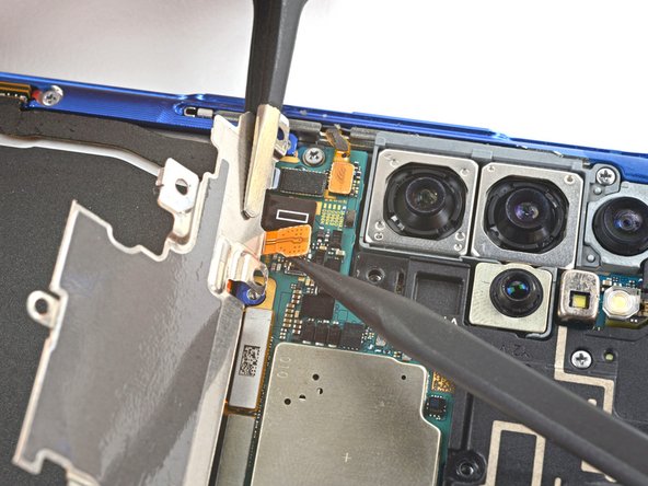

  16. Samsung Galaxy S20+ Screen and Battery Assembly Replacement, Unfasten the motherboard bracket: crwdns2935265:016crwdnd2935265:01crwdnd2935265:02crwdne2935265:0 Samsung Galaxy S20+ Screen and Battery Assembly Replacement, Unfasten the motherboard bracket: crwdns2935265:016crwdnd2935265:02crwdnd2935265:02crwdne2935265:0
    Magnetic Project Mat
    $19.95
    • Use a Phillips #00 screwdriver to remove the six 4 mm-long screws securing the motherboard bracket.

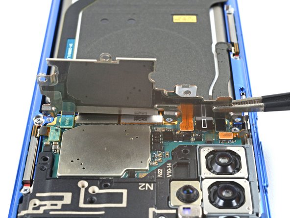

  17. Samsung Galaxy S20+ Screen and Battery Assembly Replacement, Unclip the motherboard bracket: crwdns2935265:017crwdnd2935265:01crwdnd2935265:02crwdne2935265:0 Samsung Galaxy S20+ Screen and Battery Assembly Replacement, Unclip the motherboard bracket: crwdns2935265:017crwdnd2935265:02crwdnd2935265:02crwdne2935265:0
    • Use a pair of tweezers to gently pull up and unclip the motherboard bracket from the plastic midframe.
    • Do not completely remove the bracket yet, as its still attached to the wireless charging coil.

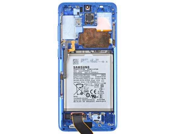

  18. Samsung Galaxy S20+ Screen and Battery Assembly Replacement: crwdns2935265:018crwdnd2935265:01crwdnd2935265:02crwdne2935265:0 Samsung Galaxy S20+ Screen and Battery Assembly Replacement: crwdns2935265:018crwdnd2935265:02crwdnd2935265:02crwdne2935265:0
    • Gently tilt up the motherboard bracket so the orange battery connector is accessible.
  19. Samsung Galaxy S20+ Screen and Battery Assembly Replacement, Disconnect the battery: crwdns2935265:019crwdnd2935265:01crwdnd2935265:02crwdne2935265:0 Samsung Galaxy S20+ Screen and Battery Assembly Replacement, Disconnect the battery: crwdns2935265:019crwdnd2935265:02crwdnd2935265:02crwdne2935265:0
    • Use a spudger to pry up and disconnect the battery connector.
    • When you disconnect connectors like these, be careful not to dislodge the small surface-mounted components surrounding the socket.
  20. Samsung Galaxy S20+ Screen and Battery Assembly Replacement, Disconnect the wireless charging coil: crwdns2935265:020crwdnd2935265:01crwdnd2935265:02crwdne2935265:0 Samsung Galaxy S20+ Screen and Battery Assembly Replacement, Disconnect the wireless charging coil: crwdns2935265:020crwdnd2935265:02crwdnd2935265:02crwdne2935265:0
    • Use a spudger to pry up and disconnect the wireless charging coil connector.

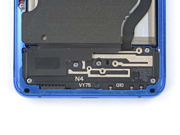

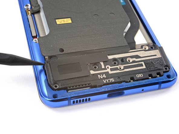

  21. Samsung Galaxy S20+ Screen and Battery Assembly Replacement, Unfasten the loudspeaker: crwdns2935265:021crwdnd2935265:01crwdnd2935265:02crwdne2935265:0 Samsung Galaxy S20+ Screen and Battery Assembly Replacement, Unfasten the loudspeaker: crwdns2935265:021crwdnd2935265:02crwdnd2935265:02crwdne2935265:0
    • Use a Phillips #00 screwdriver to remove the five 4 mm-long screws securing the loudspeaker and lower midframe.
  22. Samsung Galaxy S20+ Screen and Battery Assembly Replacement, Disconnect the loudspeaker: crwdns2935265:022crwdnd2935265:01crwdnd2935265:02crwdne2935265:0 Samsung Galaxy S20+ Screen and Battery Assembly Replacement, Disconnect the loudspeaker: crwdns2935265:022crwdnd2935265:02crwdnd2935265:02crwdne2935265:0
    • Insert the point of a spudger into the notch in the top left corner of the midframe and pry up to release the clips holding it in place.
    • Remove the loudspeaker and lower midframe.

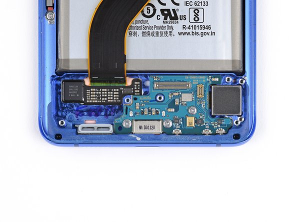

  24. Samsung Galaxy S20+ Screen and Battery Assembly Replacement, Disconnect the daughterboard: crwdns2935265:024crwdnd2935265:01crwdnd2935265:03crwdne2935265:0 Samsung Galaxy S20+ Screen and Battery Assembly Replacement, Disconnect the daughterboard: crwdns2935265:024crwdnd2935265:02crwdnd2935265:03crwdne2935265:0 Samsung Galaxy S20+ Screen and Battery Assembly Replacement, Disconnect the daughterboard: crwdns2935265:024crwdnd2935265:03crwdnd2935265:03crwdne2935265:0
    • Use a spudger to pry up and disconnect the primary and secondary flex cables from the daughterboard near the bottom of the device.
    • To re-attach press connectors like this one, carefully align and press down on one side until it clicks into place, then repeat on the other side. Do not press down on the middle. If the connector is misaligned, the pins can bend, causing permanent damage.

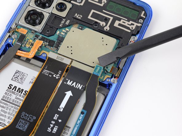

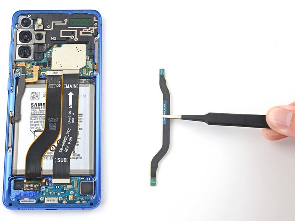

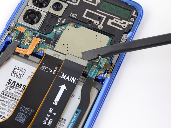

  25. Samsung Galaxy S20+ Screen and Battery Assembly Replacement, Disconnect the main flex cables: crwdns2935265:025crwdnd2935265:01crwdnd2935265:03crwdne2935265:0 Samsung Galaxy S20+ Screen and Battery Assembly Replacement, Disconnect the main flex cables: crwdns2935265:025crwdnd2935265:02crwdnd2935265:03crwdne2935265:0 Samsung Galaxy S20+ Screen and Battery Assembly Replacement, Disconnect the main flex cables: crwdns2935265:025crwdnd2935265:03crwdnd2935265:03crwdne2935265:0
    • Use a spudger to pry up and disconnect the primary and secondary flex cables from the motherboard.

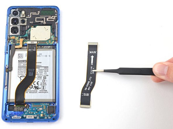

  26. Samsung Galaxy S20+ Screen and Battery Assembly Replacement, Remove the flex cables: crwdns2935265:026crwdnd2935265:01crwdnd2935265:03crwdne2935265:0 Samsung Galaxy S20+ Screen and Battery Assembly Replacement, Remove the flex cables: crwdns2935265:026crwdnd2935265:02crwdnd2935265:03crwdne2935265:0 Samsung Galaxy S20+ Screen and Battery Assembly Replacement, Remove the flex cables: crwdns2935265:026crwdnd2935265:03crwdnd2935265:03crwdne2935265:0
    • Gently peel up and remove the primary and secondary flex cables.
  27. Samsung Galaxy S20+ Screen and Battery Assembly Replacement, Unfasten the daughterboard: crwdns2935265:027crwdnd2935265:01crwdnd2935265:02crwdne2935265:0 Samsung Galaxy S20+ Screen and Battery Assembly Replacement, Unfasten the daughterboard: crwdns2935265:027crwdnd2935265:02crwdnd2935265:02crwdne2935265:0
    • Use a Phillips #00 screwdriver to remove the three 3.4 mm-long screws securing the USB-C port and daughterboard.
  28. Samsung Galaxy S20+ Screen and Battery Assembly Replacement, Remove the daughterboard: crwdns2935265:028crwdnd2935265:01crwdnd2935265:03crwdne2935265:0 Samsung Galaxy S20+ Screen and Battery Assembly Replacement, Remove the daughterboard: crwdns2935265:028crwdnd2935265:02crwdnd2935265:03crwdne2935265:0 Samsung Galaxy S20+ Screen and Battery Assembly Replacement, Remove the daughterboard: crwdns2935265:028crwdnd2935265:03crwdnd2935265:03crwdne2935265:0
    • Insert the pointed end of a spudger under the left edge of the daughterboard and pry up to release it from its recess.
    • Use a pair of blunt-nose tweezers to pull the daughterboard up and away from the bottom of the device and remove it.

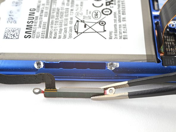

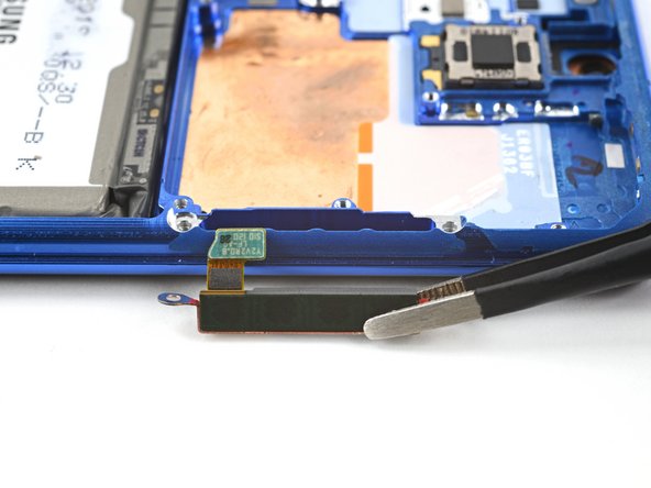

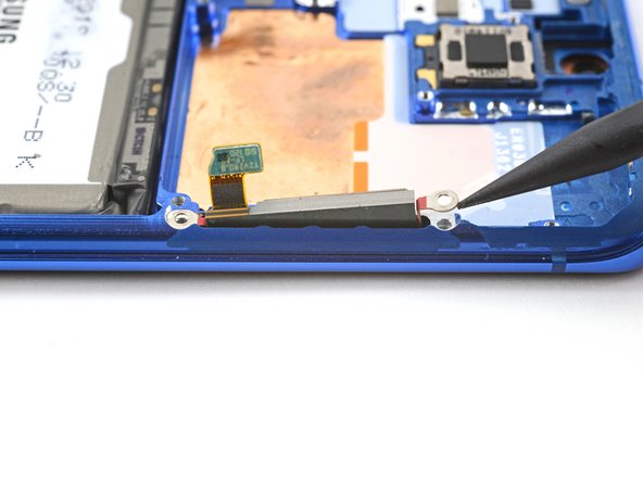

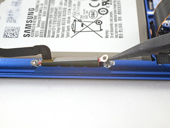

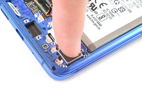

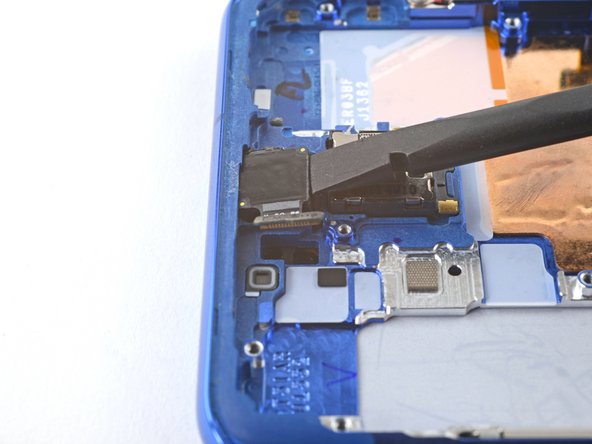

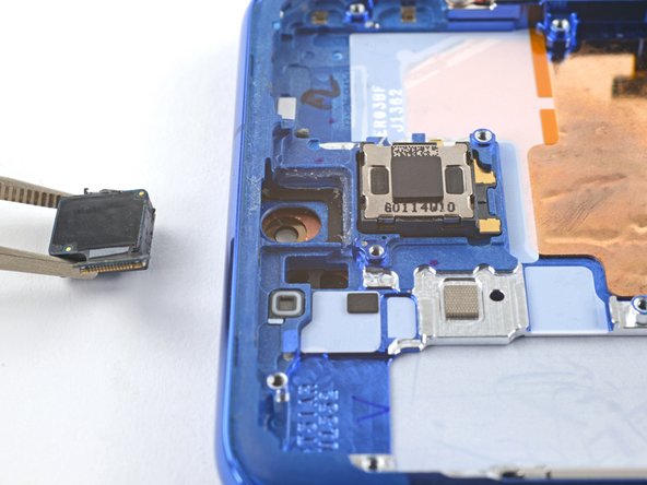

  29. Samsung Galaxy S20+ Screen and Battery Assembly Replacement, Heat the vibrator: crwdns2935265:029crwdnd2935265:01crwdnd2935265:01crwdne2935265:0
    • Apply a heated iOpener to the bottom-right corner of the device for 90 seconds.
  30. Samsung Galaxy S20+ Screen and Battery Assembly Replacement, Remove the vibrator: crwdns2935265:030crwdnd2935265:01crwdnd2935265:03crwdne2935265:0 Samsung Galaxy S20+ Screen and Battery Assembly Replacement, Remove the vibrator: crwdns2935265:030crwdnd2935265:02crwdnd2935265:03crwdne2935265:0 Samsung Galaxy S20+ Screen and Battery Assembly Replacement, Remove the vibrator: crwdns2935265:030crwdnd2935265:03crwdnd2935265:03crwdne2935265:0
    • Insert the tip of a spudger between the frame and the notch in the vibrator's edge, close to the bottom edge of the device.
    • Pry up with the spudger to separate the vibrator from the frame.
    • Remove the vibrator.
    • Set the vibrator aside. You'll reuse it during reassembly.

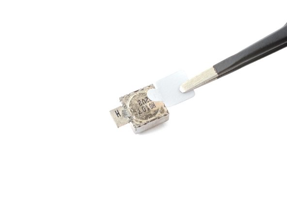

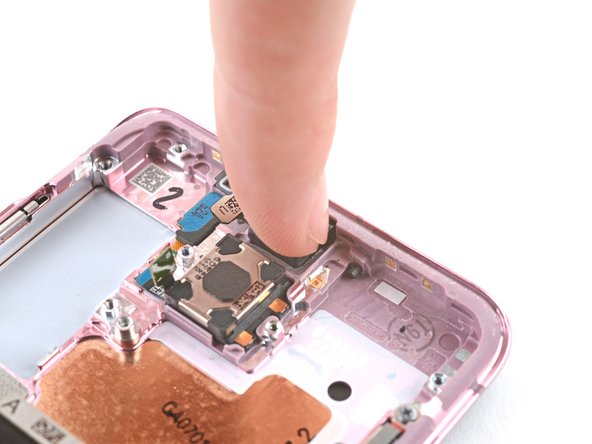

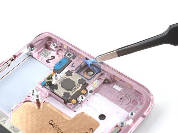

  31. Samsung Galaxy S20+ Screen and Battery Assembly Replacement, Vibrator reassembly instructions: crwdns2935265:031crwdnd2935265:01crwdnd2935265:03crwdne2935265:0 Samsung Galaxy S20+ Screen and Battery Assembly Replacement, Vibrator reassembly instructions: crwdns2935265:031crwdnd2935265:02crwdnd2935265:03crwdne2935265:0 Samsung Galaxy S20+ Screen and Battery Assembly Replacement, Vibrator reassembly instructions: crwdns2935265:031crwdnd2935265:03crwdnd2935265:03crwdne2935265:0
    • During reassembly, follow these instructions to reinstall your vibrator:
    • Peel off the vibrator adhesive from its liner and apply the sticky end to the bottom of the vibrator.
    • Use tweezers, or your fingers, to pull up on the white liner to expose the top layer of adhesive.
    • Insert the vibrator and apply pressure to adhere it to the frame.
    • The adhesive is very thin and hard to distinguish from the liner. Use your fingers to check if the adhesive transferred correctly.

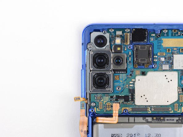

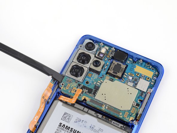

  32. Samsung Galaxy S20+ Screen and Battery Assembly Replacement, Disconnect the left 5G mmWave antenna: crwdns2935265:032crwdnd2935265:01crwdnd2935265:02crwdne2935265:0 Samsung Galaxy S20+ Screen and Battery Assembly Replacement, Disconnect the left 5G mmWave antenna: crwdns2935265:032crwdnd2935265:02crwdnd2935265:02crwdne2935265:0
    • Pry up and disconnect the left 5G mmWave antenna cable from the motherboard.
  33. Samsung Galaxy S20+ Screen and Battery Assembly Replacement, Disconnect the main display cable: crwdns2935265:033crwdnd2935265:01crwdnd2935265:02crwdne2935265:0 Samsung Galaxy S20+ Screen and Battery Assembly Replacement, Disconnect the main display cable: crwdns2935265:033crwdnd2935265:02crwdnd2935265:02crwdne2935265:0
    • Use a spudger to pry up and disconnect the main display flex cable from the motherboard.
  34. Samsung Galaxy S20+ Screen and Battery Assembly Replacement, Reposition the cables: crwdns2935265:034crwdnd2935265:01crwdnd2935265:03crwdne2935265:0 Samsung Galaxy S20+ Screen and Battery Assembly Replacement, Reposition the cables: crwdns2935265:034crwdnd2935265:02crwdnd2935265:03crwdne2935265:0 Samsung Galaxy S20+ Screen and Battery Assembly Replacement, Reposition the cables: crwdns2935265:034crwdnd2935265:03crwdnd2935265:03crwdne2935265:0
    • Gently peel up and bend the display and left 5G mmWave antenna flex cables out of the way of the motherboard and battery.

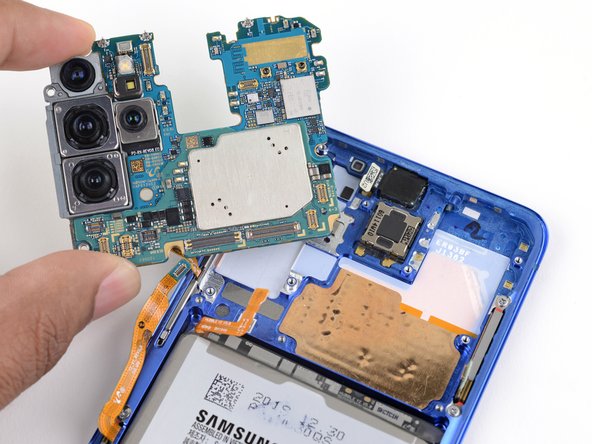

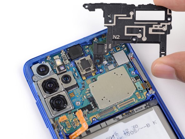

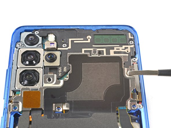

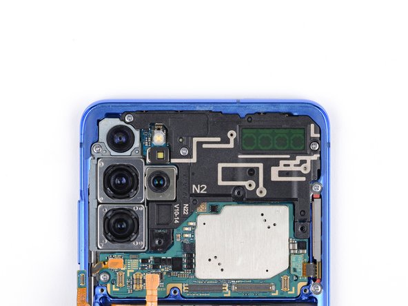

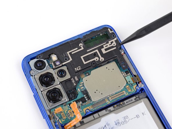

  35. Samsung Galaxy S20+ Screen and Battery Assembly Replacement, Unfasten the upper midframe: crwdns2935265:035crwdnd2935265:01crwdnd2935265:02crwdne2935265:0 Samsung Galaxy S20+ Screen and Battery Assembly Replacement, Unfasten the upper midframe: crwdns2935265:035crwdnd2935265:02crwdnd2935265:02crwdne2935265:0
    • Use a Phillips #00 screwdriver to remove the three 4 mm-long screws securing the upper midframe.
  36. Samsung Galaxy S20+ Screen and Battery Assembly Replacement, Remove the upper midframe: crwdns2935265:036crwdnd2935265:01crwdnd2935265:03crwdne2935265:0 Samsung Galaxy S20+ Screen and Battery Assembly Replacement, Remove the upper midframe: crwdns2935265:036crwdnd2935265:02crwdnd2935265:03crwdne2935265:0 Samsung Galaxy S20+ Screen and Battery Assembly Replacement, Remove the upper midframe: crwdns2935265:036crwdnd2935265:03crwdnd2935265:03crwdne2935265:0
    • Insert the point of a spudger into the notch on the right side of the upper midframe and pry up to release the clips holding it into place.
    • Remove the upper midframe.
    • Set the upper midframe aside. You'll reuse it during reassembly.

    • Use a spudger to pry up and disconnect the right 5G mmWave antenna flex cable from the motherboard.
    • Bend the cable out of the way of the motherboard.
  38. Samsung Galaxy S20+ Screen and Battery Assembly Replacement, Disconnect the side button cable: crwdns2935265:038crwdnd2935265:01crwdnd2935265:02crwdne2935265:0 Samsung Galaxy S20+ Screen and Battery Assembly Replacement, Disconnect the side button cable: crwdns2935265:038crwdnd2935265:02crwdnd2935265:02crwdne2935265:0
    • Pry up and disconnect the side button flex cable from the motherboard.
  39. Samsung Galaxy S20+ Screen and Battery Assembly Replacement, Disconnect the front facing camera: crwdns2935265:039crwdnd2935265:01crwdnd2935265:02crwdne2935265:0 Samsung Galaxy S20+ Screen and Battery Assembly Replacement, Disconnect the front facing camera: crwdns2935265:039crwdnd2935265:02crwdnd2935265:02crwdne2935265:0
    • Pry up and disconnect the front facing camera flex cable from the motherboard.
  40. Samsung Galaxy S20+ Screen and Battery Assembly Replacement, Remove the upper 5G mmWave antenna: crwdns2935265:040crwdnd2935265:01crwdnd2935265:02crwdne2935265:0 Samsung Galaxy S20+ Screen and Battery Assembly Replacement, Remove the upper 5G mmWave antenna: crwdns2935265:040crwdnd2935265:02crwdnd2935265:02crwdne2935265:0
    • Use the flat end of a spudger to pry up and disconnect the 5G mmWave antenna module.
    • Use the flat end of a spudger to pry up the corner of the antenna module.
    • The module is secured with a bit of adhesive, but should release easily.
    • Remove the mmWave antenna module.
    • During reassembly, reconnect the antenna connector first to properly align it into place, then firmly press the rest of the module down to adhere it.
  41. Samsung Galaxy S20+ Screen and Battery Assembly Replacement, Unfasten the motherboard assembly: crwdns2935265:041crwdnd2935265:01crwdnd2935265:02crwdne2935265:0 Samsung Galaxy S20+ Screen and Battery Assembly Replacement, Unfasten the motherboard assembly: crwdns2935265:041crwdnd2935265:02crwdnd2935265:02crwdne2935265:0
    • Use a Phillips #00 screwdriver to remove the two screws securing the motherboard and camera assembly:
    • One 4 mm-long screw
    • One 3.4 mm-long screw
  42. Samsung Galaxy S20+ Screen and Battery Assembly Replacement, Remove the motherboard assembly: crwdns2935265:042crwdnd2935265:01crwdnd2935265:03crwdne2935265:0 Samsung Galaxy S20+ Screen and Battery Assembly Replacement, Remove the motherboard assembly: crwdns2935265:042crwdnd2935265:02crwdnd2935265:03crwdne2935265:0 Samsung Galaxy S20+ Screen and Battery Assembly Replacement, Remove the motherboard assembly: crwdns2935265:042crwdnd2935265:03crwdnd2935265:03crwdne2935265:0
    • Insert the flat end of a spudger into the bottom left corner of the motherboard assembly and pry up to release it from the phone body.
    • Remove the motherboard assembly.
  43. Samsung Galaxy S20+ Screen and Battery Assembly Replacement, Heat the front camera: crwdns2935265:043crwdnd2935265:01crwdnd2935265:01crwdne2935265:0
    • Apply a heated iOpener to the front camera for 90 seconds.
  44. Samsung Galaxy S20+ Screen and Battery Assembly Replacement, Remove the front camera: crwdns2935265:044crwdnd2935265:01crwdnd2935265:03crwdne2935265:0 Samsung Galaxy S20+ Screen and Battery Assembly Replacement, Remove the front camera: crwdns2935265:044crwdnd2935265:02crwdnd2935265:03crwdne2935265:0 Samsung Galaxy S20+ Screen and Battery Assembly Replacement, Remove the front camera: crwdns2935265:044crwdnd2935265:03crwdnd2935265:03crwdne2935265:0
    • Insert a spudger into the gap between the frame and the front camera.
    • Pry up with the spudger to separate the front camera from the frame.
    • If you're having trouble separating the front camera from the frame, apply more heat.
    • Use tweezers, or your fingers, to remove the front camera.
    • Set the camera aside. You'll reuse it during reassembly.
  45. Samsung Galaxy S20+ Screen and Battery Assembly Replacement, Front camera reassembly instructions: crwdns2935265:045crwdnd2935265:01crwdnd2935265:03crwdne2935265:0 Samsung Galaxy S20+ Screen and Battery Assembly Replacement, Front camera reassembly instructions: crwdns2935265:045crwdnd2935265:02crwdnd2935265:03crwdne2935265:0 Samsung Galaxy S20+ Screen and Battery Assembly Replacement, Front camera reassembly instructions: crwdns2935265:045crwdnd2935265:03crwdnd2935265:03crwdne2935265:0
    • During reassembly, follow these instructions to reinstall your front camera:
    • Peel off the front camera adhesive from its liner and apply the sticky end to the frame.
    • Use tweezers, or your fingers, to pull on the tab and expose the top layer of adhesive.
    • Insert the front camera and apply pressure to adhere it to the frame.
  46. Samsung Galaxy S20+ Screen and Battery Assembly Replacement, Unfasten the 5G mmWave antennas: crwdns2935265:046crwdnd2935265:01crwdnd2935265:02crwdne2935265:0 Samsung Galaxy S20+ Screen and Battery Assembly Replacement, Unfasten the 5G mmWave antennas: crwdns2935265:046crwdnd2935265:02crwdnd2935265:02crwdne2935265:0
    • Use a Phillips screwdriver to remove the four 3.4 mm-long screws securing the 5G mmWave antennas.
  47. Samsung Galaxy S20+ Screen and Battery Assembly Replacement, Remove the right 5G antenna: crwdns2935265:047crwdnd2935265:01crwdnd2935265:03crwdne2935265:0 Samsung Galaxy S20+ Screen and Battery Assembly Replacement, Remove the right 5G antenna: crwdns2935265:047crwdnd2935265:02crwdnd2935265:03crwdne2935265:0 Samsung Galaxy S20+ Screen and Battery Assembly Replacement, Remove the right 5G antenna: crwdns2935265:047crwdnd2935265:03crwdnd2935265:03crwdne2935265:0
    • Use the point of a spudger to pry up on the 5G antenna bracket's bottom screw tab.
    • Use tweezers, or your fingers, to remove the 5G antenna.
  48. Samsung Galaxy S20+ Screen and Battery Assembly Replacement, Remove the left 5G antenna: crwdns2935265:048crwdnd2935265:01crwdnd2935265:03crwdne2935265:0 Samsung Galaxy S20+ Screen and Battery Assembly Replacement, Remove the left 5G antenna: crwdns2935265:048crwdnd2935265:02crwdnd2935265:03crwdne2935265:0 Samsung Galaxy S20+ Screen and Battery Assembly Replacement, Remove the left 5G antenna: crwdns2935265:048crwdnd2935265:03crwdnd2935265:03crwdne2935265:0
    • Use the point of a spudger to pry up on the 5G antenna bracket's top edge.
  49. Samsung Galaxy S20+ Screen and Battery Assembly Replacement, Only the screen and battery assembly remains: crwdns2935265:049crwdnd2935265:01crwdnd2935265:01crwdne2935265:0
    • You're now left with the screen and battery assembly.
