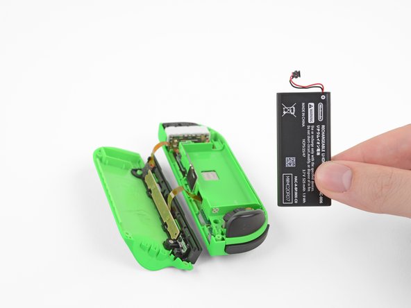

    4. Right Joy-Con Joystick Replacement, Disconnect the battery: crwdns2935265:04crwdnd2935265:01crwdnd2935265:02crwdne2935265:0 Right Joy-Con Joystick Replacement, Disconnect the battery: crwdns2935265:04crwdnd2935265:02crwdnd2935265:02crwdne2935265:0
      • Use a spudger to gently pry the battery connector from its socket on the motherboard. This will keep the Joy-Con from powering on during the repair.
      • Be extremely careful while you pry up the battery connector. If it does not come up easily, try gently pulling on the wires to disconnect it.
    5. Right Joy-Con Joystick Replacement, Remove the battery: crwdns2935265:05crwdnd2935265:01crwdnd2935265:03crwdne2935265:0 Right Joy-Con Joystick Replacement, Remove the battery: crwdns2935265:05crwdnd2935265:02crwdnd2935265:03crwdne2935265:0 Right Joy-Con Joystick Replacement, Remove the battery: crwdns2935265:05crwdnd2935265:03crwdnd2935265:03crwdne2935265:0
      • The following two steps show the removal of the battery and the coaxial antenna cable from the midframe. These two steps make for a less cluttered repair, but are not essential. If you want, you can leave the battery and the grey coax cable in place here and proceed to step 7.
      • Insert an opening pick between the battery and the Joy-Con housing. Gently pry out the battery, which is lightly taped in place.
      • Be careful not to deform or puncture the battery—it can catch fire or explode if damaged.

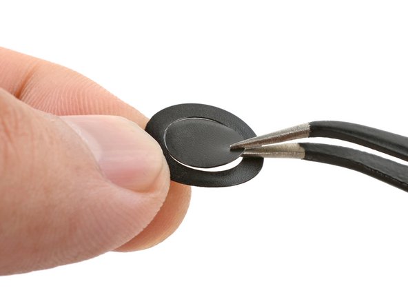

    14. Right Joy-Con Joystick Replacement, Install the Gulikit joystick ring sticker: crwdns2935265:014crwdnd2935265:01crwdnd2935265:02crwdne2935265:0 Right Joy-Con Joystick Replacement, Install the Gulikit joystick ring sticker: crwdns2935265:014crwdnd2935265:02crwdnd2935265:02crwdne2935265:0
      • If you've replaced the joystick with a Gulikit module and it came with a joystick ring sticker, follow the next two steps to install it.
      • Use your fingers to pull the thumbstick off of the Gulikit joystick module.
    15. Right Joy-Con Joystick Replacement: crwdns2935265:015crwdnd2935265:01crwdnd2935265:03crwdne2935265:0 Right Joy-Con Joystick Replacement: crwdns2935265:015crwdnd2935265:02crwdnd2935265:03crwdne2935265:0 Right Joy-Con Joystick Replacement: crwdns2935265:015crwdnd2935265:03crwdnd2935265:03crwdne2935265:0
      • Peel the ring sticker from its liner.
      • If the sticker center is still attached, separate and remove it from the ring.
      • Set the ring sticker in the joystick recess and press it with your fingers for a few seconds to attach it.
