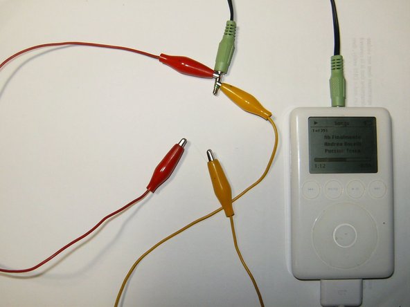

    • Simple setup to test the driver (speaker) Two leads with alligator clips, connect those to an 3.5mm audio jack extension.
    • Use those leads and touch the connector of the driver (speaker) on the PCB. There will be sound if the driver (speaker) is working.

    • Check the driver (speaker) the same way as on the left side.
    • On this headset, both drivers worked while being tested, but not when the audio was connected to the audio jack. The jack needed to be replaced.
