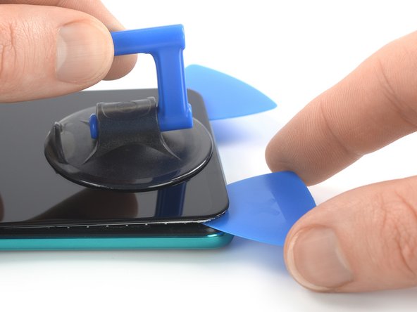

    3. Redmi Note 9 Pro Screen Replacement, Insert an iFlex: crwdns2935265:017crwdnd2935265:01crwdnd2935265:02crwdne2935265:0 Redmi Note 9 Pro Screen Replacement, Insert an iFlex: crwdns2935265:017crwdnd2935265:02crwdnd2935265:02crwdne2935265:0
      • Once the screen is warm to touch, apply a suction handle to the bottom edge of the screen.
      • If your screen is badly cracked, covering it with a layer of clear packing tape may allow the suction cup to adhere. Alternatively, very strong tape may be used instead of the suction handle. If all else fails, you can superglue the suction cup to the screen.
      • Lift the screen with the suction handle to create a small gap between the screen and the frame.
      • Insert an iFlex into the gap between the midframe and the screen.
    4. Redmi Note 9 Pro Screen Replacement, Insert an opening pick: crwdns2935265:018crwdnd2935265:01crwdnd2935265:03crwdne2935265:0 Redmi Note 9 Pro Screen Replacement, Insert an opening pick: crwdns2935265:018crwdnd2935265:02crwdnd2935265:03crwdne2935265:0 Redmi Note 9 Pro Screen Replacement, Insert an opening pick: crwdns2935265:018crwdnd2935265:03crwdnd2935265:03crwdne2935265:0
      • Insert an opening pick above the iFlex.
      • Slide the opening pick to the bottom right corner of the screen to slice its adhesive.
      • Remove the iFlex.
      • Leave the opening pick in place to prevent the adhesive from resealing.
    5. Redmi Note 9 Pro Screen Replacement, Slice the adhesive: crwdns2935265:019crwdnd2935265:01crwdnd2935265:02crwdne2935265:0 Redmi Note 9 Pro Screen Replacement, Slice the adhesive: crwdns2935265:019crwdnd2935265:02crwdnd2935265:02crwdne2935265:0
      • Insert a second opening pick at the bottom edge and slide it to the bottom left corner of the screen to slice the adhesive.
