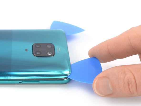

    2. Redmi Note 9 Pro Rear Glass Replacement, Insert an opening pick: crwdns2935265:02crwdnd2935265:01crwdnd2935265:03crwdne2935265:0 Redmi Note 9 Pro Rear Glass Replacement, Insert an opening pick: crwdns2935265:02crwdnd2935265:02crwdnd2935265:03crwdne2935265:0 Redmi Note 9 Pro Rear Glass Replacement, Insert an opening pick: crwdns2935265:02crwdnd2935265:03crwdnd2935265:03crwdne2935265:0
      • Secure a suction handle to the bottom edge of the rear glass, as close to the edge as possible.
      • If the rear glass is cracked, the suction handle may not stick. Try lifting it with strong tape, or superglue the suction handle in place and allow it to cure so you can proceed.
      • Lift the rear glass with the suction handle to create a small gap between the back cover and the frame.
      • In case you have trouble creating a gap, apply more heat to further soften the adhesive. Follow the iOpener instructions to avoid overheating.
      • Insert an opening pick into the gap you created.
      • Slide the opening pick to the bottom right corner to slice the adhesive.
      • Leave the opening pick in place to prevent the adhesive from resealing.

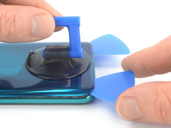

    3. Redmi Note 9 Pro Rear Glass Replacement, Slice the adhesive: crwdns2935265:03crwdnd2935265:01crwdnd2935265:02crwdne2935265:0 Redmi Note 9 Pro Rear Glass Replacement, Slice the adhesive: crwdns2935265:03crwdnd2935265:02crwdnd2935265:02crwdne2935265:0
      • Insert a second opening pick at the bottom edge of your phone.
      • Slide the opening pick to the bottom left corner to slice the adhesive.
      • Leave the opening picks in place to prevent the adhesive from resealing.
