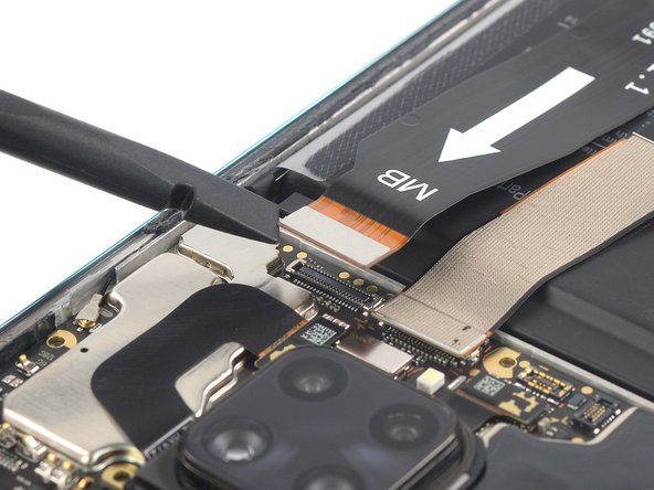

  11. Redmi Note 9 Pro Battery Replacement, Disconnect the battery cable: crwdns2935265:011crwdnd2935265:01crwdnd2935265:02crwdne2935265:0 Redmi Note 9 Pro Battery Replacement, Disconnect the battery cable: crwdns2935265:011crwdnd2935265:02crwdnd2935265:02crwdne2935265:0
    • Use a spudger to disconnect the battery cable by prying the connector straight up from its socket.
  12. Redmi Note 9 Pro Battery Replacement, Disconnect the power and volume button cable: crwdns2935265:012crwdnd2935265:01crwdnd2935265:03crwdne2935265:0 Redmi Note 9 Pro Battery Replacement, Disconnect the power and volume button cable: crwdns2935265:012crwdnd2935265:02crwdnd2935265:03crwdne2935265:0 Redmi Note 9 Pro Battery Replacement, Disconnect the power and volume button cable: crwdns2935265:012crwdnd2935265:03crwdnd2935265:03crwdne2935265:0
    • Use a spudger to disconnect the power and volume button cable by prying the connector straight up from its socket.
    • Use your spudger to carefully fold the power and volume button cable to the side to free the battery.
    • Do not fold the cable sharply and only bend it to avoid cable damage.

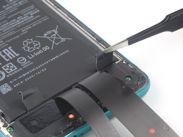

  16. Redmi Note 9 Pro Battery Replacement, Remove the stretch-release adhesive: crwdns2935265:016crwdnd2935265:01crwdnd2935265:03crwdne2935265:0 Redmi Note 9 Pro Battery Replacement, Remove the stretch-release adhesive: crwdns2935265:016crwdnd2935265:02crwdnd2935265:03crwdne2935265:0 Redmi Note 9 Pro Battery Replacement, Remove the stretch-release adhesive: crwdns2935265:016crwdnd2935265:03crwdnd2935265:03crwdne2935265:0
    • The battery is secured to the rear case with two pieces of stretch-release adhesive.
    • Don't jab the battery with any sharp tools. A punctured battery may leak dangerous chemicals or catch fire.
    • Use a pair of blunt nose tweezers or a clean fingernail to peel down both battery adhesive pull-tabs to un-stick them from the top edge of the battery.

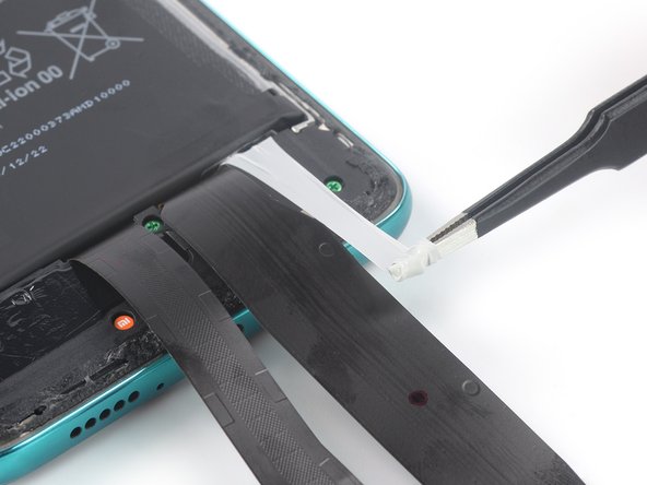

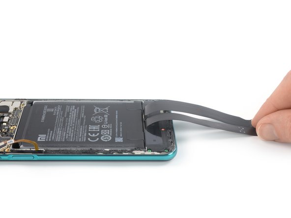

  17. Redmi Note 9 Pro Battery Replacement, Remove the pull-tabs: crwdns2935265:017crwdnd2935265:01crwdnd2935265:03crwdne2935265:0 Redmi Note 9 Pro Battery Replacement, Remove the pull-tabs: crwdns2935265:017crwdnd2935265:02crwdnd2935265:03crwdne2935265:0 Redmi Note 9 Pro Battery Replacement, Remove the pull-tabs: crwdns2935265:017crwdnd2935265:03crwdnd2935265:03crwdne2935265:0
    • Grab the first pull-tab with a pair of blunt nose tweezers or your fingers and slowly pull it away from the battery and towards the bottom edge of your phone.
    • Pull hard enough to maintain tension on the strip, but don't force it. Give it plenty of time to stretch and un-stick from under the battery.
    • Don't press down on the battery. Hold the phone firmly by its sides.
    • Keep the strip flat and unwrinkled. Try to pull evenly on the whole strip, rather than pulling mainly in the middle or on one side.
    • Pull at a low angle so the strip doesn't snag on the edge of the battery.
    • If the adhesive strip breaks off, try to retrieve it using your fingers or blunt tweezers, and continue pulling—but do not pry under the battery.
    • If the adhesive breaks off underneath the battery and can't be retrieved, continue with the next step.

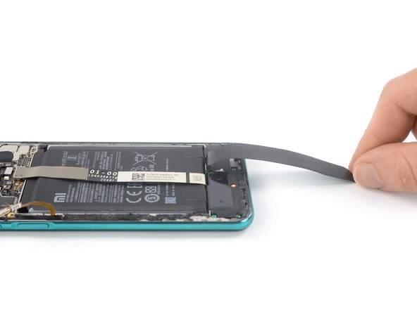

  18. Redmi Note 9 Pro Battery Replacement: crwdns2935265:018crwdnd2935265:01crwdnd2935265:03crwdne2935265:0 Redmi Note 9 Pro Battery Replacement: crwdns2935265:018crwdnd2935265:02crwdnd2935265:03crwdne2935265:0 Redmi Note 9 Pro Battery Replacement: crwdns2935265:018crwdnd2935265:03crwdnd2935265:03crwdne2935265:0
    • Repeat the previous pull-tab removal procedure on the second pull-tab.
    • Follow the same procedure as with the previous strip: don't press down on the battery, keep the strip flat and unwrinkled, and pull at a low angle.
    • If the adhesive breaks off underneath the battery and can't be retrieved, apply a few drops of high concentration (over 90%) isopropyl alcohol under the edge of the battery in the area of the broken adhesive strip(s).
    • Wait about one minute for the alcohol solution to weaken the adhesive.
    • Use the flat end of a spudger to gently lift the battery.
    • Don't try to forcefully lever the battery out. If needed, apply a few more drops of alcohol to further weaken the adhesive. Never deform or puncture the battery with your pry tool.
