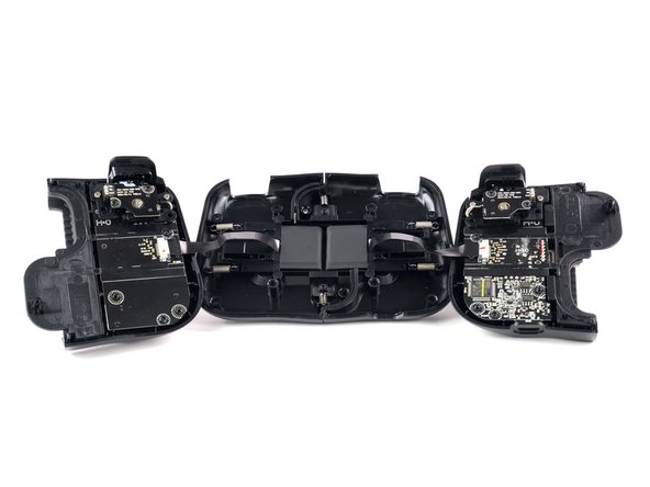

    • Game time started—we blast off ten Tri-point screws from the rear side. Thankfully we came equipped with 64 bits of Mako Driver Kit goodness. We're leveling up already!
    • Beneath the back cover, we find two Steam-ish booby-trap interconnect cables—each one snaking off to a separate circuit board.
  4. Razer Kishi Teardown: crwdns2935265:04crwdnd2935265:01crwdnd2935265:02crwdne2935265:0 Razer Kishi Teardown: crwdns2935265:04crwdnd2935265:02crwdnd2935265:02crwdne2935265:0
    • Instead of the tricky Tri-points found in other portable gaming options, we find regular Phillips #0 screws inside of the handles.
    • Normally each new level gets more challenging, but here it seems Razer gave us a break. Or is it just a distracting side quest? Regardless, we're happy to go on a Phillips fetch quest.
    • There's no boss battle here yet—just a couple boards, which we quickly extract.

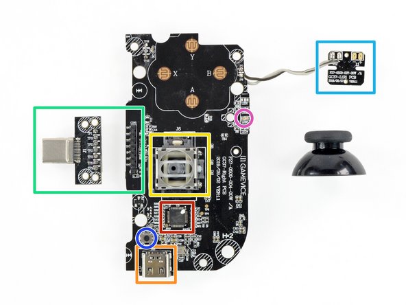

  5. Razer Kishi Teardown: crwdns2935265:05crwdnd2935265:01crwdnd2935265:02crwdne2935265:0 Razer Kishi Teardown: crwdns2935265:05crwdnd2935265:02crwdnd2935265:02crwdne2935265:0
    • The right board contains the following bijous:
    • Fresco Logic FL7102, USB3.1 Type-C PD3.0 Controller
    • Soldered-on USB Type-C charging port
    • Soldered-on joystick controller (hello Oculus Touch and Xbox One S)
    • Plug-in phone connector (in this model USB-C)
    • Soldered-on breakout board for one of the shoulder buttons
    • "Forward" button
    • Indicator LED

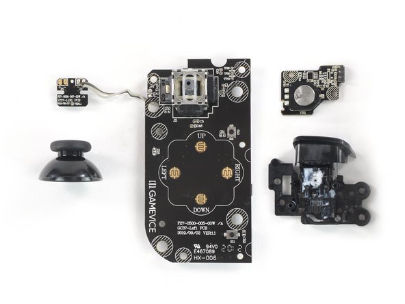

  7. Razer Kishi Teardown: crwdns2935265:07crwdnd2935265:01crwdnd2935265:03crwdne2935265:0 Razer Kishi Teardown: crwdns2935265:07crwdnd2935265:02crwdnd2935265:03crwdne2935265:0 Razer Kishi Teardown: crwdns2935265:07crwdnd2935265:03crwdnd2935265:03crwdne2935265:0
    • Extracting the left circuit board reveals:
    • Another joystick, which is also soldered in place
    • Four golden contacts for the D-pad (similar to the ones on the first circuit board)
    • Soldered-on shoulder button
    • Another shoulder trigger breakout board
    • "Back" button
    • "Home" button
    • Gamevice has rather unmistakably left its mark here—just in case you wondered with whom Razer partnered up for this controller.

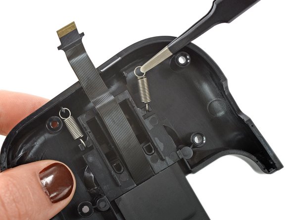

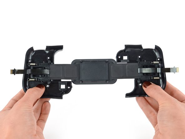

    • What remains is the telescoping slider mechanism that supports your phone when attached to the Kishi.
    • It includes a folding rubber cushion, which attaches to the back cover with small springs. That's what saves you from worrying about scratches on the back of your phone while gaming.
    • As you may have noticed, all external faces of the controller can be separated from the electrical components, which will make individual paint jobs a breeze!
