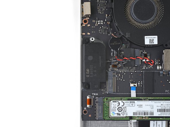

  8. Razer Blade 15" (2020) Speakers Replacement, Disconnect the right speaker: crwdns2935265:08crwdnd2935265:01crwdnd2935265:03crwdne2935265:0 Razer Blade 15" (2020) Speakers Replacement, Disconnect the right speaker: crwdns2935265:08crwdnd2935265:02crwdnd2935265:03crwdne2935265:0 Razer Blade 15" (2020) Speakers Replacement, Disconnect the right speaker: crwdns2935265:08crwdnd2935265:03crwdnd2935265:03crwdne2935265:0
    • Use the point of your spudger to press on alternating sides of the right speaker (labeled R) connector to "walk" it out of its socket.
  9. Razer Blade 15" (2020) Speakers Replacement, Unfasten the right speaker: crwdns2935265:09crwdnd2935265:01crwdnd2935265:02crwdne2935265:0 Razer Blade 15" (2020) Speakers Replacement, Unfasten the right speaker: crwdns2935265:09crwdnd2935265:02crwdnd2935265:02crwdne2935265:0
    • Use a Phillips screwdriver to remove the two 7.6 mm screws securing the right speaker.
  10. Razer Blade 15" (2020) Speakers Replacement, Remove the right speaker: crwdns2935265:010crwdnd2935265:01crwdnd2935265:02crwdne2935265:0 Razer Blade 15" (2020) Speakers Replacement, Remove the right speaker: crwdns2935265:010crwdnd2935265:02crwdnd2935265:02crwdne2935265:0
    • Remove the right speaker

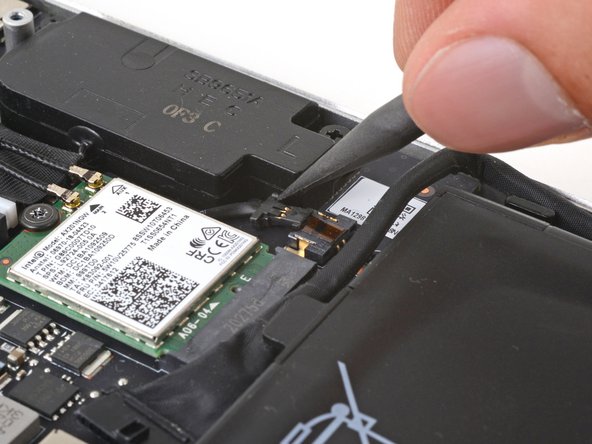

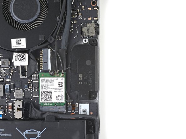

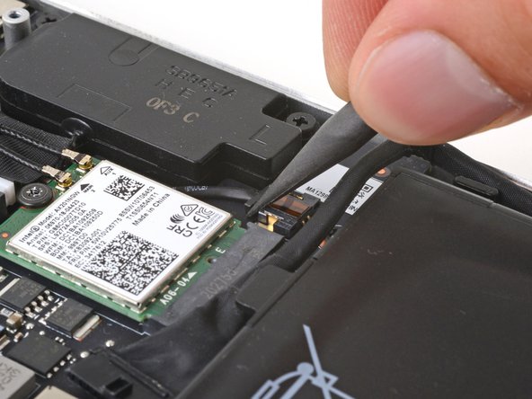

  11. Razer Blade 15" (2020) Speakers Replacement, Disconnect the left speaker: crwdns2935265:011crwdnd2935265:01crwdnd2935265:03crwdne2935265:0 Razer Blade 15" (2020) Speakers Replacement, Disconnect the left speaker: crwdns2935265:011crwdnd2935265:02crwdnd2935265:03crwdne2935265:0 Razer Blade 15" (2020) Speakers Replacement, Disconnect the left speaker: crwdns2935265:011crwdnd2935265:03crwdnd2935265:03crwdne2935265:0
    • Use the point of your spudger to press on alternating sides of the left speaker (labeled L) connector to "walk" it out of its socket.
    • If the cable is tightly wedged under the Wi-Fi card, use your Phillips screwdriver to slightly loosen the screw securing it, freeing the speaker cable.
  12. Razer Blade 15" (2020) Speakers Replacement, Unfasten the left speaker: crwdns2935265:012crwdnd2935265:01crwdnd2935265:02crwdne2935265:0 Razer Blade 15" (2020) Speakers Replacement, Unfasten the left speaker: crwdns2935265:012crwdnd2935265:02crwdnd2935265:02crwdne2935265:0
    • Use your Phillips screwdriver to remove the two 7.6 mm screws securing the left speaker.

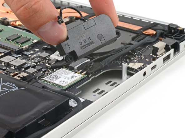

  13. Razer Blade 15" (2020) Speakers Replacement, Remove the left speaker: crwdns2935265:013crwdnd2935265:01crwdnd2935265:02crwdne2935265:0 Razer Blade 15" (2020) Speakers Replacement, Remove the left speaker: crwdns2935265:013crwdnd2935265:02crwdnd2935265:02crwdne2935265:0
    • Remove the left speaker.
