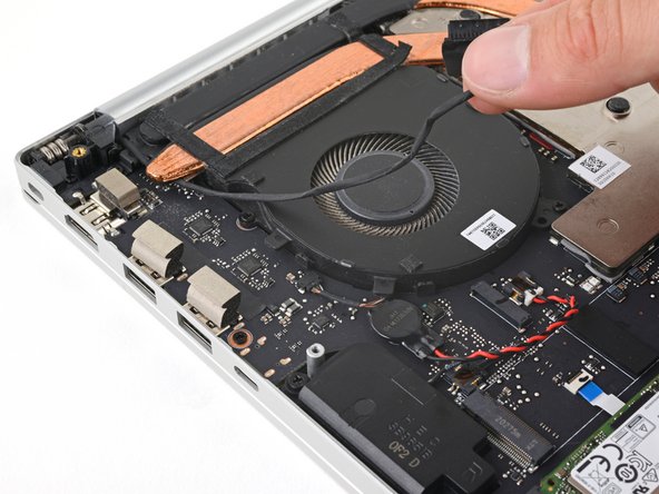

    • Use the flat end of a spudger to push the square tab on the battery connector and slide it out of its socket.

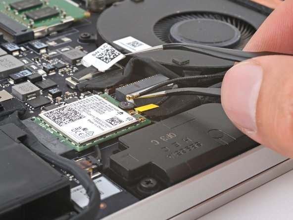

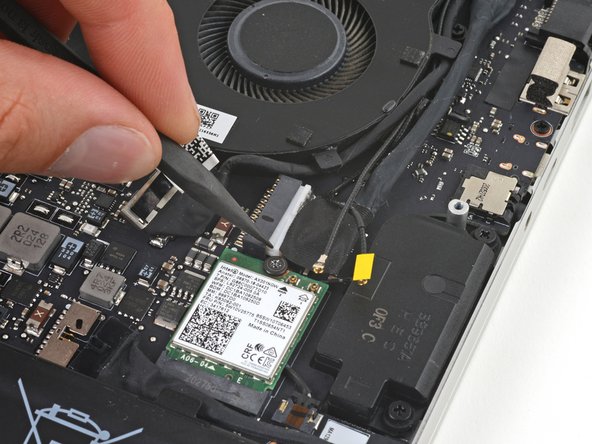

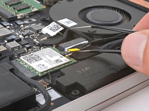

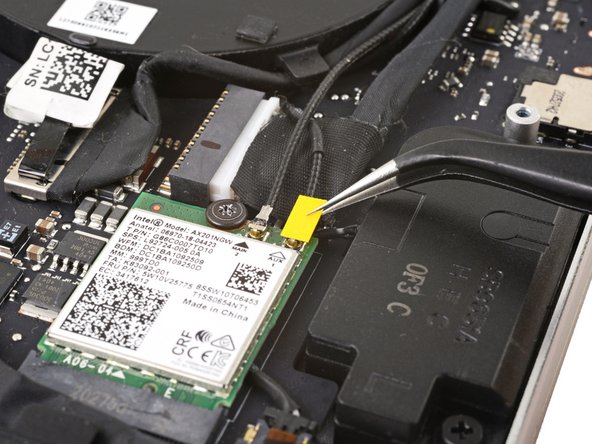

  8. Razer Blade 15" (2020) Screen Replacement, Label the antenna cables: crwdns2935265:08crwdnd2935265:01crwdnd2935265:02crwdne2935265:0 Razer Blade 15" (2020) Screen Replacement, Label the antenna cables: crwdns2935265:08crwdnd2935265:02crwdnd2935265:02crwdne2935265:0
    • In the next two steps, you'll disconnect the Wi-Fi antenna cables to access other components.
    • The antenna cables look very similar. Label one of them with a piece of tape or marker and remember which socket it connects to.
  9. Razer Blade 15" (2020) Screen Replacement, Disconnect the antenna cables: crwdns2935265:09crwdnd2935265:01crwdnd2935265:03crwdne2935265:0 Razer Blade 15" (2020) Screen Replacement, Disconnect the antenna cables: crwdns2935265:09crwdnd2935265:02crwdnd2935265:03crwdne2935265:0 Razer Blade 15" (2020) Screen Replacement, Disconnect the antenna cables: crwdns2935265:09crwdnd2935265:03crwdnd2935265:03crwdne2935265:0
    $3.99
    • Insert one arm of angled tweezers under the metal neck of each antenna cable and pry up to disconnect it.
    • During reassembly, align the connector over its socket and gently press down with the flat end of your spudger or your fingernail until it clicks into place.

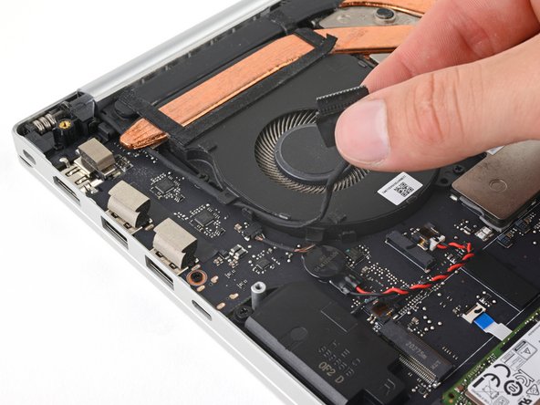

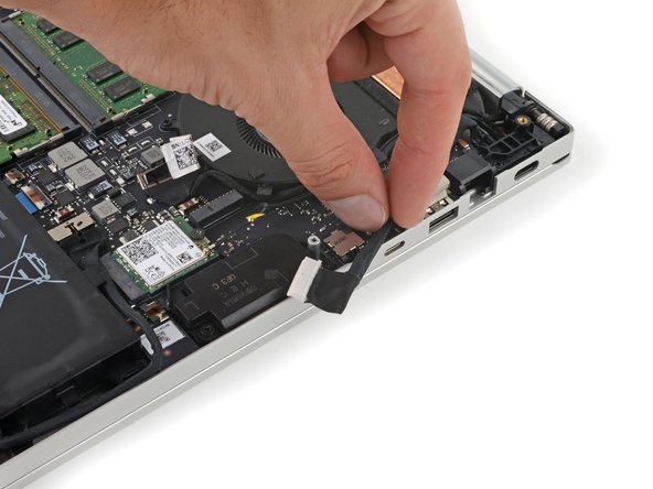

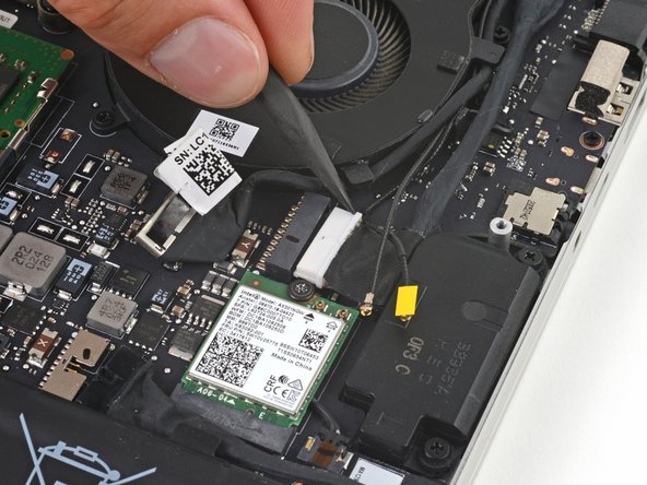

  10. Razer Blade 15" (2020) Screen Replacement, Disconnect the screen press connector: crwdns2935265:010crwdnd2935265:01crwdnd2935265:02crwdne2935265:0 Razer Blade 15" (2020) Screen Replacement, Disconnect the screen press connector: crwdns2935265:010crwdnd2935265:02crwdnd2935265:02crwdne2935265:0
    • Grab the pull tab on the screen connector.
    • Pull up to disconnect the connector from its socket.
    • During reassembly, align the connector over its socket and press down until it clicks into place.

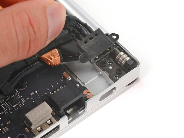

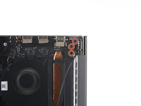

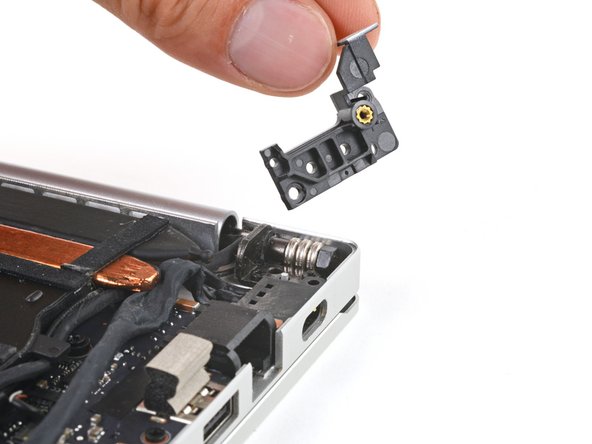

  13. Razer Blade 15" (2020) Screen Replacement, Unfasten the right hinge cover: crwdns2935265:013crwdnd2935265:01crwdnd2935265:01crwdne2935265:0
    • Use a Phillips screwdriver to remove the three 6.7 mm screws securing the right hinge cover.

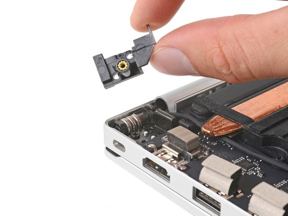

  14. Razer Blade 15" (2020) Screen Replacement, Remove the right hinge cover: crwdns2935265:014crwdnd2935265:01crwdnd2935265:02crwdne2935265:0 Razer Blade 15" (2020) Screen Replacement, Remove the right hinge cover: crwdns2935265:014crwdnd2935265:02crwdnd2935265:02crwdne2935265:0
    • Remove the right hinge cover.

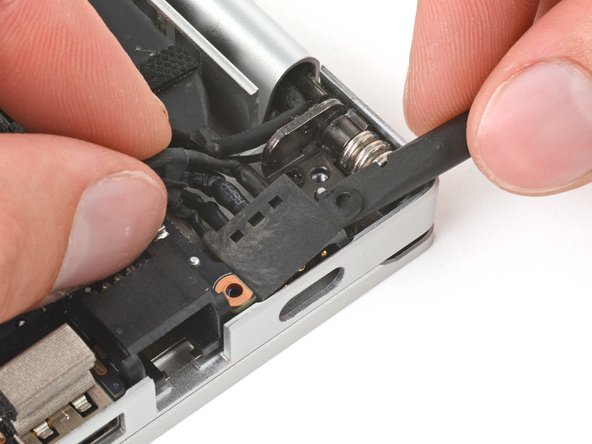

  15. Razer Blade 15" (2020) Screen Replacement, Pry up the charging port: crwdns2935265:015crwdnd2935265:01crwdnd2935265:02crwdne2935265:0 Razer Blade 15" (2020) Screen Replacement, Pry up the charging port: crwdns2935265:015crwdnd2935265:02crwdnd2935265:02crwdne2935265:0
    • Hold the charging port cables out of the way of the heatsink.
    • Use the flat end of your spudger to pry up the top screw mount of the charging port until it clears the hinge.
  16. Razer Blade 15" (2020) Screen Replacement, Remove the charging port: crwdns2935265:016crwdnd2935265:01crwdnd2935265:02crwdne2935265:0 Razer Blade 15" (2020) Screen Replacement, Remove the charging port: crwdns2935265:016crwdnd2935265:02crwdnd2935265:02crwdne2935265:0
    • Rotate the charging port counterclockwise and slide the lower screw mount out from underneath the motherboard.
    • Remove the charging port.
  17. Razer Blade 15" (2020) Screen Replacement, Disconnect the left-side screen cable: crwdns2935265:017crwdnd2935265:01crwdnd2935265:02crwdne2935265:0 Razer Blade 15" (2020) Screen Replacement, Disconnect the left-side screen cable: crwdns2935265:017crwdnd2935265:02crwdnd2935265:02crwdne2935265:0
    • Grab the pull tab on the neck of the left-side screen connector and pull it straight out of its socket.
  18. Razer Blade 15" (2020) Screen Replacement, Unclip the screen cable: crwdns2935265:018crwdnd2935265:01crwdnd2935265:03crwdne2935265:0 Razer Blade 15" (2020) Screen Replacement, Unclip the screen cable: crwdns2935265:018crwdnd2935265:02crwdnd2935265:03crwdne2935265:0 Razer Blade 15" (2020) Screen Replacement, Unclip the screen cable: crwdns2935265:018crwdnd2935265:03crwdnd2935265:03crwdne2935265:0
    • Pull the left-side screen cable out from the clips along the left edge of the fan.

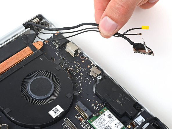

  21. Razer Blade 15" (2020) Screen Replacement, Unclip the right-side screen and antenna cables: crwdns2935265:021crwdnd2935265:01crwdnd2935265:02crwdne2935265:0 Razer Blade 15" (2020) Screen Replacement, Unclip the right-side screen and antenna cables: crwdns2935265:021crwdnd2935265:02crwdnd2935265:02crwdne2935265:0
    • Unclip the right-side screen and antenna cables from the fan and move them over the right side of the laptop.

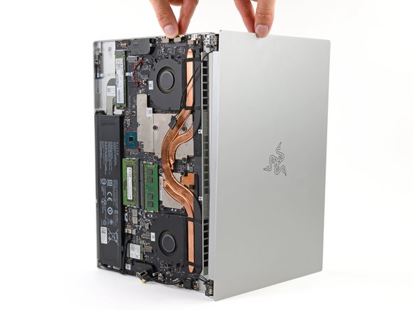

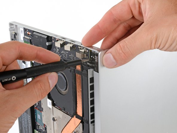

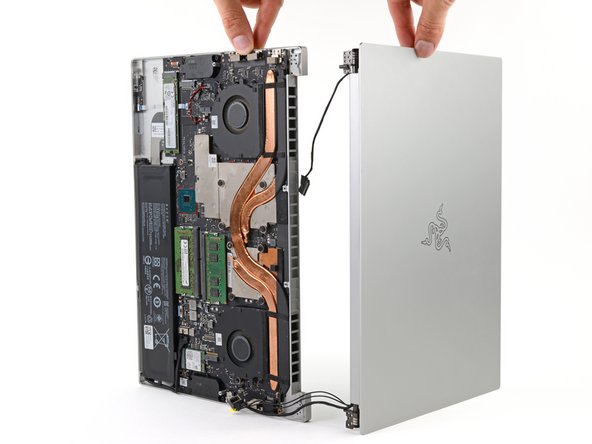

  22. Razer Blade 15" (2020) Screen Replacement, Prop up your laptop: crwdns2935265:022crwdnd2935265:01crwdnd2935265:01crwdne2935265:0
  23. Razer Blade 15" (2020) Screen Replacement, Unfasten the hinges: crwdns2935265:023crwdnd2935265:01crwdnd2935265:03crwdne2935265:0 Razer Blade 15" (2020) Screen Replacement, Unfasten the hinges: crwdns2935265:023crwdnd2935265:02crwdnd2935265:03crwdne2935265:0 Razer Blade 15" (2020) Screen Replacement, Unfasten the hinges: crwdns2935265:023crwdnd2935265:03crwdnd2935265:03crwdne2935265:0
    • Hold the laptop steady with one hand.
    • Use your Phillips screwdriver to remove the five 4.7 mm screws securing the screen hinges.
  24. Razer Blade 15" (2020) Screen Replacement, Remove the screen: crwdns2935265:024crwdnd2935265:01crwdnd2935265:03crwdne2935265:0 Razer Blade 15" (2020) Screen Replacement, Remove the screen: crwdns2935265:024crwdnd2935265:02crwdnd2935265:03crwdne2935265:0 Razer Blade 15" (2020) Screen Replacement, Remove the screen: crwdns2935265:024crwdnd2935265:03crwdnd2935265:03crwdne2935265:0
    • Hold both halves of the laptop steady during this step, as they might fall unexpectedly.
    • Slide the screen hinges away from the frame to free them from their recesses.
    • Remove the screen.
