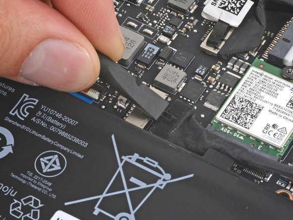

    • Apply a heated iOpener to the battery cable tape for one minute.
    • You can also use a hair dryer—but be careful, as overheating the battery may damage it or cause a fire.

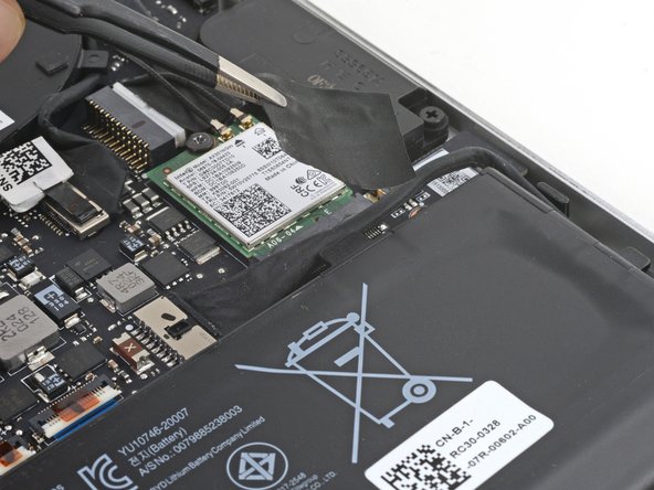

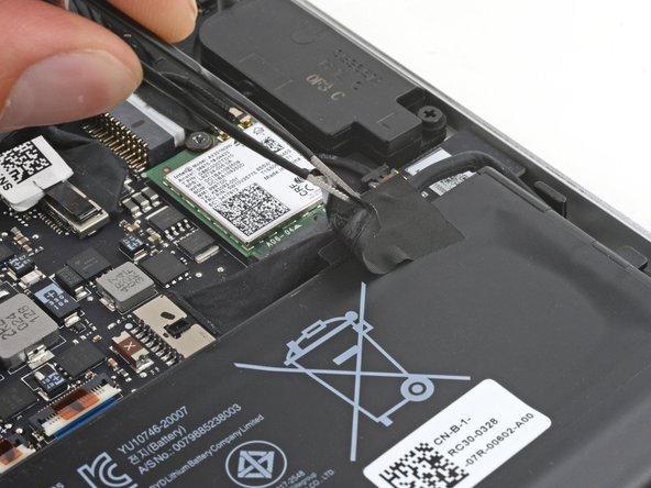

  6. Razer Blade 15" (2020) SSD Replacement, Remove the battery cable tape: crwdns2935265:06crwdnd2935265:01crwdnd2935265:03crwdne2935265:0 Razer Blade 15" (2020) SSD Replacement, Remove the battery cable tape: crwdns2935265:06crwdnd2935265:02crwdnd2935265:03crwdne2935265:0 Razer Blade 15" (2020) SSD Replacement, Remove the battery cable tape: crwdns2935265:06crwdnd2935265:03crwdnd2935265:03crwdne2935265:0
    • Be careful not to damage the battery with your tool.
    • Use blunt nose tweezers or your fingers to peel and remove the battery cable tape.

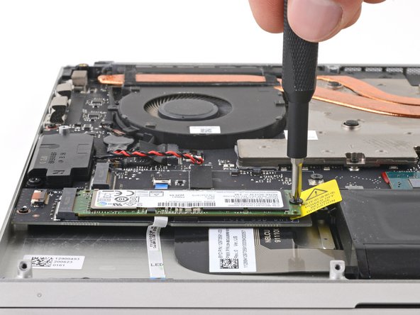

  8. Razer Blade 15" (2020) SSD Replacement, Unfasten the SSD: crwdns2935265:08crwdnd2935265:01crwdnd2935265:03crwdne2935265:0 Razer Blade 15" (2020) SSD Replacement, Unfasten the SSD: crwdns2935265:08crwdnd2935265:02crwdnd2935265:03crwdne2935265:0 Razer Blade 15" (2020) SSD Replacement, Unfasten the SSD: crwdns2935265:08crwdnd2935265:03crwdnd2935265:03crwdne2935265:0
    • Use a Phillips screwdriver to remove the 3.1 mm screw securing the SSD.
    • The SSD will pop up slightly.
  9. Razer Blade 15" (2020) SSD Replacement, Remove the SSD: crwdns2935265:09crwdnd2935265:01crwdnd2935265:03crwdne2935265:0 Razer Blade 15" (2020) SSD Replacement, Remove the SSD: crwdns2935265:09crwdnd2935265:02crwdnd2935265:03crwdne2935265:0 Razer Blade 15" (2020) SSD Replacement, Remove the SSD: crwdns2935265:09crwdnd2935265:03crwdnd2935265:03crwdne2935265:0
    • Pull the SSD straight out of its socket and remove it.
    • During reassembly, insert the SSD at a slight downward angle before lowering it flat to the frame and securing it with its screw.
