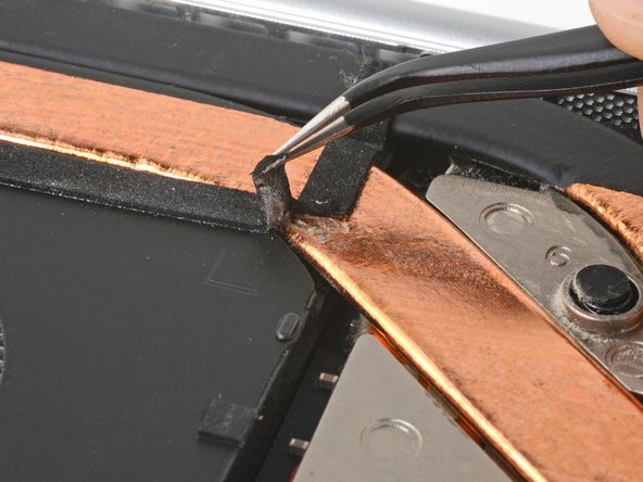

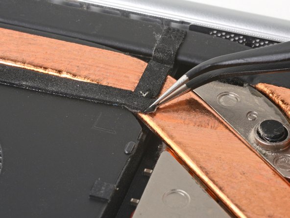

  11. Razer Blade 15" (2020) Right Fan Replacement, Peel up the fan tape: crwdns2935265:011crwdnd2935265:01crwdnd2935265:03crwdne2935265:0 Razer Blade 15" (2020) Right Fan Replacement, Peel up the fan tape: crwdns2935265:011crwdnd2935265:02crwdnd2935265:03crwdne2935265:0 Razer Blade 15" (2020) Right Fan Replacement, Peel up the fan tape: crwdns2935265:011crwdnd2935265:03crwdnd2935265:03crwdne2935265:0
    • Use tweezers to peel the right side of the fan tape from the heatsink.
