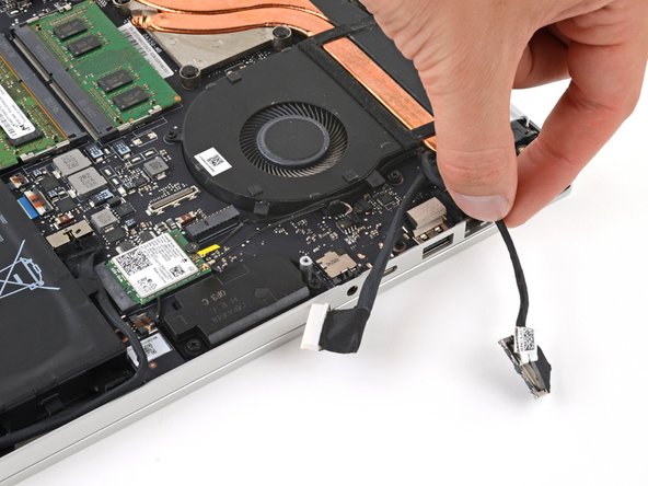

  10. Razer Blade 15" (2020) Left Fan Replacement, Disconnect the screen press connector: crwdns2935265:010crwdnd2935265:01crwdnd2935265:02crwdne2935265:0 Razer Blade 15" (2020) Left Fan Replacement, Disconnect the screen press connector: crwdns2935265:010crwdnd2935265:02crwdnd2935265:02crwdne2935265:0
    • Grab the pull tab on the screen connector.
    • Pull up to disconnect the connector from its socket.
    • During reassembly, align the connector over its socket and press down until it clicks into place.
  11. Razer Blade 15" (2020) Left Fan Replacement, Disconnect the charging port: crwdns2935265:011crwdnd2935265:01crwdnd2935265:03crwdne2935265:0 Razer Blade 15" (2020) Left Fan Replacement, Disconnect the charging port: crwdns2935265:011crwdnd2935265:02crwdnd2935265:03crwdne2935265:0 Razer Blade 15" (2020) Left Fan Replacement, Disconnect the charging port: crwdns2935265:011crwdnd2935265:03crwdnd2935265:03crwdne2935265:0
    • Use the point of your spudger to press on alternating sides of the charging port connector to "walk" it out of its socket.
  12. Razer Blade 15" (2020) Left Fan Replacement, Move the charging cable: crwdns2935265:012crwdnd2935265:01crwdnd2935265:02crwdne2935265:0 Razer Blade 15" (2020) Left Fan Replacement, Move the charging cable: crwdns2935265:012crwdnd2935265:02crwdnd2935265:02crwdne2935265:0
    • Move the charging cable over the right edge of the laptop.

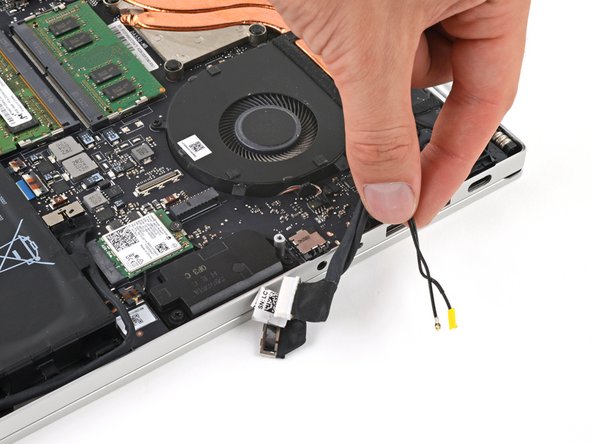

  13. Razer Blade 15" (2020) Left Fan Replacement, Move the screen and antenna cables: crwdns2935265:013crwdnd2935265:01crwdnd2935265:03crwdne2935265:0 Razer Blade 15" (2020) Left Fan Replacement, Move the screen and antenna cables: crwdns2935265:013crwdnd2935265:02crwdnd2935265:03crwdne2935265:0 Razer Blade 15" (2020) Left Fan Replacement, Move the screen and antenna cables: crwdns2935265:013crwdnd2935265:03crwdnd2935265:03crwdne2935265:0
    • Unclip the screen and antenna cables from the fan and move them over the right edge of the laptop.

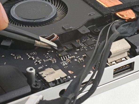

  14. Razer Blade 15" (2020) Left Fan Replacement, Disconnect the left fan: crwdns2935265:014crwdnd2935265:01crwdnd2935265:02crwdne2935265:0 Razer Blade 15" (2020) Left Fan Replacement, Disconnect the left fan: crwdns2935265:014crwdnd2935265:02crwdnd2935265:02crwdne2935265:0
    • Use tweezers or your fingers to grab the rubber sleeve around the left fan cable and pull the connector straight out of its socket.

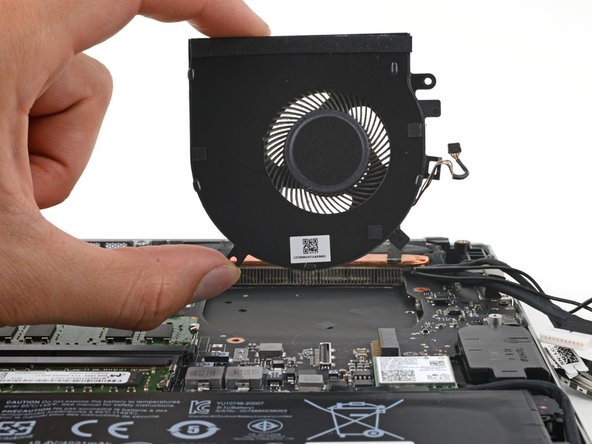

  15. Razer Blade 15" (2020) Left Fan Replacement, Unfasten the left fan: crwdns2935265:015crwdnd2935265:01crwdnd2935265:01crwdne2935265:0
    • Use a Phillips screwdriver to remove the two 6.7 mm screws securing the left fan.
  16. Razer Blade 15" (2020) Left Fan Replacement, Remove the left fan: crwdns2935265:016crwdnd2935265:01crwdnd2935265:02crwdne2935265:0 Razer Blade 15" (2020) Left Fan Replacement, Remove the left fan: crwdns2935265:016crwdnd2935265:02crwdnd2935265:02crwdne2935265:0
    • Remove the left fan.
