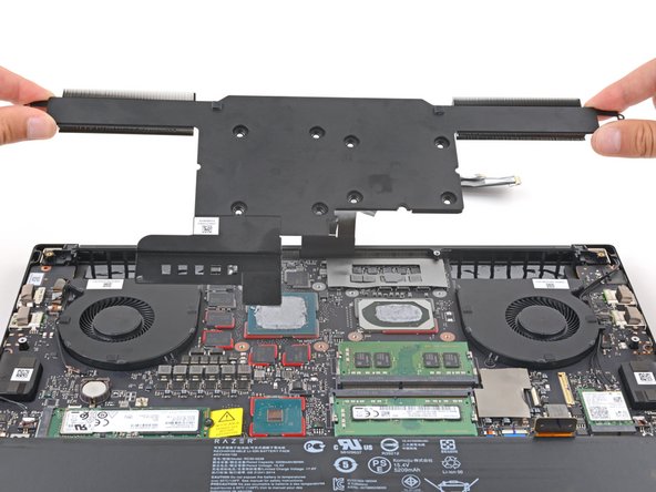

  22. Razer Blade 15 Advanced Model (Early 2020) Heatsink Replacement, Separate the heatsink: crwdns2935265:022crwdnd2935265:01crwdnd2935265:03crwdne2935265:0 Razer Blade 15 Advanced Model (Early 2020) Heatsink Replacement, Separate the heatsink: crwdns2935265:022crwdnd2935265:02crwdnd2935265:03crwdne2935265:0 Razer Blade 15 Advanced Model (Early 2020) Heatsink Replacement, Separate the heatsink: crwdns2935265:022crwdnd2935265:03crwdnd2935265:03crwdne2935265:0
    • Use strong, steady pressure to release the heatsink from the motherboard in the next two steps.
    • Insert the flat end of a spudger between the top edge of the heatsink and frame.
    • Pry the heatsink up at different points along the top edge to release it from the motherboard.
    • If the heatsink won't budge at all, use a hair dryer to warm the heatsink and soften the thermal pads.
  23. Razer Blade 15 Advanced Model (Early 2020) Heatsink Replacement: crwdns2935265:023crwdnd2935265:01crwdnd2935265:02crwdne2935265:0 Razer Blade 15 Advanced Model (Early 2020) Heatsink Replacement: crwdns2935265:023crwdnd2935265:02crwdnd2935265:02crwdne2935265:0
    • Use the flat end of a spudger to lift (not pry) the heatsink at different points along its edges until the heatsink completely detaches from the motherboard.
    • Be careful not to scrape off any surface-mounted components when putting the spudger under the heatsink.
  24. Razer Blade 15 Advanced Model (Early 2020) Heatsink Replacement, Remove the heatsink: crwdns2935265:024crwdnd2935265:01crwdnd2935265:02crwdne2935265:0 Razer Blade 15 Advanced Model (Early 2020) Heatsink Replacement, Remove the heatsink: crwdns2935265:024crwdnd2935265:02crwdnd2935265:02crwdne2935265:0
    • Remove the heatsink.
