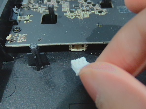

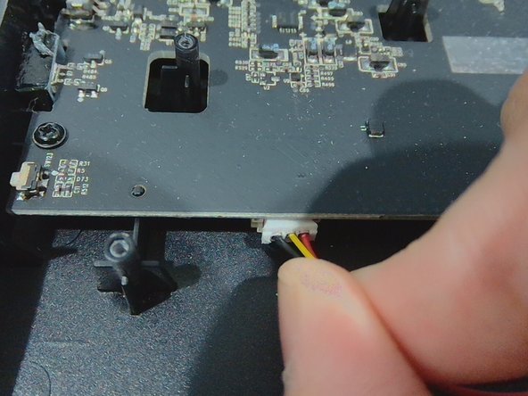

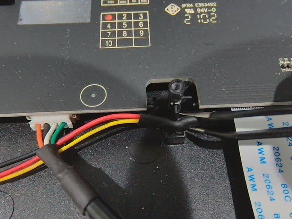

  10. Razer Blackwidow V3 Pro Battery Replacement, Battery Connector.: crwdns2935265:010crwdnd2935265:01crwdnd2935265:03crwdne2935265:0 Razer Blackwidow V3 Pro Battery Replacement, Battery Connector.: crwdns2935265:010crwdnd2935265:02crwdnd2935265:03crwdne2935265:0 Razer Blackwidow V3 Pro Battery Replacement, Battery Connector.: crwdns2935265:010crwdnd2935265:03crwdnd2935265:03crwdne2935265:0
    • Remove the battery connector from the motherboard.
    • You may need to wiggle the connector in order to remove it.
    • During reassembly, make sure to insert the connector back the right way, or you may risk damaging the connector.

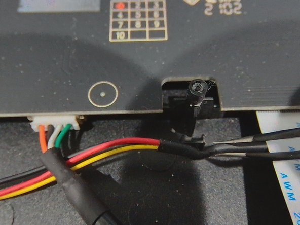

  11. Razer Blackwidow V3 Pro Battery Replacement, Removing the wire: crwdns2935265:011crwdnd2935265:01crwdnd2935265:03crwdne2935265:0 Razer Blackwidow V3 Pro Battery Replacement, Removing the wire: crwdns2935265:011crwdnd2935265:02crwdnd2935265:03crwdne2935265:0 Razer Blackwidow V3 Pro Battery Replacement, Removing the wire: crwdns2935265:011crwdnd2935265:03crwdnd2935265:03crwdne2935265:0
    • Use your hands or tweezers to remove the wires from the mount.

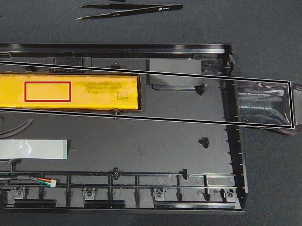

  12. Razer Blackwidow V3 Pro Battery Replacement, Battery Information: crwdns2935265:012crwdnd2935265:01crwdnd2935265:01crwdne2935265:0
    • The battery is held on with adhesive in the middle, as highlighted. direct your iOpener / heating device, and your tools in this general area to remove the battery.
  13. Razer Blackwidow V3 Pro Battery Replacement, Heating instructions: crwdns2935265:013crwdnd2935265:01crwdnd2935265:02crwdne2935265:0 Razer Blackwidow V3 Pro Battery Replacement, Heating instructions: crwdns2935265:013crwdnd2935265:02crwdnd2935265:02crwdne2935265:0
    • Heat and place an iOpener or other heating device (Hair Dryer / Heat Gun) under the general location of the battery's adhesive.
    • Don't apply too much heat to the battery, use the iOpener for about a minute on the battery maximum
    • For your reference, the red box is the general location of where the adhesive of the battery is.
    • For your reference, the black box is where the iOpener is.

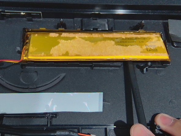

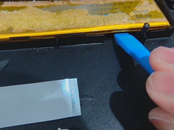

  14. Razer Blackwidow V3 Pro Battery Replacement, Adhesive cutting: crwdns2935265:014crwdnd2935265:01crwdnd2935265:02crwdne2935265:0 Razer Blackwidow V3 Pro Battery Replacement, Adhesive cutting: crwdns2935265:014crwdnd2935265:02crwdnd2935265:02crwdne2935265:0
    • Go slow, and reheat if the adhesive is still too sticky (Just don't overheat the battery). Do not puncture the battery, or you risk a dangerous situation. If you are using a heat gun or hair dryer, plan in case of a fire.
    • Use a spudger to cut the adhesive, or if you have a suction cup, you can pull the battery directly up without risking puncturing the battery.
    • Avoid bending the battery.

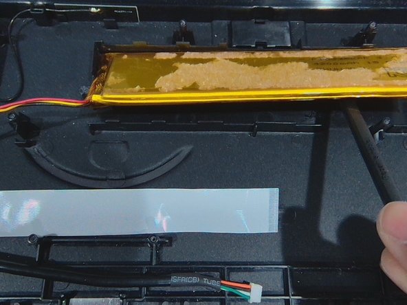

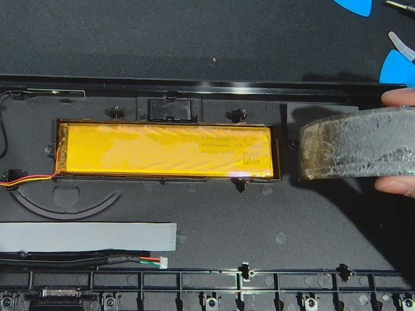

  15. Razer Blackwidow V3 Pro Battery Replacement, (iFixit opening tool only) Lifting the battery out: crwdns2935265:015crwdnd2935265:01crwdnd2935265:02crwdne2935265:0 Razer Blackwidow V3 Pro Battery Replacement, (iFixit opening tool only) Lifting the battery out: crwdns2935265:015crwdnd2935265:02crwdnd2935265:02crwdne2935265:0
    • Use an iFixit opening tool (or flat end of your spudger) to lift the battery up.
    • Prevent bending of the battery and only apply pressure periodically. Reheat if needed.

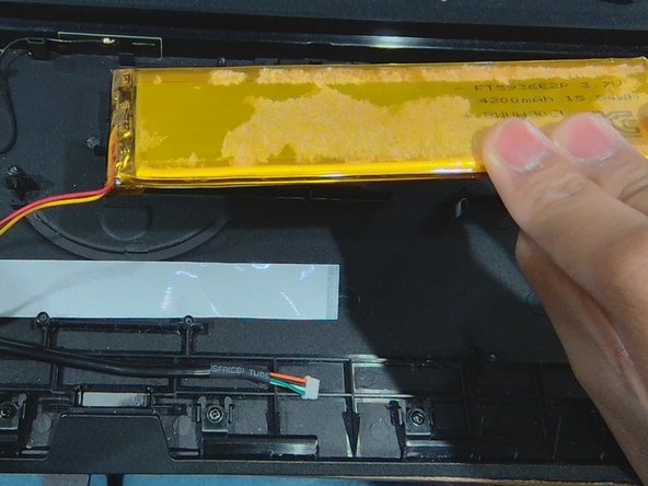

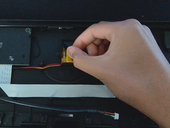

  16. Razer Blackwidow V3 Pro Battery Replacement, Remove the battery: crwdns2935265:016crwdnd2935265:01crwdnd2935265:03crwdne2935265:0 Razer Blackwidow V3 Pro Battery Replacement, Remove the battery: crwdns2935265:016crwdnd2935265:02crwdnd2935265:03crwdne2935265:0 Razer Blackwidow V3 Pro Battery Replacement, Remove the battery: crwdns2935265:016crwdnd2935265:03crwdnd2935265:03crwdne2935265:0
    • Remove the battery carefully.
Recycle responsibly, it may be the law in your area.
Make sure to calibrate your battery.
