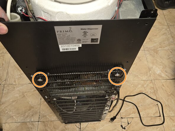

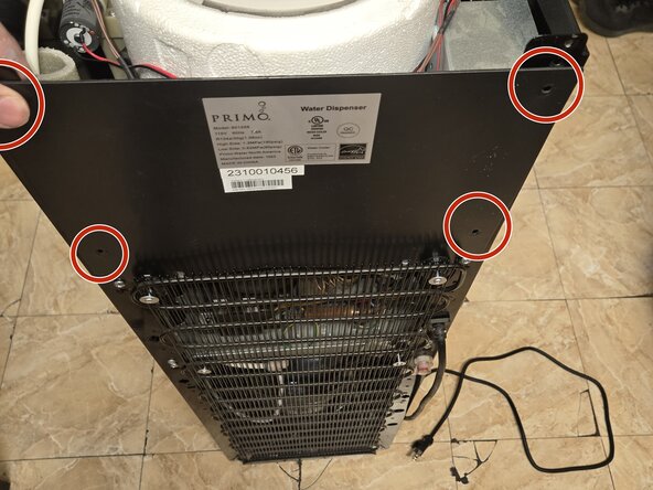

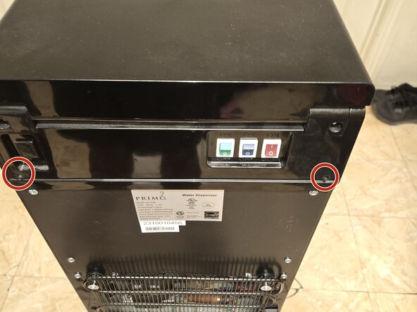

    • Remove six 9 mm Phillips screws from the back of the water cooler to detach the back panels.
  2. Primo 601258-C Temperature Sensor Replacement: crwdns2935265:02crwdnd2935265:01crwdnd2935265:02crwdne2935265:0 Primo 601258-C Temperature Sensor Replacement: crwdns2935265:02crwdnd2935265:02crwdnd2935265:02crwdne2935265:0
    • Loosen the two 25 mm Phillips screws securing the radiator, allowing you to remove the backing.

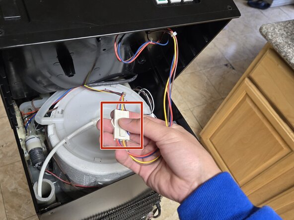

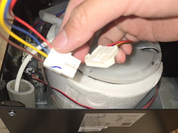

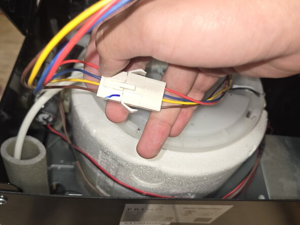

    • Remove the top of the cooler.
    • Press the tab and unplug the temperature switch from the lid.

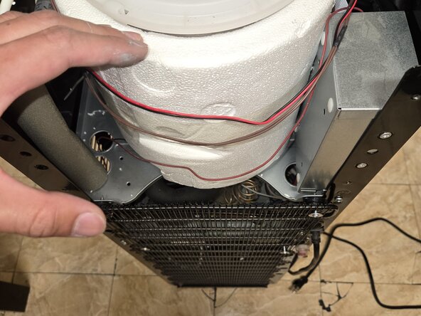

  4. Primo 601258-C Temperature Sensor Replacement: crwdns2935265:04crwdnd2935265:01crwdnd2935265:02crwdne2935265:0 Primo 601258-C Temperature Sensor Replacement: crwdns2935265:04crwdnd2935265:02crwdnd2935265:02crwdne2935265:0
    • Remove the back panel.

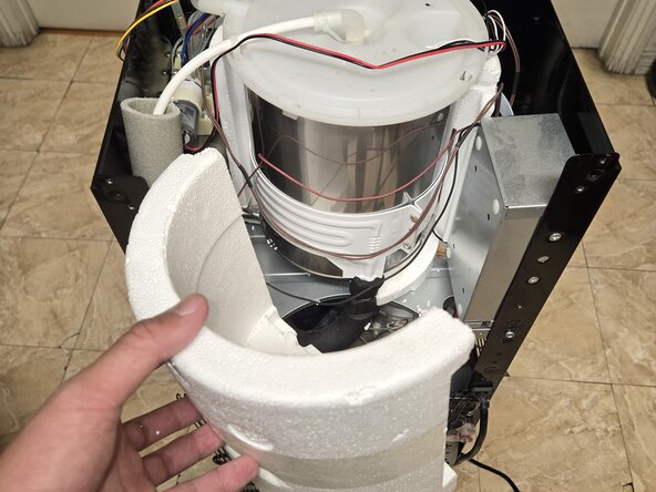

  5. Primo 601258-C Temperature Sensor Replacement: crwdns2935265:05crwdnd2935265:01crwdnd2935265:02crwdne2935265:0 Primo 601258-C Temperature Sensor Replacement: crwdns2935265:05crwdnd2935265:02crwdnd2935265:02crwdne2935265:0
    • Carefully remove the insulating foam.
    • It can easily break apart.

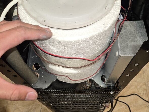

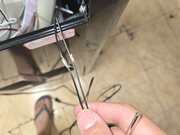

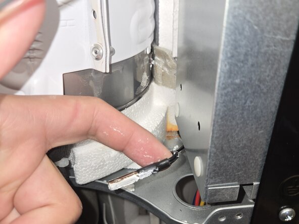

  6. Primo 601258-C Temperature Sensor Replacement: crwdns2935265:06crwdnd2935265:01crwdnd2935265:02crwdne2935265:0 Primo 601258-C Temperature Sensor Replacement: crwdns2935265:06crwdnd2935265:02crwdnd2935265:02crwdne2935265:0
    • Remove faulty temperature sensor.
    • Removing the old sensor requires moving some of the existing insulation tape.

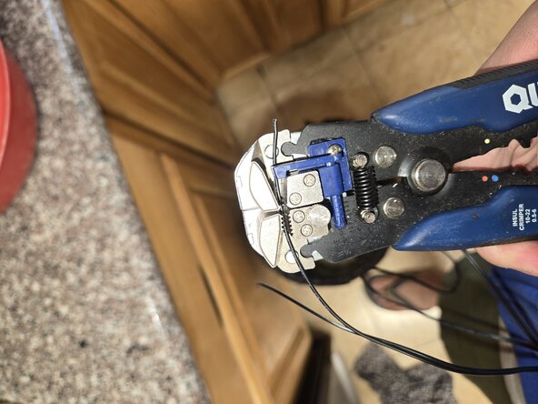

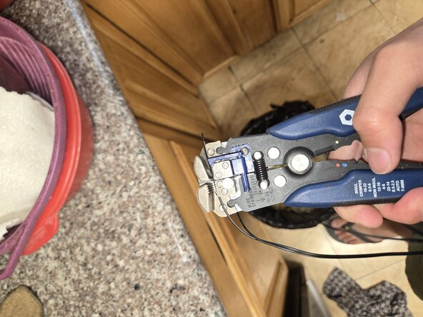

    • Use a wire stripper to strip the wire on both the old and new temperature sensors.
    • Here is a guide for Wire Stripping.

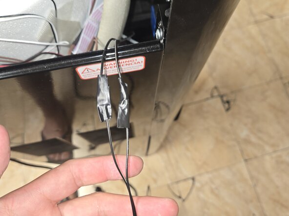

    • Twist the ends of the wires stripped wires together and wrap them with electrical tape.
    • Alternatively, you can solder the wires and secure them with heat-shrink tubing. For tips on soldering and using heat shrink tubing, refer to these guides: How to Solder Wires Together and How to Use Heat Shrink Tubing.

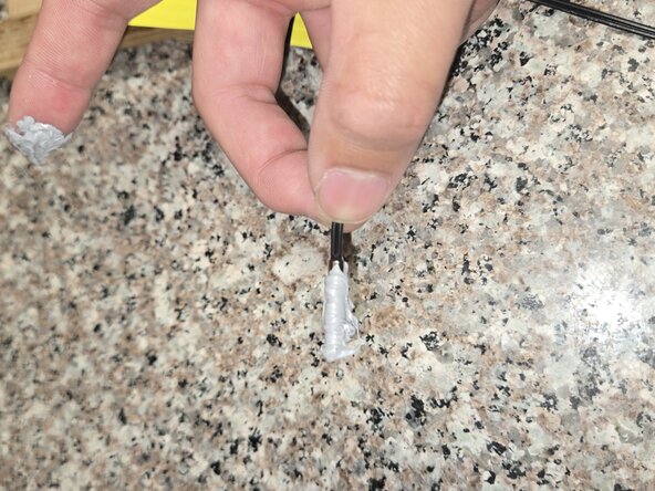

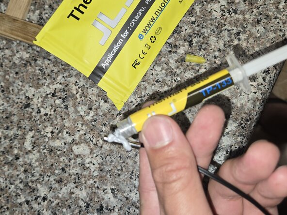

    • Apply thermal paste to the new temperature sensor.

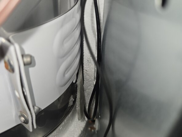

    • Insert the newly connected thermal paste-covered sensor into the slot where the old sensor was.
    • Place the old insulation back.

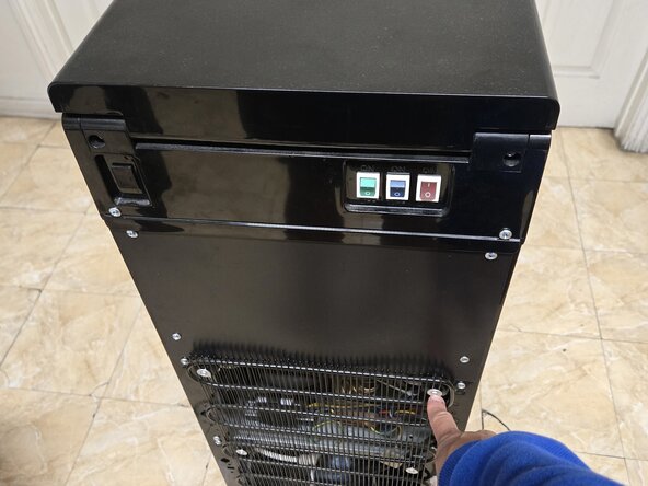

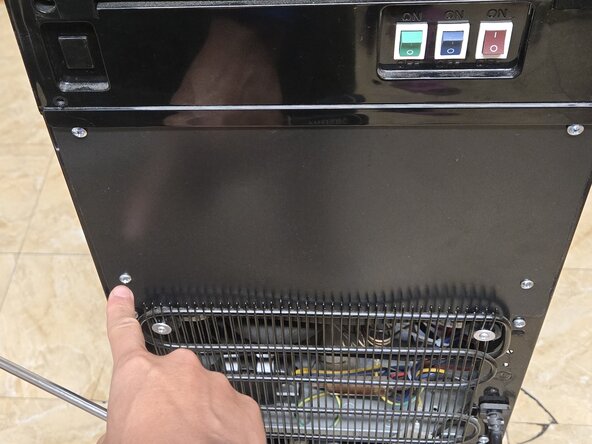

    • Reattach the backing and secure it with four 9 mm Phillips screws.
    • Tighten the two 25 mm Phillips screws.
  12. Primo 601258-C Temperature Sensor Replacement: crwdns2935265:012crwdnd2935265:01crwdnd2935265:03crwdne2935265:0 Primo 601258-C Temperature Sensor Replacement: crwdns2935265:012crwdnd2935265:02crwdnd2935265:03crwdne2935265:0 Primo 601258-C Temperature Sensor Replacement: crwdns2935265:012crwdnd2935265:03crwdnd2935265:03crwdne2935265:0
    • Reconnect the temperature control.
    • Secure the top panel with two 9 mm Phillips screws.
