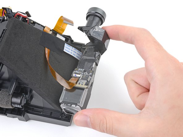

  35. Polaroid I-2 Lens Assembly Replacement, Remove the lidar sensor bracket: crwdns2935265:035crwdnd2935265:01crwdnd2935265:03crwdne2935265:0 Polaroid I-2 Lens Assembly Replacement, Remove the lidar sensor bracket: crwdns2935265:035crwdnd2935265:02crwdnd2935265:03crwdne2935265:0 Polaroid I-2 Lens Assembly Replacement, Remove the lidar sensor bracket: crwdns2935265:035crwdnd2935265:03crwdnd2935265:03crwdne2935265:0
    • The lidar sensor bracket is secured with two alignment pegs that fit into cutouts on the bracket.
    • Use tweezers, or your fingers, to push the lidar sensor bracket toward the lidar sensor and off its alignment pegs.
    • Remove the lidar sensor bracket.

  42. Polaroid I-2 Lens Assembly Replacement, Reposition the lidar sensor: crwdns2935265:042crwdnd2935265:01crwdnd2935265:03crwdne2935265:0 Polaroid I-2 Lens Assembly Replacement, Reposition the lidar sensor: crwdns2935265:042crwdnd2935265:02crwdnd2935265:03crwdne2935265:0 Polaroid I-2 Lens Assembly Replacement, Reposition the lidar sensor: crwdns2935265:042crwdnd2935265:03crwdnd2935265:03crwdne2935265:0
    • Pull the lidar sensor up and out of its slot in the frame.
    • Rotate the sensor so its exposed board is facing upward and let it hang over its slot.
  43. Polaroid I-2 Lens Assembly Replacement, Remove the lidar sensor: crwdns2935265:043crwdnd2935265:01crwdnd2935265:03crwdne2935265:0 Polaroid I-2 Lens Assembly Replacement, Remove the lidar sensor: crwdns2935265:043crwdnd2935265:02crwdnd2935265:03crwdne2935265:0 Polaroid I-2 Lens Assembly Replacement, Remove the lidar sensor: crwdns2935265:043crwdnd2935265:03crwdnd2935265:03crwdne2935265:0
    • Use the point of a spudger to "walk" the lidar sensor cable connector out of its socket until it's disconnected.
    • Remove the lidar sensor.

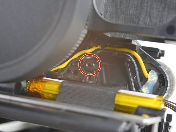

  54. Polaroid I-2 Lens Assembly Replacement, Disassembly information: crwdns2935265:054crwdnd2935265:01crwdnd2935265:03crwdne2935265:0 Polaroid I-2 Lens Assembly Replacement, Disassembly information: crwdns2935265:054crwdnd2935265:02crwdnd2935265:03crwdne2935265:0 Polaroid I-2 Lens Assembly Replacement, Disassembly information: crwdns2935265:054crwdnd2935265:03crwdnd2935265:03crwdne2935265:0
    • The lens assembly slots against a peg on the frame. Removing the assembly requires pulling it forward enough for the peg to slide out of the cutout.
    • The capacitor will brush against the battery during this procedure. Don't force the lens assembly out to avoid puncturing the battery.

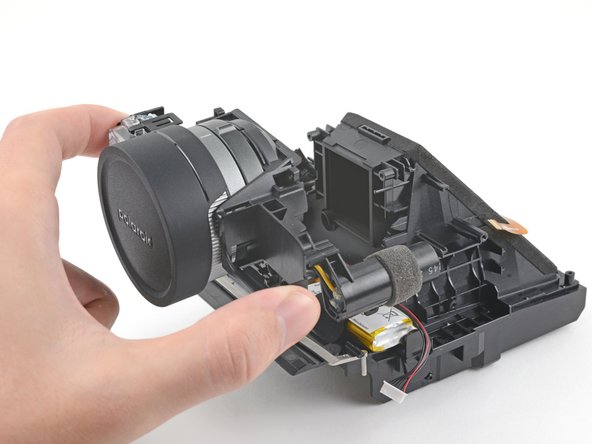

  55. Polaroid I-2 Lens Assembly Replacement, Remove the lens assembly: crwdns2935265:055crwdnd2935265:01crwdnd2935265:03crwdne2935265:0 Polaroid I-2 Lens Assembly Replacement, Remove the lens assembly: crwdns2935265:055crwdnd2935265:02crwdnd2935265:03crwdne2935265:0 Polaroid I-2 Lens Assembly Replacement, Remove the lens assembly: crwdns2935265:055crwdnd2935265:03crwdnd2935265:03crwdne2935265:0
    • Pull the lens assembly toward the front of the camera until it slides out of its alignment peg.
    • Rotate the left side of the lens assembly up to separate the capacitor from its slot in the frame.
    • If you're having trouble, try gently rocking the lens assembly side-to-side to flex the plastic in the frame.
    • During reassembly, make sure the capacitor is in its slot before realigning the lens assembly on its peg.
  56. Polaroid I-2 Lens Assembly Replacement: crwdns2935265:056crwdnd2935265:01crwdnd2935265:03crwdne2935265:0 Polaroid I-2 Lens Assembly Replacement: crwdns2935265:056crwdnd2935265:02crwdnd2935265:03crwdne2935265:0 Polaroid I-2 Lens Assembly Replacement: crwdns2935265:056crwdnd2935265:03crwdnd2935265:03crwdne2935265:0
    • Pull the lens assembly out of its slot in the frame and remove it.
