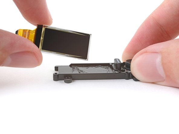

  28. Polaroid I-2 Display Replacement, Heat the display: crwdns2935265:028crwdnd2935265:01crwdnd2935265:02crwdne2935265:0 Polaroid I-2 Display Replacement, Heat the display: crwdns2935265:028crwdnd2935265:02crwdnd2935265:02crwdne2935265:0
    • The display is secured with light adhesive.
    • Heat an iOpener and apply it to the top of the display for two minutes.
    • You can also use a hair dryer, heat gun, or hot plate—but extreme heat can warp the plastic, so proceed with care.
  29. Polaroid I-2 Display Replacement, Separate the adhesive: crwdns2935265:029crwdnd2935265:01crwdnd2935265:03crwdne2935265:0 Polaroid I-2 Display Replacement, Separate the adhesive: crwdns2935265:029crwdnd2935265:02crwdnd2935265:03crwdne2935265:0 Polaroid I-2 Display Replacement, Separate the adhesive: crwdns2935265:029crwdnd2935265:03crwdnd2935265:03crwdne2935265:0
    • Insert an opening pick under the display, near its cable.
    • Slide an opening pick under the display to separate the adhesive.
  30. Polaroid I-2 Display Replacement: crwdns2935265:030crwdnd2935265:01crwdnd2935265:03crwdne2935265:0 Polaroid I-2 Display Replacement: crwdns2935265:030crwdnd2935265:02crwdnd2935265:03crwdne2935265:0 Polaroid I-2 Display Replacement: crwdns2935265:030crwdnd2935265:03crwdnd2935265:03crwdne2935265:0
    • Pry up with the opening pick to separate any remaining adhesive.
    • Remove the display.
