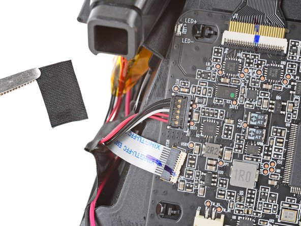

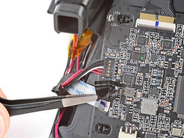

  12. Polaroid Flip Battery Replacement, Disconnect the battery: crwdns2935265:012crwdnd2935265:01crwdnd2935265:03crwdne2935265:0 Polaroid Flip Battery Replacement, Disconnect the battery: crwdns2935265:012crwdnd2935265:02crwdnd2935265:03crwdne2935265:0 Polaroid Flip Battery Replacement, Disconnect the battery: crwdns2935265:012crwdnd2935265:03crwdnd2935265:03crwdne2935265:0
    • Use tweezers or your fingers to remove the piece of tape covering the battery connector.
    • Set the tape aside—you'll need it for reassembly.

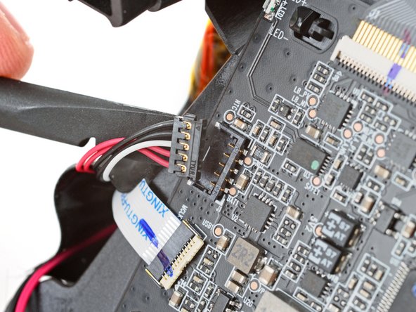

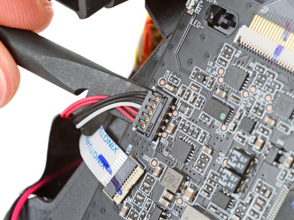

  13. Polaroid Flip Battery Replacement: crwdns2935265:013crwdnd2935265:01crwdnd2935265:03crwdne2935265:0 Polaroid Flip Battery Replacement: crwdns2935265:013crwdnd2935265:02crwdnd2935265:03crwdne2935265:0 Polaroid Flip Battery Replacement: crwdns2935265:013crwdnd2935265:03crwdnd2935265:03crwdne2935265:0
    • Gently slide the flat end of a spudger under the battery connector and lift it out of the socket.
    • Don't lift on the cables themselves, only on the connector. Otherwise, you may damage the wires.

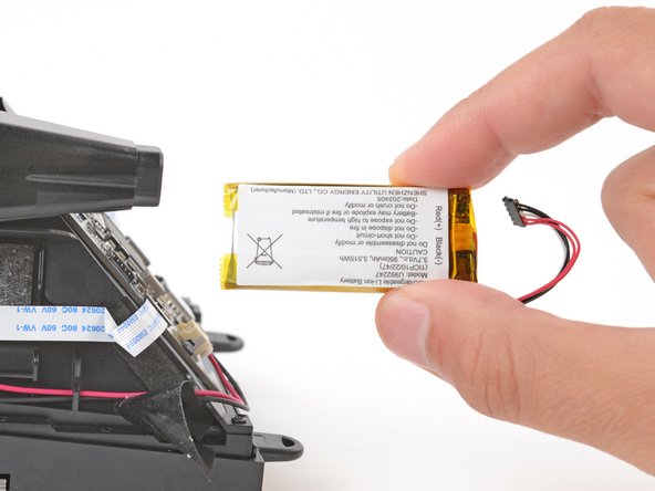

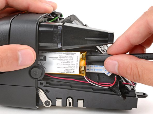

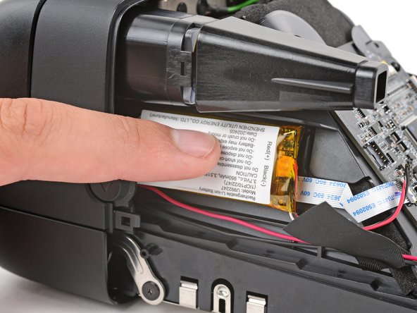

  15. Polaroid Flip Battery Replacement, Separate the battery adhesive: crwdns2935265:015crwdnd2935265:01crwdnd2935265:03crwdne2935265:0 Polaroid Flip Battery Replacement, Separate the battery adhesive: crwdns2935265:015crwdnd2935265:02crwdnd2935265:03crwdne2935265:0 Polaroid Flip Battery Replacement, Separate the battery adhesive: crwdns2935265:015crwdnd2935265:03crwdnd2935265:03crwdne2935265:0
    • A piece of foam tape secures the battery to the camera.
    • Slide the flat end of a spudger completely under the battery and lift to separate the tape, making sure not to push on the white cable under the battery.
    • Be very careful not to puncture or deform the battery.
    • Remove the battery.

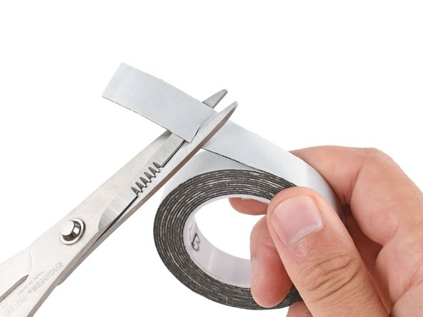

  16. Polaroid Flip Battery Replacement, Reassembly information: crwdns2935265:016crwdnd2935265:01crwdnd2935265:03crwdne2935265:0 Polaroid Flip Battery Replacement, Reassembly information: crwdns2935265:016crwdnd2935265:02crwdnd2935265:03crwdne2935265:0 Polaroid Flip Battery Replacement, Reassembly information: crwdns2935265:016crwdnd2935265:03crwdnd2935265:03crwdne2935265:0
    • If the battery tape stayed intact, you can reuse it and skip this step. Otherwise, follow this step to remove and replace the tape.
    • Use a spudger and tweezers to peel up and remove the old piece of foam tape.
    • Cut a new piece of foam tape approximately 0.5 x 1.5 inches (1.5 x 4 cm).
    • Apply the new piece of tape above (not on) the white ribbon cable, where the old tape was.
    • Reconnect the battery by aligning the connector head over its socket and pressing it into place with your finger—you should feel the connector slide into the socket. Don't try to force the connector into place. If it doesn't connect easily, reposition the connector and try again.
    • Reconnecting the battery ensures it's properly oriented when securing it with the tape.
    • Press the battery into place on the tape to secure it.
