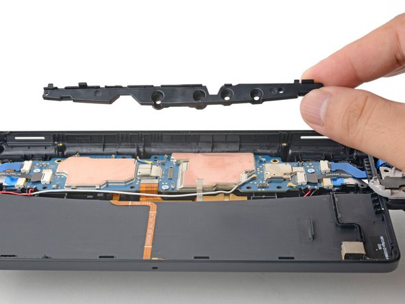

  43. PlayStation Portal USB-C and Headphone Ports Replacement, Loosen the joystick brackets: crwdns2935265:043crwdnd2935265:01crwdnd2935265:02crwdne2935265:0 PlayStation Portal USB-C and Headphone Ports Replacement, Loosen the joystick brackets: crwdns2935265:043crwdnd2935265:02crwdnd2935265:02crwdne2935265:0
    • Use a Phillips screwdriver to remove the four 6.5 mm‑long screws (two on each side) securing the two joystick brackets to the Portal.
    • These screws can be tight. Brace the Portal with your hand and apply strong pressure to the screwdriver. You can also try using a JIS #00 screwdriver to get a better grip on these screws.
  44. PlayStation Portal USB-C and Headphone Ports Replacement: crwdns2935265:044crwdnd2935265:01crwdnd2935265:02crwdne2935265:0 PlayStation Portal USB-C and Headphone Ports Replacement: crwdns2935265:044crwdnd2935265:02crwdnd2935265:02crwdne2935265:0
    • Each joystick bracket is still attached to the Portal by a delicate flex cable. Be careful not to strain the cable as you move the bracket.
    • Carefully flip the right bracket over so that it no longer blocks the edge of the screen.
    • Repeat the process for the left bracket.
  45. PlayStation Portal USB-C and Headphone Ports Replacement: crwdns2935265:045crwdnd2935265:01crwdnd2935265:02crwdne2935265:0 PlayStation Portal USB-C and Headphone Ports Replacement: crwdns2935265:045crwdnd2935265:02crwdnd2935265:02crwdne2935265:0
    • Use tape to secure the two brackets to the frame so they don't block the screen.
    • Make sure the delicate flex cables aren't strained when the brackets are taped down.

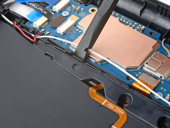

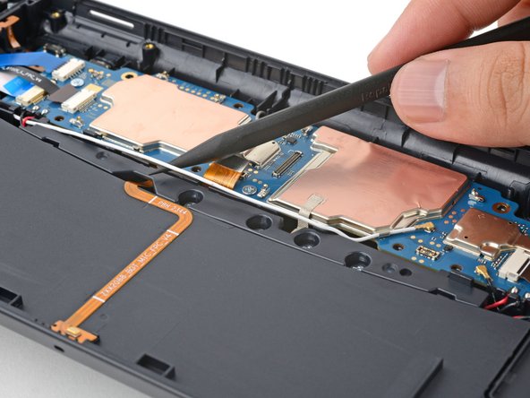

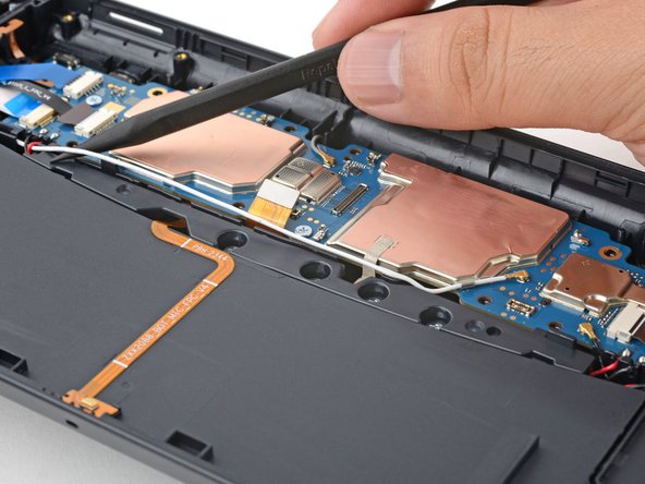

  71. PlayStation Portal USB-C and Headphone Ports Replacement, Remove the port bracket: crwdns2935265:071crwdnd2935265:01crwdnd2935265:03crwdne2935265:0 PlayStation Portal USB-C and Headphone Ports Replacement, Remove the port bracket: crwdns2935265:071crwdnd2935265:02crwdnd2935265:03crwdne2935265:0 PlayStation Portal USB-C and Headphone Ports Replacement, Remove the port bracket: crwdns2935265:071crwdnd2935265:03crwdnd2935265:03crwdne2935265:0
    • Use the point of a spudger to lift the white antenna cable out of its groove along the bottom edge of the motherboard.

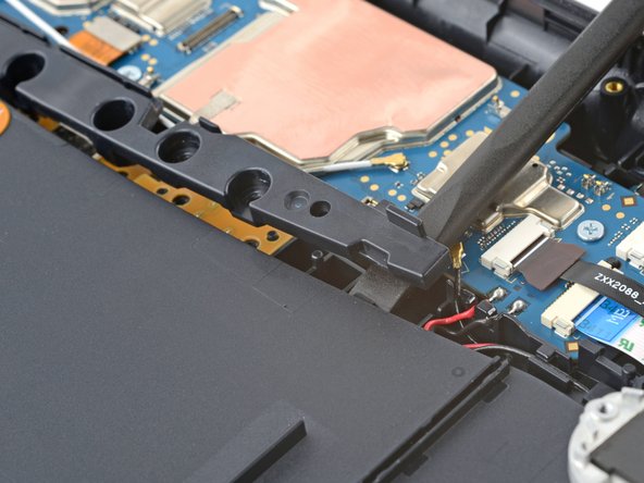

  72. PlayStation Portal USB-C and Headphone Ports Replacement: crwdns2935265:072crwdnd2935265:01crwdnd2935265:01crwdne2935265:0
    • Use a Phillips screwdriver to remove the four 6.5 mm‑long screws securing the port bracket to the frame.
  73. PlayStation Portal USB-C and Headphone Ports Replacement: crwdns2935265:073crwdnd2935265:01crwdnd2935265:03crwdne2935265:0 PlayStation Portal USB-C and Headphone Ports Replacement: crwdns2935265:073crwdnd2935265:02crwdnd2935265:03crwdne2935265:0 PlayStation Portal USB-C and Headphone Ports Replacement: crwdns2935265:073crwdnd2935265:03crwdnd2935265:03crwdne2935265:0
    • Insert the flat edge of a spudger into the top edge of the port bracket, near the left corner.
    • Pry up to release the clips securing the bracket.
    • Repeat the procedure near the right edge of the bracket to fully unclip the port bracket.
  74. PlayStation Portal USB-C and Headphone Ports Replacement: crwdns2935265:074crwdnd2935265:01crwdnd2935265:02crwdne2935265:0 PlayStation Portal USB-C and Headphone Ports Replacement: crwdns2935265:074crwdnd2935265:02crwdnd2935265:02crwdne2935265:0
    • Lift and remove the port bracket.

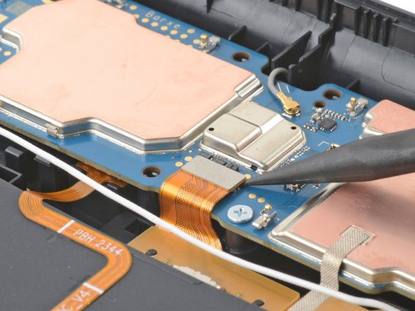

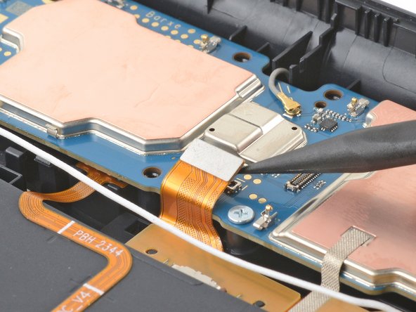

  75. PlayStation Portal USB-C and Headphone Ports Replacement, Loosen the ports board: crwdns2935265:075crwdnd2935265:01crwdnd2935265:03crwdne2935265:0 PlayStation Portal USB-C and Headphone Ports Replacement, Loosen the ports board: crwdns2935265:075crwdnd2935265:02crwdnd2935265:03crwdne2935265:0 PlayStation Portal USB-C and Headphone Ports Replacement, Loosen the ports board: crwdns2935265:075crwdnd2935265:03crwdnd2935265:03crwdne2935265:0
    • Use the point of a spudger to pry up and disconnect the ports board connector.

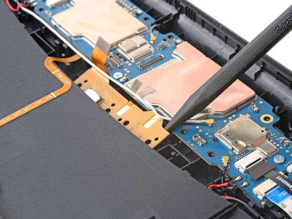

  76. PlayStation Portal USB-C and Headphone Ports Replacement: crwdns2935265:076crwdnd2935265:01crwdnd2935265:02crwdne2935265:0 PlayStation Portal USB-C and Headphone Ports Replacement: crwdns2935265:076crwdnd2935265:02crwdnd2935265:02crwdne2935265:0
    • Insert the point of a spudger under the conductive tape bridging the ports board to the motherboard.
    • Gently lift the tape up to separate it from the ports board.
    • The tape helps mitigate EMI (electromagnetic interference). If you break it during repair, it's not a big deal—the Portal will still function.
    • During reassembly, press the tape back onto the ports board.

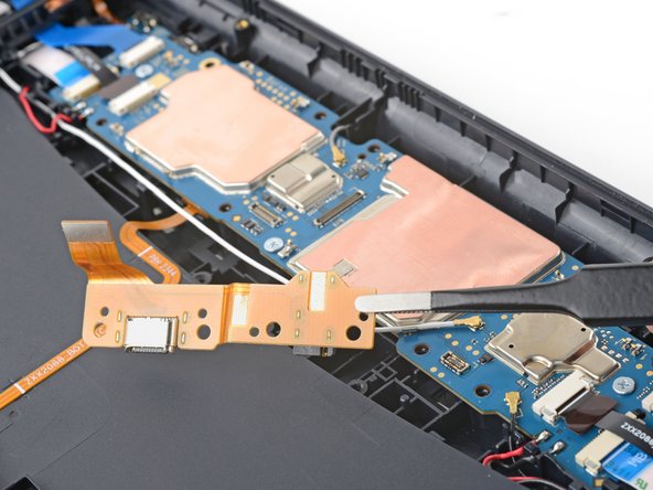

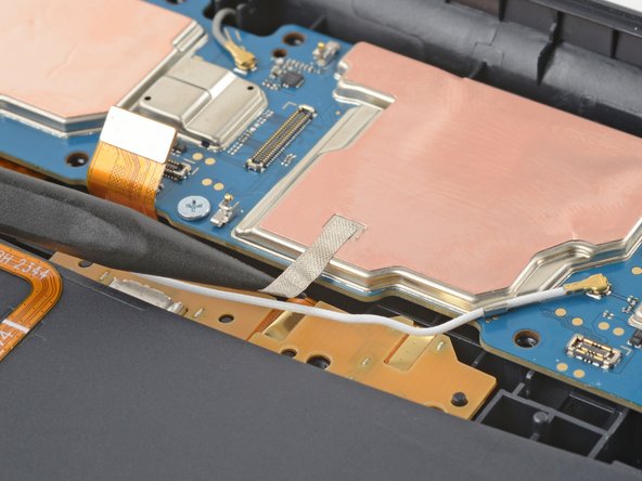

  77. PlayStation Portal USB-C and Headphone Ports Replacement: crwdns2935265:077crwdnd2935265:01crwdnd2935265:02crwdne2935265:0 PlayStation Portal USB-C and Headphone Ports Replacement: crwdns2935265:077crwdnd2935265:02crwdnd2935265:02crwdne2935265:0
    • Insert the point of a spudger under the top-right corner of the ports board and pry up to loosen it.
  78. PlayStation Portal USB-C and Headphone Ports Replacement: crwdns2935265:078crwdnd2935265:01crwdnd2935265:02crwdne2935265:0 PlayStation Portal USB-C and Headphone Ports Replacement: crwdns2935265:078crwdnd2935265:02crwdnd2935265:02crwdne2935265:0
    • Remove the ports board.
For optimal performance, after completing this guide, calibrate your newly installed battery.
