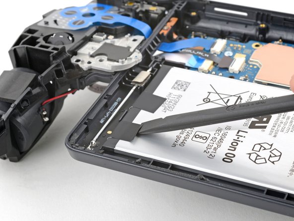

  43. PlayStation Portal Battery Replacement, Loosen the joystick brackets: crwdns2935265:043crwdnd2935265:01crwdnd2935265:02crwdne2935265:0 PlayStation Portal Battery Replacement, Loosen the joystick brackets: crwdns2935265:043crwdnd2935265:02crwdnd2935265:02crwdne2935265:0
    • Use a Phillips screwdriver to remove the four 6.5 mm‑long screws (two on each side) securing the two joystick brackets to the Portal.
    • These screws can be tight. Brace the Portal with your hand and apply strong pressure to the screwdriver. You can also try using a JIS #00 screwdriver to get a better grip on these screws.
  44. PlayStation Portal Battery Replacement: crwdns2935265:044crwdnd2935265:01crwdnd2935265:02crwdne2935265:0 PlayStation Portal Battery Replacement: crwdns2935265:044crwdnd2935265:02crwdnd2935265:02crwdne2935265:0
    • Each joystick bracket is still attached to the Portal by a delicate flex cable. Be careful not to strain the cable as you move the bracket.
    • Carefully flip the right bracket over so that it no longer blocks the edge of the screen.
    • Repeat the process for the left bracket.
  45. PlayStation Portal Battery Replacement: crwdns2935265:045crwdnd2935265:01crwdnd2935265:02crwdne2935265:0 PlayStation Portal Battery Replacement: crwdns2935265:045crwdnd2935265:02crwdnd2935265:02crwdne2935265:0
    • Use tape to secure the two brackets to the frame so they don't block the screen.
    • Make sure the delicate flex cables aren't strained when the brackets are taped down.

  66. PlayStation Portal Battery Replacement, Remove the stretch-release adhesive strips: crwdns2935265:066crwdnd2935265:01crwdnd2935265:03crwdne2935265:0 PlayStation Portal Battery Replacement, Remove the stretch-release adhesive strips: crwdns2935265:066crwdnd2935265:02crwdnd2935265:03crwdne2935265:0 PlayStation Portal Battery Replacement, Remove the stretch-release adhesive strips: crwdns2935265:066crwdnd2935265:03crwdnd2935265:03crwdne2935265:0
    • The battery is secured using four stretch-release adhesive strips. Each strip ends with a black pull-tab along the outer edges of the battery.
    • Use the flat edge of a spudger or your fingers to carefully peel up a black pull-tab from the top of the battery.
    • Be careful not to puncture the battery with your tool.
  67. PlayStation Portal Battery Replacement: crwdns2935265:067crwdnd2935265:01crwdnd2935265:02crwdne2935265:0 PlayStation Portal Battery Replacement: crwdns2935265:067crwdnd2935265:02crwdnd2935265:02crwdne2935265:0
    • Peel up the remaining three black pull-tabs from the top of the battery.
