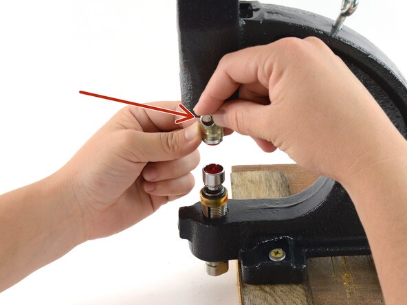

    6. Plastic Snap Installation Using a Hand Press, Prepare the snap dies: crwdns2935265:06crwdnd2935265:01crwdnd2935265:03crwdne2935265:0 Plastic Snap Installation Using a Hand Press, Prepare the snap dies: crwdns2935265:06crwdnd2935265:02crwdnd2935265:03crwdne2935265:0 Plastic Snap Installation Using a Hand Press, Prepare the snap dies: crwdns2935265:06crwdnd2935265:03crwdnd2935265:03crwdne2935265:0
      • Place the cap die into the lower fitting of the hand press and drop the cap piece into the die, flat side down, so the plastic post is sticking upward.
      • Click the socket or stud piece into the corresponding die.
      • Patagonia Repair Tech Tip: The socket and stud dies look like the opposing snap so that the plastic piece will click right in.

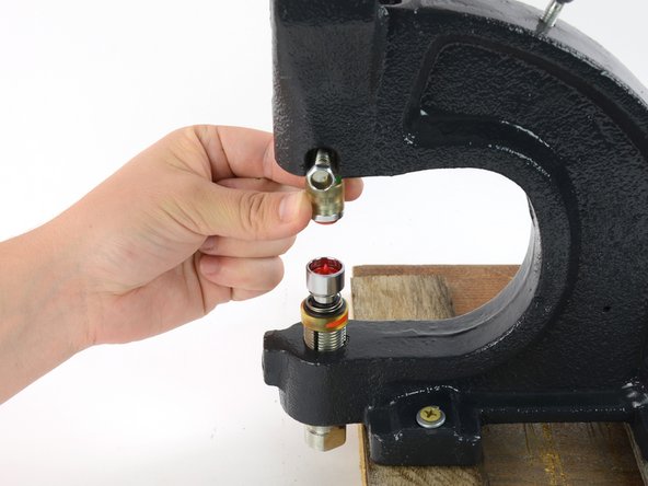

    7. Plastic Snap Installation Using a Hand Press, Set up the hand press: crwdns2935265:07crwdnd2935265:01crwdnd2935265:02crwdne2935265:0 Plastic Snap Installation Using a Hand Press, Set up the hand press: crwdns2935265:07crwdnd2935265:02crwdnd2935265:02crwdne2935265:0
      • Use your fingers, a screwdriver, or a hex key, as needed, to unscrew the tightening mechanism on the side of the press near the top die fitting.
      • Insert the die upward and hold it in place.
      • Tighten the tightening mechanism.
    8. Plastic Snap Installation Using a Hand Press, Install the snap: crwdns2935265:08crwdnd2935265:01crwdnd2935265:03crwdne2935265:0 Plastic Snap Installation Using a Hand Press, Install the snap: crwdns2935265:08crwdnd2935265:02crwdnd2935265:03crwdne2935265:0 Plastic Snap Installation Using a Hand Press, Install the snap: crwdns2935265:08crwdnd2935265:03crwdnd2935265:03crwdne2935265:0
      • Place the garment over the bottom snap die so that the hole on the fabric lines up with the plastic post of the new cap.
      • Make sure no extra fabric is caught inside the press and that the orientation of the garment is correct.
      • Hold the fabric in place with one hand, then use your other hand to pull down the handle of the press.
      • This requires a lot of pressure to make sure the snap replacement is successful - so pull hard!

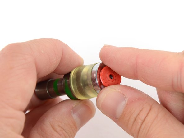

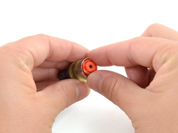

    9. Plastic Snap Installation Using a Hand Press, Quality control: crwdns2935265:09crwdnd2935265:01crwdnd2935265:03crwdne2935265:0 Plastic Snap Installation Using a Hand Press, Quality control: crwdns2935265:09crwdnd2935265:02crwdnd2935265:03crwdne2935265:0 Plastic Snap Installation Using a Hand Press, Quality control: crwdns2935265:09crwdnd2935265:03crwdnd2935265:03crwdne2935265:0
      • Remove the garment from the press and check that the new snap clicks into the opposing side.
      • A properly secured snap will flatten the cap post into the socket/stud piece. Depending on the type of snap dies used, this will produce one of two outcomes:
      • Three concentric circles visible at the center of the snap (reference image #2)
      • A mushroom dome shape at the center of the snap (reference image #3)
      • If the snap spins in place, the snap isn't secure. Repeat the previous step.
