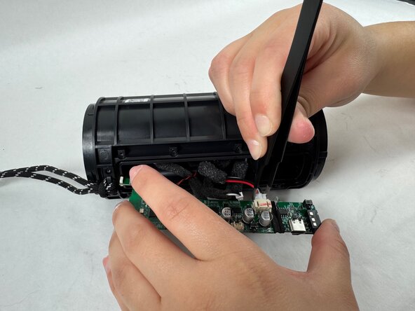

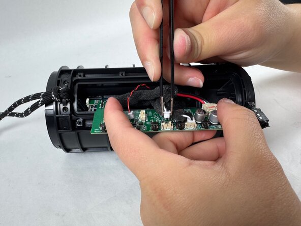

  10. Ortizan X10 USB-C Charging Port Replacement: crwdns2935265:010crwdnd2935265:01crwdnd2935265:03crwdne2935265:0 Ortizan X10 USB-C Charging Port Replacement: crwdns2935265:010crwdnd2935265:02crwdnd2935265:03crwdne2935265:0 Ortizan X10 USB-C Charging Port Replacement: crwdns2935265:010crwdnd2935265:03crwdnd2935265:03crwdne2935265:0
    • Utilizing the Precision Tweezer disconnect all three JST Connectors connected to the motherboard.
    • To disconnect the first three JST Connectors, use the precision tweezer and firmly grip the sides of the connectors and pull it up.
    • To disconnect the last JST Connector, use the precision tweezer, firmly grip the sides of the connectors and carefully move it side to side until it unplugs.

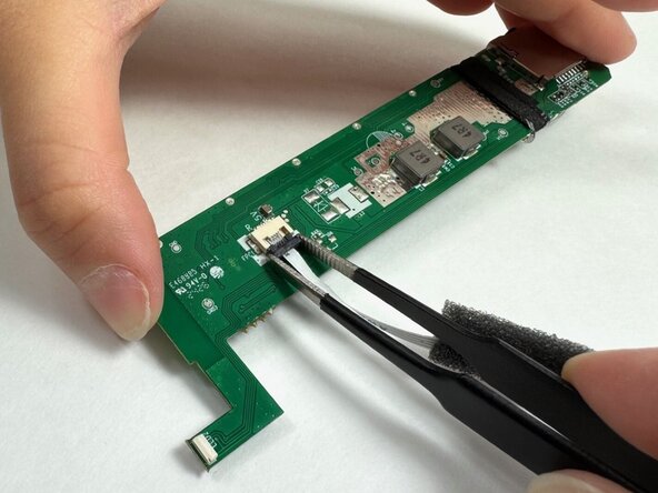

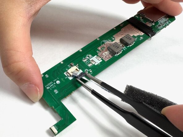

  11. Ortizan X10 USB-C Charging Port Replacement: crwdns2935265:011crwdnd2935265:01crwdnd2935265:03crwdne2935265:0 Ortizan X10 USB-C Charging Port Replacement: crwdns2935265:011crwdnd2935265:02crwdnd2935265:03crwdne2935265:0 Ortizan X10 USB-C Charging Port Replacement: crwdns2935265:011crwdnd2935265:03crwdnd2935265:03crwdne2935265:0
    • To disconnect the LED connector from the motherboard, use a pair of tweezers or a clean fingernail to gently wiggle the black connector from side to side until it slides off.
    • Use caution when wiggling this connector side to side, as excessive force may cause it to break.
    • Once the connector is removed, the white ZIF tape will naturally detach from the motherboard. At this point, all components have been successfully disconnected, and the motherboard is ready for replacement. To reassemble your device, follow these instructions in reverse order.

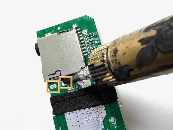

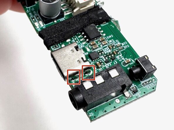

  12. Ortizan X10 USB-C Charging Port Replacement, USB-C Charging Port: crwdns2935265:012crwdnd2935265:01crwdnd2935265:01crwdne2935265:0
    • Locate the USB-C charging port on your motherboard.
  13. Ortizan X10 USB-C Charging Port Replacement: crwdns2935265:013crwdnd2935265:01crwdnd2935265:03crwdne2935265:0 Ortizan X10 USB-C Charging Port Replacement: crwdns2935265:013crwdnd2935265:02crwdnd2935265:03crwdne2935265:0 Ortizan X10 USB-C Charging Port Replacement: crwdns2935265:013crwdnd2935265:03crwdnd2935265:03crwdne2935265:0
    • There are four primary solder joints, two on each side of the USB-C charging port, that requires desoldering.
    • Additionally, two solder points located at the rear of the port must also be addressed.
    • To solder these connections, use a fine-tipped soldering iron to apply controlled, even heat to each joint.
    • Maintain a steady hand and avoid prolonged heat to prevent PCB damage.
    • Once the solder has melted, gently lift the USB-C using tweezers. If resistant is felt, apply additional heat to ensure all joints are fully liquefied before removal.
    • While the use of a soldering iron may take longer than other methods, it offers greater precision and reduces the risk of damaging surrounding components. Be patient and reapply heat as needed to ensure complete detachment of the USB-C port.
