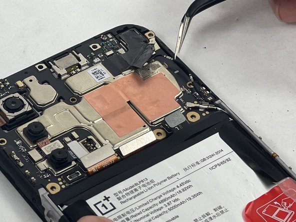

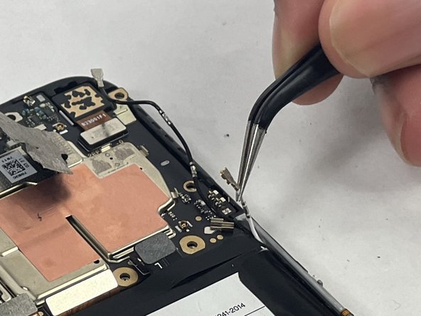

  11. OnePlus Nord N200 Rear Cameras Replacement, Rear Cameras: crwdns2935265:011crwdnd2935265:01crwdnd2935265:03crwdne2935265:0 OnePlus Nord N200 Rear Cameras Replacement, Rear Cameras: crwdns2935265:011crwdnd2935265:02crwdnd2935265:03crwdne2935265:0 OnePlus Nord N200 Rear Cameras Replacement, Rear Cameras: crwdns2935265:011crwdnd2935265:03crwdnd2935265:03crwdne2935265:0
    • The black Coaxial connector should be disconnected first as it is the ground cable.
    • Peal the tape up in the upper right corner of the phone to reveal the black coaxial cable.
    • To disconnect the black coaxial cable, slide a thin, ESD-safe pry tool or angled tweezers under the metal neck of the connector (as close to the head as possible) and lift straight up from the board.
    • When working with these connectors, it's key to always lift the head straight up. If pried on at an odd angle, you risk breaking the socket off of the board underneath.
    • Reconnecting these can be tricky. Use tweezers to hold the connector in place over its socket and gently press down with your finger or a spudger—the connector should "snap" into place. If you're having trouble, reposition the head and try again.
    • Don't try to force the connector into place or you may permanently damage it.

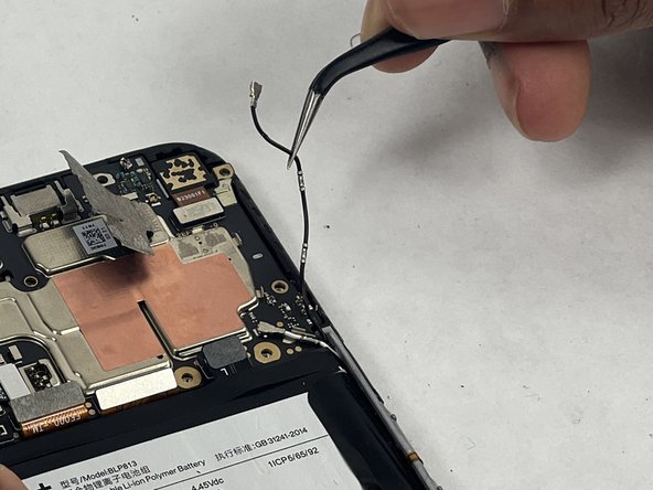

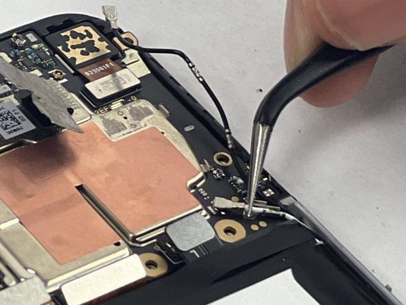

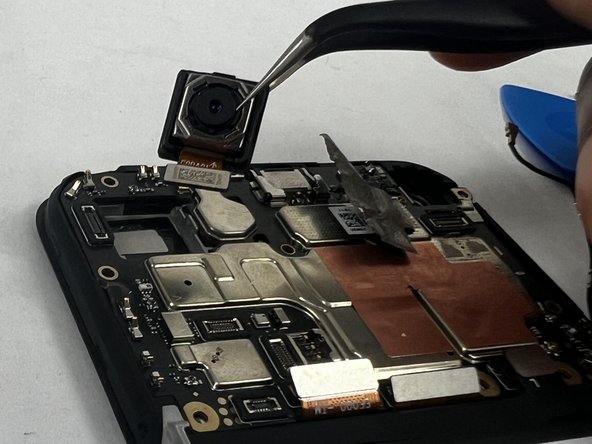

  12. OnePlus Nord N200 Rear Cameras Replacement: crwdns2935265:012crwdnd2935265:01crwdnd2935265:03crwdne2935265:0 OnePlus Nord N200 Rear Cameras Replacement: crwdns2935265:012crwdnd2935265:02crwdnd2935265:03crwdne2935265:0 OnePlus Nord N200 Rear Cameras Replacement: crwdns2935265:012crwdnd2935265:03crwdnd2935265:03crwdne2935265:0
    • Slide a thin, ESD-safe pry tool or angled tweezers under the metal neck of the white coaxial cable connector and lift straight up from the board.
    • Use the tweezers to move the white coaxial connector away from the board.

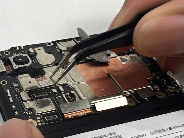

  13. OnePlus Nord N200 Rear Cameras Replacement: crwdns2935265:013crwdnd2935265:01crwdnd2935265:03crwdne2935265:0 OnePlus Nord N200 Rear Cameras Replacement: crwdns2935265:013crwdnd2935265:02crwdnd2935265:03crwdne2935265:0 OnePlus Nord N200 Rear Cameras Replacement: crwdns2935265:013crwdnd2935265:03crwdnd2935265:03crwdne2935265:0
    • Place a spudger or an opening tool under the edge of the small camera's press connector and pry straight up to disconnect it.
    • Make sure to pry under the edge of the connector itself, and not under the socket on the board. Otherwise, you risk permanently damaging the socket.
    • Work carefully: don't pry on or accidentally scrape any small, surface mounted components on the board.
    • Use the tweezers to remove the camera module from the board.
    • To reconnect, align the connector carefully over its socket and press down with your fingertip—first on one side, then the other—until it clicks into place. Don't try to force the connector into place. If you're having trouble, reposition it and try again.
    • Don't press down on the middle of wider connectors until they're fully seated. If misaligned, the connector or the pins underneath can bend or break, causing permanent damage.
    • You don't have to disconnect this specific camera. If you know which camera is faulty you may skip this and go to directly disconnecting the faulty camera.

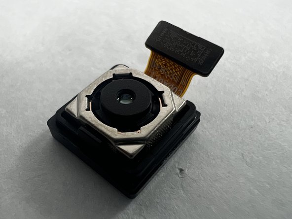

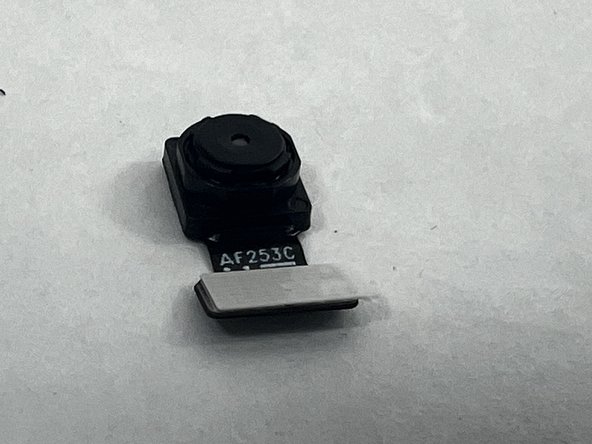

  14. OnePlus Nord N200 Rear Cameras Replacement: crwdns2935265:014crwdnd2935265:01crwdnd2935265:02crwdne2935265:0 OnePlus Nord N200 Rear Cameras Replacement: crwdns2935265:014crwdnd2935265:02crwdnd2935265:02crwdne2935265:0
    • Remove the small rear camera.

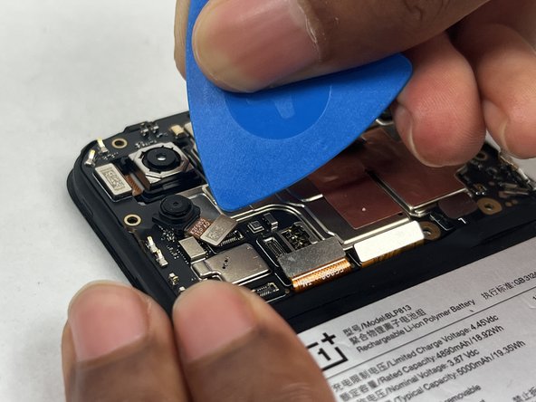

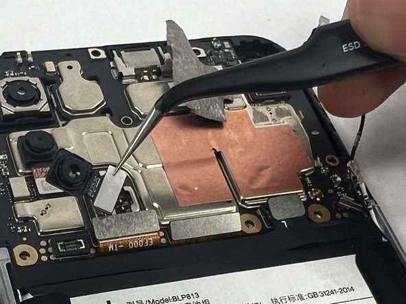

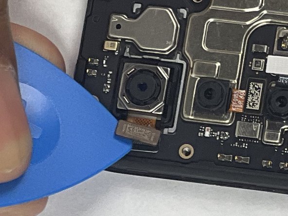

  15. OnePlus Nord N200 Rear Cameras Replacement: crwdns2935265:015crwdnd2935265:01crwdnd2935265:03crwdne2935265:0 OnePlus Nord N200 Rear Cameras Replacement: crwdns2935265:015crwdnd2935265:02crwdnd2935265:03crwdne2935265:0 OnePlus Nord N200 Rear Cameras Replacement: crwdns2935265:015crwdnd2935265:03crwdnd2935265:03crwdne2935265:0
    • Repeat the process to detach the middle camera press connector.
    • Use the tweezers to grab the camera module and move it away from the board.

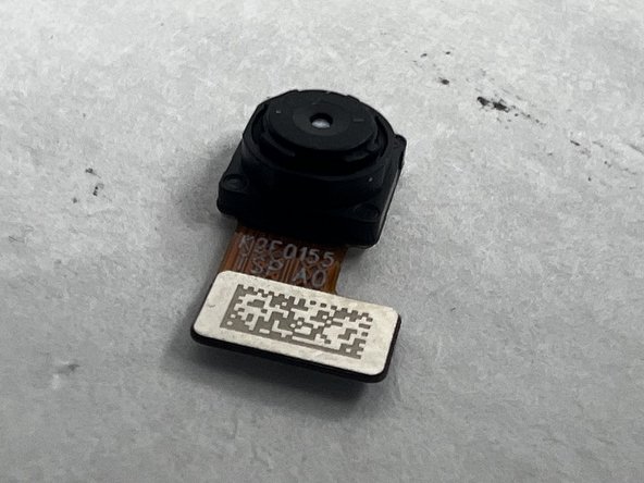

  16. OnePlus Nord N200 Rear Cameras Replacement: crwdns2935265:016crwdnd2935265:01crwdnd2935265:02crwdne2935265:0 OnePlus Nord N200 Rear Cameras Replacement: crwdns2935265:016crwdnd2935265:02crwdnd2935265:02crwdne2935265:0
    • Remove the middle rear camera.

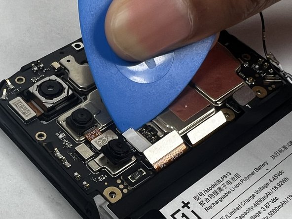

  17. OnePlus Nord N200 Rear Cameras Replacement: crwdns2935265:017crwdnd2935265:01crwdnd2935265:03crwdne2935265:0 OnePlus Nord N200 Rear Cameras Replacement: crwdns2935265:017crwdnd2935265:02crwdnd2935265:03crwdne2935265:0 OnePlus Nord N200 Rear Cameras Replacement: crwdns2935265:017crwdnd2935265:03crwdnd2935265:03crwdne2935265:0
    • Place a spudger or an opening tool under the connector's edge of the third camera and pry straight up to disconnect it.

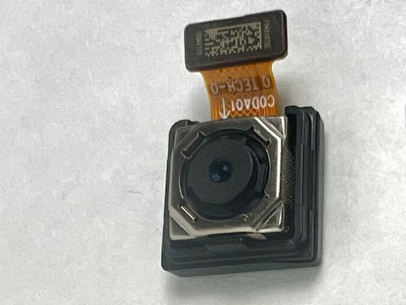

  18. OnePlus Nord N200 Rear Cameras Replacement: crwdns2935265:018crwdnd2935265:01crwdnd2935265:03crwdne2935265:0 OnePlus Nord N200 Rear Cameras Replacement: crwdns2935265:018crwdnd2935265:02crwdnd2935265:03crwdne2935265:0 OnePlus Nord N200 Rear Cameras Replacement: crwdns2935265:018crwdnd2935265:03crwdnd2935265:03crwdne2935265:0
    • Remove the larger rear camera.
