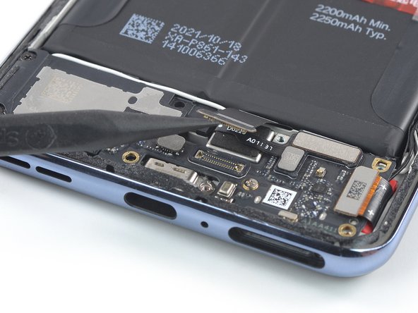

  17. OnePlus Nord 2 5G Daughterboard Replacement, Disconnect the battery cable: crwdns2935265:017crwdnd2935265:01crwdnd2935265:02crwdne2935265:0 OnePlus Nord 2 5G Daughterboard Replacement, Disconnect the battery cable: crwdns2935265:017crwdnd2935265:02crwdnd2935265:02crwdne2935265:0
    • Use a spudger to disconnect the battery cable by prying the connector straight up from its socket.

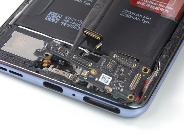

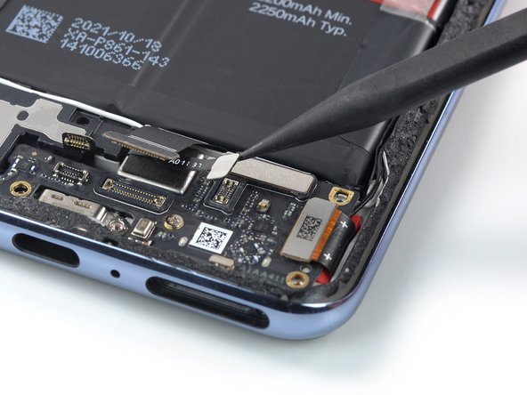

  21. OnePlus Nord 2 5G Daughterboard Replacement, Disconnect the interconnect and the antenna board cables: crwdns2935265:021crwdnd2935265:01crwdnd2935265:03crwdne2935265:0 OnePlus Nord 2 5G Daughterboard Replacement, Disconnect the interconnect and the antenna board cables: crwdns2935265:021crwdnd2935265:02crwdnd2935265:03crwdne2935265:0 OnePlus Nord 2 5G Daughterboard Replacement, Disconnect the interconnect and the antenna board cables: crwdns2935265:021crwdnd2935265:03crwdnd2935265:03crwdne2935265:0
    • Use a spudger to disconnect the interconnect and the antenna board cables by prying the connectors straight up from their socket.

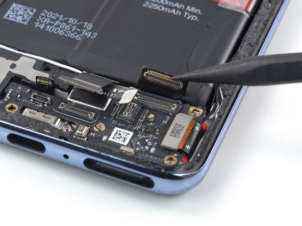

  22. OnePlus Nord 2 5G Daughterboard Replacement, Disconnect the fingerprint sensor and the interconnect cables: crwdns2935265:022crwdnd2935265:01crwdnd2935265:03crwdne2935265:0 OnePlus Nord 2 5G Daughterboard Replacement, Disconnect the fingerprint sensor and the interconnect cables: crwdns2935265:022crwdnd2935265:02crwdnd2935265:03crwdne2935265:0 OnePlus Nord 2 5G Daughterboard Replacement, Disconnect the fingerprint sensor and the interconnect cables: crwdns2935265:022crwdnd2935265:03crwdnd2935265:03crwdne2935265:0
    • Use a spudger to disconnect the fingerprint sensor and the interconnect cables by prying the connectors straight up from their sockets.
  23. OnePlus Nord 2 5G Daughterboard Replacement, Disconnect the display: crwdns2935265:023crwdnd2935265:01crwdnd2935265:02crwdne2935265:0 OnePlus Nord 2 5G Daughterboard Replacement, Disconnect the display: crwdns2935265:023crwdnd2935265:02crwdnd2935265:02crwdne2935265:0
    • Use a spudger to disconnect the display cable by prying the connector straight up from its socket.

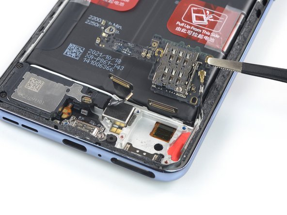

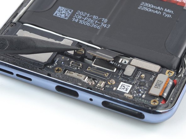

  24. OnePlus Nord 2 5G Daughterboard Replacement, Unfasten the daughterboard: crwdns2935265:024crwdnd2935265:01crwdnd2935265:01crwdne2935265:0
    • Use a Phillips driver to remove the 2.8 mm-long screw securing the daughterboard.
  25. OnePlus Nord 2 5G Daughterboard Replacement, Pry up the daughterboard: crwdns2935265:025crwdnd2935265:01crwdnd2935265:02crwdne2935265:0 OnePlus Nord 2 5G Daughterboard Replacement, Pry up the daughterboard: crwdns2935265:025crwdnd2935265:02crwdnd2935265:02crwdne2935265:0
    • Insert the point of a spudger underneath the top edge of the daughterboard.
    • Pry upwards to loosen the daughterboard.
    • Don't try to remove the daughterboard all the way yet. There's an antenna cable on its bottom that is still connected to it.

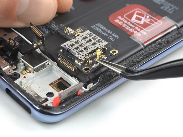

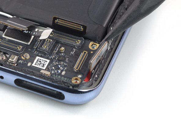

  26. OnePlus Nord 2 5G Daughterboard Replacement, Fold over the daughterboard: crwdns2935265:026crwdnd2935265:01crwdnd2935265:02crwdne2935265:0 OnePlus Nord 2 5G Daughterboard Replacement, Fold over the daughterboard: crwdns2935265:026crwdnd2935265:02crwdnd2935265:02crwdne2935265:0
    • Use a pair of blunt nose tweezers to carefully fold the daughterboard over in direction of the battery.
  27. OnePlus Nord 2 5G Daughterboard Replacement, Disconnect the antenna cable: crwdns2935265:027crwdnd2935265:01crwdnd2935265:02crwdne2935265:0 OnePlus Nord 2 5G Daughterboard Replacement, Disconnect the antenna cable: crwdns2935265:027crwdnd2935265:02crwdnd2935265:02crwdne2935265:0
    • Slide a one arm of a pair of tweezers under the black antenna cable until they're snug against the metal connector.
    • Disconnect the upper antenna cable by prying it straight up from the daughterboard.

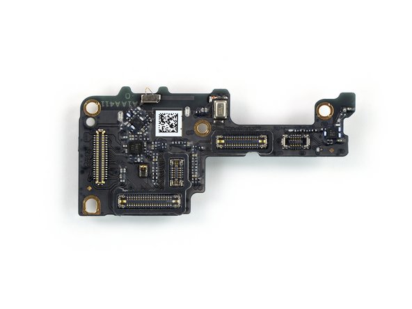

  28. OnePlus Nord 2 5G Daughterboard Replacement, Remove the daughterboard: crwdns2935265:028crwdnd2935265:01crwdnd2935265:02crwdne2935265:0 OnePlus Nord 2 5G Daughterboard Replacement, Remove the daughterboard: crwdns2935265:028crwdnd2935265:02crwdnd2935265:02crwdne2935265:0
    • Remove the daughterboard.
Compare your new replacement part to the original part—you may need to transfer remaining components or remove adhesive backings from the new part before you install it.
