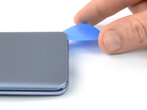

  1. OnePlus Nord 2 5G Battery Replacement, Loosen the rear glass: crwdns2935265:01crwdnd2935265:01crwdnd2935265:01crwdne2935265:0
    • Prepare an iOpener and apply it to the rear glass for at least three minutes to loosen the adhesive underneath.
    • A hair dryer, heat gun, or hot plate may also be used, but be careful not to overheat the phone—the display and internal battery are both susceptible to heat damage.

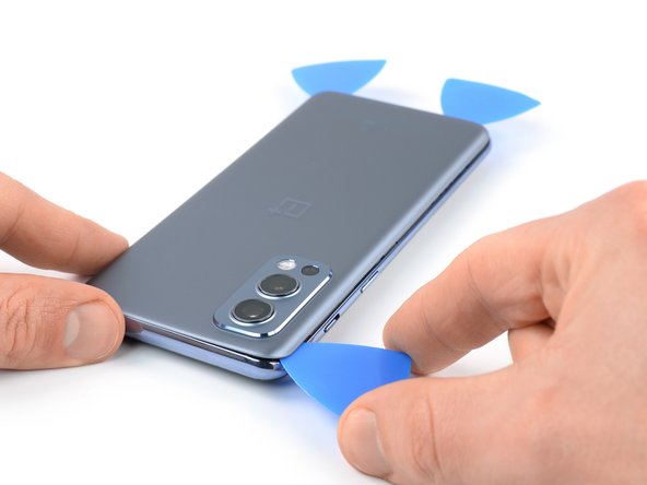

  2. OnePlus Nord 2 5G Battery Replacement, Insert an iFlex: crwdns2935265:02crwdnd2935265:01crwdnd2935265:03crwdne2935265:0 OnePlus Nord 2 5G Battery Replacement, Insert an iFlex: crwdns2935265:02crwdnd2935265:02crwdnd2935265:03crwdne2935265:0 OnePlus Nord 2 5G Battery Replacement, Insert an iFlex: crwdns2935265:02crwdnd2935265:03crwdnd2935265:03crwdne2935265:0
    • Due to its surface, no suction tool will hold onto the phone's rear glass. A thin slicing tool is required to create a gap between the rear glass and the midframe.
    • Insert an iFlex into the seam between the rear glass and the midframe at the bottom edge of the phone to create a gap. This may require some force.
    • Leave the iFlex in place to prevent the adhesive from resealing.

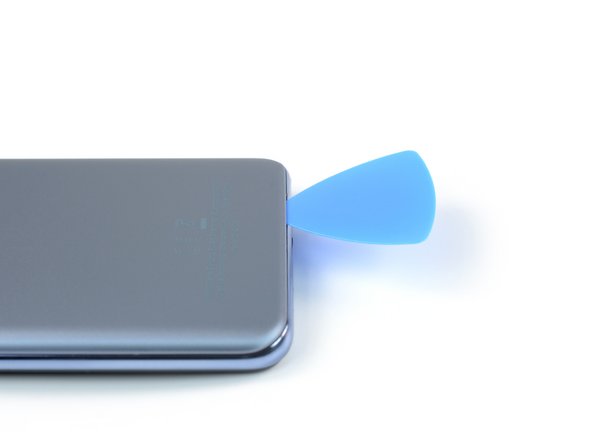

  3. OnePlus Nord 2 5G Battery Replacement, Insert an opening pick: crwdns2935265:03crwdnd2935265:01crwdnd2935265:03crwdne2935265:0 OnePlus Nord 2 5G Battery Replacement, Insert an opening pick: crwdns2935265:03crwdnd2935265:02crwdnd2935265:03crwdne2935265:0 OnePlus Nord 2 5G Battery Replacement, Insert an opening pick: crwdns2935265:03crwdnd2935265:03crwdnd2935265:03crwdne2935265:0
    • Insert an opening pick into the gap you created with the iFlex.
    • Remove the iFlex.

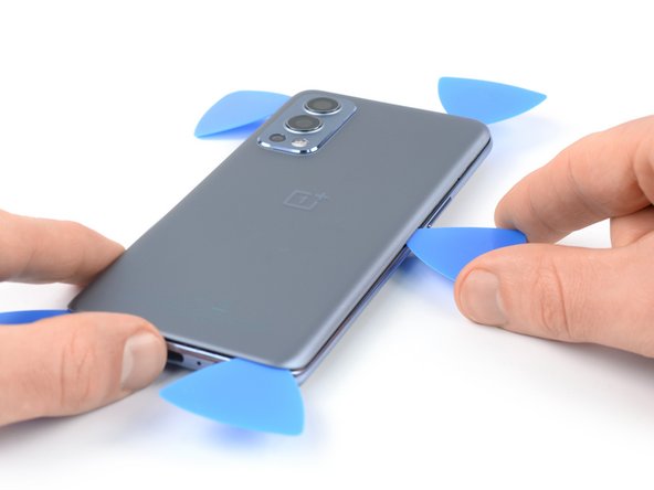

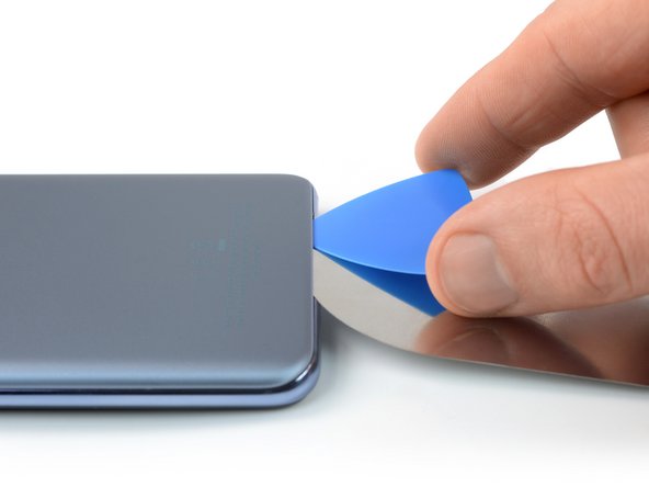

  4. OnePlus Nord 2 5G Battery Replacement, Slice the bottom edge adhesive: crwdns2935265:04crwdnd2935265:01crwdnd2935265:02crwdne2935265:0 OnePlus Nord 2 5G Battery Replacement, Slice the bottom edge adhesive: crwdns2935265:04crwdnd2935265:02crwdnd2935265:02crwdne2935265:0
    • Slide the opening pick to the bottom right corner to slice the adhesive.
    • Leave the opening pick in place to prevent the adhesive from resealing.

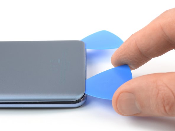

  5. OnePlus Nord 2 5G Battery Replacement: crwdns2935265:05crwdnd2935265:01crwdnd2935265:02crwdne2935265:0 OnePlus Nord 2 5G Battery Replacement: crwdns2935265:05crwdnd2935265:02crwdnd2935265:02crwdne2935265:0
    • Insert a second opening pick at the bottom right corner of your phone.
    • Slide the opening pick to the bottom left corner to slice the adhesive.
    • Leave the opening picks in place to prevent the adhesive from resealing.

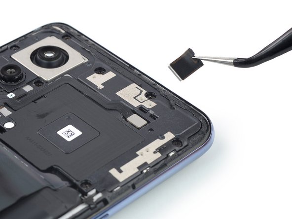

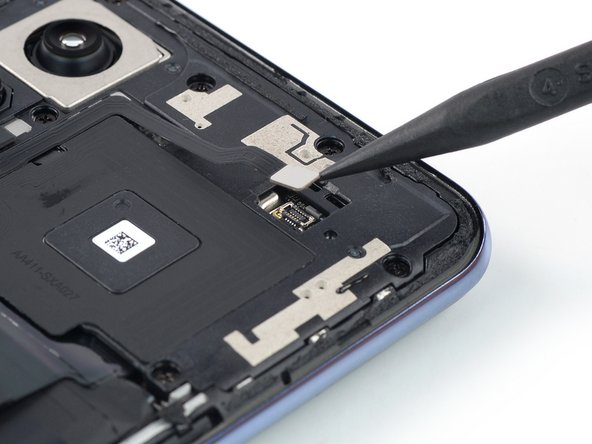

  10. OnePlus Nord 2 5G Battery Replacement, Remove the connector bracket: crwdns2935265:010crwdnd2935265:01crwdnd2935265:02crwdne2935265:0 OnePlus Nord 2 5G Battery Replacement, Remove the connector bracket: crwdns2935265:010crwdnd2935265:02crwdnd2935265:02crwdne2935265:0
    • Use a pair of tweezers to remove the metal bracket covering the flash assembly connector.
  11. OnePlus Nord 2 5G Battery Replacement, Disconnect the flash assembly: crwdns2935265:011crwdnd2935265:01crwdnd2935265:02crwdne2935265:0 OnePlus Nord 2 5G Battery Replacement, Disconnect the flash assembly: crwdns2935265:011crwdnd2935265:02crwdnd2935265:02crwdne2935265:0
    • Use the point of a spudger to disconnect the flash assembly cable by prying the connector straight up from its socket.

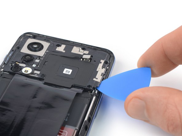

  13. OnePlus Nord 2 5G Battery Replacement, Pry up the motherboard cover: crwdns2935265:013crwdnd2935265:01crwdnd2935265:03crwdne2935265:0 OnePlus Nord 2 5G Battery Replacement, Pry up the motherboard cover: crwdns2935265:013crwdnd2935265:02crwdnd2935265:03crwdne2935265:0 OnePlus Nord 2 5G Battery Replacement, Pry up the motherboard cover: crwdns2935265:013crwdnd2935265:03crwdnd2935265:03crwdne2935265:0

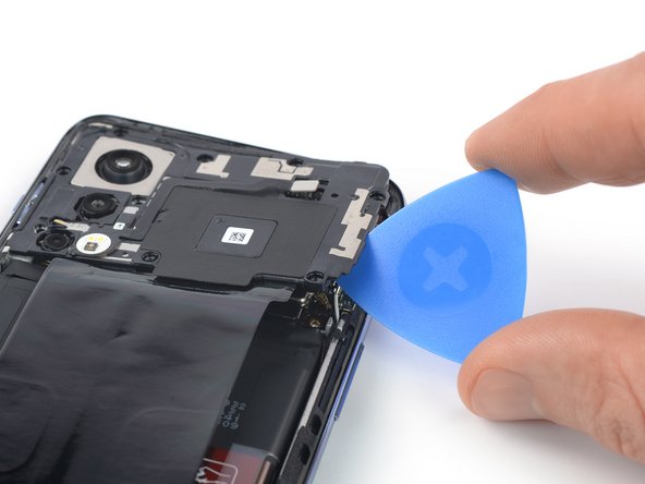

    • The motherboard cover is held in place by plastic clips.
    • Insert an opening pick underneath the bottom right edge of the motherboard cover.
    • Twist the opening pick sideways release the plastic clips and to pry up the motherboard cover.
  14. OnePlus Nord 2 5G Battery Replacement, Remove the motherboard cover: crwdns2935265:014crwdnd2935265:01crwdnd2935265:02crwdne2935265:0 OnePlus Nord 2 5G Battery Replacement, Remove the motherboard cover: crwdns2935265:014crwdnd2935265:02crwdnd2935265:02crwdne2935265:0
    • Remove the motherboard cover.

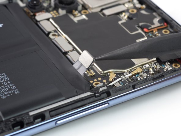

  15. OnePlus Nord 2 5G Battery Replacement, Disconnect the battery cable: crwdns2935265:015crwdnd2935265:01crwdnd2935265:02crwdne2935265:0 OnePlus Nord 2 5G Battery Replacement, Disconnect the battery cable: crwdns2935265:015crwdnd2935265:02crwdnd2935265:02crwdne2935265:0
    • Use a spudger to disconnect the battery cable by prying the connector straight up from its socket.

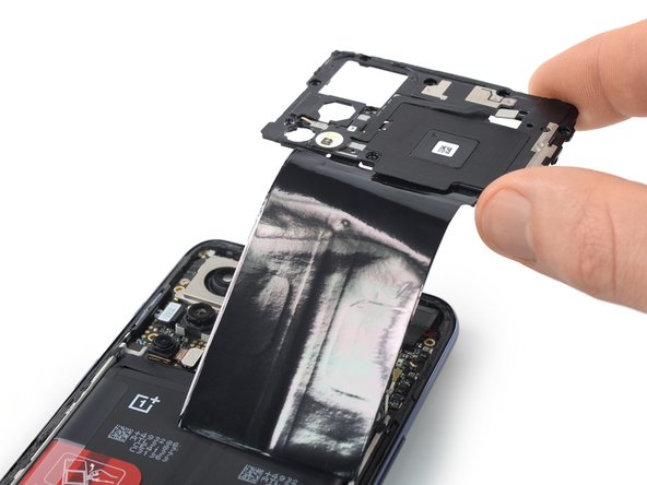

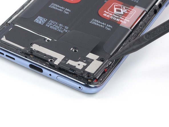

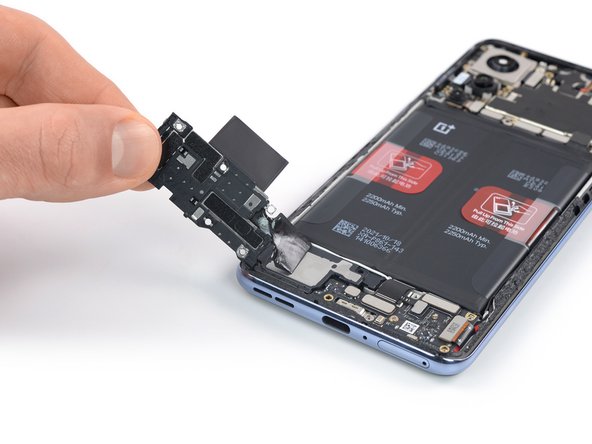

  18. OnePlus Nord 2 5G Battery Replacement, Remove the daughterboard cover: crwdns2935265:018crwdnd2935265:01crwdnd2935265:03crwdne2935265:0 OnePlus Nord 2 5G Battery Replacement, Remove the daughterboard cover: crwdns2935265:018crwdnd2935265:02crwdnd2935265:03crwdne2935265:0 OnePlus Nord 2 5G Battery Replacement, Remove the daughterboard cover: crwdns2935265:018crwdnd2935265:03crwdnd2935265:03crwdne2935265:0
    • Fold the daughterboard cover to the left like you would open the front cover of a book.
    • Carefully peel the black tape off of the loudspeaker.
    • Remove the daughterboard cover.

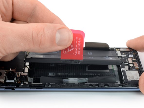

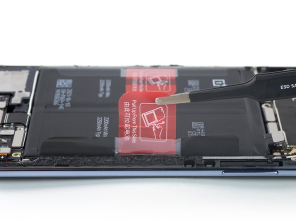

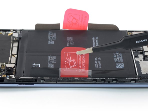

  19. OnePlus Nord 2 5G Battery Replacement, Peel up the right pull tab: crwdns2935265:019crwdnd2935265:01crwdnd2935265:02crwdne2935265:0 OnePlus Nord 2 5G Battery Replacement, Peel up the right pull tab: crwdns2935265:019crwdnd2935265:02crwdnd2935265:02crwdne2935265:0
    • Take care not to puncture or bend the battery with your tool—a punctured or bent battery may leak dangerous chemicals or cause a fire.
    • Use a pair of blunt nose tweezers or your fingers to peel the right pull tab off the battery.

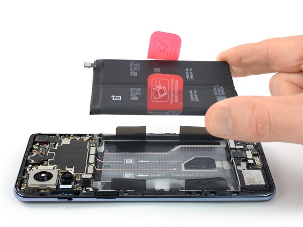

  20. OnePlus Nord 2 5G Battery Replacement, Lift the right half of the battery: crwdns2935265:020crwdnd2935265:01crwdnd2935265:02crwdne2935265:0 OnePlus Nord 2 5G Battery Replacement, Lift the right half of the battery: crwdns2935265:020crwdnd2935265:02crwdnd2935265:02crwdne2935265:0
    • Grab and lift the right pull-tab to remove the first half of the battery from its recess.
    • Don't try to remove the battery all the way yet. The left half is still adhered to the midframe.
    • If you're having trouble lifting the battery out of its recess, apply a heated iOpener to the screen for two minutes to loosen the battery adhesive.
    • A hair dryer, heat gun, or hot plate may also be used, but be careful not to overheat the device.
    • Only apply heat to the screen to prevent the battery from overheating.

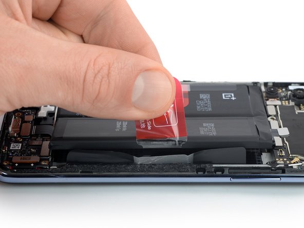

  21. OnePlus Nord 2 5G Battery Replacement, Peel up the left pull tab: crwdns2935265:021crwdnd2935265:01crwdnd2935265:02crwdne2935265:0 OnePlus Nord 2 5G Battery Replacement, Peel up the left pull tab: crwdns2935265:021crwdnd2935265:02crwdnd2935265:02crwdne2935265:0
    • Use a pair of blunt nose tweezers or your fingers to peel the left pull tab off the battery.
  22. OnePlus Nord 2 5G Battery Replacement, Lift the left half of the battery: crwdns2935265:022crwdnd2935265:01crwdnd2935265:02crwdne2935265:0 OnePlus Nord 2 5G Battery Replacement, Lift the left half of the battery: crwdns2935265:022crwdnd2935265:02crwdnd2935265:02crwdne2935265:0
    • Grab and lift the left pull-tab to remove the second half of the battery from its recess.

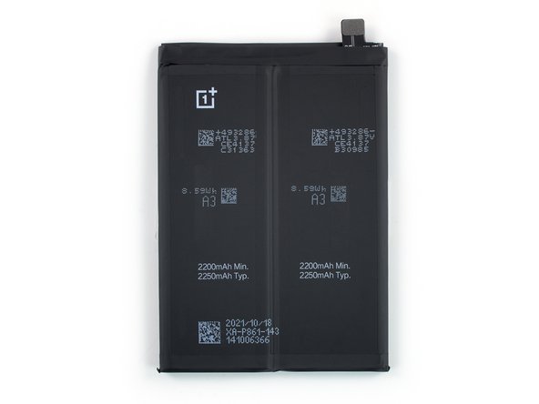

  23. OnePlus Nord 2 5G Battery Replacement, Remove the battery: crwdns2935265:023crwdnd2935265:01crwdnd2935265:03crwdne2935265:0 OnePlus Nord 2 5G Battery Replacement, Remove the battery: crwdns2935265:023crwdnd2935265:02crwdnd2935265:03crwdne2935265:0 OnePlus Nord 2 5G Battery Replacement, Remove the battery: crwdns2935265:023crwdnd2935265:03crwdnd2935265:03crwdne2935265:0
    • Peel the battery from any remaining adhesive and remove it.
    • Don't reinstall a damaged or deformed battery, as doing so is a potential safety hazard.
    • Secure the new battery with pre-cut adhesive or double-sided adhesive tape. In order to position it correctly, apply the new adhesive into the device at the places where the old adhesive was located, not directly onto the battery. Press the new battery firmly into place.
    • During reassembly, temporarily reconnect the battery to the motherboard before you press it into place to ensure correct alignment. Disconnect the battery after it's seated.
During reassembly, apply new adhesive where it's necessary after cleaning the relevant areas with isopropyl alcohol (>90%).

Hi. Please tell me, what is the name of the original battery for the nord2 model? Which battery should I change to?
Peter - crwdns2934203:0crwdne2934203:0 crwdns2950251:0crwdne2950251:0
I am looking for the same answer for the battery for "oneplus nord 2 5g"
so far the mode that I have found is BLP861, which is for the following models:
ONEPLUS NORD 2T
NORD 2 5G
NORD CE 5G
tridy - crwdns2934203:0crwdne2934203:0 crwdns2950251:0crwdne2950251:0
