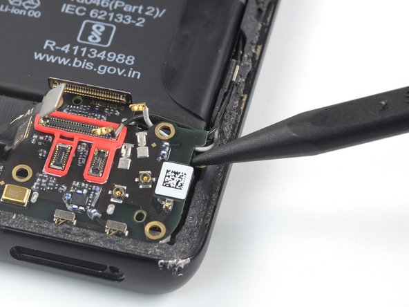

    7. OnePlus 8 Screen Replacement, Unfasten the daughterboard: crwdns2935265:020crwdnd2935265:01crwdnd2935265:01crwdne2935265:0
      • Use a Phillips driver to remove the single 3.3 mm-long screw securing the daughterboard.
    8. OnePlus 8 Screen Replacement, Pry up the daughterboard: crwdns2935265:021crwdnd2935265:01crwdnd2935265:02crwdne2935265:0 OnePlus 8 Screen Replacement, Pry up the daughterboard: crwdns2935265:021crwdnd2935265:02crwdnd2935265:02crwdne2935265:0
      • Insert the point of a spudger under the top right corner of the daughterboard.
      • Pry up the daughterboard.
    9. OnePlus 8 Screen Replacement, Remove the daughterboard: crwdns2935265:022crwdnd2935265:01crwdnd2935265:03crwdne2935265:0 OnePlus 8 Screen Replacement, Remove the daughterboard: crwdns2935265:022crwdnd2935265:02crwdnd2935265:03crwdne2935265:0 OnePlus 8 Screen Replacement, Remove the daughterboard: crwdns2935265:022crwdnd2935265:03crwdnd2935265:03crwdne2935265:0
      • Use a pair of tweezers or your fingers to remove the daughterboard.
      • Before reinstalling the daughterboard, make sure all cables that connect to it are out of the way.

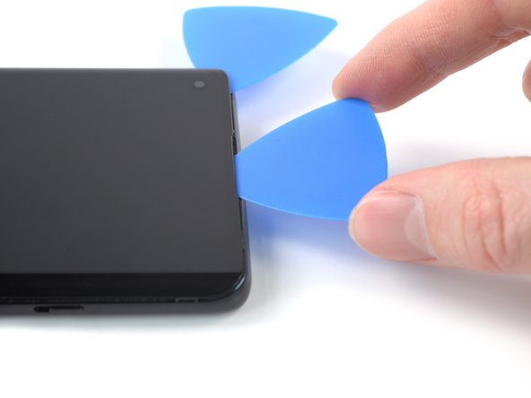

    4. OnePlus 8 Screen Replacement, Insert an iFlex: crwdns2935265:026crwdnd2935265:01crwdnd2935265:03crwdne2935265:0 OnePlus 8 Screen Replacement, Insert an iFlex: crwdns2935265:026crwdnd2935265:02crwdnd2935265:03crwdne2935265:0 OnePlus 8 Screen Replacement, Insert an iFlex: crwdns2935265:026crwdnd2935265:03crwdnd2935265:03crwdne2935265:0
      iFlex Opening Tool
      $11.99
      • Apply a suction handle to the center of the bottom edge of the screen, as close to the edge as possible.
      • If your display is badly cracked, cover it with a layer of clear packing tape to help the suction cup adhere. Alternatively, you can pull using very strong tape instead of a suction cup. If all else fails, try supergluing the suction cup to the broken screen.
      • Pull up on the suction handle with strong, steady force and insert an iFlex between the screen and frame.
      • Make sure to unsert the iFlex under the screen, not the plastic frame.
      • Depending on the age of your phone, this may be difficult. If you're having trouble, apply more heat to the bottom edge and try again.
    5. OnePlus 8 Screen Replacement, Slice the bottom edge adhesive: crwdns2935265:027crwdnd2935265:01crwdnd2935265:03crwdne2935265:0 OnePlus 8 Screen Replacement, Slice the bottom edge adhesive: crwdns2935265:027crwdnd2935265:02crwdnd2935265:03crwdne2935265:0 OnePlus 8 Screen Replacement, Slice the bottom edge adhesive: crwdns2935265:027crwdnd2935265:03crwdnd2935265:03crwdne2935265:0
      • Insert an opening pick between the iFlex and the screen.
      • Slide the opening pick to the bottom right corner of the screen to slice the adhesive.
      • Leave the opening pick in place to prevent the adhesive from resealing.

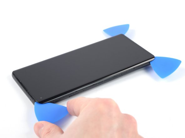

    6. OnePlus 8 Screen Replacement: crwdns2935265:028crwdnd2935265:01crwdnd2935265:03crwdne2935265:0 OnePlus 8 Screen Replacement: crwdns2935265:028crwdnd2935265:02crwdnd2935265:03crwdne2935265:0 OnePlus 8 Screen Replacement: crwdns2935265:028crwdnd2935265:03crwdnd2935265:03crwdne2935265:0
      • Insert a second opening pick between the iFlex and the screen.
      • Slide the opening pick to the bottom left corner of the screen to slice the adhesive.
      • Remove the iFlex.
    7. OnePlus 8 Screen Replacement, Slice the left edge adhesive: crwdns2935265:029crwdnd2935265:01crwdnd2935265:03crwdne2935265:0 OnePlus 8 Screen Replacement, Slice the left edge adhesive: crwdns2935265:029crwdnd2935265:02crwdnd2935265:03crwdne2935265:0 OnePlus 8 Screen Replacement, Slice the left edge adhesive: crwdns2935265:029crwdnd2935265:03crwdnd2935265:03crwdne2935265:0
      • If the adhesive becomes hard to cut, it's most likely cooled down. Use your iOpener or heat gun to reheat it.
      • Insert a third opening pick underneath the bottom left corner of the screen.
      • Slide the opening pick up the left edge of the screen to slice the adhesive.
      • Leave the opening pick in the top left corner to prevent the adhesive from resealing.
    8. OnePlus 8 Screen Replacement, Slice the top edge adhesive: crwdns2935265:030crwdnd2935265:01crwdnd2935265:03crwdne2935265:0 OnePlus 8 Screen Replacement, Slice the top edge adhesive: crwdns2935265:030crwdnd2935265:02crwdnd2935265:03crwdne2935265:0 OnePlus 8 Screen Replacement, Slice the top edge adhesive: crwdns2935265:030crwdnd2935265:03crwdnd2935265:03crwdne2935265:0
      • Insert a fourth opening pick at the top left corner of the screen.
      • Slide the opening pick along the top edge of the phone to slice the adhesive.
      • Leave the opening pick in the top right corner to prevent the adhesive from resealing.
    9. OnePlus 8 Screen Replacement, Slice the right edge adhesive: crwdns2935265:031crwdnd2935265:01crwdnd2935265:03crwdne2935265:0 OnePlus 8 Screen Replacement, Slice the right edge adhesive: crwdns2935265:031crwdnd2935265:02crwdnd2935265:03crwdne2935265:0 OnePlus 8 Screen Replacement, Slice the right edge adhesive: crwdns2935265:031crwdnd2935265:03crwdnd2935265:03crwdne2935265:0
      • Insert a fifth opening pick underneath the top right corner of the screen and slide it down the right edge of the phone to slice the remaining adhesive.
