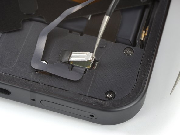

    4. Nothing Phone (1) Screen Replacement, Fold over the bottom LED assembly: crwdns2935265:014crwdnd2935265:01crwdnd2935265:02crwdne2935265:0 Nothing Phone (1) Screen Replacement, Fold over the bottom LED assembly: crwdns2935265:014crwdnd2935265:02crwdnd2935265:02crwdne2935265:0
      • The bottom LED assembly is still held in place by a small piece of adhesive sitting between the cable winds. Avoid straining or tearing the cable when folding the assembly over.
      • Use a pair of blunt nosed tweezers and carefully fold the bottom LED assembly over to get free access to the LED cable connector.
    5. Nothing Phone (1) Screen Replacement, Open the connector bracket: crwdns2935265:015crwdnd2935265:01crwdnd2935265:03crwdne2935265:0 Nothing Phone (1) Screen Replacement, Open the connector bracket: crwdns2935265:015crwdnd2935265:02crwdnd2935265:03crwdne2935265:0 Nothing Phone (1) Screen Replacement, Open the connector bracket: crwdns2935265:015crwdnd2935265:03crwdnd2935265:03crwdne2935265:0
      • The LED connector bracket sits very tight and may require some force to open it.
      • Insert one arm of a pair of tweezers into the gap at the right side of the connector bracket.
      • Push your tweezers toward the left edge of the phone to free the closure flap of the connector bracket.
      • If you're struggling to free the flap, pull the black rubber piece to the left to give the bracket more room.
      • Lift the connector bracket with your tweezers to access the LED connector.

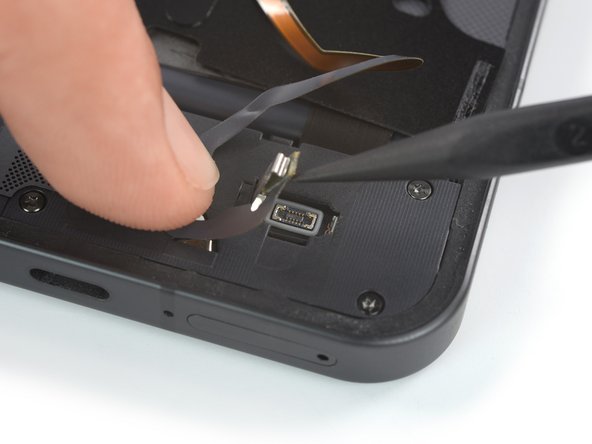

    6. Nothing Phone (1) Screen Replacement, Disconnect the LED cable: crwdns2935265:016crwdnd2935265:01crwdnd2935265:02crwdne2935265:0 Nothing Phone (1) Screen Replacement, Disconnect the LED cable: crwdns2935265:016crwdnd2935265:02crwdnd2935265:02crwdne2935265:0
      • Use a spudger to disconnect the LED cable by prying the connector straight up from its socket.
    7. Nothing Phone (1) Screen Replacement, Remove the bottom LED assembly: crwdns2935265:017crwdnd2935265:01crwdnd2935265:02crwdne2935265:0 Nothing Phone (1) Screen Replacement, Remove the bottom LED assembly: crwdns2935265:017crwdnd2935265:02crwdnd2935265:02crwdne2935265:0
      • Use a pair of tweezers or your fingers to remove the bottom LED assembly.

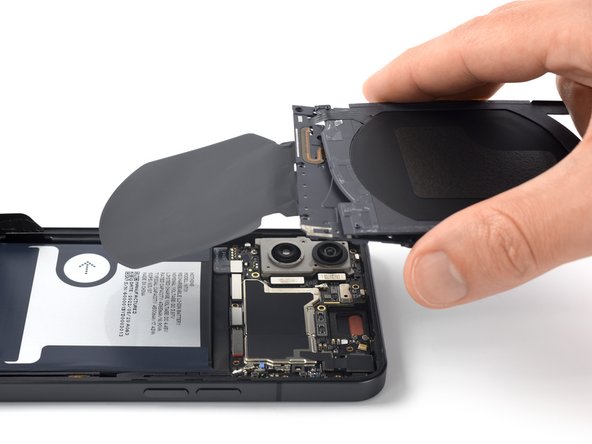

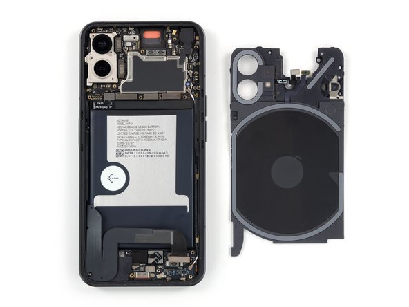

    21. Nothing Phone (1) Screen Replacement, Fold over the charging board assembly: crwdns2935265:031crwdnd2935265:01crwdnd2935265:02crwdne2935265:0 Nothing Phone (1) Screen Replacement, Fold over the charging board assembly: crwdns2935265:031crwdnd2935265:02crwdnd2935265:02crwdne2935265:0
      • When folding the charging coil assembly over avoid straining components and cables.
      • Carefully fold the charging coil to the top edge of the phone to access the motherboard cover screws.
