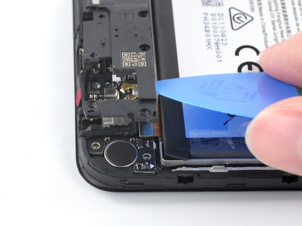

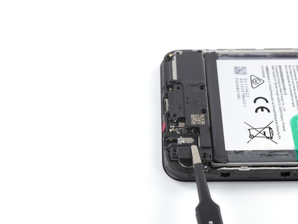

  16. Nokia G42 5G Screen Assembly Replacement, Unfasten the loudspeaker: crwdns2935265:016crwdnd2935265:01crwdnd2935265:01crwdne2935265:0
  17. Nokia G42 5G Screen Assembly Replacement, Pry up the loudspeaker: crwdns2935265:017crwdnd2935265:01crwdnd2935265:03crwdne2935265:0 Nokia G42 5G Screen Assembly Replacement, Pry up the loudspeaker: crwdns2935265:017crwdnd2935265:02crwdnd2935265:03crwdne2935265:0 Nokia G42 5G Screen Assembly Replacement, Pry up the loudspeaker: crwdns2935265:017crwdnd2935265:03crwdnd2935265:03crwdne2935265:0
    • Insert an opening pick underneath the top right edge of the loudspeaker.
    • Avoid pushing down at a sharp angle, or you risk damaging the interconnect ribbon cable underneath.
    • Twist the opening pick to release loudspeaker from the plastic clips holding it in place.

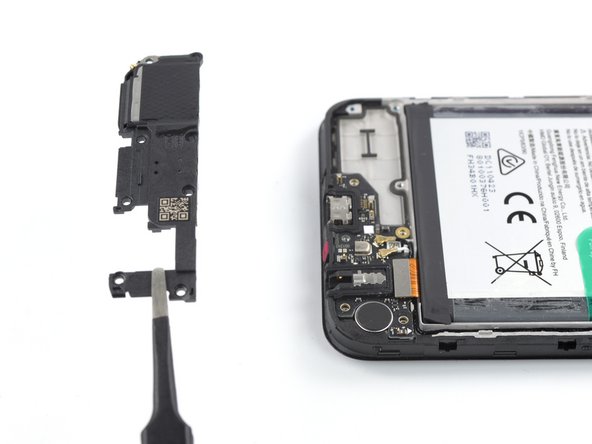

  18. Nokia G42 5G Screen Assembly Replacement, Remove the loudspeaker: crwdns2935265:018crwdnd2935265:01crwdnd2935265:02crwdne2935265:0 Nokia G42 5G Screen Assembly Replacement, Remove the loudspeaker: crwdns2935265:018crwdnd2935265:02crwdnd2935265:02crwdne2935265:0
    • Use a pair of tweezers or your fingers to remove the loudspeaker.

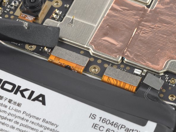

  20. Nokia G42 5G Screen Assembly Replacement, Disconnect the antenna cables: crwdns2935265:020crwdnd2935265:01crwdnd2935265:03crwdne2935265:0 Nokia G42 5G Screen Assembly Replacement, Disconnect the antenna cables: crwdns2935265:020crwdnd2935265:02crwdnd2935265:03crwdne2935265:0 Nokia G42 5G Screen Assembly Replacement, Disconnect the antenna cables: crwdns2935265:020crwdnd2935265:03crwdnd2935265:03crwdne2935265:0
    • Use a spudger to disconnect both antenna cables by prying their connectors straight up from the sockets on the motherboard.
  21. Nokia G42 5G Screen Assembly Replacement, Unseat the antenna cables: crwdns2935265:021crwdnd2935265:01crwdnd2935265:03crwdne2935265:0 Nokia G42 5G Screen Assembly Replacement, Unseat the antenna cables: crwdns2935265:021crwdnd2935265:02crwdnd2935265:03crwdne2935265:0 Nokia G42 5G Screen Assembly Replacement, Unseat the antenna cables: crwdns2935265:021crwdnd2935265:03crwdnd2935265:03crwdne2935265:0
    • Use a pair of tweezers or your fingers to lift the antenna cables out of their recess in the frame.
    • During reassembly, connect the white antenna cable to the motherboard before connecting the black antenna cable. Then reseat the antenna cables into their recess.

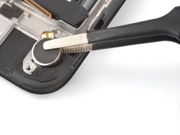

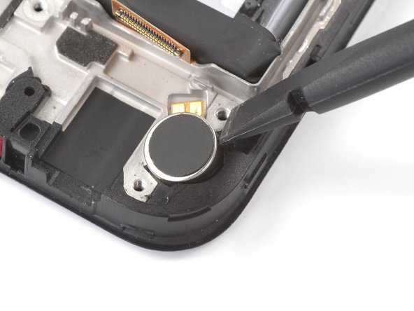

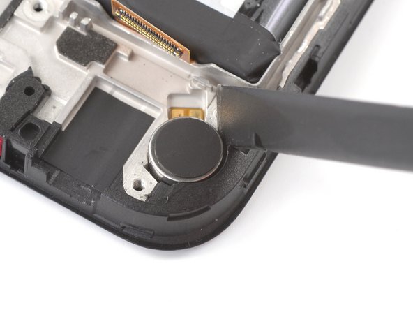

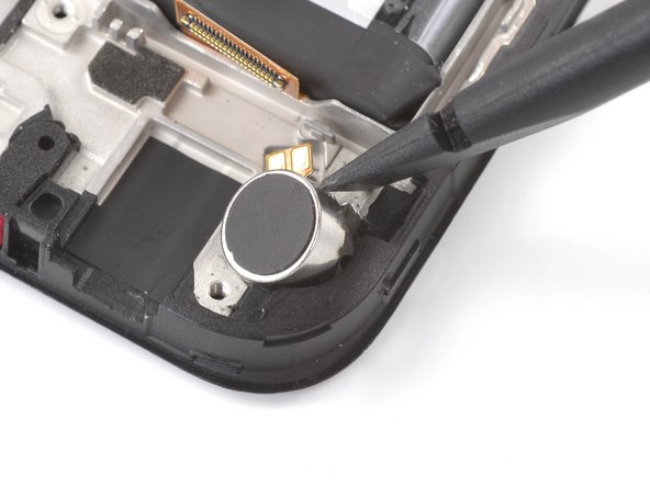

  24. Nokia G42 5G Screen Assembly Replacement, Pry up the vibration motor: crwdns2935265:024crwdnd2935265:01crwdnd2935265:03crwdne2935265:0 Nokia G42 5G Screen Assembly Replacement, Pry up the vibration motor: crwdns2935265:024crwdnd2935265:02crwdnd2935265:03crwdne2935265:0 Nokia G42 5G Screen Assembly Replacement, Pry up the vibration motor: crwdns2935265:024crwdnd2935265:03crwdnd2935265:03crwdne2935265:0
    Tesa 61395 Tape
    $5.99

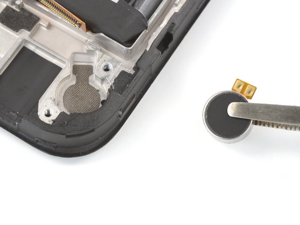

    • The vibration motor is held in place with mild adhesive.
    • Insert the flat end of a spudger into the small recess on the upper right side of the vibration motor.
    • Pivot the spudger up to pry up the vibration motor off of the adhesive securing it underneath.
    • If you can't pry up the vibration motor with a spudger, use pointed tweezers instead.
    • During reassembly, you can reuse the old adhesive if it's still sticky. If not, replace it with new custom cut adhesive, such as Tesa Tape.
  25. Nokia G42 5G Screen Assembly Replacement, Remove the vibration motor: crwdns2935265:025crwdnd2935265:01crwdnd2935265:02crwdne2935265:0 Nokia G42 5G Screen Assembly Replacement, Remove the vibration motor: crwdns2935265:025crwdnd2935265:02crwdnd2935265:02crwdne2935265:0
    • Use a pair of tweezers or your fingers to remove the vibration motor.

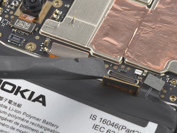

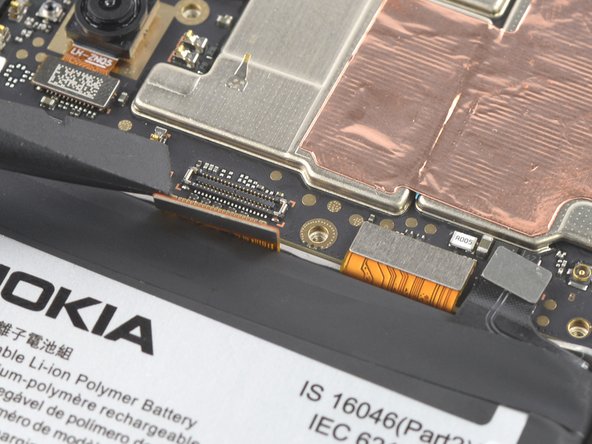

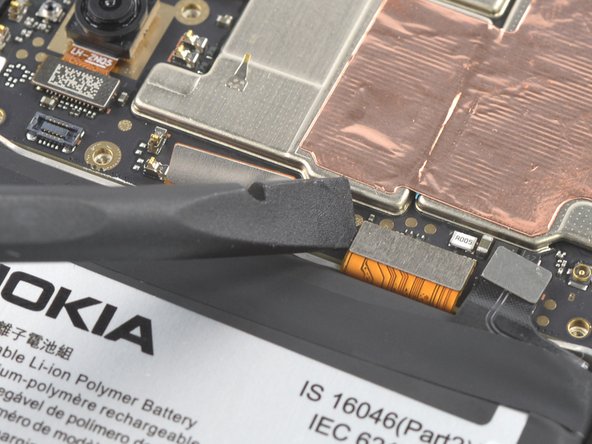

  26. Nokia G42 5G Screen Assembly Replacement, Disconnect the display cable: crwdns2935265:026crwdnd2935265:01crwdnd2935265:02crwdne2935265:0 Nokia G42 5G Screen Assembly Replacement, Disconnect the display cable: crwdns2935265:026crwdnd2935265:02crwdnd2935265:02crwdne2935265:0
    • Use the flat end of a spudger to disconnect the display cable by prying the connector straight up from its socket.
  27. Nokia G42 5G Screen Assembly Replacement, Disconnect the interconnect cable: crwdns2935265:027crwdnd2935265:01crwdnd2935265:02crwdne2935265:0 Nokia G42 5G Screen Assembly Replacement, Disconnect the interconnect cable: crwdns2935265:027crwdnd2935265:02crwdnd2935265:02crwdne2935265:0
    • Use the flat end of a spudger to disconnect the interconnect cable by prying the connector straight up from its socket.
    • To re-attach press connectors like this one, carefully align and press down on one side until it clicks into place, then repeat on the other side. Don't press down on the middle. If the connector is misaligned, the pins can bend and cause permanent damage.

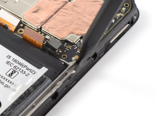

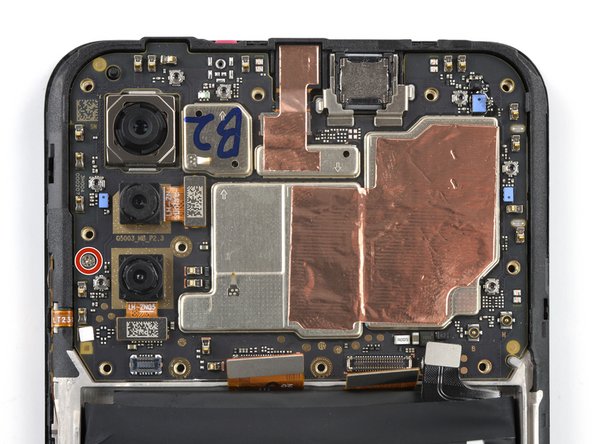

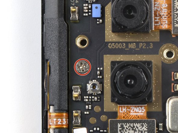

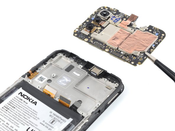

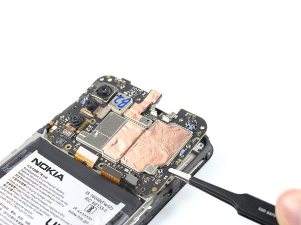

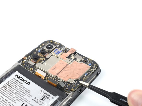

  28. Nokia G42 5G Screen Assembly Replacement, Unfasten the motherboard: crwdns2935265:028crwdnd2935265:01crwdnd2935265:02crwdne2935265:0 Nokia G42 5G Screen Assembly Replacement, Unfasten the motherboard: crwdns2935265:028crwdnd2935265:02crwdnd2935265:02crwdne2935265:0
    • Use a Phillips screwdriver to remove the single 2.8 mm‑long screw securing the motherboard.

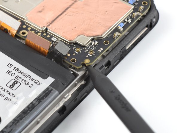

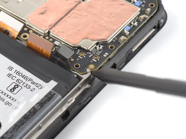

  29. Nokia G42 5G Screen Assembly Replacement, Pry up the motherboard: crwdns2935265:029crwdnd2935265:01crwdnd2935265:03crwdne2935265:0 Nokia G42 5G Screen Assembly Replacement, Pry up the motherboard: crwdns2935265:029crwdnd2935265:02crwdnd2935265:03crwdne2935265:0 Nokia G42 5G Screen Assembly Replacement, Pry up the motherboard: crwdns2935265:029crwdnd2935265:03crwdnd2935265:03crwdne2935265:0
    • Insert the pointed end of a spudger underneath the bottom right corner of the motherboard.
    • Pry the motherboard up until you can grip it with your fingers.
    • During reassembly, clip in the motherboard cover on the top right corner first.
  30. Nokia G42 5G Screen Assembly Replacement, Remove the motherboard: crwdns2935265:030crwdnd2935265:01crwdnd2935265:03crwdne2935265:0 Nokia G42 5G Screen Assembly Replacement, Remove the motherboard: crwdns2935265:030crwdnd2935265:02crwdnd2935265:03crwdne2935265:0 Nokia G42 5G Screen Assembly Replacement, Remove the motherboard: crwdns2935265:030crwdnd2935265:03crwdnd2935265:03crwdne2935265:0
    • Grip the motherboard on the right edge using a pair of tweezers or your fingers.
    • Remove the motherboard.
    • During reassembly, apply small dabs of thermal paste to the marked areas on the new screen assembly. Follow this guide to prepare the motherboard and apply the paste.

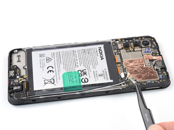

  32. Nokia G42 5G Screen Assembly Replacement, Loosen the battery tabs: crwdns2935265:032crwdnd2935265:01crwdnd2935265:02crwdne2935265:0 Nokia G42 5G Screen Assembly Replacement, Loosen the battery tabs: crwdns2935265:032crwdnd2935265:02crwdnd2935265:02crwdne2935265:0
    • Be extra careful to not puncture, bend, or deform the battery during the next few steps—a damaged battery may leak dangerous chemicals or cause a fire.
    • Use your fingers to peel the two outer adhesive tabs off of the battery.
  33. Nokia G42 5G Screen Assembly Replacement, Lift out the battery: crwdns2935265:033crwdnd2935265:01crwdnd2935265:03crwdne2935265:0 Nokia G42 5G Screen Assembly Replacement, Lift out the battery: crwdns2935265:033crwdnd2935265:02crwdnd2935265:03crwdne2935265:0 Nokia G42 5G Screen Assembly Replacement, Lift out the battery: crwdns2935265:033crwdnd2935265:03crwdnd2935265:03crwdne2935265:0
    • The battery is secured to the frame with adhesive. Pull tabs are provided to separate the adhesive and remove the battery.
    • Use your fingers to peel the center green pull tab off of the battery.
    • Using one hand to hold the phone steady, use your other hand to slowly and steadily lift the center green pull tab up to separate the adhesive securing the battery underneath.
    • If the green pull tab rips, use the outer clear tabs instead.
    • If you have any difficulties with stubborn battery adhesive, you can contact Nokia's phones support.
