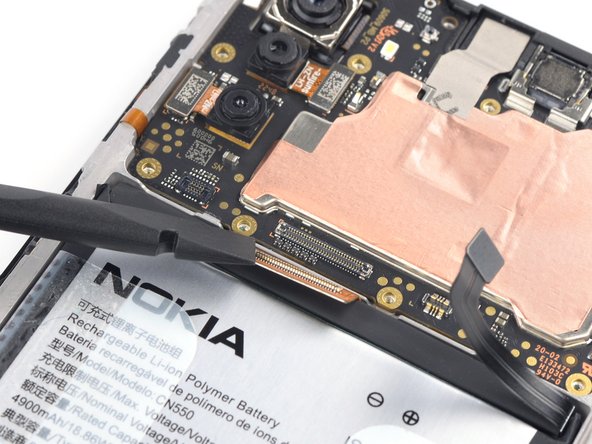

  15. Nokia G22 Screen Assembly Replacement, Disconnect the battery cable: crwdns2935265:015crwdnd2935265:01crwdnd2935265:02crwdne2935265:0 Nokia G22 Screen Assembly Replacement, Disconnect the battery cable: crwdns2935265:015crwdnd2935265:02crwdnd2935265:02crwdne2935265:0
    • Use the flat end of a spudger to disconnect the battery cable by prying the connector straight up from its socket.

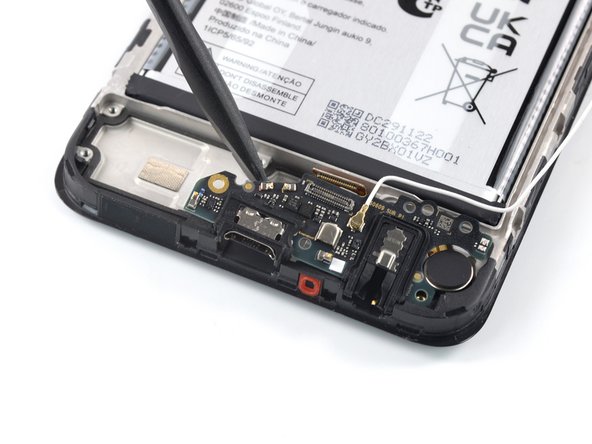

  19. Nokia G22 Screen Assembly Replacement, Disconnect the display cable: crwdns2935265:019crwdnd2935265:01crwdnd2935265:02crwdne2935265:0 Nokia G22 Screen Assembly Replacement, Disconnect the display cable: crwdns2935265:019crwdnd2935265:02crwdnd2935265:02crwdne2935265:0
    • Use the flat end of a spudger to disconnect the display cable by prying the connector straight up from its socket.

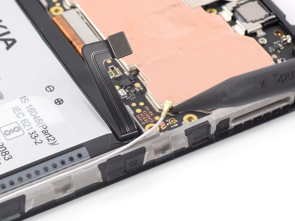

  20. Nokia G22 Screen Assembly Replacement, Disconnect the antenna cable: crwdns2935265:020crwdnd2935265:01crwdnd2935265:02crwdne2935265:0 Nokia G22 Screen Assembly Replacement, Disconnect the antenna cable: crwdns2935265:020crwdnd2935265:02crwdnd2935265:02crwdne2935265:0
    • Use the pointed end of a spudger to disconnect the antenna cable by prying the connector straight up from its socket on the motherboard.
  21. Nokia G22 Screen Assembly Replacement, Unseat the antenna cable: crwdns2935265:021crwdnd2935265:01crwdnd2935265:03crwdne2935265:0 Nokia G22 Screen Assembly Replacement, Unseat the antenna cable: crwdns2935265:021crwdnd2935265:02crwdnd2935265:03crwdne2935265:0 Nokia G22 Screen Assembly Replacement, Unseat the antenna cable: crwdns2935265:021crwdnd2935265:03crwdnd2935265:03crwdne2935265:0
    • Use a pair of tweezers or your fingers to lift the antenna cable out of its recess in the frame.
    • During reassembly, connect the antenna cable to the motherboard before reseating the antenna cable into its recess.

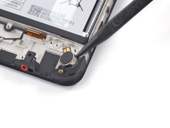

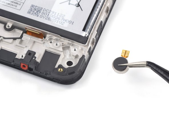

  25. Nokia G22 Screen Assembly Replacement, Remove the vibration motor: crwdns2935265:025crwdnd2935265:01crwdnd2935265:03crwdne2935265:0 Nokia G22 Screen Assembly Replacement, Remove the vibration motor: crwdns2935265:025crwdnd2935265:02crwdnd2935265:03crwdne2935265:0 Nokia G22 Screen Assembly Replacement, Remove the vibration motor: crwdns2935265:025crwdnd2935265:03crwdnd2935265:03crwdne2935265:0
    Tesa 61395 Tape
    $5.99
    • The vibration motor is held in place with mild adhesive.
    • Insert the pointed end of a spudger into the small recess on the upper right side of the vibration motor.
    • Pivot the spudger up to pry up the vibration motor off of the adhesive securing it underneath.
    • Use a pair of tweezers or your fingers to remove the vibration motor.
    • During reassembly, you can reuse the old adhesive if it's still sticky. If not, replace it with new custom cut adhesive, such as Tesa Tape.

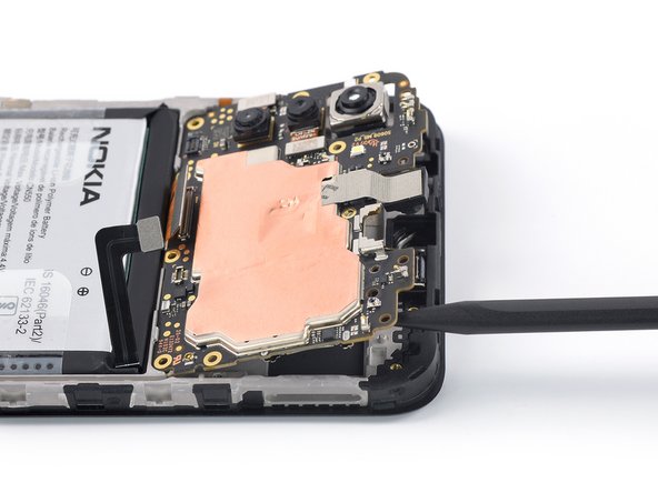

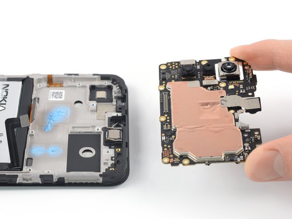

  27. Nokia G22 Screen Assembly Replacement, Unfasten the motherboard: crwdns2935265:027crwdnd2935265:01crwdnd2935265:01crwdne2935265:0
    • Use a Phillips screwdriver to remove the 2.8 mm‑long screw securing the motherboard.
  28. Nokia G22 Screen Assembly Replacement, Pry up the motherboard: crwdns2935265:028crwdnd2935265:01crwdnd2935265:02crwdne2935265:0 Nokia G22 Screen Assembly Replacement, Pry up the motherboard: crwdns2935265:028crwdnd2935265:02crwdnd2935265:02crwdne2935265:0
    • Insert the pointed end of a spudger underneath the top right corner of the motherboard.
    • Pry the motherboard up until you can grip it with your fingers.
  29. Nokia G22 Screen Assembly Replacement, Remove the motherboard: crwdns2935265:029crwdnd2935265:01crwdnd2935265:02crwdne2935265:0 Nokia G22 Screen Assembly Replacement, Remove the motherboard: crwdns2935265:029crwdnd2935265:02crwdnd2935265:02crwdne2935265:0
    • Remove the motherboard.
    • During reassembly apply small beads of thermal paste to the marked areas on the new screen assembly. See this generic guide for detailed steps on how to prepare the motherboard and apply the paste.

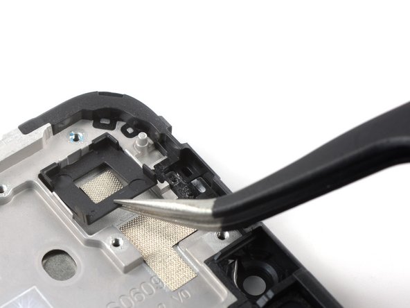

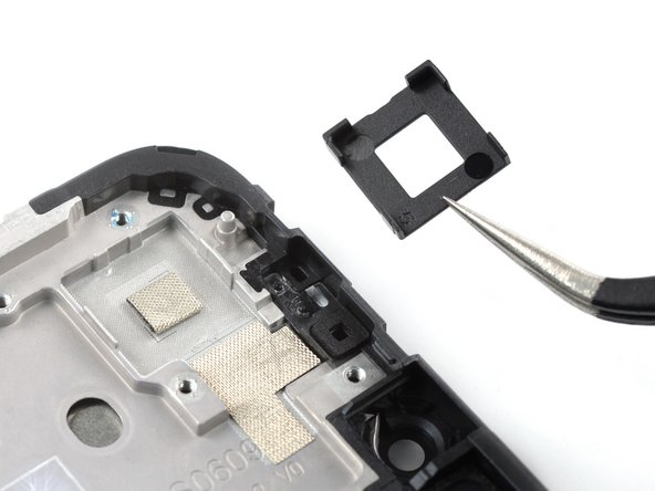

  31. Nokia G22 Screen Assembly Replacement, Remove the camera bracket: crwdns2935265:031crwdnd2935265:01crwdnd2935265:03crwdne2935265:0 Nokia G22 Screen Assembly Replacement, Remove the camera bracket: crwdns2935265:031crwdnd2935265:02crwdnd2935265:03crwdne2935265:0 Nokia G22 Screen Assembly Replacement, Remove the camera bracket: crwdns2935265:031crwdnd2935265:03crwdnd2935265:03crwdne2935265:0
    • If your new screen assembly comes with a camera bracket you can skip this step. If not you’ll need to transfer the bracket or apply a new one.
    • Use a pair of tweezers to remove the black camera bracket.
    • The camera bracket is held in place with mild adhesive.
    • During reassembly, transfer the old camera bracket or install a new bracket for the new screen assembly.

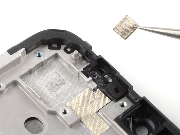

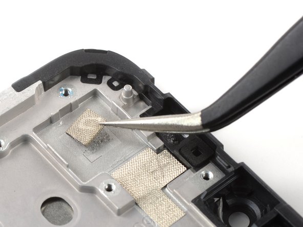

  32. Nokia G22 Screen Assembly Replacement, Remove the foam pad: crwdns2935265:032crwdnd2935265:01crwdnd2935265:03crwdne2935265:0 Nokia G22 Screen Assembly Replacement, Remove the foam pad: crwdns2935265:032crwdnd2935265:02crwdnd2935265:03crwdne2935265:0 Nokia G22 Screen Assembly Replacement, Remove the foam pad: crwdns2935265:032crwdnd2935265:03crwdnd2935265:03crwdne2935265:0
    • If your new screen assembly comes with a foam pad you can skip this step. If not you’ll need to transfer the old pad or apply a new one.
    • Use a pair of tweezers to carefully peel the foam off of the frame to remove it.
    • The foam pad in the camera recess is held in place with mild adhesive.
    • During reassembly, transfer the old foam pad or install a new one for the new screen assembly. You can install the camera bracket first to help orient the foam pad.

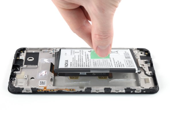

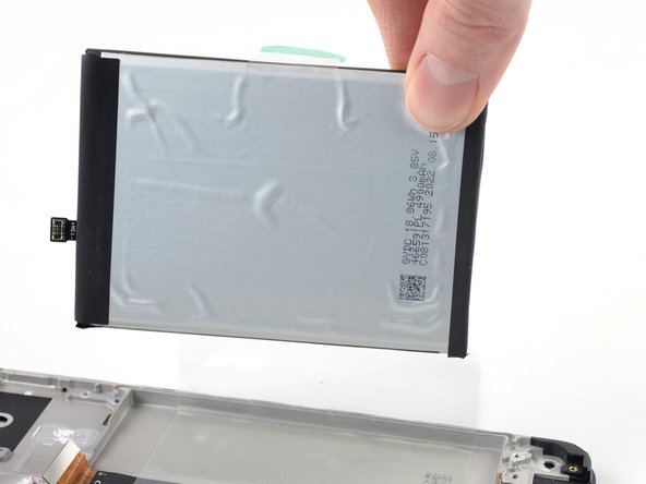

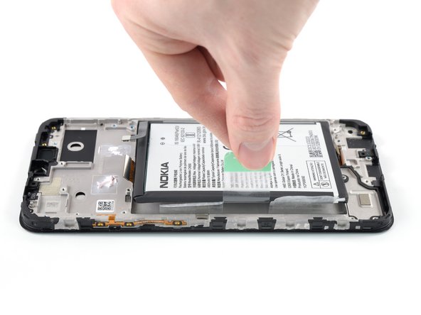

  33. Nokia G22 Screen Assembly Replacement, Loosen the battery tabs: crwdns2935265:033crwdnd2935265:01crwdnd2935265:02crwdne2935265:0 Nokia G22 Screen Assembly Replacement, Loosen the battery tabs: crwdns2935265:033crwdnd2935265:02crwdnd2935265:02crwdne2935265:0
    • Be extra careful to not puncture, bend, or deform the battery during the next few steps—a damaged battery may leak dangerous chemicals or cause a fire.
    • Use your fingers to peel the two outer adhesive tabs off of the battery.
  34. Nokia G22 Screen Assembly Replacement, Lift out the battery: crwdns2935265:034crwdnd2935265:01crwdnd2935265:03crwdne2935265:0 Nokia G22 Screen Assembly Replacement, Lift out the battery: crwdns2935265:034crwdnd2935265:02crwdnd2935265:03crwdne2935265:0 Nokia G22 Screen Assembly Replacement, Lift out the battery: crwdns2935265:034crwdnd2935265:03crwdnd2935265:03crwdne2935265:0
    • The battery in the Nokia G22 is secured with adhesive. A pull tab is provided to separate the adhesive and remove the battery.
    • Use your fingers to peel the center green pull tab off of the battery.
    • Using one hand to hold the phone down, use your other hand to slowly and steadily lift the center green pull tab up to separate the adhesive securing the battery underneath.
    • If the green pull tab should rip, you can use the outer tabs to pull out the battery including the adhesive film underneath. Be aware that therefore this will take more time and probably some heat to soften the adhesive.
    • If you have any difficulties with stubborn battery adhesive, you can contact "Nokia phones support".

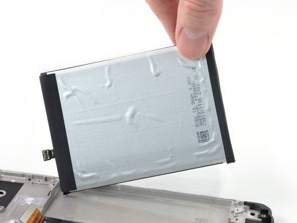

  35. Nokia G22 Screen Assembly Replacement, Remove the battery: crwdns2935265:035crwdnd2935265:01crwdnd2935265:03crwdne2935265:0 Nokia G22 Screen Assembly Replacement, Remove the battery: crwdns2935265:035crwdnd2935265:02crwdnd2935265:03crwdne2935265:0 Nokia G22 Screen Assembly Replacement, Remove the battery: crwdns2935265:035crwdnd2935265:03crwdnd2935265:03crwdne2935265:0
    • Peel the battery off of the adhesive film and remove it.

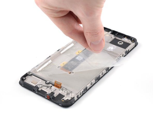

  36. Nokia G22 Screen Assembly Replacement, Remove the battery adhesive film: crwdns2935265:036crwdnd2935265:01crwdnd2935265:03crwdne2935265:0 Nokia G22 Screen Assembly Replacement, Remove the battery adhesive film: crwdns2935265:036crwdnd2935265:02crwdnd2935265:03crwdne2935265:0 Nokia G22 Screen Assembly Replacement, Remove the battery adhesive film: crwdns2935265:036crwdnd2935265:03crwdnd2935265:03crwdne2935265:0
    • Grab the bottom right edge of the leftover adhesive film and pull it towards the top of the phone with steady force to remove it.
    • During reassembly, follow these instructions to apply a new battery adhesive film:
    • Remove the battery adhesive film from its liners and apply it to the battery.
    • Align the bottom edge of the battery (the edge without adhesive) with the bottom edge of the recess.
    • Lower the battery with its film down and press firmly to secure it in place.

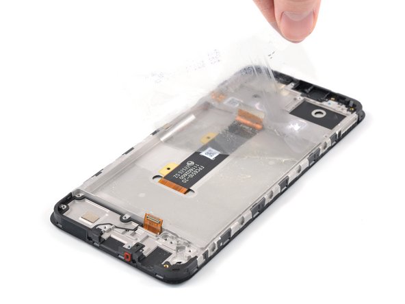

  37. Nokia G22 Screen Assembly Replacement, Only the screen assembly remains: crwdns2935265:037crwdnd2935265:01crwdnd2935265:01crwdne2935265:0
    • Only the screen assembly remains.
    • During reassembly, compare your new replacement assembly to the original part:
    • If your part comes with battery adhesive pre-installed, remove its plastic liners before continuing to the previous step.
    • If your part has no battery adhesive, remove the clear liner on the pre-cut battery adhesive and apply the sticky section to the battery well. Remove the opaque liner before continuing to the previous step.
    • If you're reusing your original battery, carefully inspect it for any signs of physical damage. If it's bent, creased, dented or scratched, replace it with a new battery. Installing a damaged battery is a safety hazard.
