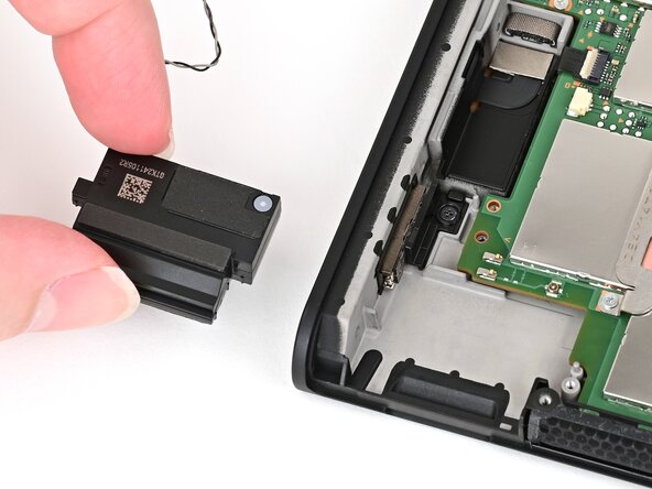

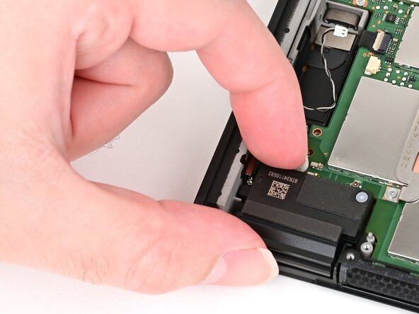

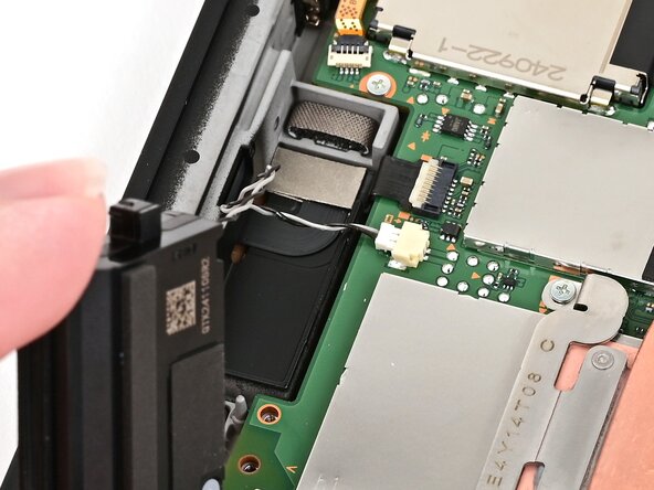

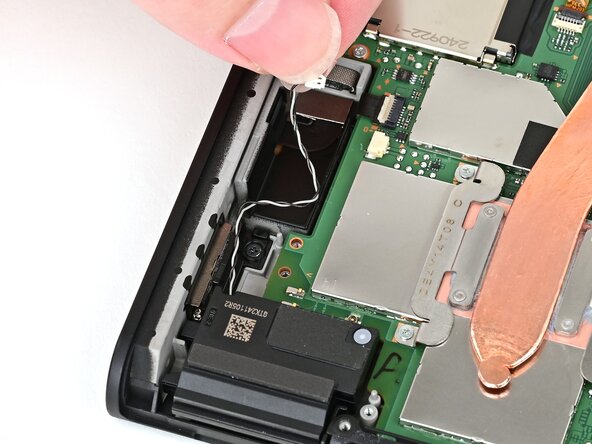

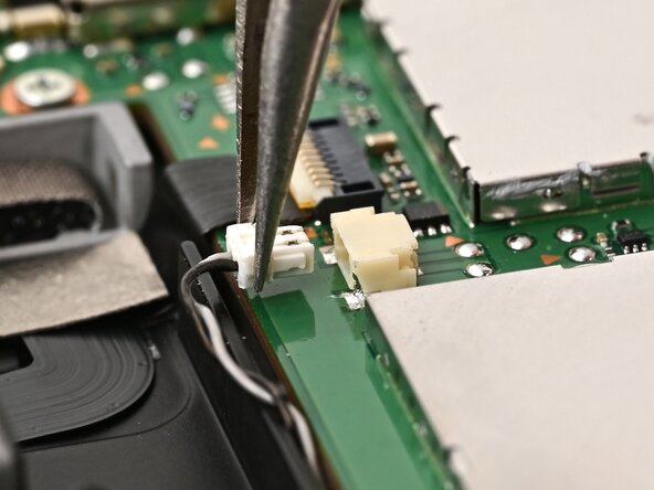

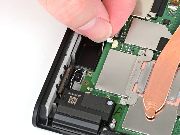

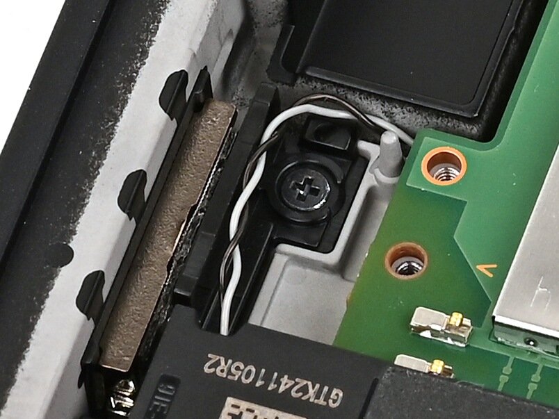

  35. Nintendo Switch 2 Speakers Replacement, Disconnect the left speaker: crwdns2935265:035crwdnd2935265:01crwdnd2935265:02crwdne2935265:0 Nintendo Switch 2 Speakers Replacement, Disconnect the left speaker: crwdns2935265:035crwdnd2935265:02crwdnd2935265:02crwdne2935265:0
    • Use tweezers or your fingers to firmly grip the left speaker cable's white JST connector and pull straight away from its socket to disconnect it.

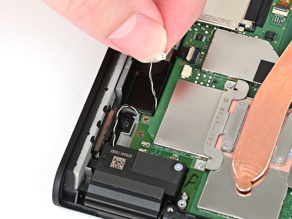

  36. Nintendo Switch 2 Speakers Replacement, Remove the left speaker: crwdns2935265:036crwdnd2935265:01crwdnd2935265:03crwdne2935265:0 Nintendo Switch 2 Speakers Replacement, Remove the left speaker: crwdns2935265:036crwdnd2935265:02crwdnd2935265:03crwdne2935265:0 Nintendo Switch 2 Speakers Replacement, Remove the left speaker: crwdns2935265:036crwdnd2935265:03crwdnd2935265:03crwdne2935265:0
    • Lift the speaker out of its recess and route its cable out from beneath the battery cable.
    • Remove the left speaker.

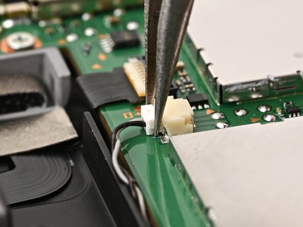

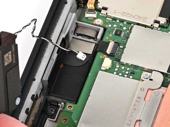

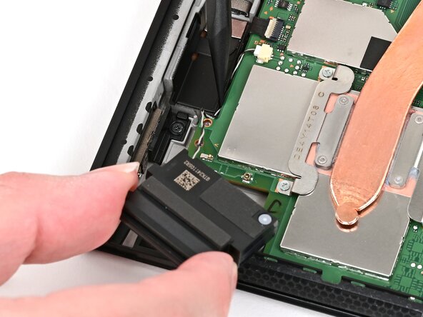

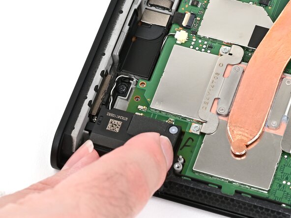

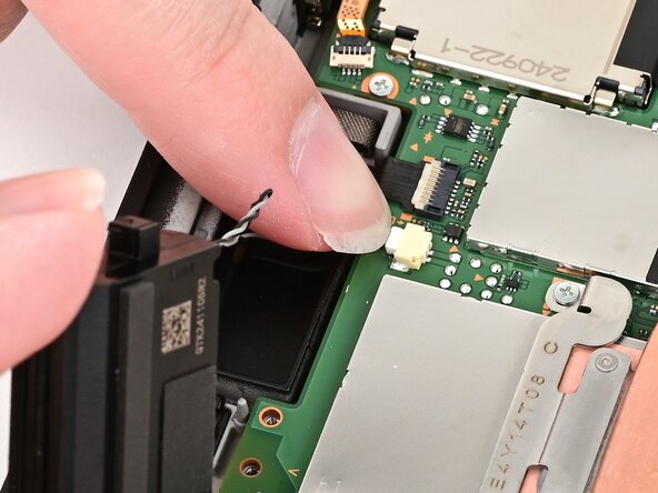

  37. Nintendo Switch 2 Speakers Replacement, Disconnect the right speaker: crwdns2935265:037crwdnd2935265:01crwdnd2935265:02crwdne2935265:0 Nintendo Switch 2 Speakers Replacement, Disconnect the right speaker: crwdns2935265:037crwdnd2935265:02crwdnd2935265:02crwdne2935265:0
    • Use tweezers or your fingers to firmly grip the right speaker cable's white JST connector and pull straight away from its socket to disconnect it.
  38. Nintendo Switch 2 Speakers Replacement, Unroute the right speaker cable: crwdns2935265:038crwdnd2935265:01crwdnd2935265:03crwdne2935265:0 Nintendo Switch 2 Speakers Replacement, Unroute the right speaker cable: crwdns2935265:038crwdnd2935265:02crwdnd2935265:03crwdne2935265:0 Nintendo Switch 2 Speakers Replacement, Unroute the right speaker cable: crwdns2935265:038crwdnd2935265:03crwdnd2935265:03crwdne2935265:0
    • Pull the right speaker cable out from beneath the board until it's free.
  39. Nintendo Switch 2 Speakers Replacement, Remove the right speaker: crwdns2935265:039crwdnd2935265:01crwdnd2935265:02crwdne2935265:0 Nintendo Switch 2 Speakers Replacement, Remove the right speaker: crwdns2935265:039crwdnd2935265:02crwdnd2935265:02crwdne2935265:0
    • Pick up the right speaker by its housing and remove it.

    • Lower the shield plate into place and align it with its screw holes.
  49. Nintendo Switch 2 Speakers Replacement, Finish routing the gray antenna cable: crwdns2935265:049crwdnd2935265:01crwdnd2935265:03crwdne2935265:0 Nintendo Switch 2 Speakers Replacement, Finish routing the gray antenna cable: crwdns2935265:049crwdnd2935265:02crwdnd2935265:03crwdne2935265:0 Nintendo Switch 2 Speakers Replacement, Finish routing the gray antenna cable: crwdns2935265:049crwdnd2935265:03crwdnd2935265:03crwdne2935265:0
    • Route the gray antenna cable down its channel on the right edge of the frame.
  50. Nintendo Switch 2 Speakers Replacement: crwdns2935265:050crwdnd2935265:01crwdnd2935265:03crwdne2935265:0 Nintendo Switch 2 Speakers Replacement: crwdns2935265:050crwdnd2935265:02crwdnd2935265:03crwdne2935265:0 Nintendo Switch 2 Speakers Replacement: crwdns2935265:050crwdnd2935265:03crwdnd2935265:03crwdne2935265:0
    • Press the gray antenna cable into its groove at the bottom of its channel, and continue routing until it's secured to the clip at the bottom of the frame.
  51. Nintendo Switch 2 Speakers Replacement, Install the shield plate screws: crwdns2935265:051crwdnd2935265:01crwdnd2935265:02crwdne2935265:0 Nintendo Switch 2 Speakers Replacement, Install the shield plate screws: crwdns2935265:051crwdnd2935265:02crwdnd2935265:02crwdne2935265:0
    • Use a JIS 00 driver to install the seven screws securing the shield plate:
    • Two 6.2 mm‑long silver screws
    • Five 4.4 mm‑long silver screws
  52. Nintendo Switch 2 Speakers Replacement, Connect the MicroSD connector: crwdns2935265:052crwdnd2935265:01crwdnd2935265:02crwdne2935265:0 Nintendo Switch 2 Speakers Replacement, Connect the MicroSD connector: crwdns2935265:052crwdnd2935265:02crwdnd2935265:02crwdne2935265:0
    • Use your finger or the flat end of a spudger to press the MicroSD card reader press connector onto its socket on the board.
    • Don't try to force the connector into place. If you're having trouble, reposition it and try again.
  53. Nintendo Switch 2 Speakers Replacement, Connect the antenna cables: crwdns2935265:053crwdnd2935265:01crwdnd2935265:03crwdne2935265:0 Nintendo Switch 2 Speakers Replacement, Connect the antenna cables: crwdns2935265:053crwdnd2935265:02crwdnd2935265:03crwdne2935265:0 Nintendo Switch 2 Speakers Replacement, Connect the antenna cables: crwdns2935265:053crwdnd2935265:03crwdnd2935265:03crwdne2935265:0
    • Use tweezers to hold the lower antenna coaxial connector in place over its socket and gently press down with your finger or a spudger—the connector should "snap" into place. If you're having trouble, reposition the head instead of using more force.
    • Repeat this process to connect the three central coaxial connectors to their respective sockets.
    • The black cable connects to the socket closest to the fan, the white to the middle, and the gray the furthest away.
  54. Nintendo Switch 2 Speakers Replacement, Install the upper antenna: crwdns2935265:054crwdnd2935265:01crwdnd2935265:03crwdne2935265:0 Nintendo Switch 2 Speakers Replacement, Install the upper antenna: crwdns2935265:054crwdnd2935265:02crwdnd2935265:03crwdne2935265:0 Nintendo Switch 2 Speakers Replacement, Install the upper antenna: crwdns2935265:054crwdnd2935265:03crwdnd2935265:03crwdne2935265:0
    • Use tweezers or your fingers to align the upper antenna with its screw holes and black alignment pegs and set it into place.
    • Use a JIS 00 driver to install the two screws securing the upper antenna:
    • One 4.4 mm‑long silver screw
    • One 4.6 mm‑long green screw
  55. Nintendo Switch 2 Speakers Replacement, Install the lower antenna: crwdns2935265:055crwdnd2935265:01crwdnd2935265:03crwdne2935265:0 Nintendo Switch 2 Speakers Replacement, Install the lower antenna: crwdns2935265:055crwdnd2935265:02crwdnd2935265:03crwdne2935265:0 Nintendo Switch 2 Speakers Replacement, Install the lower antenna: crwdns2935265:055crwdnd2935265:03crwdnd2935265:03crwdne2935265:0
    • Use tweezers or your fingers to align the lower antenna with its screw holes and gray alignment pegs and set it into place.
    • Use a JIS 00 driver to install the three 4.4 mm‑long screws securing the lower antenna.
  56. Nintendo Switch 2 Speakers Replacement, Prepare the back cover: crwdns2935265:056crwdnd2935265:01crwdnd2935265:03crwdne2935265:0 Nintendo Switch 2 Speakers Replacement, Prepare the back cover: crwdns2935265:056crwdnd2935265:02crwdnd2935265:03crwdne2935265:0 Nintendo Switch 2 Speakers Replacement, Prepare the back cover: crwdns2935265:056crwdnd2935265:03crwdnd2935265:03crwdne2935265:0
    • Fully pull out the game card tray.
    • Double-check the power and volume buttons to ensure they're seated correctly. If the rubber membrane beneath the buttons is out of place, ensure it's aligned with its pegs.
    • Check the microphone to ensure it's fully seated in its slot in the frame.
  57. Nintendo Switch 2 Speakers Replacement, Install the back cover: crwdns2935265:057crwdnd2935265:01crwdnd2935265:03crwdne2935265:0 Nintendo Switch 2 Speakers Replacement, Install the back cover: crwdns2935265:057crwdnd2935265:02crwdnd2935265:03crwdne2935265:0 Nintendo Switch 2 Speakers Replacement, Install the back cover: crwdns2935265:057crwdnd2935265:03crwdnd2935265:03crwdne2935265:0
    • Align the top of the back cover with the top of the console.
    • Set the top edge of the back cover into place, checking the buttons and ports to ensure they're aligned properly. If they aren't, lift the back cover and try again.
    • Press along the top edge to fasten the clips securing the back cover to the console.
  58. Nintendo Switch 2 Speakers Replacement: crwdns2935265:058crwdnd2935265:01crwdnd2935265:02crwdne2935265:0 Nintendo Switch 2 Speakers Replacement: crwdns2935265:058crwdnd2935265:02crwdnd2935265:02crwdne2935265:0
    • Squeeze the rest of the back cover and console together to fasten the clips.
  59. Nintendo Switch 2 Speakers Replacement, Install the back-side screws: crwdns2935265:059crwdnd2935265:01crwdnd2935265:03crwdne2935265:0 Nintendo Switch 2 Speakers Replacement, Install the back-side screws: crwdns2935265:059crwdnd2935265:02crwdnd2935265:03crwdne2935265:0 Nintendo Switch 2 Speakers Replacement, Install the back-side screws: crwdns2935265:059crwdnd2935265:03crwdnd2935265:03crwdne2935265:0
    • Use a JIS 00 driver to install the three 3.1 mm‑long screws securing the back cover: one on the top edge of the console, and two on either side of the bottom USB-C port.
    • Use a Y00 driver to install the two 4.4 mm‑long screws in the kickstand cutout.
  60. Nintendo Switch 2 Speakers Replacement, Install the side screws: crwdns2935265:060crwdnd2935265:01crwdnd2935265:02crwdne2935265:0 Nintendo Switch 2 Speakers Replacement, Install the side screws: crwdns2935265:060crwdnd2935265:02crwdnd2935265:02crwdne2935265:0
    • Install the two 3.6 mm‑long gold screws on each side of the console (four in total).
  61. Nintendo Switch 2 Speakers Replacement, Test the console: crwdns2935265:061crwdnd2935265:01crwdnd2935265:02crwdne2935265:0 Nintendo Switch 2 Speakers Replacement, Test the console: crwdns2935265:061crwdnd2935265:02crwdnd2935265:02crwdne2935265:0
    • Power on the console and test functionality to ensure it's working as expected.
  62. Nintendo Switch 2 Speakers Replacement, Install the stickers: crwdns2935265:062crwdnd2935265:01crwdnd2935265:03crwdne2935265:0 Nintendo Switch 2 Speakers Replacement, Install the stickers: crwdns2935265:062crwdnd2935265:02crwdnd2935265:03crwdne2935265:0 Nintendo Switch 2 Speakers Replacement, Install the stickers: crwdns2935265:062crwdnd2935265:03crwdnd2935265:03crwdne2935265:0
    • Align the right side sticker with its recess. Ensure the cutout in the sticker is aligned with the Joy-Con connector.
    • Set the sticker into its recess, first on one side, then the other.
    • Use your finger or the flat end of a spudger to press the sticker into place.
    • If the sticker isn't sticking well, apply heat after you press it into place.
  63. Nintendo Switch 2 Speakers Replacement: crwdns2935265:063crwdnd2935265:01crwdnd2935265:03crwdne2935265:0 Nintendo Switch 2 Speakers Replacement: crwdns2935265:063crwdnd2935265:02crwdnd2935265:03crwdne2935265:0 Nintendo Switch 2 Speakers Replacement: crwdns2935265:063crwdnd2935265:03crwdnd2935265:03crwdne2935265:0
    • Repeat this procedure to install the left side sticker.
