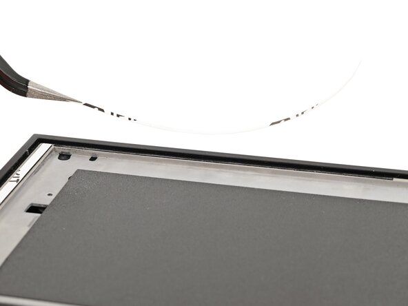

  5. Nintendo Switch 2 Screen Replacement, Pry up the right side sticker: crwdns2935265:05crwdnd2935265:01crwdnd2935265:03crwdne2935265:0 Nintendo Switch 2 Screen Replacement, Pry up the right side sticker: crwdns2935265:05crwdnd2935265:02crwdnd2935265:03crwdne2935265:0 Nintendo Switch 2 Screen Replacement, Pry up the right side sticker: crwdns2935265:05crwdnd2935265:03crwdnd2935265:03crwdne2935265:0
    • The pointed end of the tweezers can damage the sticker from the underside, leaving a noticeable mark. If it's difficult to lift, apply more heat instead of using more force.
    • Slide one arm of angled tweezers underneath the sticker from its cutout around the right Joy‑Con 2 connector.
    • Gently pry up on the sticker until it starts to lift from the console.
    • Leave the tweezers in place to keep the sticker lifted.

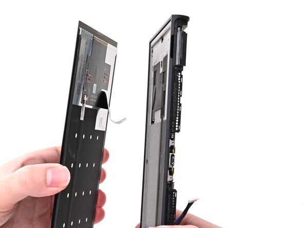

  29. Nintendo Switch 2 Screen Replacement, Unroute the gray antenna cable: crwdns2935265:029crwdnd2935265:01crwdnd2935265:03crwdne2935265:0 Nintendo Switch 2 Screen Replacement, Unroute the gray antenna cable: crwdns2935265:029crwdnd2935265:02crwdnd2935265:03crwdne2935265:0 Nintendo Switch 2 Screen Replacement, Unroute the gray antenna cable: crwdns2935265:029crwdnd2935265:03crwdnd2935265:03crwdne2935265:0
    • Insert one arm of angled tweezers underneath the gray antenna cable at the bottom-right corner of the console.
    • Lift the cable out of the black clip securing it to the frame.
  30. Nintendo Switch 2 Screen Replacement: crwdns2935265:030crwdnd2935265:01crwdnd2935265:03crwdne2935265:0 Nintendo Switch 2 Screen Replacement: crwdns2935265:030crwdnd2935265:02crwdnd2935265:03crwdne2935265:0 Nintendo Switch 2 Screen Replacement: crwdns2935265:030crwdnd2935265:03crwdnd2935265:03crwdne2935265:0
    • Unroute the gray antenna cable from its channel along the right edge of the console.
  31. Nintendo Switch 2 Screen Replacement: crwdns2935265:031crwdnd2935265:01crwdnd2935265:02crwdne2935265:0 Nintendo Switch 2 Screen Replacement: crwdns2935265:031crwdnd2935265:02crwdnd2935265:02crwdne2935265:0
    • Lift and slide the shield plate away from the right edge of the console until the gray antenna cable is completely free.
  32. Nintendo Switch 2 Screen Replacement, Remove the shield plate: crwdns2935265:032crwdnd2935265:01crwdnd2935265:02crwdne2935265:0 Nintendo Switch 2 Screen Replacement, Remove the shield plate: crwdns2935265:032crwdnd2935265:02crwdnd2935265:02crwdne2935265:0
    • Pick up and remove the shield plate.

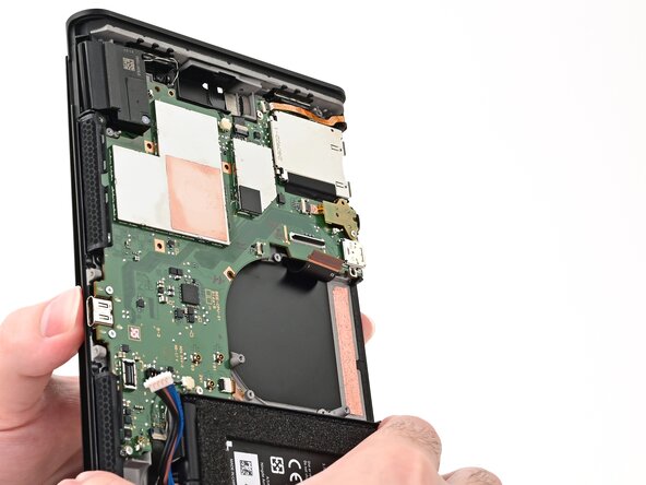

  33. Nintendo Switch 2 Screen Replacement, Disconnect the battery: crwdns2935265:033crwdnd2935265:01crwdnd2935265:02crwdne2935265:0 Nintendo Switch 2 Screen Replacement, Disconnect the battery: crwdns2935265:033crwdnd2935265:02crwdnd2935265:02crwdne2935265:0
    • Insert the flat end of a spudger underneath the flat-topped battery connector, located next to the battery, and pry up to disconnect it.

  40. Nintendo Switch 2 Screen Replacement, Disconnect the fan: crwdns2935265:040crwdnd2935265:01crwdnd2935265:02crwdne2935265:0 Nintendo Switch 2 Screen Replacement, Disconnect the fan: crwdns2935265:040crwdnd2935265:02crwdnd2935265:02crwdne2935265:0
    • Use the point of a spudger to flip up the locking flap on the fan cable ZIF connector, located next to the fan on the console's board.
  41. Nintendo Switch 2 Screen Replacement: crwdns2935265:041crwdnd2935265:01crwdnd2935265:03crwdne2935265:0 Nintendo Switch 2 Screen Replacement: crwdns2935265:041crwdnd2935265:02crwdnd2935265:03crwdne2935265:0 Nintendo Switch 2 Screen Replacement: crwdns2935265:041crwdnd2935265:03crwdnd2935265:03crwdne2935265:0
    • Use tweezers or your fingers to gently pull the cable out of its socket.
    • If you're using tweezers, pull the cable out by its "wings" instead of gripping the cable itself.
  42. Nintendo Switch 2 Screen Replacement, Remove the fan screws: crwdns2935265:042crwdnd2935265:01crwdnd2935265:02crwdne2935265:0 Nintendo Switch 2 Screen Replacement, Remove the fan screws: crwdns2935265:042crwdnd2935265:02crwdnd2935265:02crwdne2935265:0
    • Use a JIS 00 driver to remove the three 5.2 mm‑long silver screws securing the fan.
  43. Nintendo Switch 2 Screen Replacement, Remove the fan: crwdns2935265:043crwdnd2935265:01crwdnd2935265:03crwdne2935265:0 Nintendo Switch 2 Screen Replacement, Remove the fan: crwdns2935265:043crwdnd2935265:02crwdnd2935265:03crwdne2935265:0 Nintendo Switch 2 Screen Replacement, Remove the fan: crwdns2935265:043crwdnd2935265:03crwdnd2935265:03crwdne2935265:0
    • Slide the fan out of its recess to free its cable, then pick it up to remove it.

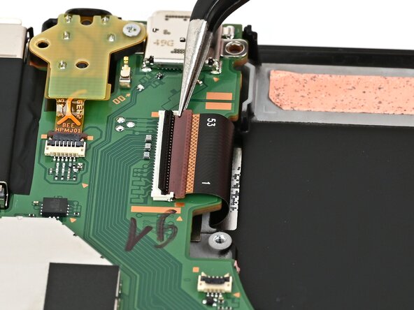

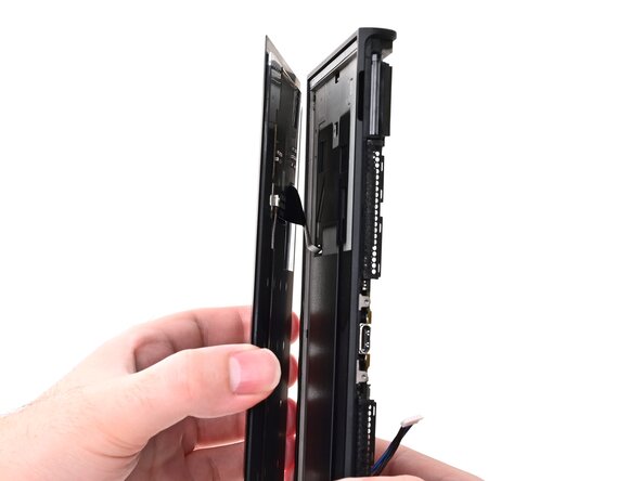

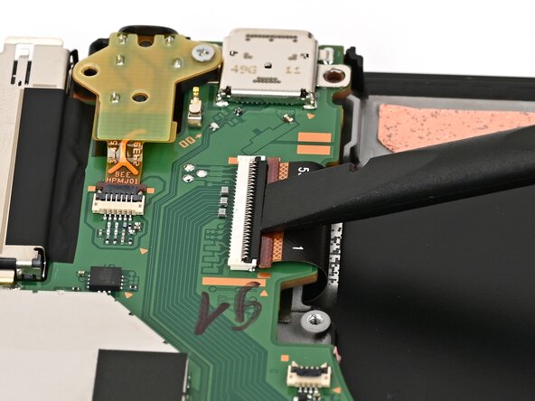

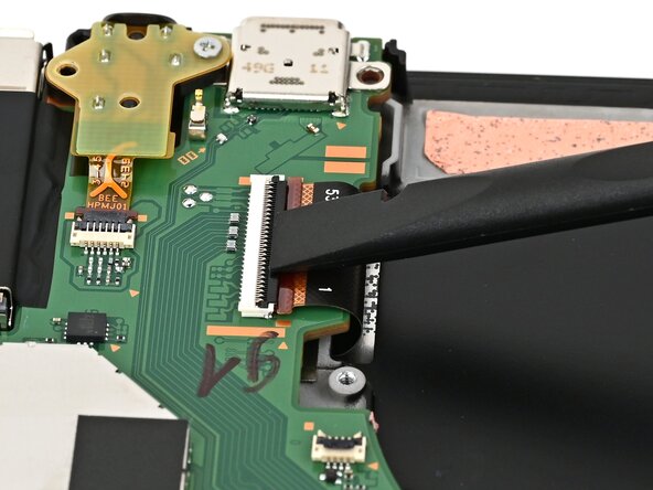

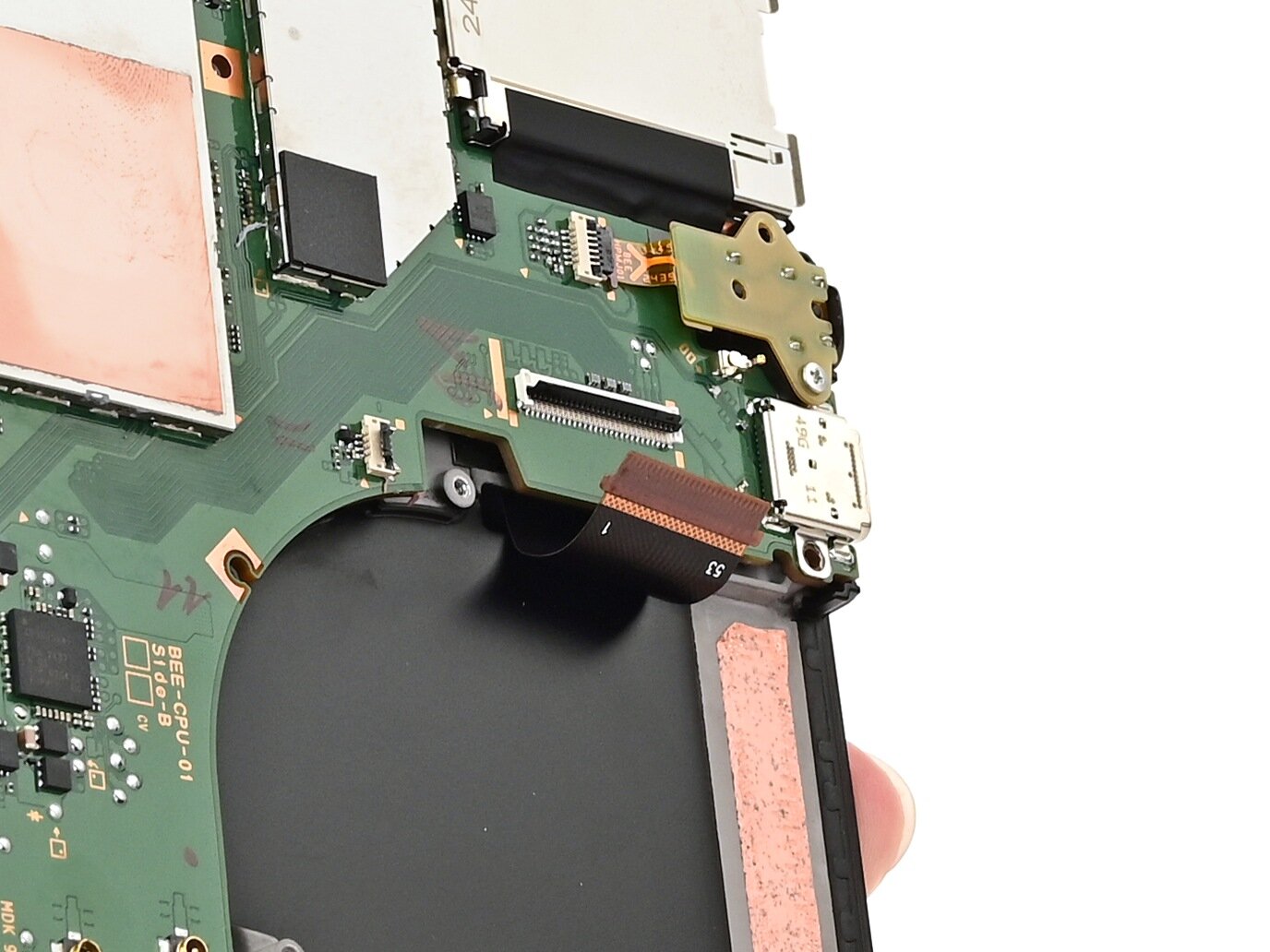

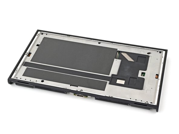

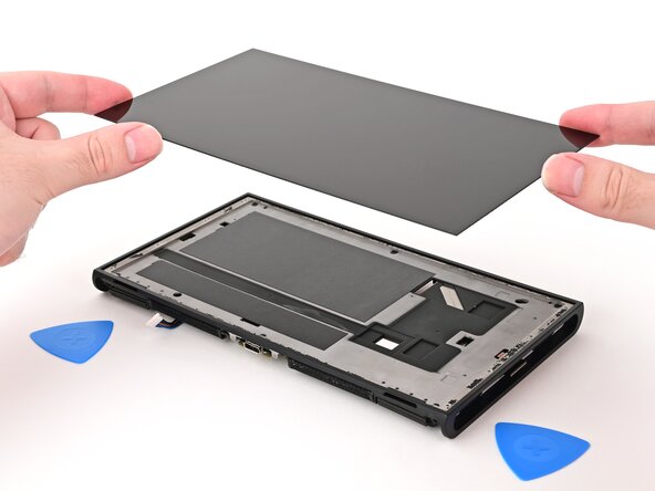

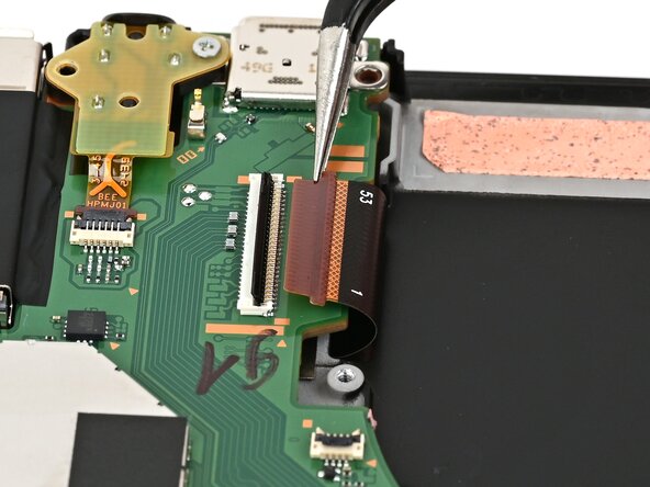

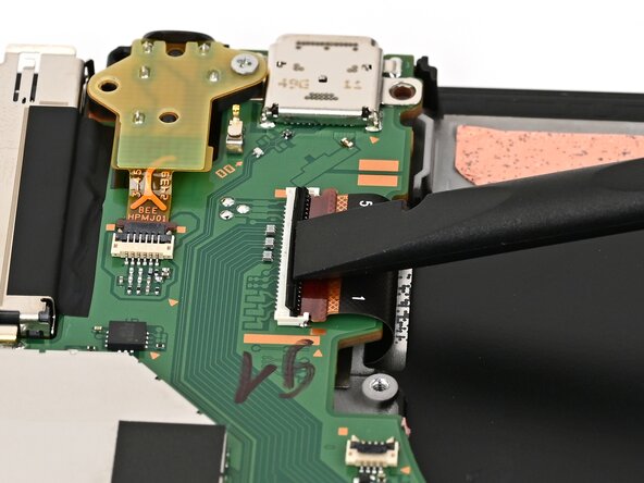

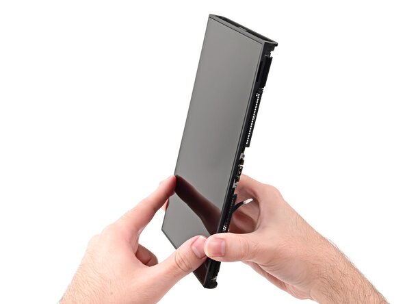

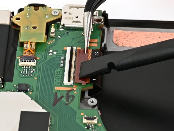

  44. Nintendo Switch 2 Screen Replacement, Disconnect the screen: crwdns2935265:044crwdnd2935265:01crwdnd2935265:02crwdne2935265:0 Nintendo Switch 2 Screen Replacement, Disconnect the screen: crwdns2935265:044crwdnd2935265:02crwdnd2935265:02crwdne2935265:0
    • Use your finger or the flat end of a spudger to flip up the locking flap on the screen cable ZIF connector.
  45. Nintendo Switch 2 Screen Replacement: crwdns2935265:045crwdnd2935265:01crwdnd2935265:02crwdne2935265:0 Nintendo Switch 2 Screen Replacement: crwdns2935265:045crwdnd2935265:02crwdnd2935265:02crwdne2935265:0
    • Use tweezers or your fingers to gently pull the cable out of its connector.

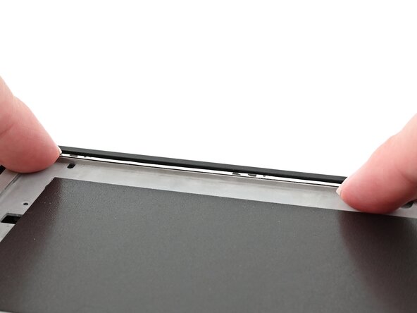

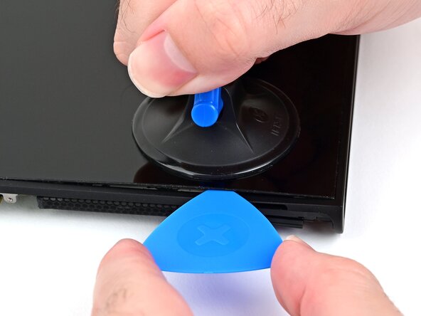

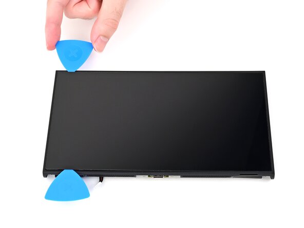

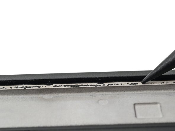

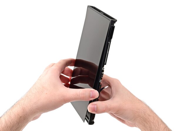

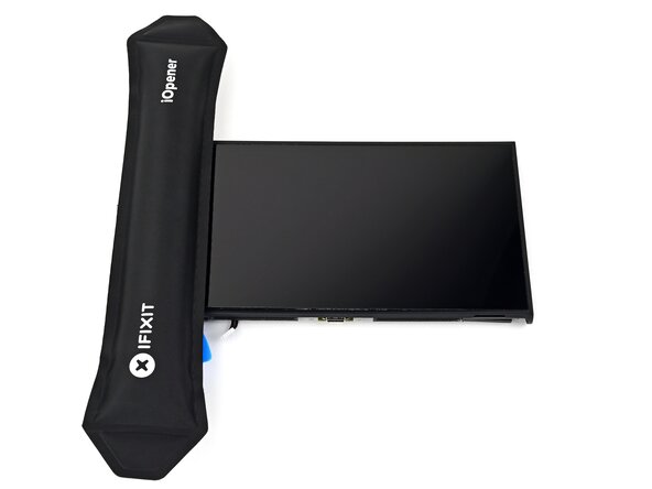

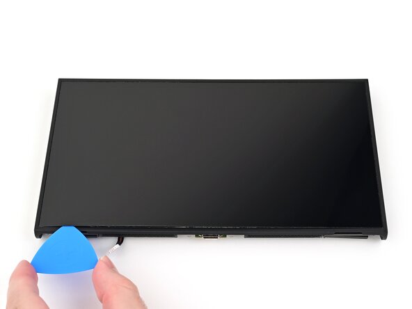

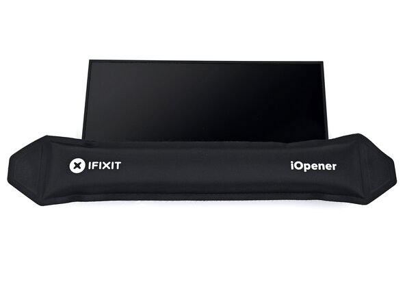

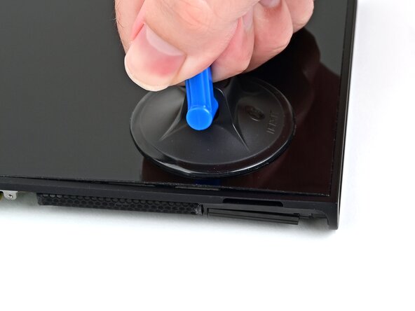

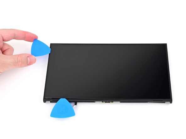

  46. Nintendo Switch 2 Screen Replacement, Heat the bottom edge: crwdns2935265:046crwdnd2935265:01crwdnd2935265:01crwdne2935265:0
    • Flip the console over so the screen is facing up.
    • Apply a heated iOpener to the bottom edge of the screen for two minutes.
    • Alternatively, you can use a hair dryer or heat gun to heat the bottom edge of the screen until it's hot to the touch.

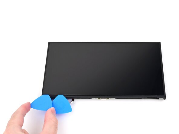

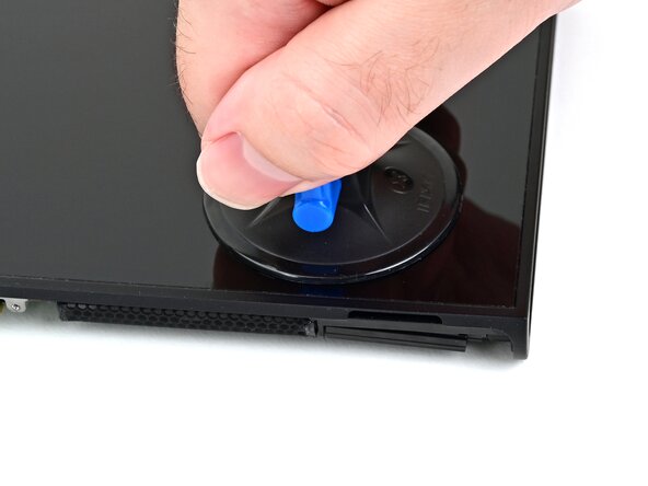

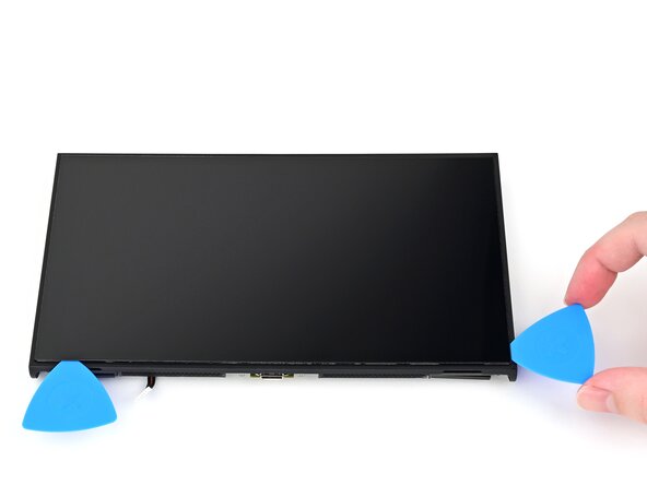

  47. Nintendo Switch 2 Screen Replacement, Insert an opening pick: crwdns2935265:047crwdnd2935265:01crwdnd2935265:03crwdne2935265:0 Nintendo Switch 2 Screen Replacement, Insert an opening pick: crwdns2935265:047crwdnd2935265:02crwdnd2935265:03crwdne2935265:0 Nintendo Switch 2 Screen Replacement, Insert an opening pick: crwdns2935265:047crwdnd2935265:03crwdnd2935265:03crwdne2935265:0
    • Apply a suction handle to the bottom edge of the screen, above the right speaker and ventilation cutouts.
    • Pull up on the handle with a strong, steady force to create a gap between the screen and the frame.
    • Insert the tip of an opening pick into the gap.
    • If you can't create a gap large enough to fit an opening pick, reheat the bottom edge of the screen and try again.

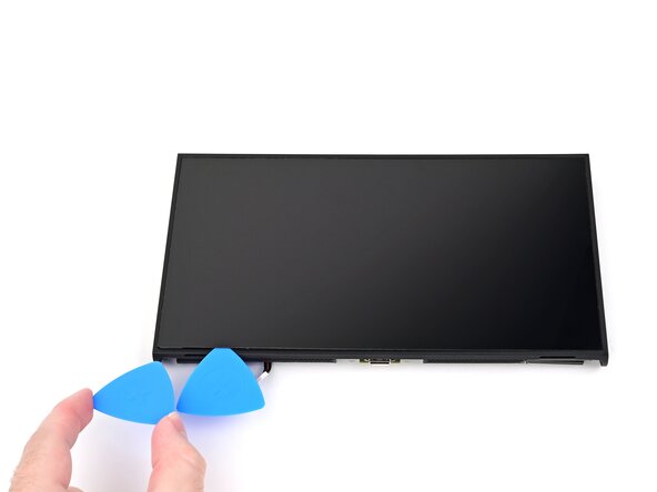

  48. Nintendo Switch 2 Screen Replacement, Separate the bottom adhesive: crwdns2935265:048crwdnd2935265:01crwdnd2935265:02crwdne2935265:0 Nintendo Switch 2 Screen Replacement, Separate the bottom adhesive: crwdns2935265:048crwdnd2935265:02crwdnd2935265:02crwdne2935265:0
    • Slide your pick across the bottom edge to separate the adhesive.
    • Leave your pick inserted in the bottom left corner to prevent the adhesive from resealing.

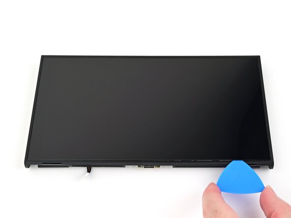

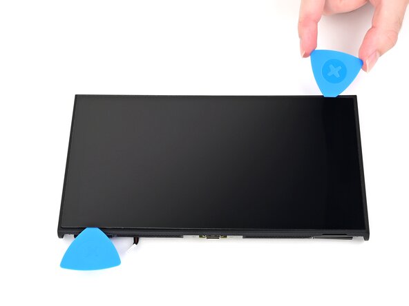

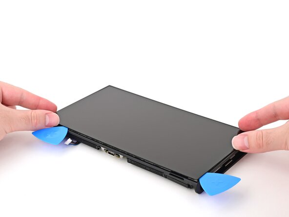

  49. Nintendo Switch 2 Screen Replacement, Heat the left edge: crwdns2935265:049crwdnd2935265:01crwdnd2935265:01crwdne2935265:0
  50. Nintendo Switch 2 Screen Replacement, Separate the left adhesive: crwdns2935265:050crwdnd2935265:01crwdnd2935265:03crwdne2935265:0 Nintendo Switch 2 Screen Replacement, Separate the left adhesive: crwdns2935265:050crwdnd2935265:02crwdnd2935265:03crwdne2935265:0 Nintendo Switch 2 Screen Replacement, Separate the left adhesive: crwdns2935265:050crwdnd2935265:03crwdnd2935265:03crwdne2935265:0
    • Insert a second opening pick next to the first one and slide it up the left edge of the screen.
  51. Nintendo Switch 2 Screen Replacement, Separate the remaining adhesives: crwdns2935265:051crwdnd2935265:01crwdnd2935265:03crwdne2935265:0 Nintendo Switch 2 Screen Replacement, Separate the remaining adhesives: crwdns2935265:051crwdnd2935265:02crwdnd2935265:03crwdne2935265:0 Nintendo Switch 2 Screen Replacement, Separate the remaining adhesives: crwdns2935265:051crwdnd2935265:03crwdnd2935265:03crwdne2935265:0
    • Repeat the heating and sliding procedure along the remaining screen edges.

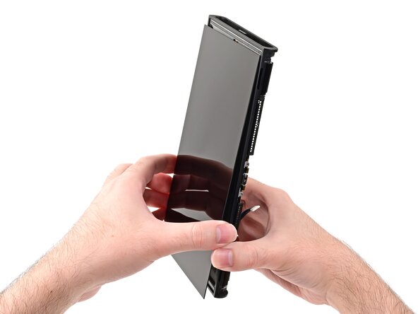

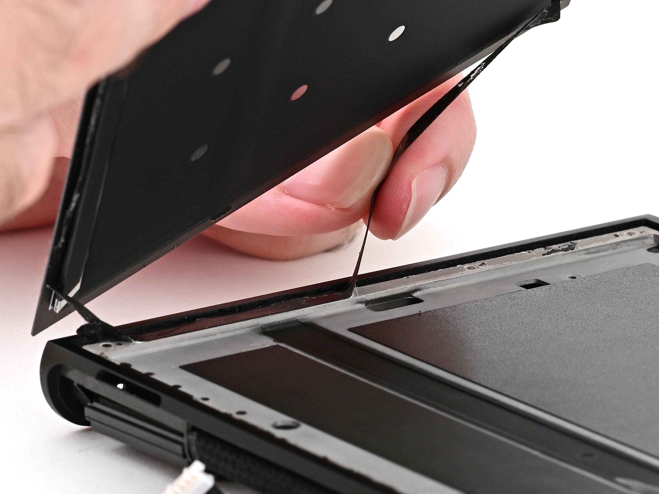

  52. Nintendo Switch 2 Screen Replacement, Remove the screen: crwdns2935265:052crwdnd2935265:01crwdnd2935265:02crwdne2935265:0 Nintendo Switch 2 Screen Replacement, Remove the screen: crwdns2935265:052crwdnd2935265:02crwdnd2935265:02crwdne2935265:0
    • Lift the screen off the frame to remove it.

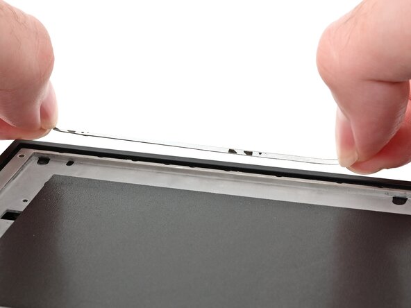

    • If any adhesive strips are still stuck to the frame, peel it up with slow, steady force to release it.
  53. Nintendo Switch 2 Screen Replacement, Disassembly complete: crwdns2935265:053crwdnd2935265:01crwdnd2935265:01crwdne2935265:0
    • Congratulations on completing disassembly! The remaining steps will show how to reassemble your console.

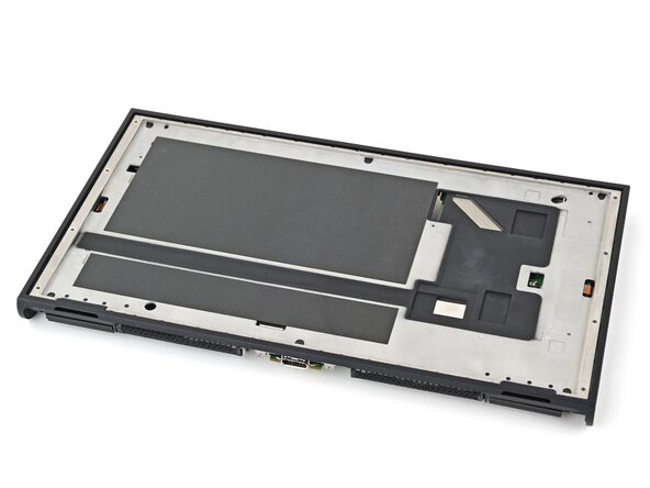

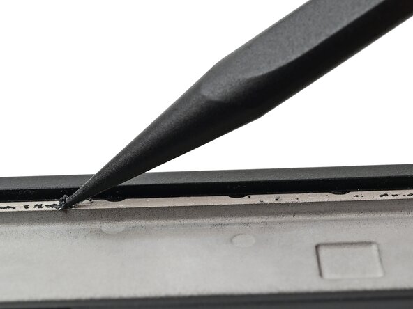

  54. Nintendo Switch 2 Screen Replacement, Clean the frame: crwdns2935265:054crwdnd2935265:01crwdnd2935265:03crwdne2935265:0 Nintendo Switch 2 Screen Replacement, Clean the frame: crwdns2935265:054crwdnd2935265:02crwdnd2935265:03crwdne2935265:0 Nintendo Switch 2 Screen Replacement, Clean the frame: crwdns2935265:054crwdnd2935265:03crwdnd2935265:03crwdne2935265:0
    Adhesive Cleanup Kit (Set of 12)
    $7.99
    • Use the point of a spudger to scrape off any adhesive left on the frame.
    • Apply a bit of isopropyl alcohol to a cotton swab or lint-free cloth and clean the frame until it's free of adhesive residue.
    • Alternatively, use our adhesive cleanup kit.

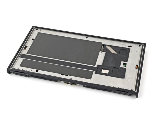

  55. Nintendo Switch 2 Screen Replacement, Apply new adhesive: crwdns2935265:055crwdnd2935265:01crwdnd2935265:03crwdne2935265:0 Nintendo Switch 2 Screen Replacement, Apply new adhesive: crwdns2935265:055crwdnd2935265:02crwdnd2935265:03crwdne2935265:0 Nintendo Switch 2 Screen Replacement, Apply new adhesive: crwdns2935265:055crwdnd2935265:03crwdnd2935265:03crwdne2935265:0
    Tesa 61395 Tape
    $2.99
    • If your replacement screen comes with adhesive pre-applied, skip this step.
    • Use your fingers to install strips of thin, double-sided tape to the raised lip along the edges of the frame. Use 1 mm strips for the top and bottom edges and 2 mm strips for the sides.
  56. Nintendo Switch 2 Screen Replacement, Prepare the adhesive: crwdns2935265:056crwdnd2935265:01crwdnd2935265:03crwdne2935265:0 Nintendo Switch 2 Screen Replacement, Prepare the adhesive: crwdns2935265:056crwdnd2935265:02crwdnd2935265:03crwdne2935265:0 Nintendo Switch 2 Screen Replacement, Prepare the adhesive: crwdns2935265:056crwdnd2935265:03crwdnd2935265:03crwdne2935265:0
    • Use angled tweezers to peel off all liners from the adhesive.

  59. Nintendo Switch 2 Screen Replacement, Connect the screen cable: crwdns2935265:059crwdnd2935265:01crwdnd2935265:03crwdne2935265:0 Nintendo Switch 2 Screen Replacement, Connect the screen cable: crwdns2935265:059crwdnd2935265:02crwdnd2935265:03crwdne2935265:0 Nintendo Switch 2 Screen Replacement, Connect the screen cable: crwdns2935265:059crwdnd2935265:03crwdnd2935265:03crwdne2935265:0
    • Use tweezers or your fingers to slide the screen cable into its ZIF connector until it's fully seated.
    • If you're using tweezers, you can use the flat end of a spudger to help guide the cable into its connector.
    • Flip the hinged locking flap down to secure the cable.

  63. Nintendo Switch 2 Screen Replacement, Install thermal paste: crwdns2935265:063crwdnd2935265:01crwdnd2935265:03crwdne2935265:0 Nintendo Switch 2 Screen Replacement, Install thermal paste: crwdns2935265:063crwdnd2935265:02crwdnd2935265:03crwdne2935265:0 Nintendo Switch 2 Screen Replacement, Install thermal paste: crwdns2935265:063crwdnd2935265:03crwdnd2935265:03crwdne2935265:0
    iFixit Thermal Paste
    $9.95
    • Apply a bead of new thermal paste to the center of the processor's copper heat spreader, roughly the size of a pea.
  64. Nintendo Switch 2 Screen Replacement, Install the heat sink: crwdns2935265:064crwdnd2935265:01crwdnd2935265:03crwdne2935265:0 Nintendo Switch 2 Screen Replacement, Install the heat sink: crwdns2935265:064crwdnd2935265:02crwdnd2935265:03crwdne2935265:0 Nintendo Switch 2 Screen Replacement, Install the heat sink: crwdns2935265:064crwdnd2935265:03crwdnd2935265:03crwdne2935265:0
    • Set the heat sink's aluminum fins into its recess behind the fan, then lower the heat sink onto the board.
