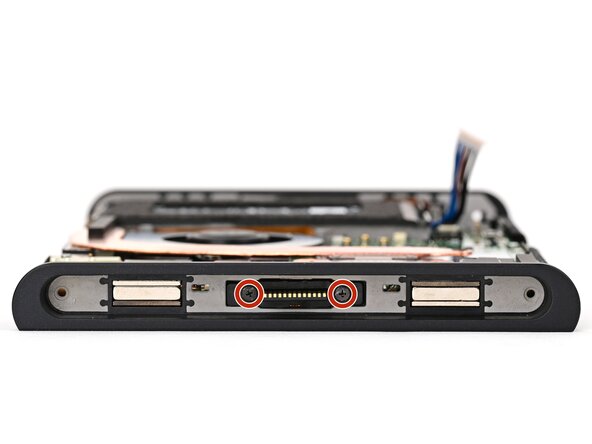

  2. Nintendo Switch 2 Right Joy-Con 2 Connector Replacement, Remove the bottom screws: crwdns2935265:02crwdnd2935265:01crwdnd2935265:02crwdne2935265:0 Nintendo Switch 2 Right Joy-Con 2 Connector Replacement, Remove the bottom screws: crwdns2935265:02crwdnd2935265:02crwdnd2935265:02crwdne2935265:0
    • Use a JIS 00 driver to remove the two 3.1 mm‑long screws on either side of the bottom USB-C port.
    • You can try a non-iFixit Phillips driver in a pinch, but you risk damaging or stripping the screw. Push down firmly on the driver and twist slowly.

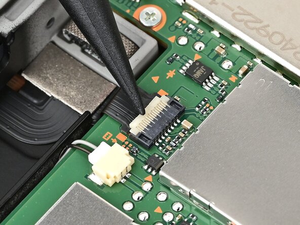

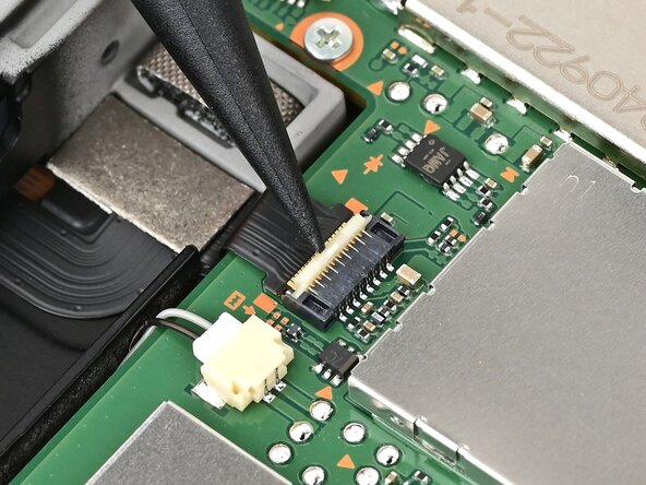

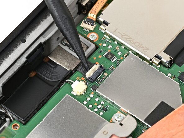

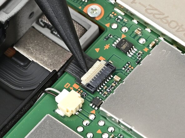

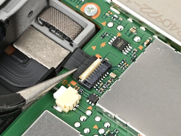

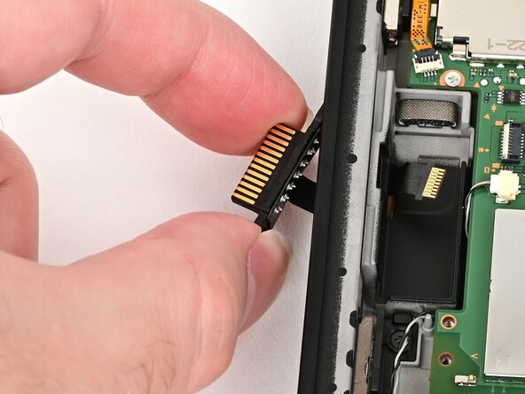

  35. Nintendo Switch 2 Right Joy-Con 2 Connector Replacement, Disconnect the right Joy‑Con 2 connector cable: crwdns2935265:035crwdnd2935265:01crwdnd2935265:03crwdne2935265:0 Nintendo Switch 2 Right Joy-Con 2 Connector Replacement, Disconnect the right Joy‑Con 2 connector cable: crwdns2935265:035crwdnd2935265:02crwdnd2935265:03crwdne2935265:0 Nintendo Switch 2 Right Joy-Con 2 Connector Replacement, Disconnect the right Joy‑Con 2 connector cable: crwdns2935265:035crwdnd2935265:03crwdnd2935265:03crwdne2935265:0
    • Use the point of a spudger to flip up the locking flap on the right Joy‑Con 2 connector cable ZIF connector, located on the edge of the console's board.

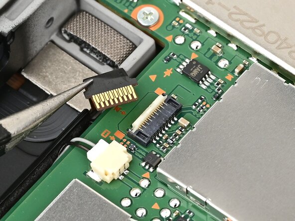

  36. Nintendo Switch 2 Right Joy-Con 2 Connector Replacement: crwdns2935265:036crwdnd2935265:01crwdnd2935265:02crwdne2935265:0 Nintendo Switch 2 Right Joy-Con 2 Connector Replacement: crwdns2935265:036crwdnd2935265:02crwdnd2935265:02crwdne2935265:0
    • Use tweezers or your fingers to gently pull the cable out of its connector.

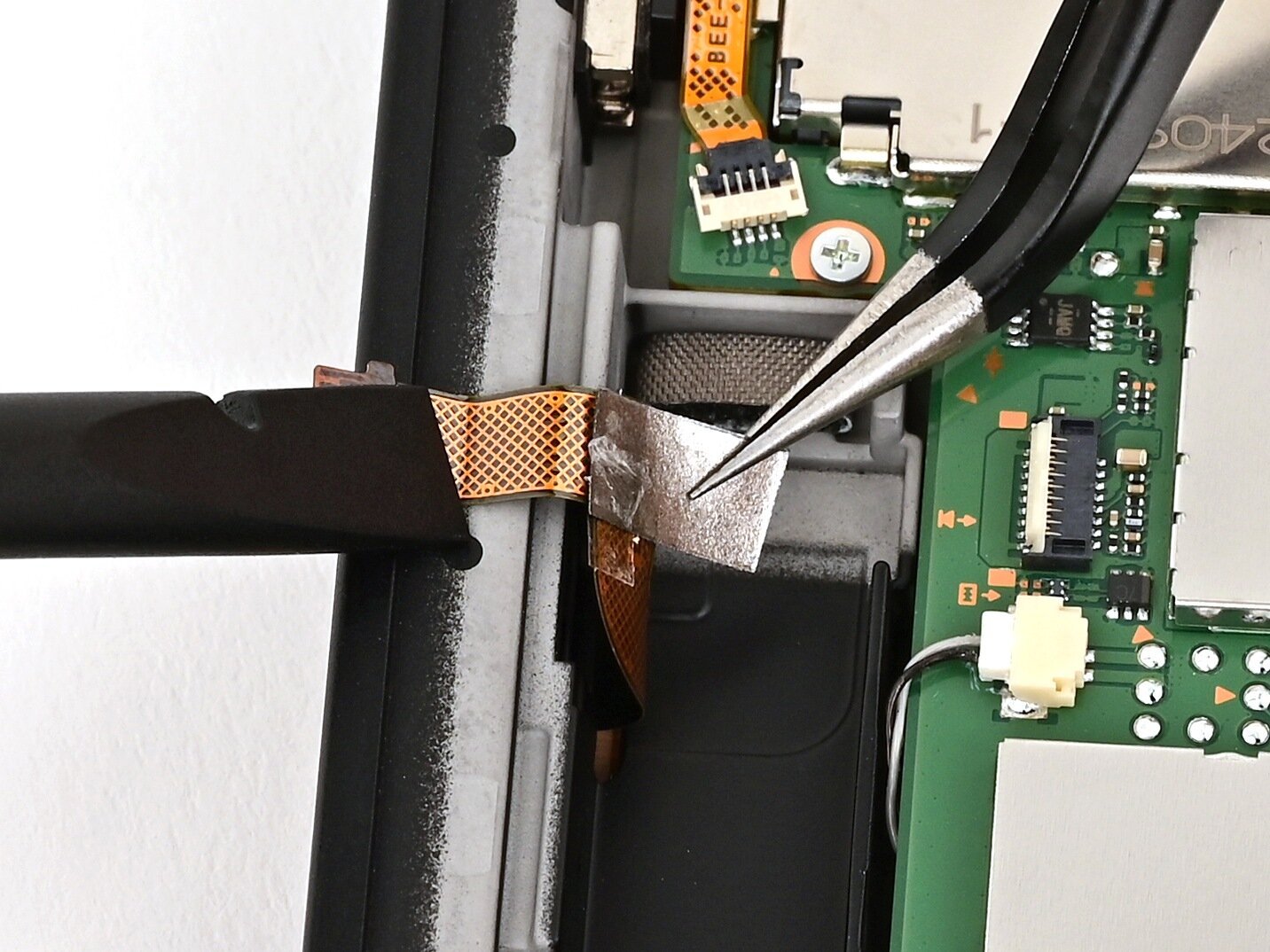

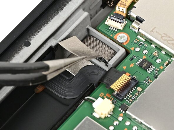

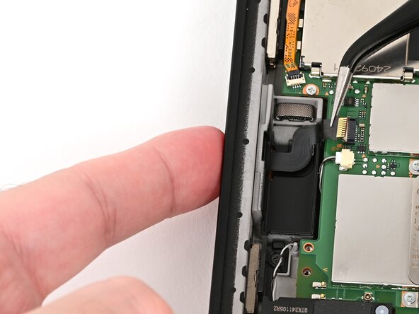

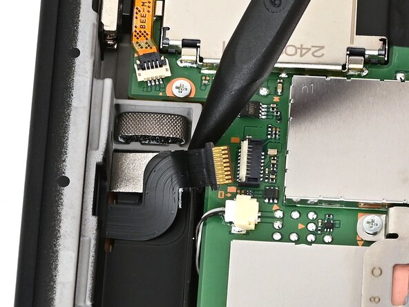

  37. Nintendo Switch 2 Right Joy-Con 2 Connector Replacement, Remove the cable cover: crwdns2935265:037crwdnd2935265:01crwdnd2935265:02crwdne2935265:0 Nintendo Switch 2 Right Joy-Con 2 Connector Replacement, Remove the cable cover: crwdns2935265:037crwdnd2935265:02crwdnd2935265:02crwdne2935265:0
    • Use tweezers to pick up and remove the silver sticker covering the right Joy‑Con 2 connector cable.

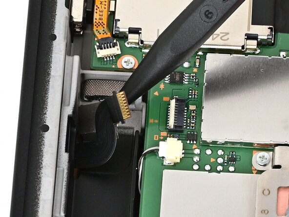

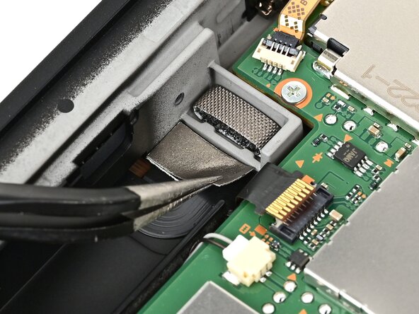

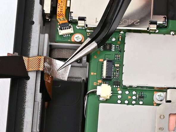

  38. Nintendo Switch 2 Right Joy-Con 2 Connector Replacement, Lift the cable: crwdns2935265:038crwdnd2935265:01crwdnd2935265:03crwdne2935265:0 Nintendo Switch 2 Right Joy-Con 2 Connector Replacement, Lift the cable: crwdns2935265:038crwdnd2935265:02crwdnd2935265:03crwdne2935265:0 Nintendo Switch 2 Right Joy-Con 2 Connector Replacement, Lift the cable: crwdns2935265:038crwdnd2935265:03crwdnd2935265:03crwdne2935265:0
    • Insert the point of a spudger underneath the cable and lift it up to separate the adhesive securing it to the frame.
    • If the silver sticker beneath the cable remains attached to the cable, remove that, too.

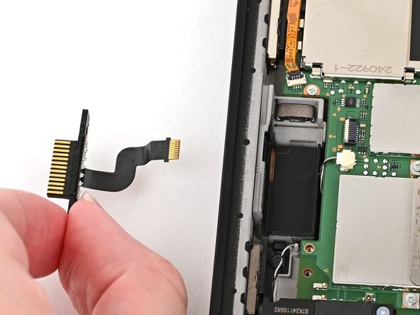

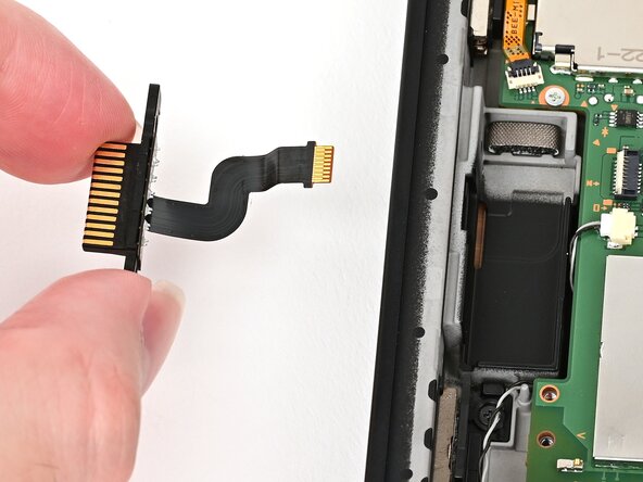

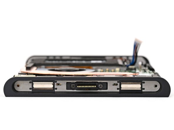

  39. Nintendo Switch 2 Right Joy-Con 2 Connector Replacement, Remove the right Joy‑Con 2 connector screws: crwdns2935265:039crwdnd2935265:01crwdnd2935265:02crwdne2935265:0 Nintendo Switch 2 Right Joy-Con 2 Connector Replacement, Remove the right Joy‑Con 2 connector screws: crwdns2935265:039crwdnd2935265:02crwdnd2935265:02crwdne2935265:0
    • Use a JIS 00 driver to remove the two 3.2 mm‑long black screws securing the right Joy‑Con 2 connector.

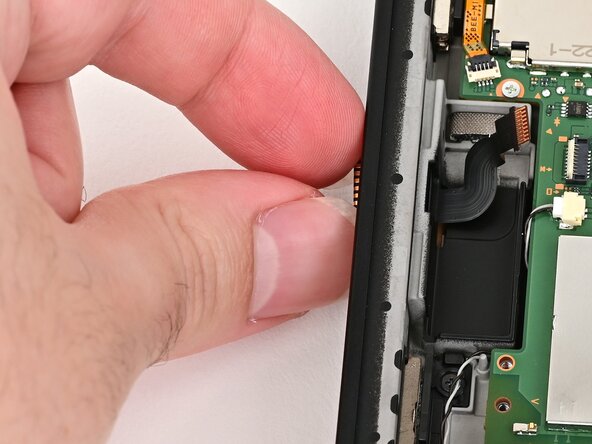

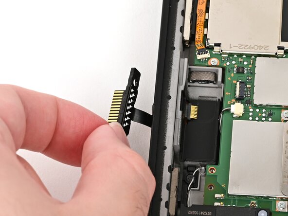

  40. Nintendo Switch 2 Right Joy-Con 2 Connector Replacement, Remove the right Joy‑Con 2 connector: crwdns2935265:040crwdnd2935265:01crwdnd2935265:03crwdne2935265:0 Nintendo Switch 2 Right Joy-Con 2 Connector Replacement, Remove the right Joy‑Con 2 connector: crwdns2935265:040crwdnd2935265:02crwdnd2935265:03crwdne2935265:0 Nintendo Switch 2 Right Joy-Con 2 Connector Replacement, Remove the right Joy‑Con 2 connector: crwdns2935265:040crwdnd2935265:03crwdnd2935265:03crwdne2935265:0
    • Grab the right Joy‑Con 2 connector and carefully thread its cable out of the frame.
    • Remove the right Joy‑Con 2 connector.
  41. Nintendo Switch 2 Right Joy-Con 2 Connector Replacement, Disassembly complete: crwdns2935265:041crwdnd2935265:01crwdnd2935265:01crwdne2935265:0
    • Congratulations on completing disassembly! The remaining steps will show how to reassemble your console.
