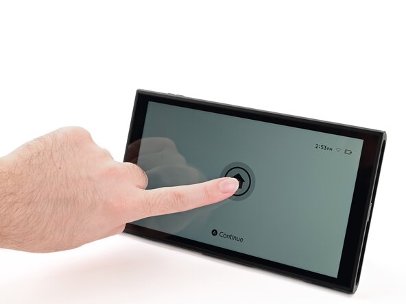

Nintendo Switch 2 Microphone Replacement

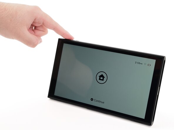

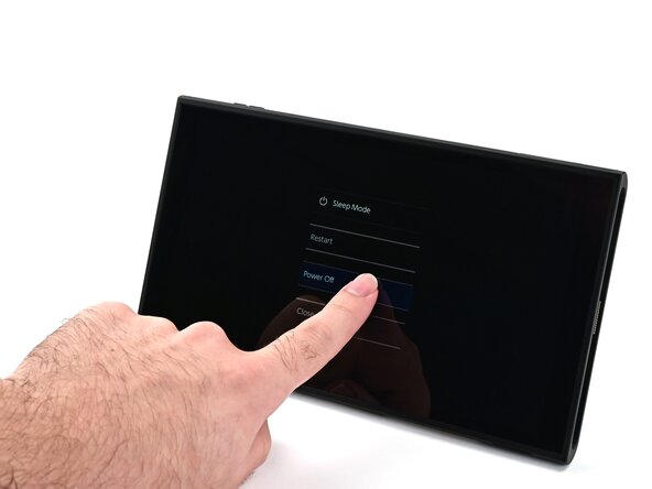

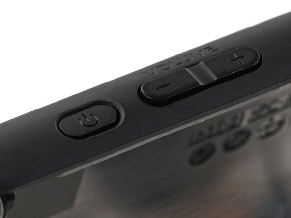

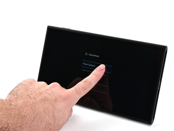

  1. Nintendo Switch 2 Microphone Replacement, Power off the console: crwdns2935265:01crwdnd2935265:01crwdnd2935265:03crwdne2935265:0 Nintendo Switch 2 Microphone Replacement, Power off the console: crwdns2935265:01crwdnd2935265:02crwdnd2935265:03crwdne2935265:0 Nintendo Switch 2 Microphone Replacement, Power off the console: crwdns2935265:01crwdnd2935265:03crwdnd2935265:03crwdne2935265:0
    • For your safety, discharge the battery below 25% before disassembling the console. This reduces the risk of a fire if the battery is damaged during the repair. If the battery is swollen, take appropriate precautions.
    • Remove any game cards and disconnect any cables, controllers, or other accessories from the console.
    • Power off the console by holding down the power button, selecting Power Options, then pressing Power Off.

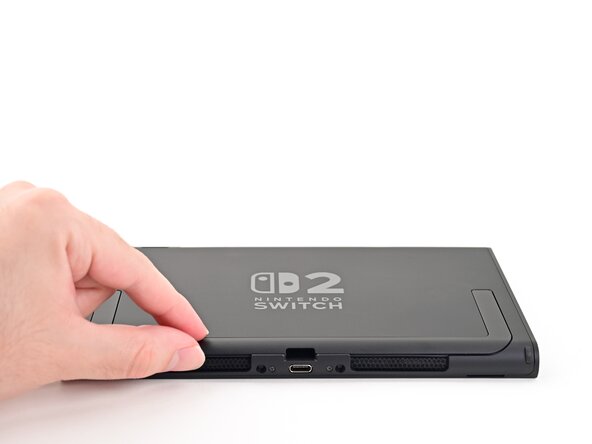

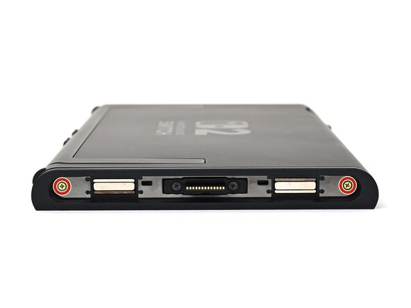

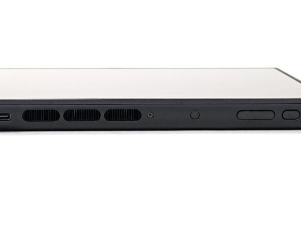

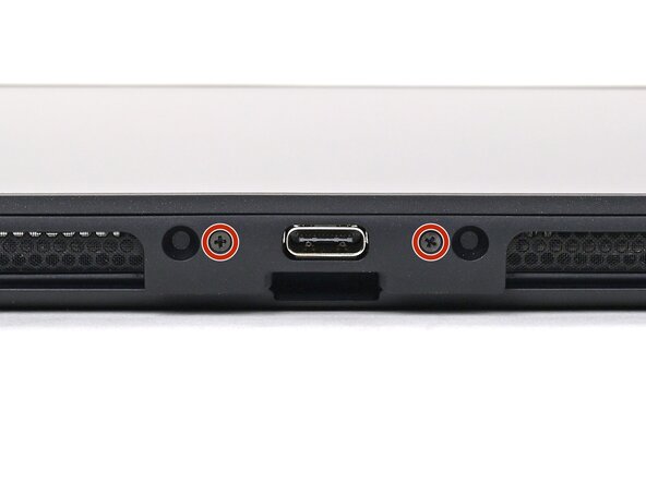

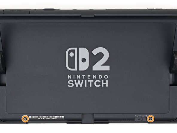

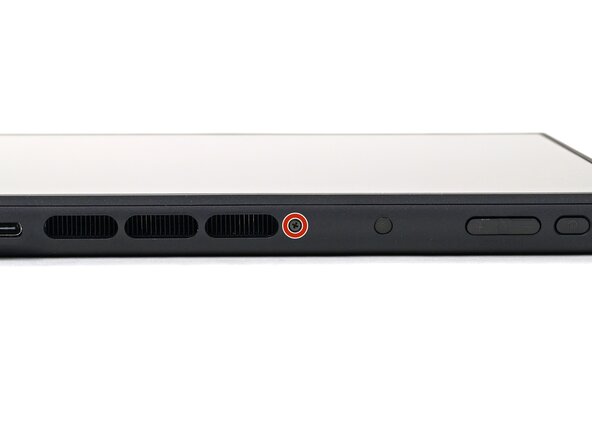

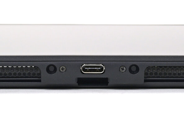

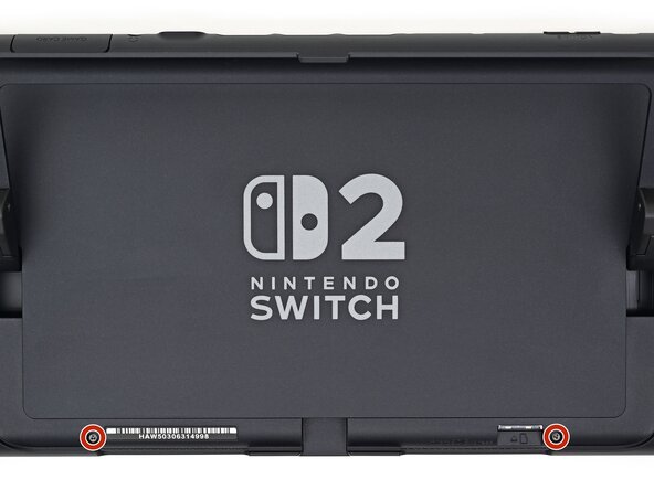

  2. Nintendo Switch 2 Microphone Replacement, Remove the bottom screws: crwdns2935265:02crwdnd2935265:01crwdnd2935265:02crwdne2935265:0 Nintendo Switch 2 Microphone Replacement, Remove the bottom screws: crwdns2935265:02crwdnd2935265:02crwdnd2935265:02crwdne2935265:0
    • Use a JIS 00 driver to remove the two 3.1 mm‑long screws on either side of the bottom USB-C port.
    • You can try a non-iFixit Phillips driver in a pinch, but you risk damaging or stripping the screw. Push down firmly on the driver and twist slowly.
  3. Nintendo Switch 2 Microphone Replacement, Remove the top screw: crwdns2935265:03crwdnd2935265:01crwdnd2935265:02crwdne2935265:0 Nintendo Switch 2 Microphone Replacement, Remove the top screw: crwdns2935265:03crwdnd2935265:02crwdnd2935265:02crwdne2935265:0
    • Use a JIS 00 driver to remove the 3.1 mm‑long screw on the top edge of the console (next to the ventilation cutouts).

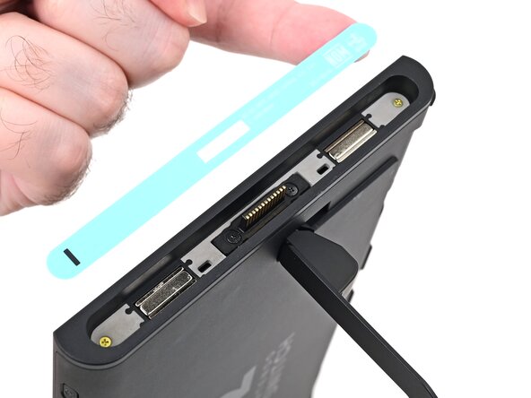

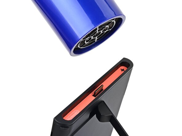

  4. Nintendo Switch 2 Microphone Replacement, Heat the right side sticker: crwdns2935265:04crwdnd2935265:01crwdnd2935265:01crwdne2935265:0
    • The Switch 2 has stickers on either side that need to removed to access the screws securing the back cover. It's easy to damage the stickers during removal, but you can mitigate this by regularly reheating the stickers and working carefully.
    • Use a hair dryer or heat gun to heat the sticker on the right side of the console, labeled with a "+" symbol, until it's hot to the touch.
    • You can use the kickstand to prop the console up vertically for easier access.
    • If you're using a heat gun, set it to low to avoid melting the plastic edge of the console.

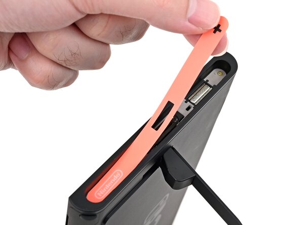

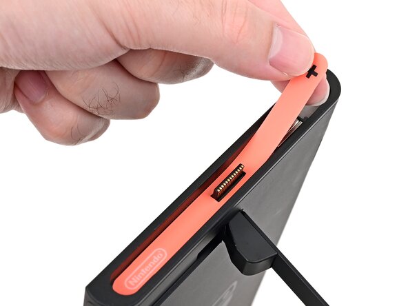

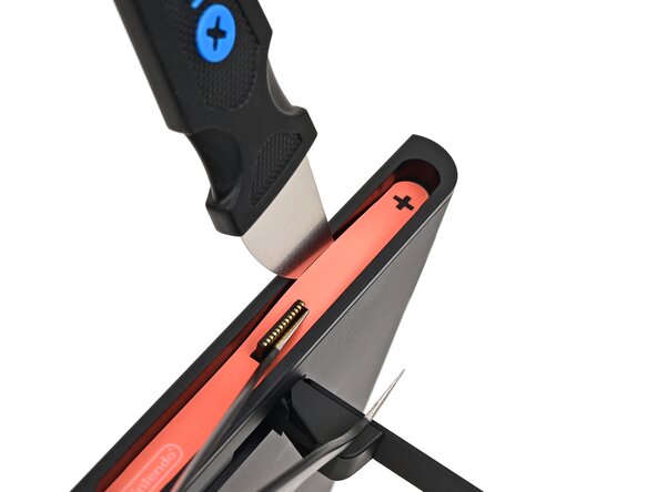

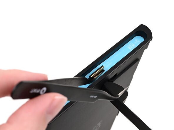

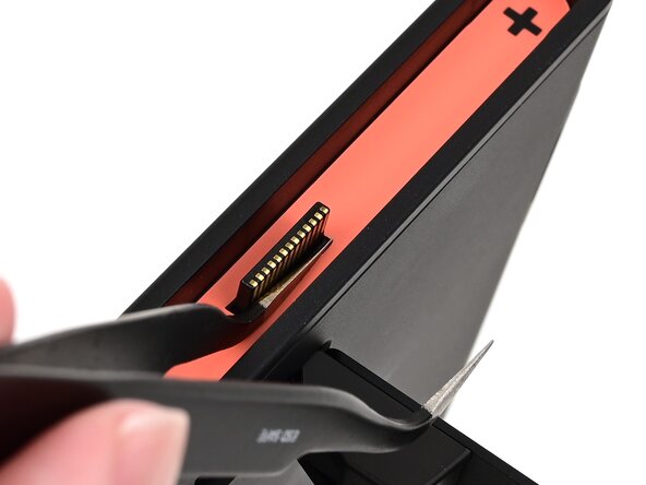

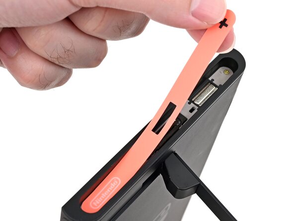

  5. Nintendo Switch 2 Microphone Replacement, Pry up the right side sticker: crwdns2935265:05crwdnd2935265:01crwdnd2935265:03crwdne2935265:0 Nintendo Switch 2 Microphone Replacement, Pry up the right side sticker: crwdns2935265:05crwdnd2935265:02crwdnd2935265:03crwdne2935265:0 Nintendo Switch 2 Microphone Replacement, Pry up the right side sticker: crwdns2935265:05crwdnd2935265:03crwdnd2935265:03crwdne2935265:0
    • The pointed end of the tweezers can damage the sticker from the underside, leaving a noticeable mark. If it's difficult to lift, apply more heat instead of using more force.
    • Slide one arm of angled tweezers underneath the sticker from its cutout around the right Joy‑Con 2 connector.
    • Gently pry up on the sticker until it starts to lift from the console.
    • Leave the tweezers in place to keep the sticker lifted.

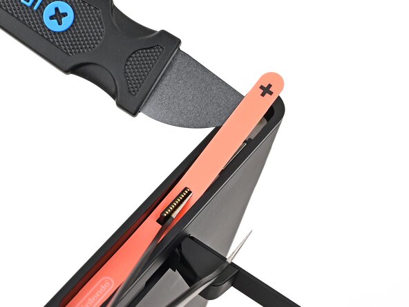

  6. Nintendo Switch 2 Microphone Replacement: crwdns2935265:06crwdnd2935265:01crwdnd2935265:03crwdne2935265:0 Nintendo Switch 2 Microphone Replacement: crwdns2935265:06crwdnd2935265:02crwdnd2935265:03crwdne2935265:0 Nintendo Switch 2 Microphone Replacement: crwdns2935265:06crwdnd2935265:03crwdnd2935265:03crwdne2935265:0
    Jimmy
    $7.95

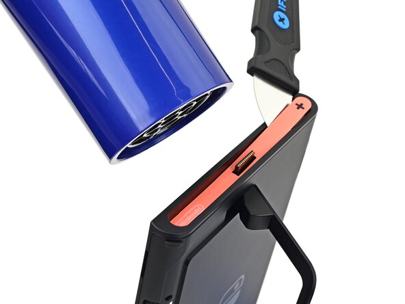

    • Insert the tip of a Jimmy into the gap formed between the long edge of the console and the sticker.
    • Gently pry up the sticker, working your way up the long edge until the top of the sticker is separated from the console.
    • Remove the tweezers once the sticker is lifted.
    • You can leave the Jimmy in place to hold the top of the sticker off the frame—if it falls back into its recess, repeat this procedure to lift it back up.

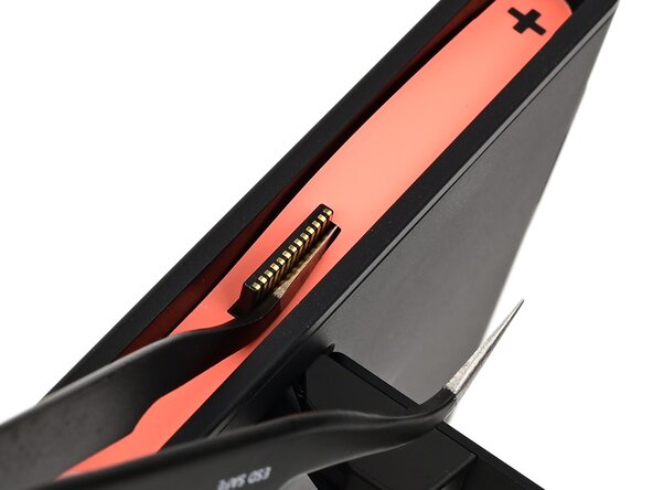

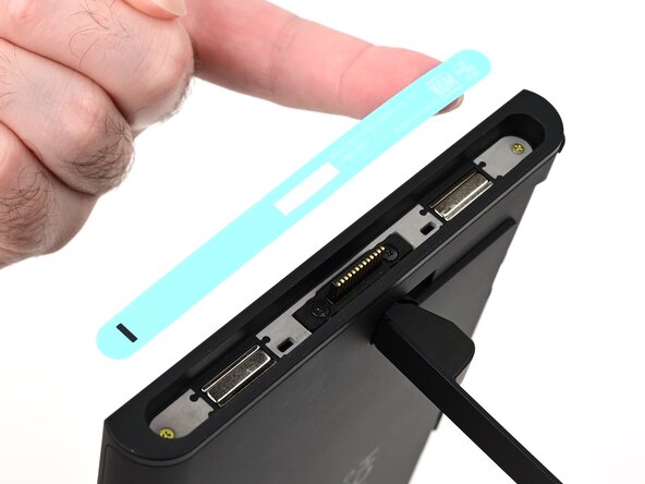

  7. Nintendo Switch 2 Microphone Replacement, Heat the right side sticker: crwdns2935265:07crwdnd2935265:01crwdnd2935265:01crwdne2935265:0
    • Reheat the bottom of the right side until it's hot to the touch.

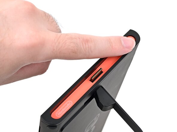

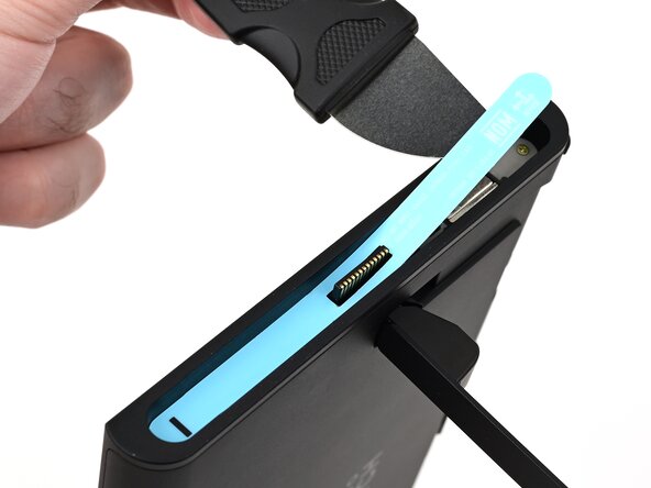

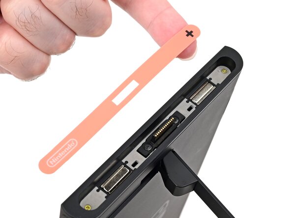

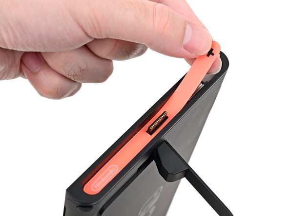

  8. Nintendo Switch 2 Microphone Replacement, Remove the right side sticker: crwdns2935265:08crwdnd2935265:01crwdnd2935265:03crwdne2935265:0 Nintendo Switch 2 Microphone Replacement, Remove the right side sticker: crwdns2935265:08crwdnd2935265:02crwdnd2935265:03crwdne2935265:0 Nintendo Switch 2 Microphone Replacement, Remove the right side sticker: crwdns2935265:08crwdnd2935265:03crwdnd2935265:03crwdne2935265:0
    • Carefully lift the sticker over the Joy‑Con 2 connector, then peel it up fully to remove it.
  9. Nintendo Switch 2 Microphone Replacement, Remove the left side sticker: crwdns2935265:09crwdnd2935265:01crwdnd2935265:03crwdne2935265:0 Nintendo Switch 2 Microphone Replacement, Remove the left side sticker: crwdns2935265:09crwdnd2935265:02crwdnd2935265:03crwdne2935265:0 Nintendo Switch 2 Microphone Replacement, Remove the left side sticker: crwdns2935265:09crwdnd2935265:03crwdnd2935265:03crwdne2935265:0
    • Repeat this procedure to remove the sticker along the left side of the console, labeled with a "-" symbol.

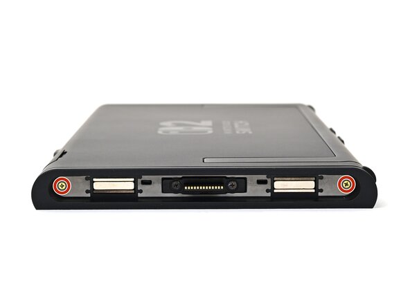

  10. Nintendo Switch 2 Microphone Replacement, Remove the side screws: crwdns2935265:010crwdnd2935265:01crwdnd2935265:02crwdne2935265:0 Nintendo Switch 2 Microphone Replacement, Remove the side screws: crwdns2935265:010crwdnd2935265:02crwdnd2935265:02crwdne2935265:0
    • Use a JIS 00 driver to remove the two 3.6 mm‑long gold screws on each side of the console (four in total).

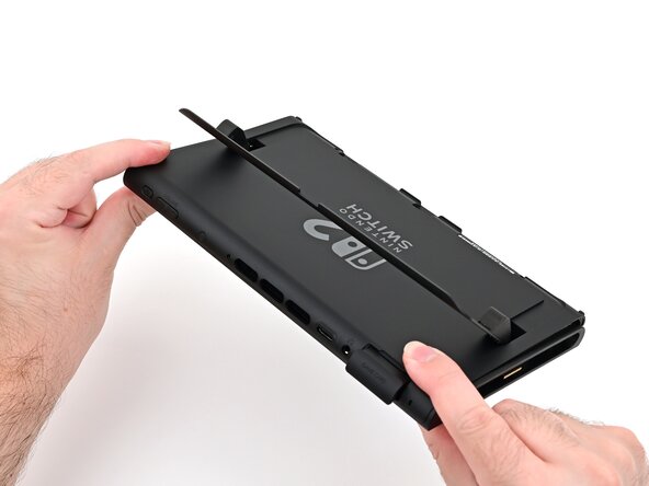

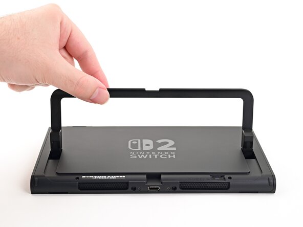

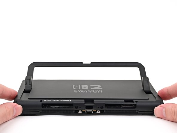

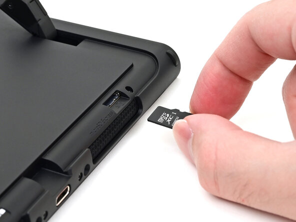

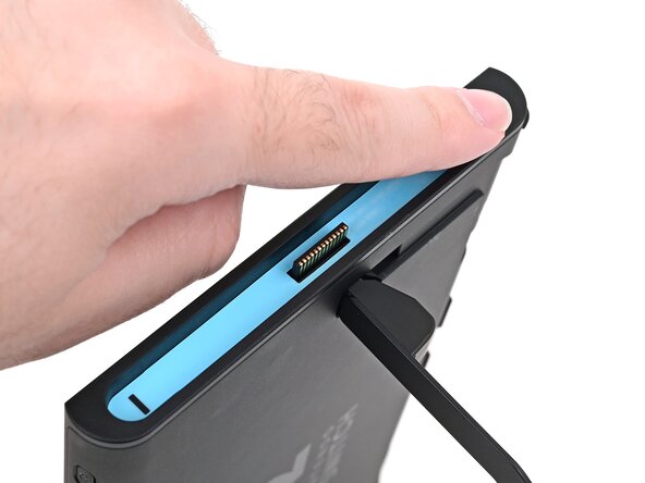

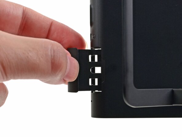

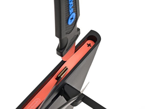

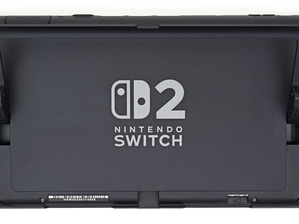

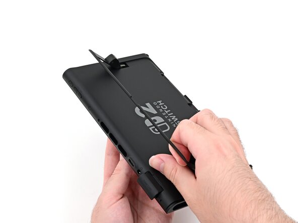

  11. Nintendo Switch 2 Microphone Replacement, Open the kickstand: crwdns2935265:011crwdnd2935265:01crwdnd2935265:03crwdne2935265:0 Nintendo Switch 2 Microphone Replacement, Open the kickstand: crwdns2935265:011crwdnd2935265:02crwdnd2935265:03crwdne2935265:0 Nintendo Switch 2 Microphone Replacement, Open the kickstand: crwdns2935265:011crwdnd2935265:03crwdnd2935265:03crwdne2935265:0
    • Use your fingers to flip up the kickstand on the back of the console.
    • If there's a microSD Express card installed, remove it now before you continue to the next step.
  12. Nintendo Switch 2 Microphone Replacement, Remove the back-side screws: crwdns2935265:012crwdnd2935265:01crwdnd2935265:02crwdne2935265:0 Nintendo Switch 2 Microphone Replacement, Remove the back-side screws: crwdns2935265:012crwdnd2935265:02crwdnd2935265:02crwdne2935265:0
    • Use a Y00 driver to remove the two 4.4 mm‑long screws in the kickstand cutout.

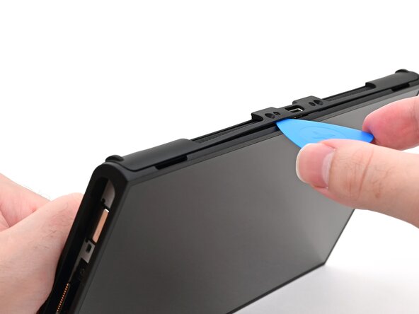

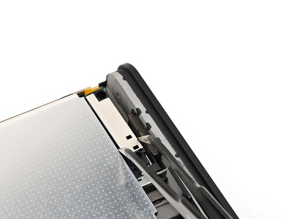

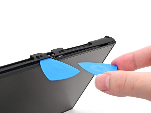

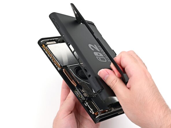

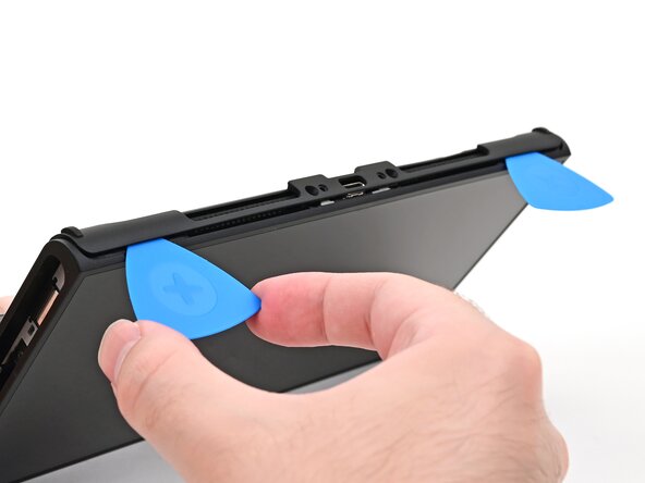

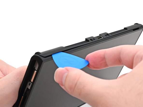

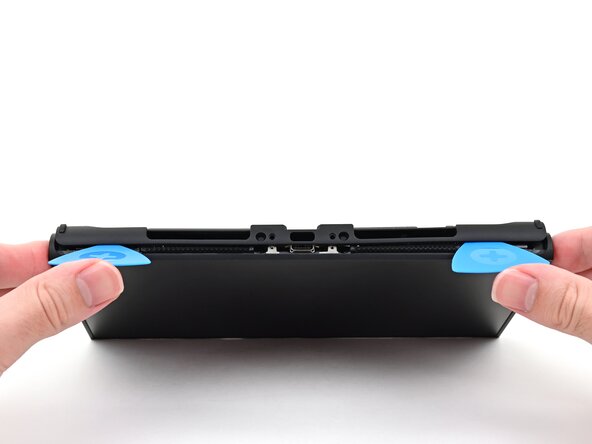

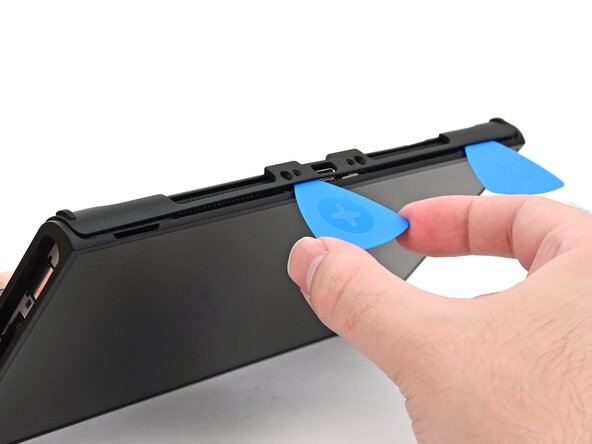

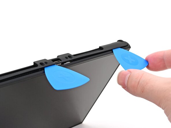

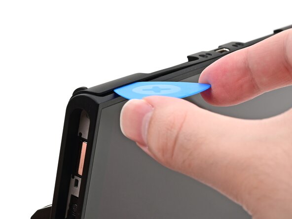

  13. Nintendo Switch 2 Microphone Replacement, Insert an opening pick: crwdns2935265:013crwdnd2935265:01crwdnd2935265:02crwdne2935265:0 Nintendo Switch 2 Microphone Replacement, Insert an opening pick: crwdns2935265:013crwdnd2935265:02crwdnd2935265:02crwdne2935265:0
    • Insert an opening pick into the gap between the back cover and speaker cutout on the bottom edge of the console.
  14. Nintendo Switch 2 Microphone Replacement: crwdns2935265:014crwdnd2935265:01crwdnd2935265:02crwdne2935265:0 Nintendo Switch 2 Microphone Replacement: crwdns2935265:014crwdnd2935265:02crwdnd2935265:02crwdne2935265:0
    • Slide the opening pick towards the USB-C port until it's underneath the screw hole next to the port.

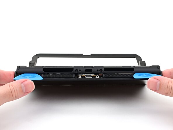

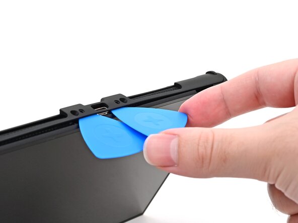

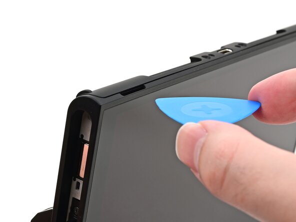

  15. Nintendo Switch 2 Microphone Replacement, Insert a second opening pick: crwdns2935265:015crwdnd2935265:01crwdnd2935265:03crwdne2935265:0 Nintendo Switch 2 Microphone Replacement, Insert a second opening pick: crwdns2935265:015crwdnd2935265:02crwdnd2935265:03crwdne2935265:0 Nintendo Switch 2 Microphone Replacement, Insert a second opening pick: crwdns2935265:015crwdnd2935265:03crwdnd2935265:03crwdne2935265:0
    • Insert a second opening pick underneath the screw hole on the opposite side of the USB-C port, and slide it to the corner of the console.
  16. Nintendo Switch 2 Microphone Replacement: crwdns2935265:016crwdnd2935265:01crwdnd2935265:02crwdne2935265:0 Nintendo Switch 2 Microphone Replacement: crwdns2935265:016crwdnd2935265:02crwdnd2935265:02crwdne2935265:0
    • Slide the first opening pick back to where it was first inserted.

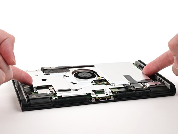

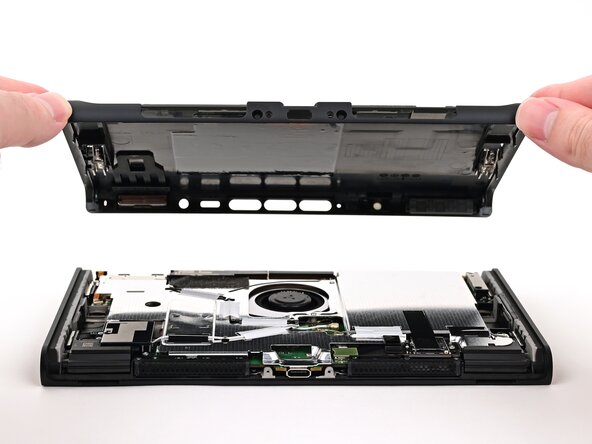

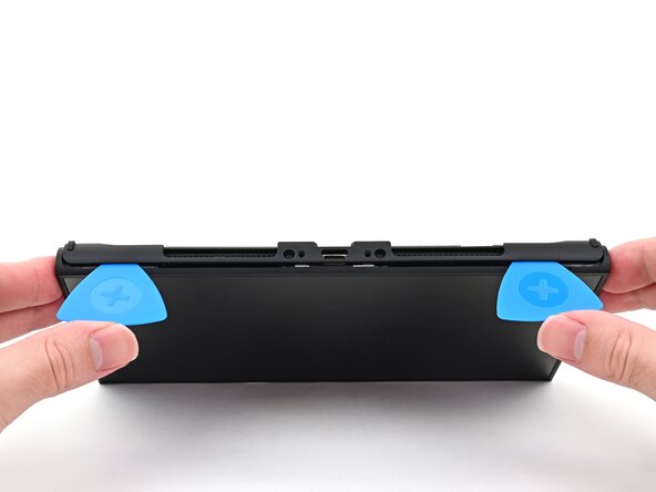

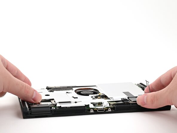

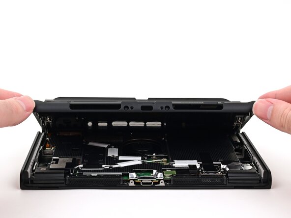

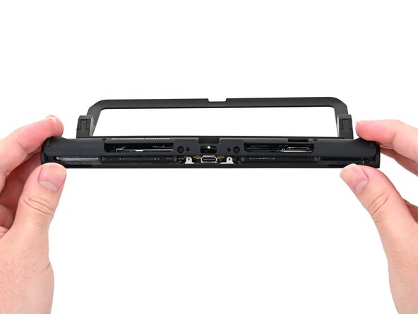

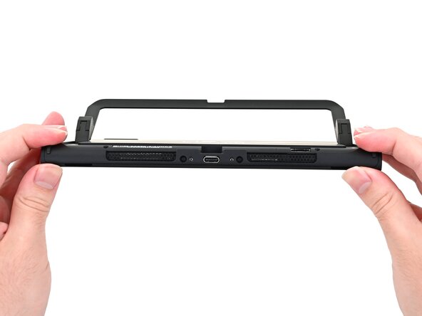

  17. Nintendo Switch 2 Microphone Replacement, Remove the back cover: crwdns2935265:017crwdnd2935265:01crwdnd2935265:03crwdne2935265:0 Nintendo Switch 2 Microphone Replacement, Remove the back cover: crwdns2935265:017crwdnd2935265:02crwdnd2935265:03crwdne2935265:0 Nintendo Switch 2 Microphone Replacement, Remove the back cover: crwdns2935265:017crwdnd2935265:03crwdnd2935265:03crwdne2935265:0
    • Be careful not to drop your console. Once the back cover pops up, the opening picks will fall out of place.
    • Hold the console with two hands. Rest your thumbs on the opening picks.
    • Push up on the opening picks to lift the back cover until it pops up above the USB-C port.
  18. Nintendo Switch 2 Microphone Replacement: crwdns2935265:018crwdnd2935265:01crwdnd2935265:03crwdne2935265:0 Nintendo Switch 2 Microphone Replacement: crwdns2935265:018crwdnd2935265:02crwdnd2935265:03crwdne2935265:0 Nintendo Switch 2 Microphone Replacement: crwdns2935265:018crwdnd2935265:03crwdnd2935265:03crwdne2935265:0
    • Lift the back cover up from the bottom edge and remove it.

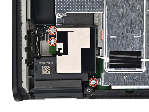

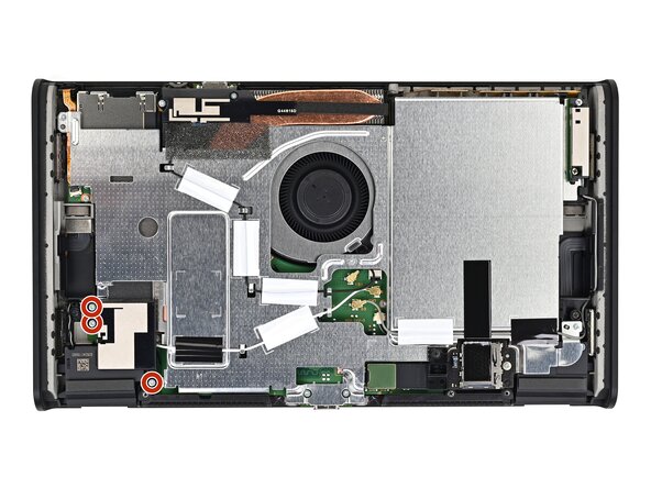

  19. Nintendo Switch 2 Microphone Replacement, Remove the lower antenna screws: crwdns2935265:019crwdnd2935265:01crwdnd2935265:02crwdne2935265:0 Nintendo Switch 2 Microphone Replacement, Remove the lower antenna screws: crwdns2935265:019crwdnd2935265:02crwdnd2935265:02crwdne2935265:0
    • Use a JIS 00 driver to remove the three 4.4 mm‑long silver screws securing the lower antenna.

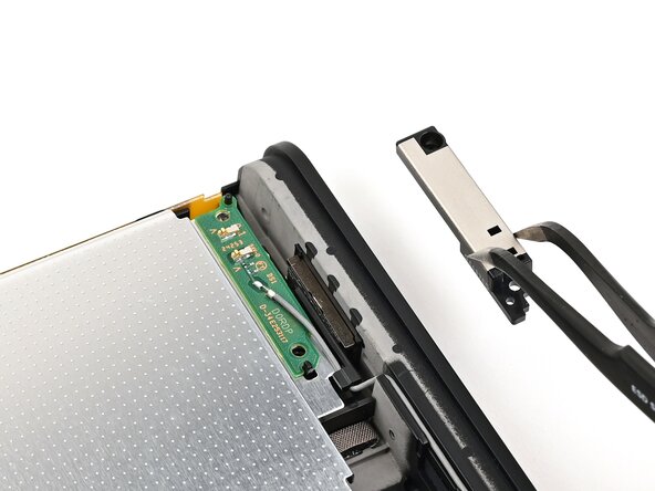

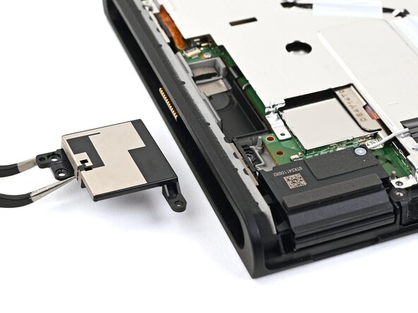

  20. Nintendo Switch 2 Microphone Replacement, Remove the lower antenna: crwdns2935265:020crwdnd2935265:01crwdnd2935265:02crwdne2935265:0 Nintendo Switch 2 Microphone Replacement, Remove the lower antenna: crwdns2935265:020crwdnd2935265:02crwdnd2935265:02crwdne2935265:0
    • Use tweezers or your fingers to remove the lower antenna.

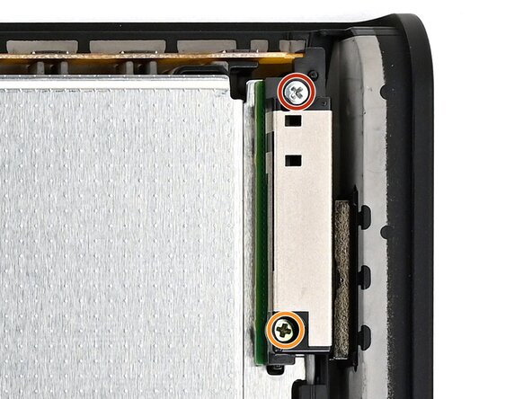

  21. Nintendo Switch 2 Microphone Replacement, Remove the upper antenna screws: crwdns2935265:021crwdnd2935265:01crwdnd2935265:02crwdne2935265:0 Nintendo Switch 2 Microphone Replacement, Remove the upper antenna screws: crwdns2935265:021crwdnd2935265:02crwdnd2935265:02crwdne2935265:0
    • Use a JIS 00 driver to remove the two screws securing the upper antenna:
    • One 4.4 mm‑long silver screw
    • One 4.6 mm‑long green screw

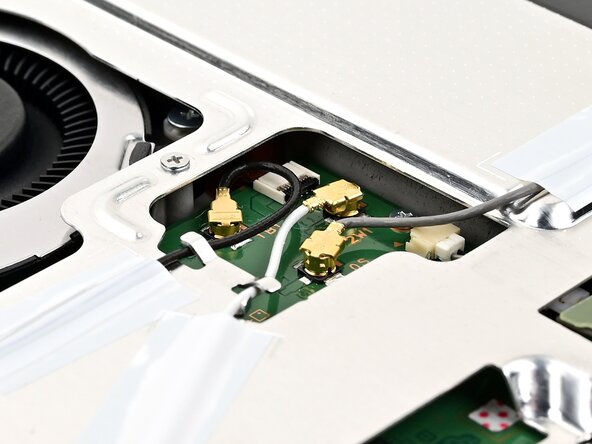

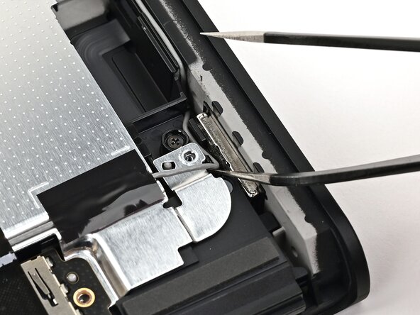

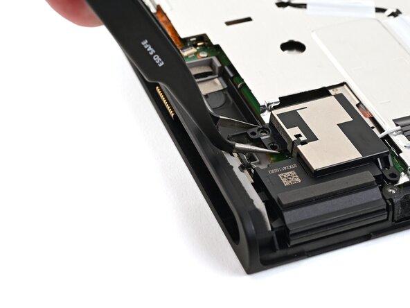

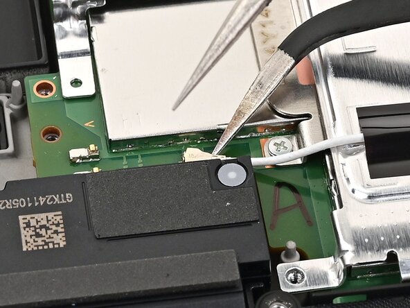

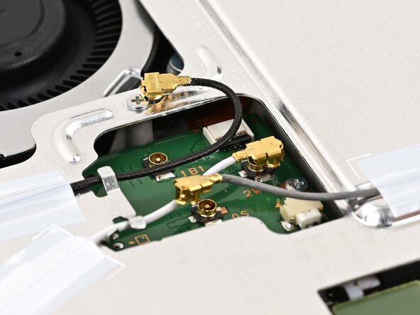

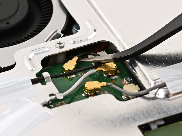

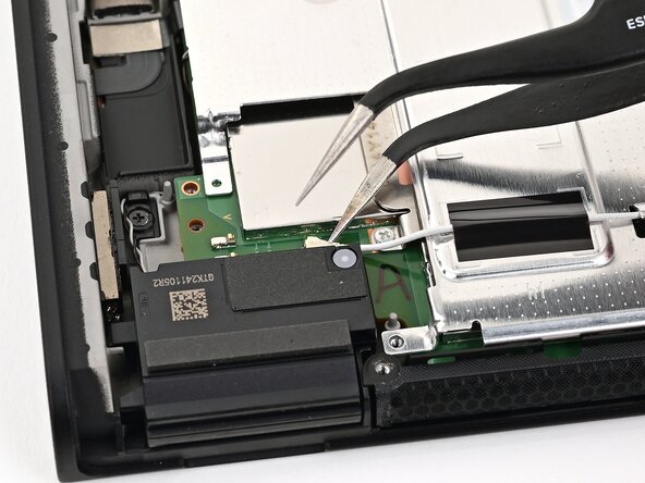

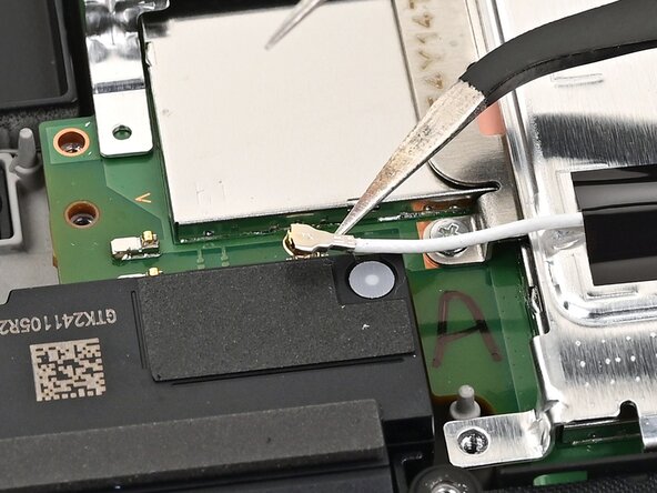

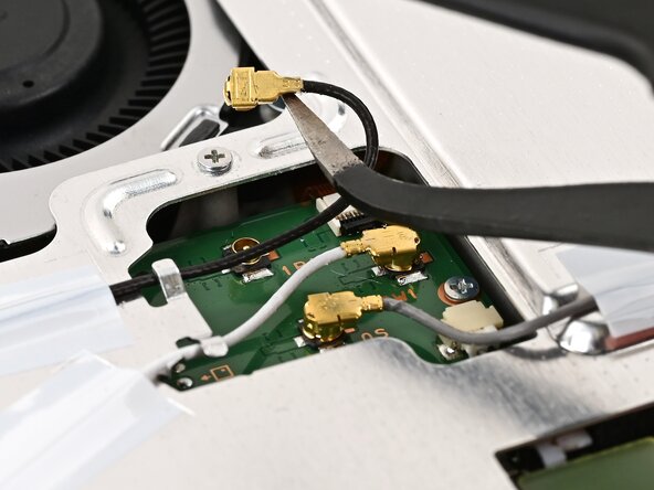

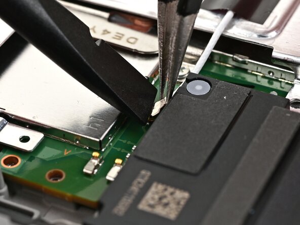

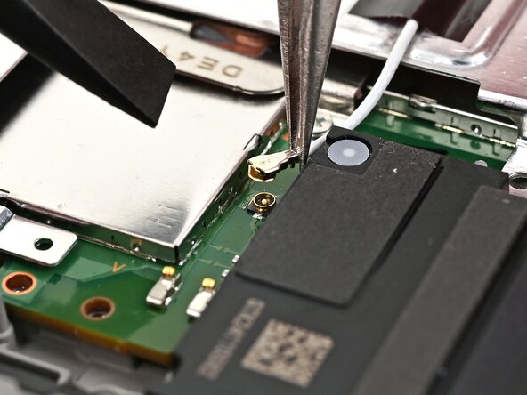

  23. Nintendo Switch 2 Microphone Replacement, Disconnect the lower antenna cable: crwdns2935265:023crwdnd2935265:01crwdnd2935265:03crwdne2935265:0 Nintendo Switch 2 Microphone Replacement, Disconnect the lower antenna cable: crwdns2935265:023crwdnd2935265:02crwdnd2935265:03crwdne2935265:0 Nintendo Switch 2 Microphone Replacement, Disconnect the lower antenna cable: crwdns2935265:023crwdnd2935265:03crwdnd2935265:03crwdne2935265:0
    • Insert an arm of angled tweezers under the metal neck of the white interconnect cable coaxial connector (located beneath the lower antenna) and lift straight up to disconnect it.
  24. Nintendo Switch 2 Microphone Replacement, Disconnect the remaining antenna cables: crwdns2935265:024crwdnd2935265:01crwdnd2935265:03crwdne2935265:0 Nintendo Switch 2 Microphone Replacement, Disconnect the remaining antenna cables: crwdns2935265:024crwdnd2935265:02crwdnd2935265:03crwdne2935265:0 Nintendo Switch 2 Microphone Replacement, Disconnect the remaining antenna cables: crwdns2935265:024crwdnd2935265:03crwdnd2935265:03crwdne2935265:0
    • Repeat this procedure to disconnect the three central coaxial connectors from the board.

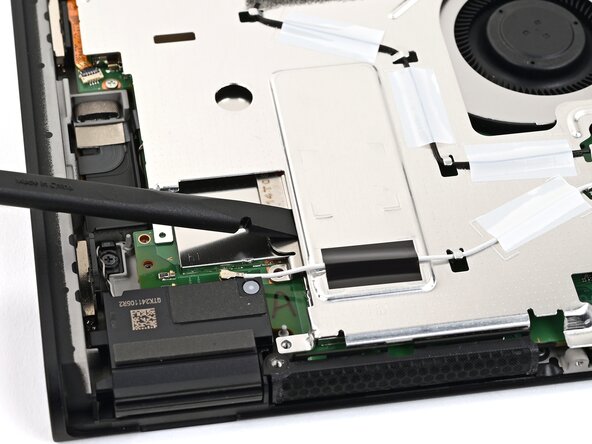

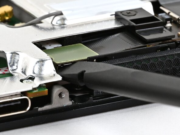

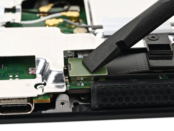

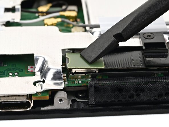

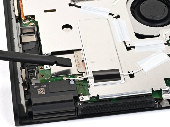

  25. Nintendo Switch 2 Microphone Replacement, Disconnect the MicroSD connector: crwdns2935265:025crwdnd2935265:01crwdnd2935265:03crwdne2935265:0 Nintendo Switch 2 Microphone Replacement, Disconnect the MicroSD connector: crwdns2935265:025crwdnd2935265:02crwdnd2935265:03crwdne2935265:0 Nintendo Switch 2 Microphone Replacement, Disconnect the MicroSD connector: crwdns2935265:025crwdnd2935265:03crwdnd2935265:03crwdne2935265:0
    • Use the flat end of a spudger to pry up and disconnect the MicroSD card reader press connector, located next to the bottom USB‑C port.

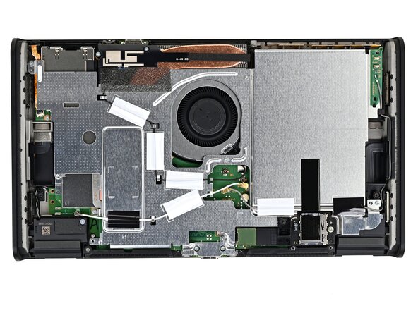

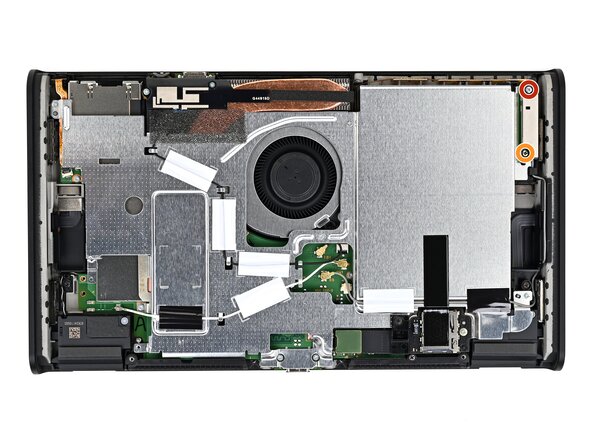

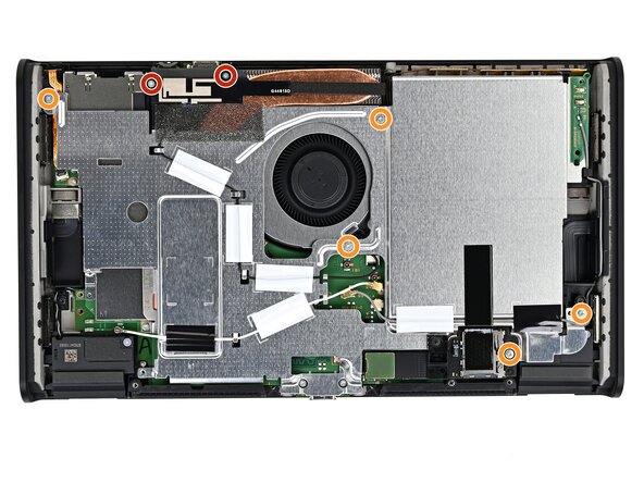

  26. Nintendo Switch 2 Microphone Replacement, Remove the shield plate screws: crwdns2935265:026crwdnd2935265:01crwdnd2935265:02crwdne2935265:0 Nintendo Switch 2 Microphone Replacement, Remove the shield plate screws: crwdns2935265:026crwdnd2935265:02crwdnd2935265:02crwdne2935265:0
    • Use a JIS 00 driver to remove the seven screws securing the shield plate:
    • Two 6.2 mm‑long silver screws
    • Five 4.4 mm‑long silver screws

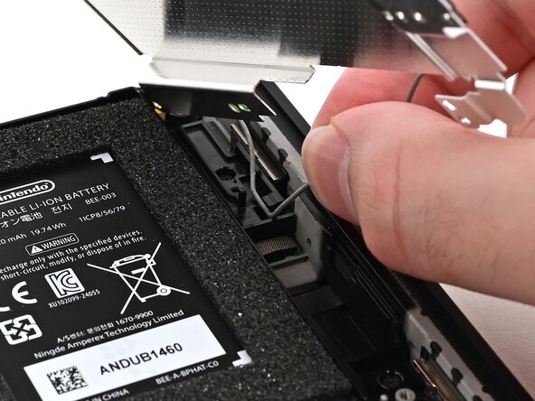

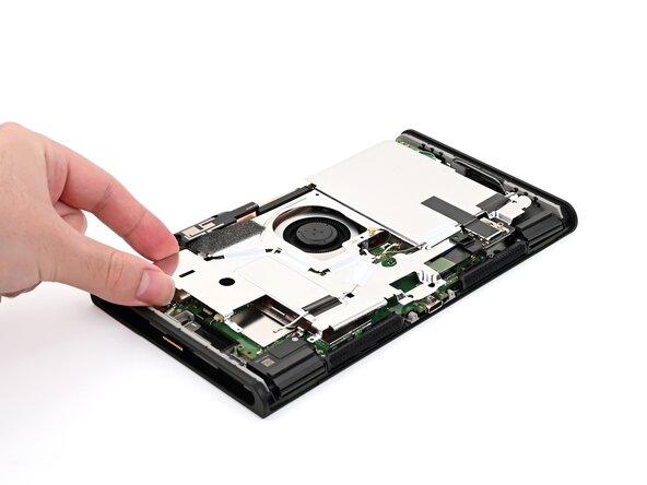

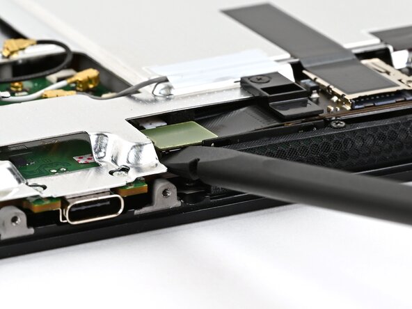

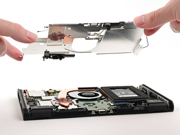

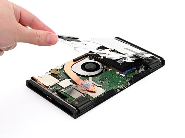

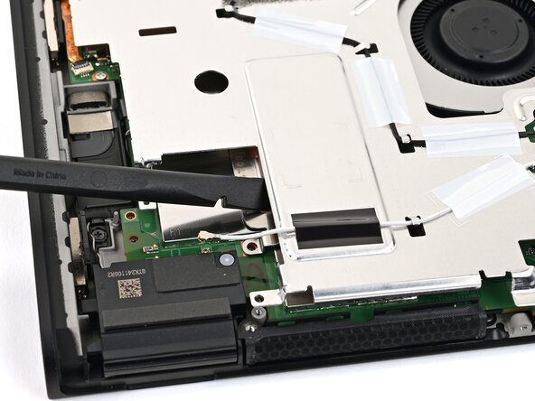

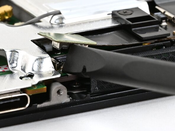

  27. Nintendo Switch 2 Microphone Replacement, Lift the shield plate: crwdns2935265:027crwdnd2935265:01crwdnd2935265:03crwdne2935265:0 Nintendo Switch 2 Microphone Replacement, Lift the shield plate: crwdns2935265:027crwdnd2935265:02crwdnd2935265:03crwdne2935265:0 Nintendo Switch 2 Microphone Replacement, Lift the shield plate: crwdns2935265:027crwdnd2935265:03crwdnd2935265:03crwdne2935265:0
    • Insert the flat end of a spudger between the shield plate and the processor's heat sink, next to the square (⛶) marking on the shield plate.
    • Twist the spudger to lift the shield plate and separate the thermal putty bonded to it. Keep lifting the shield plate until you don't feel resistance.
  28. Nintendo Switch 2 Microphone Replacement: crwdns2935265:028crwdnd2935265:01crwdnd2935265:03crwdne2935265:0 Nintendo Switch 2 Microphone Replacement: crwdns2935265:028crwdnd2935265:02crwdnd2935265:03crwdne2935265:0 Nintendo Switch 2 Microphone Replacement: crwdns2935265:028crwdnd2935265:03crwdnd2935265:03crwdne2935265:0
    • Lift the left edge of the shield plate to ensure it's fully separated from the thermal putty.
    • Gently set the shield plate back down.

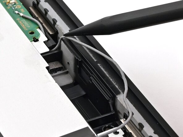

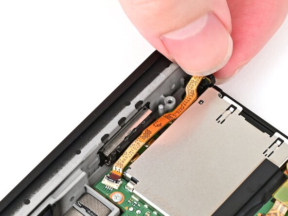

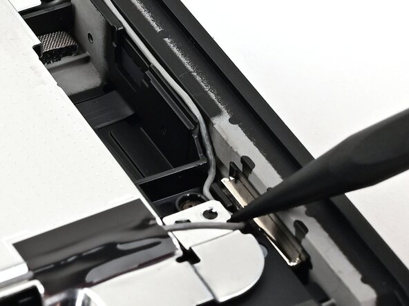

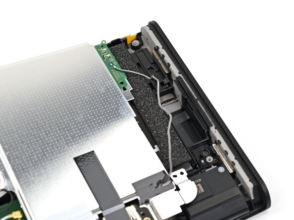

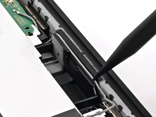

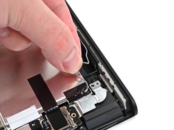

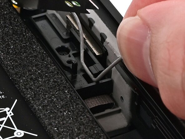

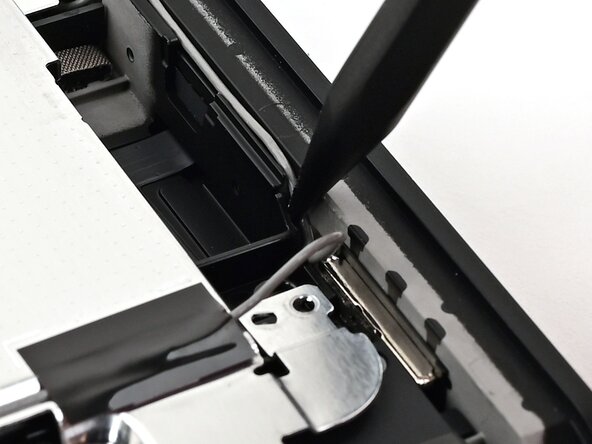

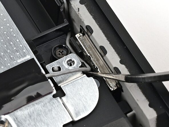

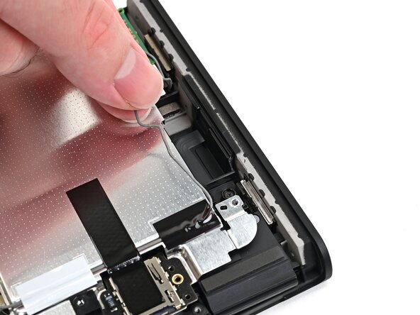

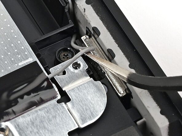

  29. Nintendo Switch 2 Microphone Replacement, Unroute the gray antenna cable: crwdns2935265:029crwdnd2935265:01crwdnd2935265:03crwdne2935265:0 Nintendo Switch 2 Microphone Replacement, Unroute the gray antenna cable: crwdns2935265:029crwdnd2935265:02crwdnd2935265:03crwdne2935265:0 Nintendo Switch 2 Microphone Replacement, Unroute the gray antenna cable: crwdns2935265:029crwdnd2935265:03crwdnd2935265:03crwdne2935265:0
    • Insert one arm of angled tweezers underneath the gray antenna cable at the bottom-right corner of the console.
    • Lift the cable out of the black clip securing it to the frame.

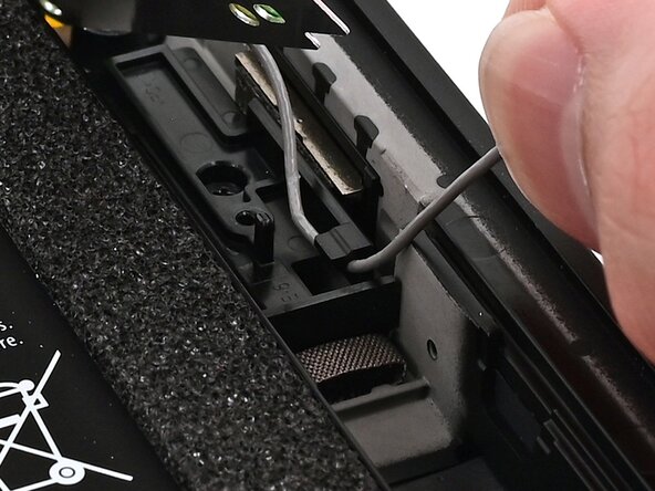

  30. Nintendo Switch 2 Microphone Replacement: crwdns2935265:030crwdnd2935265:01crwdnd2935265:03crwdne2935265:0 Nintendo Switch 2 Microphone Replacement: crwdns2935265:030crwdnd2935265:02crwdnd2935265:03crwdne2935265:0 Nintendo Switch 2 Microphone Replacement: crwdns2935265:030crwdnd2935265:03crwdnd2935265:03crwdne2935265:0

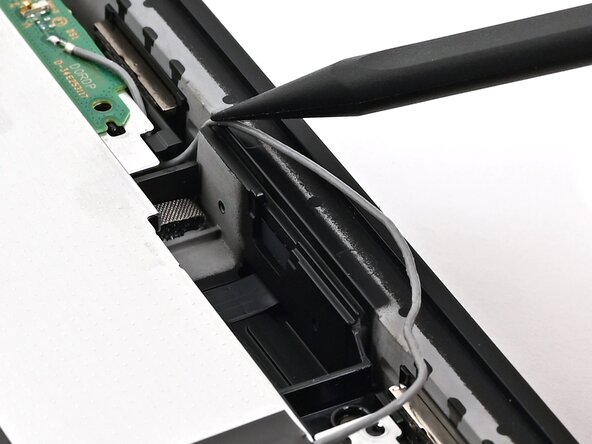

    • Unroute the gray antenna cable from its channel along the right edge of the console.
  31. Nintendo Switch 2 Microphone Replacement: crwdns2935265:031crwdnd2935265:01crwdnd2935265:02crwdne2935265:0 Nintendo Switch 2 Microphone Replacement: crwdns2935265:031crwdnd2935265:02crwdnd2935265:02crwdne2935265:0

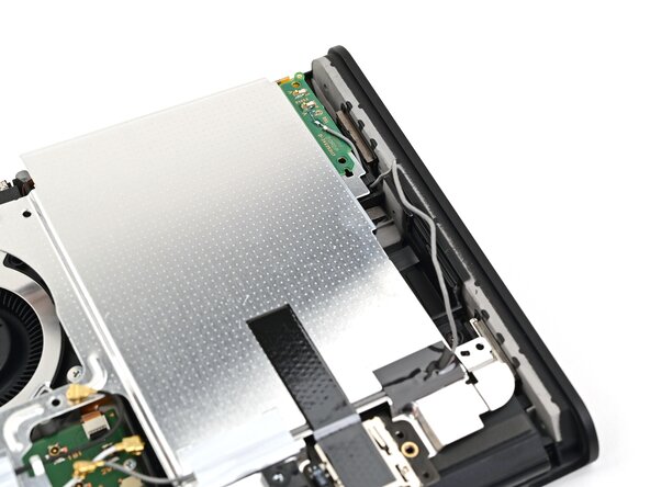

    • Lift and slide the shield plate away from the right edge of the console until the gray antenna cable is completely free.

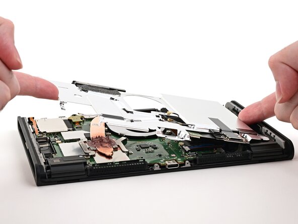

  32. Nintendo Switch 2 Microphone Replacement, Remove the shield plate: crwdns2935265:032crwdnd2935265:01crwdnd2935265:02crwdne2935265:0 Nintendo Switch 2 Microphone Replacement, Remove the shield plate: crwdns2935265:032crwdnd2935265:02crwdnd2935265:02crwdne2935265:0
    • Pick up and remove the shield plate.

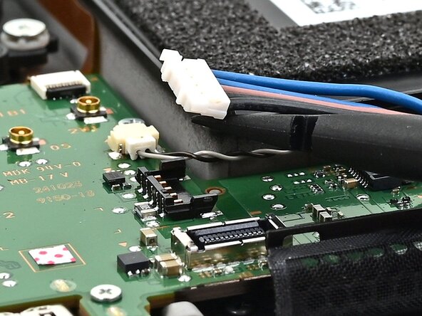

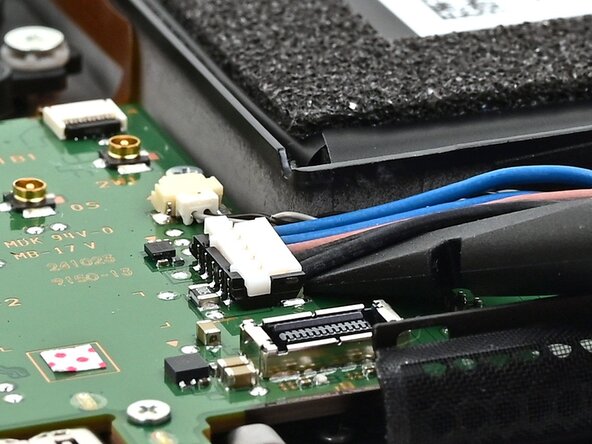

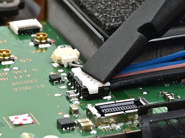

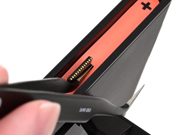

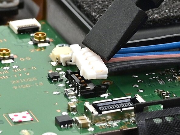

  33. Nintendo Switch 2 Microphone Replacement, Disconnect the battery: crwdns2935265:033crwdnd2935265:01crwdnd2935265:02crwdne2935265:0 Nintendo Switch 2 Microphone Replacement, Disconnect the battery: crwdns2935265:033crwdnd2935265:02crwdnd2935265:02crwdne2935265:0
    • Insert the flat end of a spudger underneath the flat-topped battery connector, located next to the battery, and pry up to disconnect it.

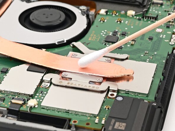

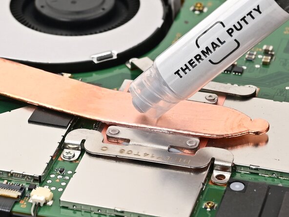

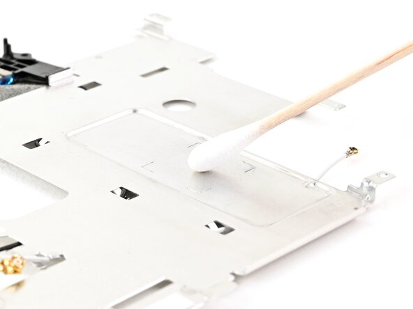

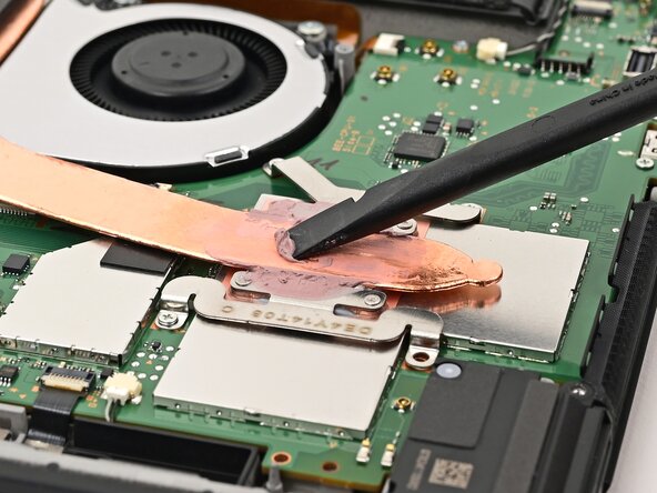

  34. Nintendo Switch 2 Microphone Replacement, Clean the heat pipe: crwdns2935265:034crwdnd2935265:01crwdnd2935265:03crwdne2935265:0 Nintendo Switch 2 Microphone Replacement, Clean the heat pipe: crwdns2935265:034crwdnd2935265:02crwdnd2935265:03crwdne2935265:0 Nintendo Switch 2 Microphone Replacement, Clean the heat pipe: crwdns2935265:034crwdnd2935265:03crwdnd2935265:03crwdne2935265:0
    Arctic Silver ArctiClean
    $9.99
    • If you don't have replacement thermal putty, use the flat end of a spudger to distribute the old putty evenly across the heat pipe, as thick as possible to ensure proper contact. Repeat this process on the shield plate, then skip this step.
    • Use the flat end of a spudger to scrape off the thermal putty on top of the copper heat pipe.
    • Apply high-concentration (90% or higher) isopropyl alcohol or thermal material remover to a cotton swab or lint-free cloth and wipe away any remaining thermal putty on both the heat pipe and shield plate.
    • Don't use a paper towel or rag, as they may scratch the shield plate.

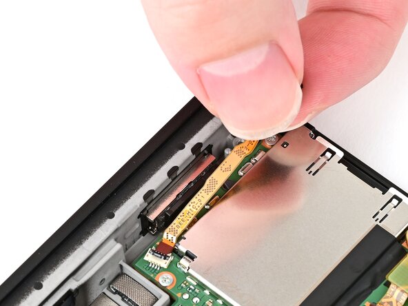

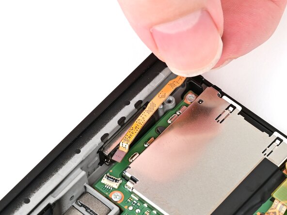

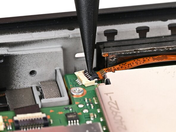

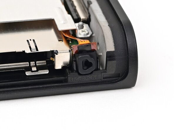

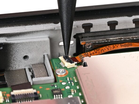

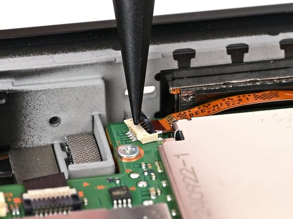

  35. Nintendo Switch 2 Microphone Replacement, Disconnect the microphone: crwdns2935265:035crwdnd2935265:01crwdnd2935265:02crwdne2935265:0 Nintendo Switch 2 Microphone Replacement, Disconnect the microphone: crwdns2935265:035crwdnd2935265:02crwdnd2935265:02crwdne2935265:0
    • Use the point of a spudger to flip up the locking flap on the microphone cable ZIF connector, located on the console's board.
  36. Nintendo Switch 2 Microphone Replacement, Remove the microphone: crwdns2935265:036crwdnd2935265:01crwdnd2935265:03crwdne2935265:0 Nintendo Switch 2 Microphone Replacement, Remove the microphone: crwdns2935265:036crwdnd2935265:02crwdnd2935265:03crwdne2935265:0 Nintendo Switch 2 Microphone Replacement, Remove the microphone: crwdns2935265:036crwdnd2935265:03crwdnd2935265:03crwdne2935265:0
    • Pick up the microphone and pull its cable out of its socket to remove it.

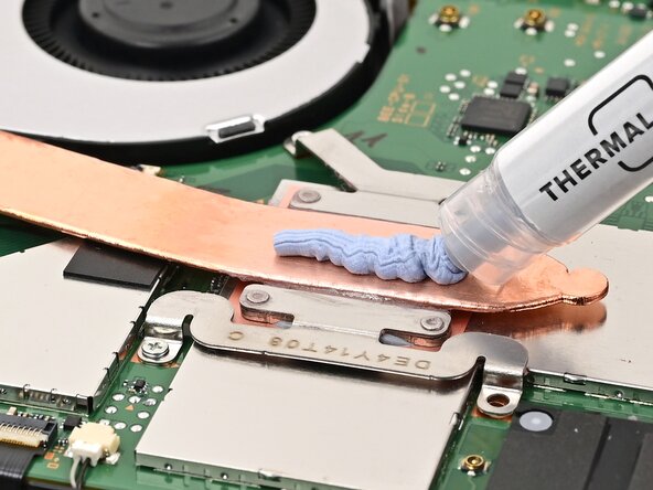

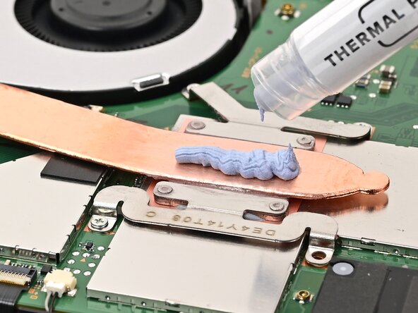

  41. Nintendo Switch 2 Microphone Replacement, Apply thermal putty: crwdns2935265:041crwdnd2935265:01crwdnd2935265:03crwdne2935265:0 Nintendo Switch 2 Microphone Replacement, Apply thermal putty: crwdns2935265:041crwdnd2935265:02crwdnd2935265:03crwdne2935265:0 Nintendo Switch 2 Microphone Replacement, Apply thermal putty: crwdns2935265:041crwdnd2935265:03crwdnd2935265:03crwdne2935265:0
    iFixit Thermal Putty
    $9.95
    • Apply a line of new thermal putty down the center of the heat pipe, roughly the thickness of a pea.

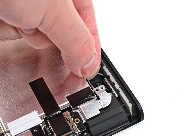

  42. Nintendo Switch 2 Microphone Replacement, Route the gray antenna cable: crwdns2935265:042crwdnd2935265:01crwdnd2935265:03crwdne2935265:0 Nintendo Switch 2 Microphone Replacement, Route the gray antenna cable: crwdns2935265:042crwdnd2935265:02crwdnd2935265:03crwdne2935265:0 Nintendo Switch 2 Microphone Replacement, Route the gray antenna cable: crwdns2935265:042crwdnd2935265:03crwdnd2935265:03crwdne2935265:0
    • Hold the top‑right corner of the shield plate above the top‑right corner of the console.
    • Route the gray antenna cable underneath the black hook near the top corner of the frame.

    • Use tweezers to hold the lower antenna coaxial connector in place over its socket and gently press down with your finger or a spudger—the connector should "snap" into place. If you're having trouble, reposition the head instead of using more force.
    • Repeat this process to connect the three central coaxial connectors to their respective sockets.
    • The black cable connects to the socket closest to the fan, the white to the middle, and the gray the furthest away.
  49. Nintendo Switch 2 Microphone Replacement, Install the upper antenna: crwdns2935265:049crwdnd2935265:01crwdnd2935265:03crwdne2935265:0 Nintendo Switch 2 Microphone Replacement, Install the upper antenna: crwdns2935265:049crwdnd2935265:02crwdnd2935265:03crwdne2935265:0 Nintendo Switch 2 Microphone Replacement, Install the upper antenna: crwdns2935265:049crwdnd2935265:03crwdnd2935265:03crwdne2935265:0
    • Use tweezers or your fingers to align the upper antenna with its screw holes and black alignment pegs and set it into place.
    • Use a JIS 00 driver to install the two screws securing the upper antenna:
  50. Nintendo Switch 2 Microphone Replacement, Install the lower antenna: crwdns2935265:050crwdnd2935265:01crwdnd2935265:03crwdne2935265:0 Nintendo Switch 2 Microphone Replacement, Install the lower antenna: crwdns2935265:050crwdnd2935265:02crwdnd2935265:03crwdne2935265:0 Nintendo Switch 2 Microphone Replacement, Install the lower antenna: crwdns2935265:050crwdnd2935265:03crwdnd2935265:03crwdne2935265:0
    • Use tweezers or your fingers to align the lower antenna with its screw holes and gray alignment pegs and set it into place.
    • Use a JIS 00 driver to install the three 4.4 mm‑long screws securing the lower antenna.
  51. Nintendo Switch 2 Microphone Replacement, Prepare the back cover: crwdns2935265:051crwdnd2935265:01crwdnd2935265:03crwdne2935265:0 Nintendo Switch 2 Microphone Replacement, Prepare the back cover: crwdns2935265:051crwdnd2935265:02crwdnd2935265:03crwdne2935265:0 Nintendo Switch 2 Microphone Replacement, Prepare the back cover: crwdns2935265:051crwdnd2935265:03crwdnd2935265:03crwdne2935265:0
    • Fully pull out the game card tray.
    • Double-check the power and volume buttons to ensure they're seated correctly. If the rubber membrane beneath the buttons is out of place, ensure it's aligned with its pegs.
    • Check the microphone to ensure it's fully seated in its slot in the frame.
  52. Nintendo Switch 2 Microphone Replacement, Install the back cover: crwdns2935265:052crwdnd2935265:01crwdnd2935265:03crwdne2935265:0 Nintendo Switch 2 Microphone Replacement, Install the back cover: crwdns2935265:052crwdnd2935265:02crwdnd2935265:03crwdne2935265:0 Nintendo Switch 2 Microphone Replacement, Install the back cover: crwdns2935265:052crwdnd2935265:03crwdnd2935265:03crwdne2935265:0
    • Align the top of the back cover with the top of the console.
    • Set the top edge of the back cover into place, checking the buttons and ports to ensure they're aligned properly. If they aren't, lift the back cover and try again.
    • Press along the top edge to fasten the clips securing the back cover to the console.
  53. Nintendo Switch 2 Microphone Replacement: crwdns2935265:053crwdnd2935265:01crwdnd2935265:02crwdne2935265:0 Nintendo Switch 2 Microphone Replacement: crwdns2935265:053crwdnd2935265:02crwdnd2935265:02crwdne2935265:0
    • Squeeze the rest of the back cover and console together to fasten the clips.
  54. Nintendo Switch 2 Microphone Replacement, Install the back-side screws: crwdns2935265:054crwdnd2935265:01crwdnd2935265:03crwdne2935265:0 Nintendo Switch 2 Microphone Replacement, Install the back-side screws: crwdns2935265:054crwdnd2935265:02crwdnd2935265:03crwdne2935265:0 Nintendo Switch 2 Microphone Replacement, Install the back-side screws: crwdns2935265:054crwdnd2935265:03crwdnd2935265:03crwdne2935265:0
    • Use a JIS 00 driver to install the three 3.1 mm‑long screws securing the back cover: one on the top edge of the console, and two on either side of the bottom USB-C port.
    • Use a Y00 driver to install the two 4.4 mm‑long screws in the kickstand cutout.
  55. Nintendo Switch 2 Microphone Replacement, Install the side screws: crwdns2935265:055crwdnd2935265:01crwdnd2935265:02crwdne2935265:0 Nintendo Switch 2 Microphone Replacement, Install the side screws: crwdns2935265:055crwdnd2935265:02crwdnd2935265:02crwdne2935265:0
    • Install the two 3.6 mm‑long gold screws on each side of the console (four in total).
  56. Nintendo Switch 2 Microphone Replacement, Test the console: crwdns2935265:056crwdnd2935265:01crwdnd2935265:02crwdne2935265:0 Nintendo Switch 2 Microphone Replacement, Test the console: crwdns2935265:056crwdnd2935265:02crwdnd2935265:02crwdne2935265:0
    • Power on the console and test functionality to ensure it's working as expected.
  57. Nintendo Switch 2 Microphone Replacement, Install the stickers: crwdns2935265:057crwdnd2935265:01crwdnd2935265:03crwdne2935265:0 Nintendo Switch 2 Microphone Replacement, Install the stickers: crwdns2935265:057crwdnd2935265:02crwdnd2935265:03crwdne2935265:0 Nintendo Switch 2 Microphone Replacement, Install the stickers: crwdns2935265:057crwdnd2935265:03crwdnd2935265:03crwdne2935265:0
    • Align the right side sticker with its recess. Ensure the cutout in the sticker is aligned with the Joy-Con connector.
    • Set the sticker into its recess, first on one side, then the other.
    • Use your finger or the flat end of a spudger to press the sticker into place.
    • If the sticker isn't sticking well, apply heat after you press it into place.
  58. Nintendo Switch 2 Microphone Replacement: crwdns2935265:058crwdnd2935265:01crwdnd2935265:03crwdne2935265:0 Nintendo Switch 2 Microphone Replacement: crwdns2935265:058crwdnd2935265:02crwdnd2935265:03crwdne2935265:0 Nintendo Switch 2 Microphone Replacement: crwdns2935265:058crwdnd2935265:03crwdnd2935265:03crwdne2935265:0
    • Repeat this procedure to install the left side sticker.
