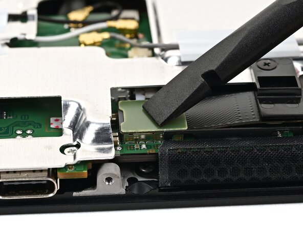

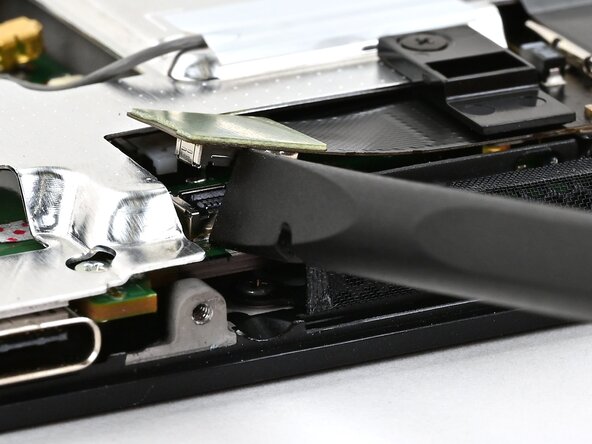

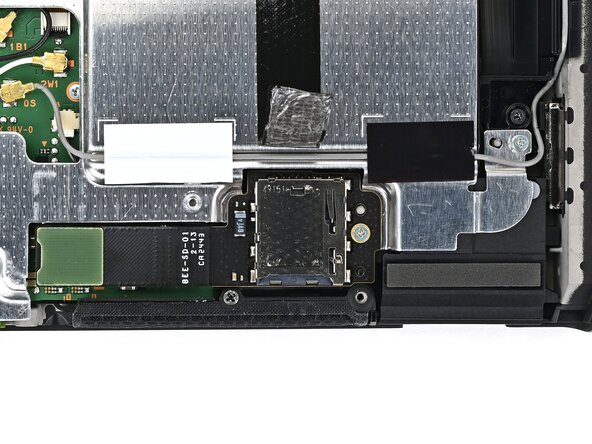

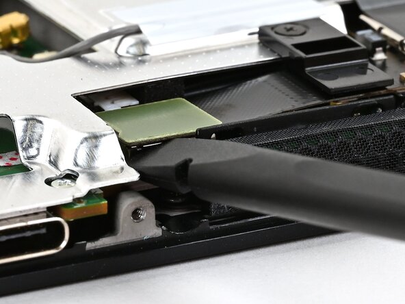

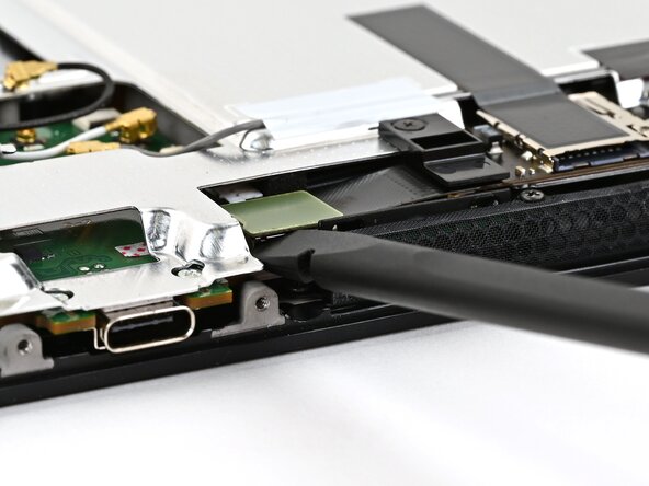

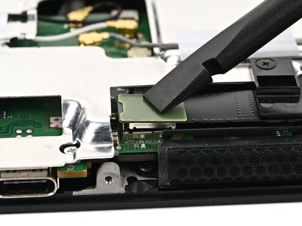

  19. Nintendo Switch 2 MicroSD Card Reader Replacement, Disconnect the MicroSD card reader: crwdns2935265:019crwdnd2935265:01crwdnd2935265:03crwdne2935265:0 Nintendo Switch 2 MicroSD Card Reader Replacement, Disconnect the MicroSD card reader: crwdns2935265:019crwdnd2935265:02crwdnd2935265:03crwdne2935265:0 Nintendo Switch 2 MicroSD Card Reader Replacement, Disconnect the MicroSD card reader: crwdns2935265:019crwdnd2935265:03crwdnd2935265:03crwdne2935265:0
    • Use the flat end of a spudger to pry up and disconnect the MicroSD card reader press connector, located next to the bottom USB‑C port.

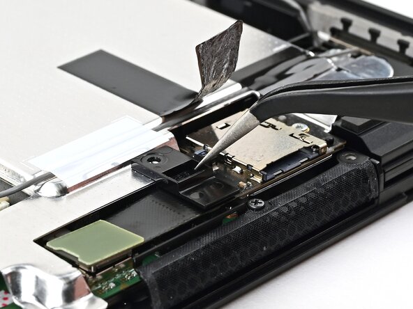

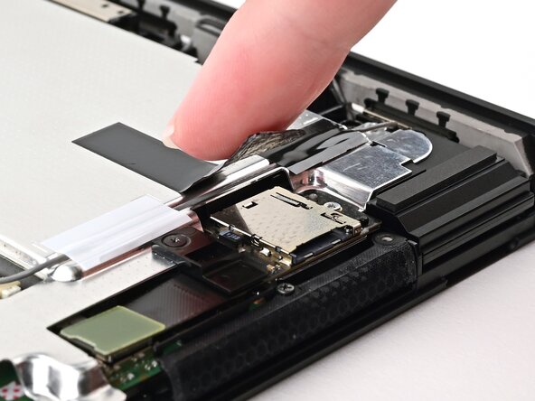

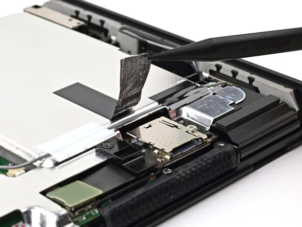

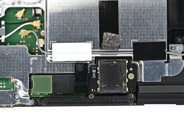

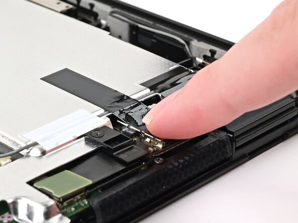

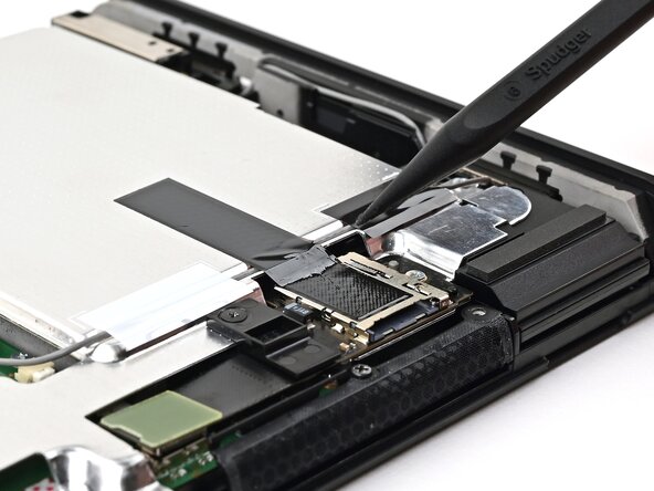

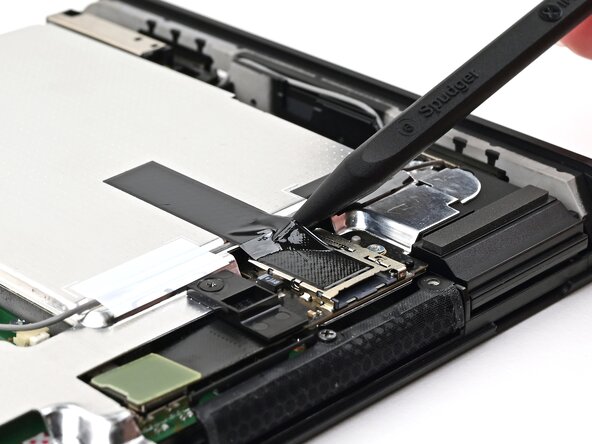

  20. Nintendo Switch 2 MicroSD Card Reader Replacement, Lift the tape: crwdns2935265:020crwdnd2935265:01crwdnd2935265:03crwdne2935265:0 Nintendo Switch 2 MicroSD Card Reader Replacement, Lift the tape: crwdns2935265:020crwdnd2935265:02crwdnd2935265:03crwdne2935265:0 Nintendo Switch 2 MicroSD Card Reader Replacement, Lift the tape: crwdns2935265:020crwdnd2935265:03crwdnd2935265:03crwdne2935265:0
    • Insert the point of a spudger underneath the black tape securing the MicroSD card reader.
    • Slowly lift the tape off the card reader.
    • Leave the tape attached to the shield plate—it'll be reused during reassembly.

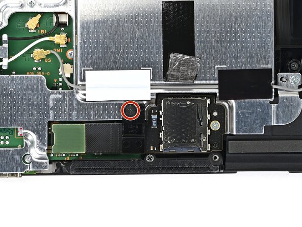

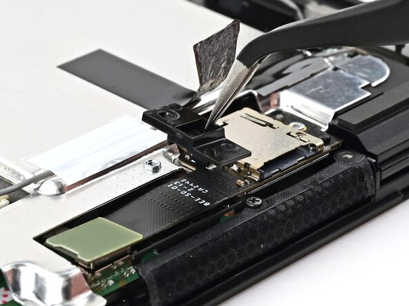

  21. Nintendo Switch 2 MicroSD Card Reader Replacement, Remove the cable bracket: crwdns2935265:021crwdnd2935265:01crwdnd2935265:02crwdne2935265:0 Nintendo Switch 2 MicroSD Card Reader Replacement, Remove the cable bracket: crwdns2935265:021crwdnd2935265:02crwdnd2935265:02crwdne2935265:0
    • Use a JIS 00 driver to remove the 1.6 mm‑long black screw securing the bracket over the MicroSD card reader's cable.
  22. Nintendo Switch 2 MicroSD Card Reader Replacement: crwdns2935265:022crwdnd2935265:01crwdnd2935265:02crwdne2935265:0 Nintendo Switch 2 MicroSD Card Reader Replacement: crwdns2935265:022crwdnd2935265:02crwdnd2935265:02crwdne2935265:0
    • Pick up and remove the bracket securing the card reader's cable.

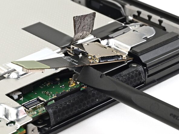

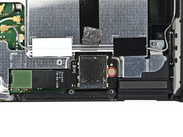

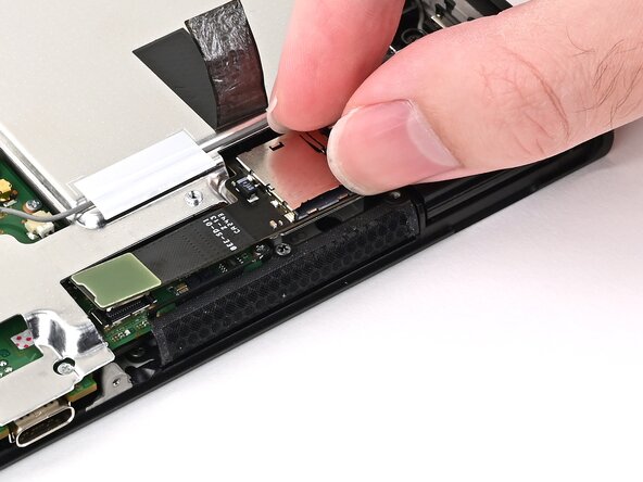

  23. Nintendo Switch 2 MicroSD Card Reader Replacement, Remove the MicroSD card reader: crwdns2935265:023crwdnd2935265:01crwdnd2935265:02crwdne2935265:0 Nintendo Switch 2 MicroSD Card Reader Replacement, Remove the MicroSD card reader: crwdns2935265:023crwdnd2935265:02crwdnd2935265:02crwdne2935265:0
    • Use a JIS 00 driver to remove the 4.4 mm‑long silver screw securing the MicroSD card reader.

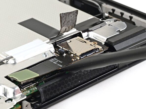

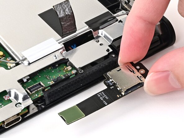

  24. Nintendo Switch 2 MicroSD Card Reader Replacement: crwdns2935265:024crwdnd2935265:01crwdnd2935265:02crwdne2935265:0 Nintendo Switch 2 MicroSD Card Reader Replacement: crwdns2935265:024crwdnd2935265:02crwdnd2935265:02crwdne2935265:0
    • Use your fingers or the flat end of a spudger to lift the MicroSD card reader to separate the adhesive securing it to the shield plate.

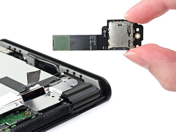

  25. Nintendo Switch 2 MicroSD Card Reader Replacement: crwdns2935265:025crwdnd2935265:01crwdnd2935265:01crwdne2935265:0
    • Remove the MicroSD card reader
  26. Nintendo Switch 2 MicroSD Card Reader Replacement, Disassembly complete: crwdns2935265:026crwdnd2935265:01crwdnd2935265:01crwdne2935265:0

  32. Nintendo Switch 2 MicroSD Card Reader Replacement, Connect the MicroSD card reader: crwdns2935265:032crwdnd2935265:01crwdnd2935265:02crwdne2935265:0 Nintendo Switch 2 MicroSD Card Reader Replacement, Connect the MicroSD card reader: crwdns2935265:032crwdnd2935265:02crwdnd2935265:02crwdne2935265:0
    • Use your finger or the flat end of a spudger to press the MicroSD card reader press connector onto its socket on the board.
    • Don't try to force the connector into place. If you're having trouble, lift it and try again.
