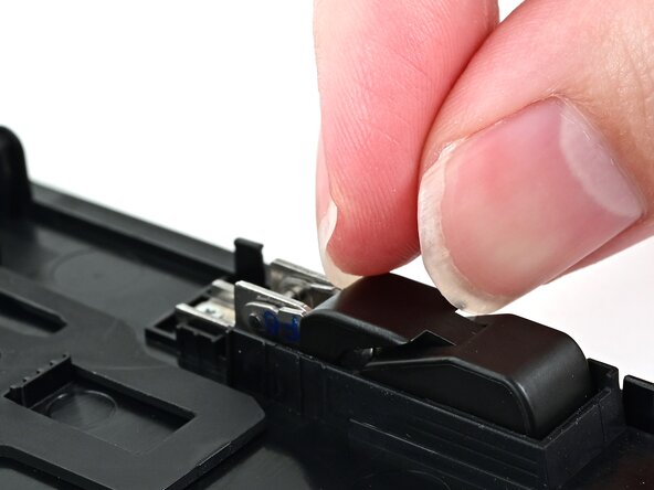

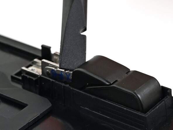

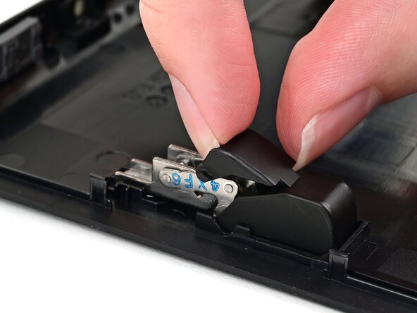

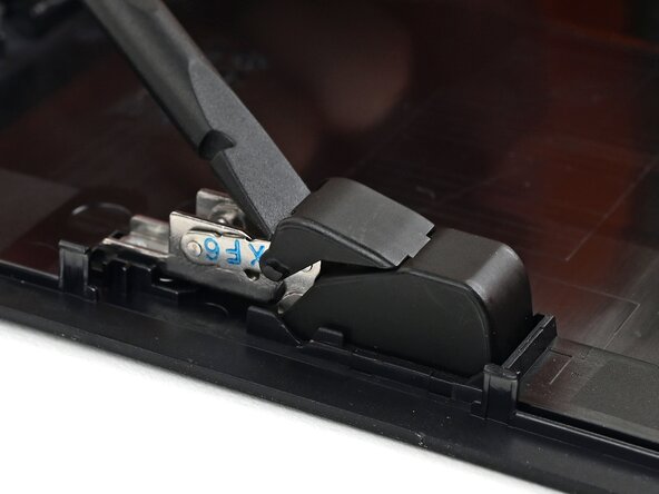

  19. Nintendo Switch 2 Kickstand Replacement, Remove the upper hinge covers: crwdns2935265:019crwdnd2935265:01crwdnd2935265:02crwdne2935265:0 Nintendo Switch 2 Kickstand Replacement, Remove the upper hinge covers: crwdns2935265:019crwdnd2935265:02crwdnd2935265:02crwdne2935265:0
    • Use the flat end of a spudger to pry up one of the hinge's plastic upper hinge covers until it "pops" up.

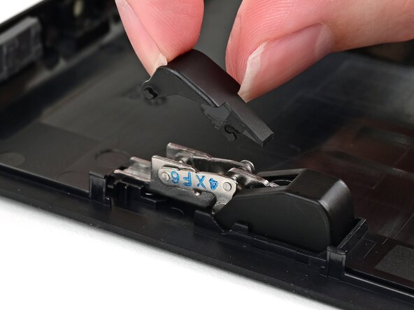

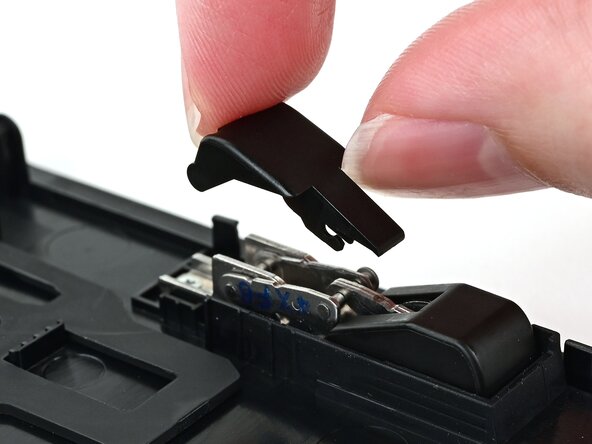

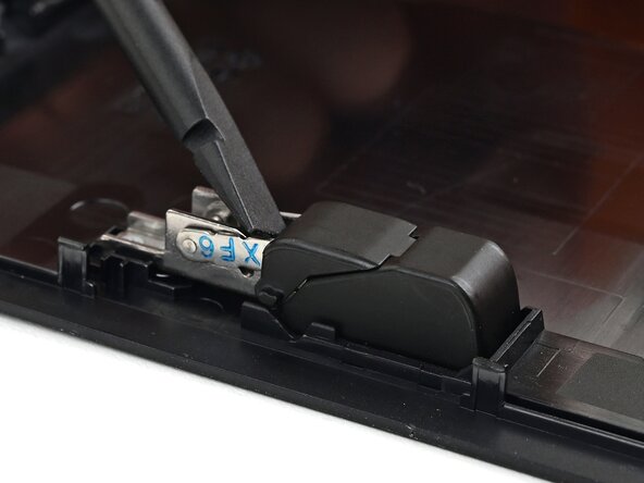

  20. Nintendo Switch 2 Kickstand Replacement: crwdns2935265:020crwdnd2935265:01crwdnd2935265:02crwdne2935265:0 Nintendo Switch 2 Kickstand Replacement: crwdns2935265:020crwdnd2935265:02crwdnd2935265:02crwdne2935265:0
    • Pull the upper hinge cover out from underneath the lower hinge cover to remove it.
    • The cover is clipped in place and requires a little bit of force to remove.

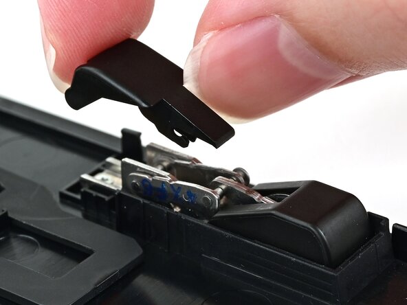

  21. Nintendo Switch 2 Kickstand Replacement: crwdns2935265:021crwdnd2935265:01crwdnd2935265:03crwdne2935265:0 Nintendo Switch 2 Kickstand Replacement: crwdns2935265:021crwdnd2935265:02crwdnd2935265:03crwdne2935265:0 Nintendo Switch 2 Kickstand Replacement: crwdns2935265:021crwdnd2935265:03crwdnd2935265:03crwdne2935265:0
    • Repeat this process to remove the upper hinge cover on the other hinge.

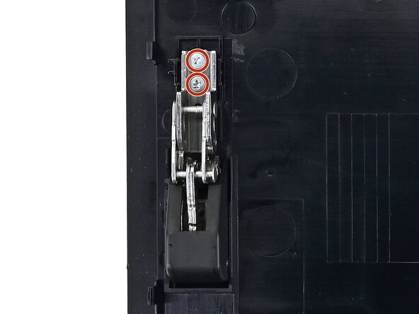

  22. Nintendo Switch 2 Kickstand Replacement, Remove the kickstand screws: crwdns2935265:022crwdnd2935265:01crwdnd2935265:02crwdne2935265:0 Nintendo Switch 2 Kickstand Replacement, Remove the kickstand screws: crwdns2935265:022crwdnd2935265:02crwdnd2935265:02crwdne2935265:0
    • Use a JIS 00 driver to remove the two 2.3 mm‑long silver screws securing each hinge to the inside of the back cover (four total).

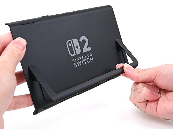

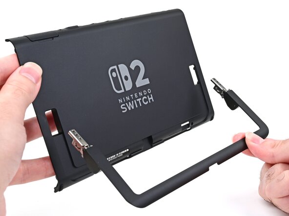

  23. Nintendo Switch 2 Kickstand Replacement, Remove the kickstand: crwdns2935265:023crwdnd2935265:01crwdnd2935265:03crwdne2935265:0 Nintendo Switch 2 Kickstand Replacement, Remove the kickstand: crwdns2935265:023crwdnd2935265:02crwdnd2935265:03crwdne2935265:0 Nintendo Switch 2 Kickstand Replacement, Remove the kickstand: crwdns2935265:023crwdnd2935265:03crwdnd2935265:03crwdne2935265:0
    • Open the kickstand to a 45‑degree angle and pull it out of the back cover to remove it.

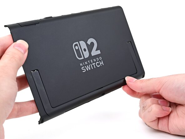

  25. Nintendo Switch 2 Kickstand Replacement, Install the kickstand: crwdns2935265:025crwdnd2935265:01crwdnd2935265:03crwdne2935265:0 Nintendo Switch 2 Kickstand Replacement, Install the kickstand: crwdns2935265:025crwdnd2935265:02crwdnd2935265:03crwdne2935265:0 Nintendo Switch 2 Kickstand Replacement, Install the kickstand: crwdns2935265:025crwdnd2935265:03crwdnd2935265:03crwdne2935265:0
    • Align the kickstand so its hinge covers are facing the back cover.
    • Insert the hinges through their slots in the back cover and set the kickstand into its cutout.

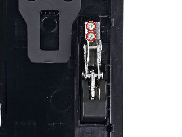

  26. Nintendo Switch 2 Kickstand Replacement, Install the kickstand screws: crwdns2935265:026crwdnd2935265:01crwdnd2935265:02crwdne2935265:0 Nintendo Switch 2 Kickstand Replacement, Install the kickstand screws: crwdns2935265:026crwdnd2935265:02crwdnd2935265:02crwdne2935265:0
    • Use a JIS 00 driver to install the two 2.3 mm‑long silver screws securing each hinge to the inside of the back cover (four total).

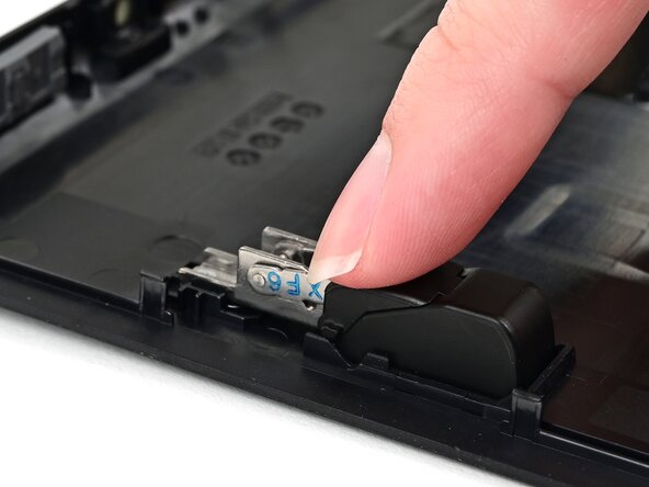

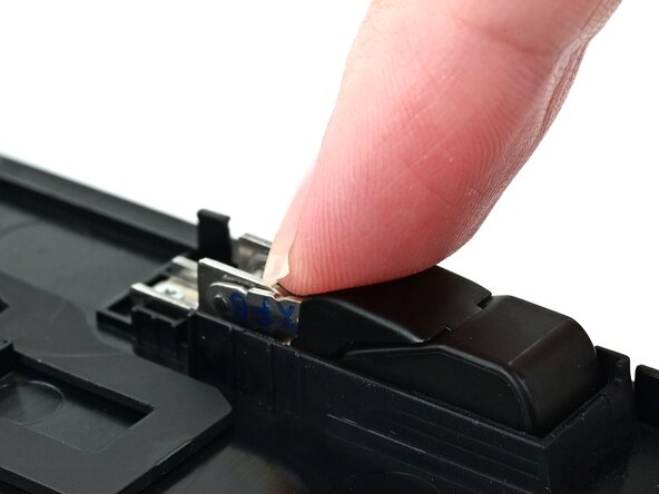

  27. Nintendo Switch 2 Kickstand Replacement, Install the upper hinge covers: crwdns2935265:027crwdnd2935265:01crwdnd2935265:03crwdne2935265:0 Nintendo Switch 2 Kickstand Replacement, Install the upper hinge covers: crwdns2935265:027crwdnd2935265:02crwdnd2935265:03crwdne2935265:0 Nintendo Switch 2 Kickstand Replacement, Install the upper hinge covers: crwdns2935265:027crwdnd2935265:03crwdnd2935265:03crwdne2935265:0

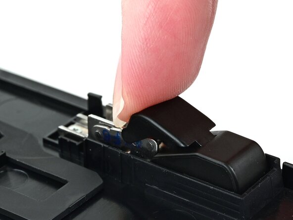

    • Align one of the upper hinge covers with its respective hinge, and slide it underneath the lower hinge cover.
    • Use your finger to press the upper hinge cover down until it clicks into place.

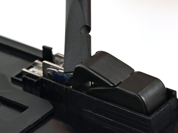

  28. Nintendo Switch 2 Kickstand Replacement: crwdns2935265:028crwdnd2935265:01crwdnd2935265:03crwdne2935265:0 Nintendo Switch 2 Kickstand Replacement: crwdns2935265:028crwdnd2935265:02crwdnd2935265:03crwdne2935265:0 Nintendo Switch 2 Kickstand Replacement: crwdns2935265:028crwdnd2935265:03crwdnd2935265:03crwdne2935265:0
    • Repeat this process to install the other upper hinge cover.
