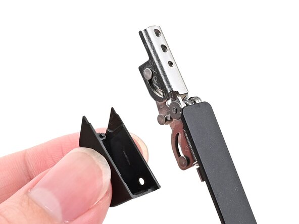

  19. Nintendo Switch 2 Hinges Replacement, Remove the upper hinge covers: crwdns2935265:019crwdnd2935265:01crwdnd2935265:02crwdne2935265:0 Nintendo Switch 2 Hinges Replacement, Remove the upper hinge covers: crwdns2935265:019crwdnd2935265:02crwdnd2935265:02crwdne2935265:0
    • Use the flat end of a spudger to pry up one of the hinge's plastic upper hinge covers until it "pops" up.
  20. Nintendo Switch 2 Hinges Replacement: crwdns2935265:020crwdnd2935265:01crwdnd2935265:02crwdne2935265:0 Nintendo Switch 2 Hinges Replacement: crwdns2935265:020crwdnd2935265:02crwdnd2935265:02crwdne2935265:0
    • Pull the upper hinge cover out from underneath the lower hinge cover to remove it.
    • The cover is clipped in place and requires a little bit of force to remove.
  21. Nintendo Switch 2 Hinges Replacement: crwdns2935265:021crwdnd2935265:01crwdnd2935265:03crwdne2935265:0 Nintendo Switch 2 Hinges Replacement: crwdns2935265:021crwdnd2935265:02crwdnd2935265:03crwdne2935265:0 Nintendo Switch 2 Hinges Replacement: crwdns2935265:021crwdnd2935265:03crwdnd2935265:03crwdne2935265:0
    • Repeat this process to remove the upper hinge cover on the other hinge.

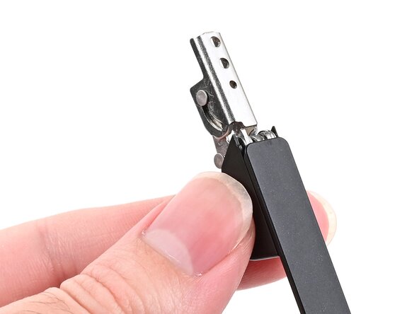

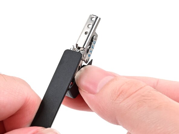

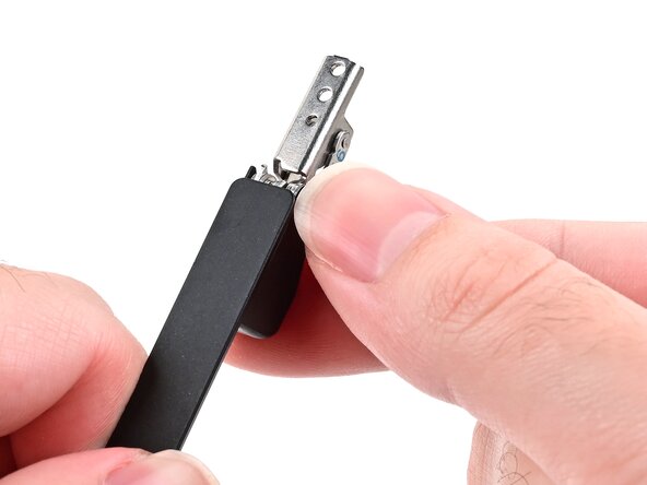

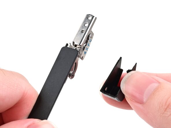

  24. Nintendo Switch 2 Hinges Replacement, Remove the hinge covers: crwdns2935265:024crwdnd2935265:01crwdnd2935265:02crwdne2935265:0 Nintendo Switch 2 Hinges Replacement, Remove the hinge covers: crwdns2935265:024crwdnd2935265:02crwdnd2935265:02crwdne2935265:0
    • Use a JIS 00 driver to remove the 1.7 mm‑long black screw securing each hinge cover to the kickstand (two screws total).

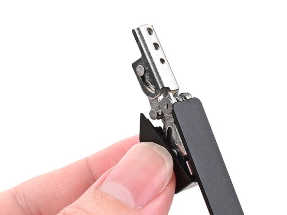

  25. Nintendo Switch 2 Hinges Replacement: crwdns2935265:025crwdnd2935265:01crwdnd2935265:03crwdne2935265:0 Nintendo Switch 2 Hinges Replacement: crwdns2935265:025crwdnd2935265:02crwdnd2935265:03crwdne2935265:0 Nintendo Switch 2 Hinges Replacement: crwdns2935265:025crwdnd2935265:03crwdnd2935265:03crwdne2935265:0
    • Use your fingers to pull one of the hinge covers at a downward angle away from its hinge to remove it.
  26. Nintendo Switch 2 Hinges Replacement: crwdns2935265:026crwdnd2935265:01crwdnd2935265:03crwdne2935265:0 Nintendo Switch 2 Hinges Replacement: crwdns2935265:026crwdnd2935265:02crwdnd2935265:03crwdne2935265:0 Nintendo Switch 2 Hinges Replacement: crwdns2935265:026crwdnd2935265:03crwdnd2935265:03crwdne2935265:0
    • Repeat this process to pull the hinge cover off the other hinge.

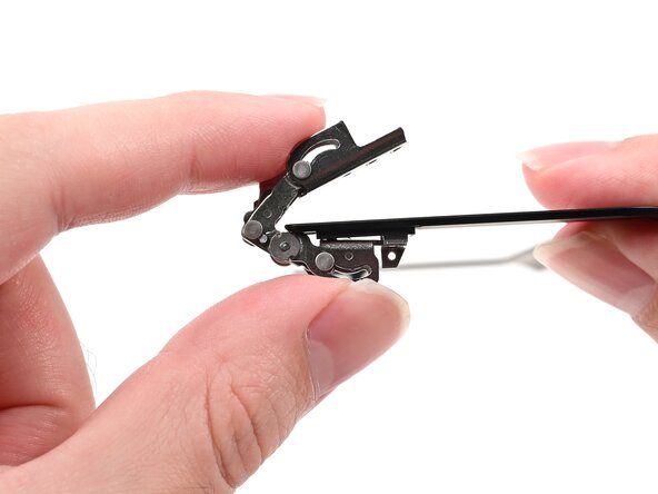

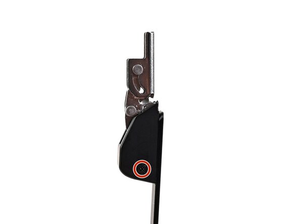

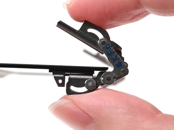

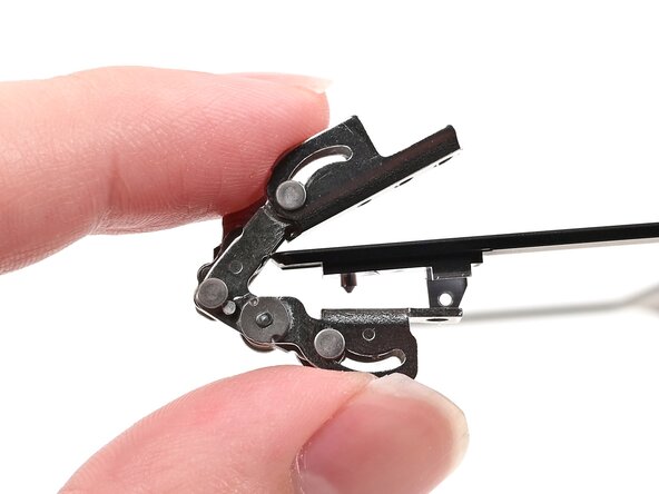

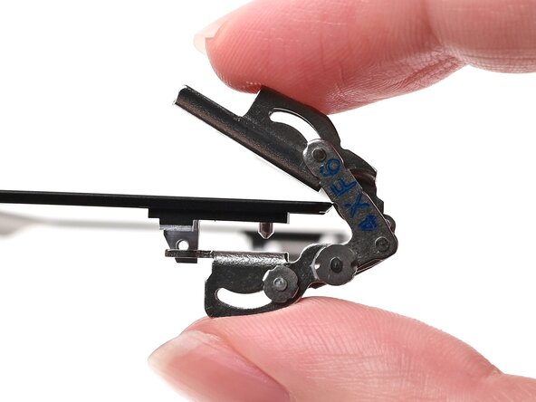

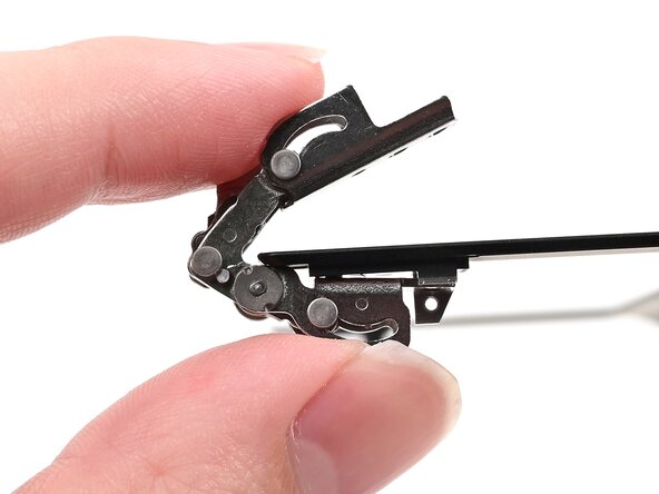

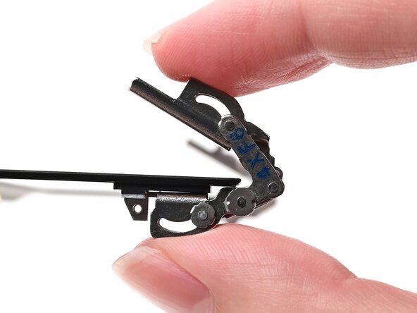

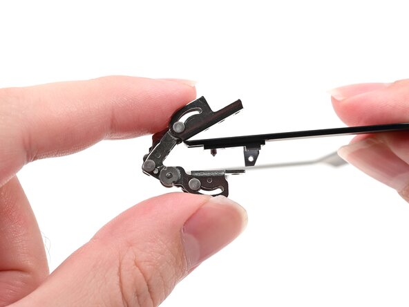

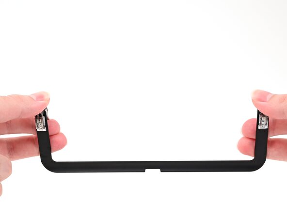

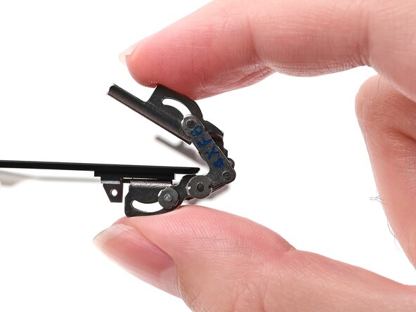

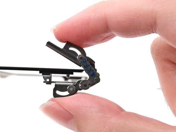

  27. Nintendo Switch 2 Hinges Replacement, Fold the hinges: crwdns2935265:027crwdnd2935265:01crwdnd2935265:03crwdne2935265:0 Nintendo Switch 2 Hinges Replacement, Fold the hinges: crwdns2935265:027crwdnd2935265:02crwdnd2935265:03crwdne2935265:0 Nintendo Switch 2 Hinges Replacement, Fold the hinges: crwdns2935265:027crwdnd2935265:03crwdnd2935265:03crwdne2935265:0
    • Use your fingers to fold both hinges as far back as they'll go.

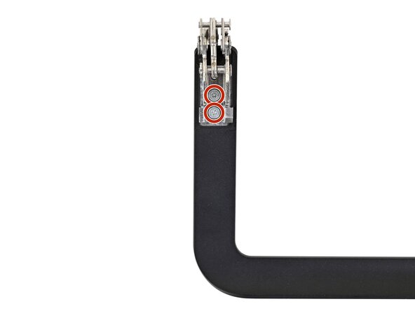

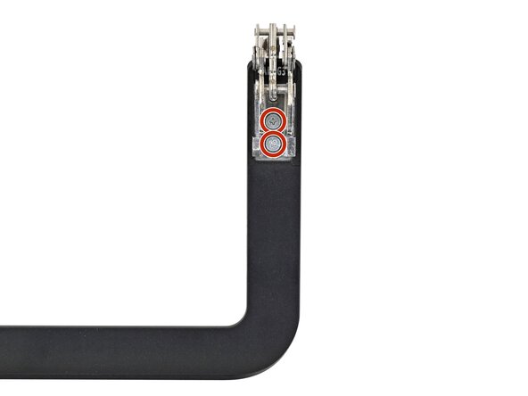

  28. Nintendo Switch 2 Hinges Replacement, Remove the hinge screws: crwdns2935265:028crwdnd2935265:01crwdnd2935265:02crwdne2935265:0 Nintendo Switch 2 Hinges Replacement, Remove the hinge screws: crwdns2935265:028crwdnd2935265:02crwdnd2935265:02crwdne2935265:0
    • Use a JIS 00 driver to remove the two 2.3 mm‑long silver screws securing each hinge to the kickstand (four screws in total).

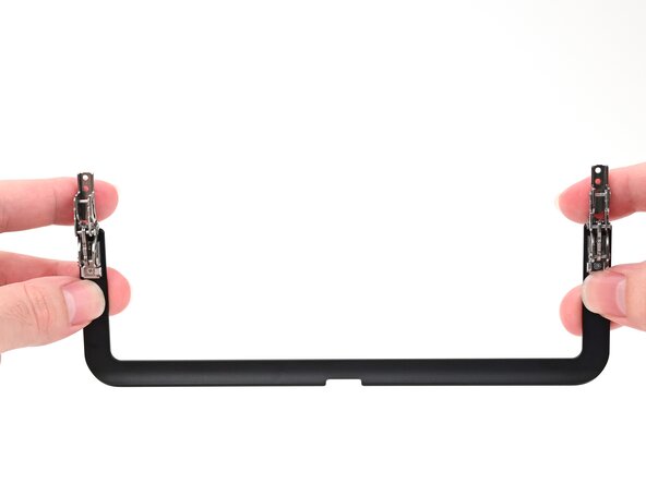

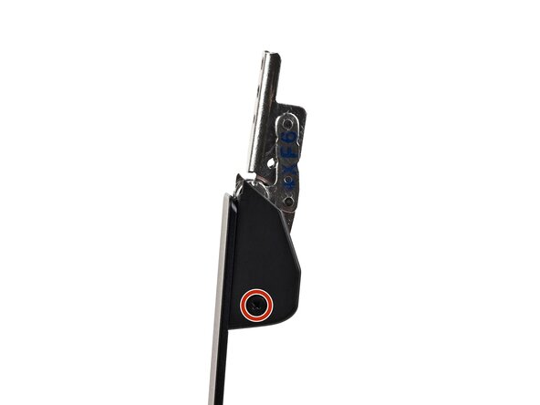

  29. Nintendo Switch 2 Hinges Replacement, Remove the hinges: crwdns2935265:029crwdnd2935265:01crwdnd2935265:03crwdne2935265:0 Nintendo Switch 2 Hinges Replacement, Remove the hinges: crwdns2935265:029crwdnd2935265:02crwdnd2935265:03crwdne2935265:0 Nintendo Switch 2 Hinges Replacement, Remove the hinges: crwdns2935265:029crwdnd2935265:03crwdnd2935265:03crwdne2935265:0
    • Lift one of the hinges off its alignment peg on the kickstand to remove it.
  30. Nintendo Switch 2 Hinges Replacement: crwdns2935265:030crwdnd2935265:01crwdnd2935265:03crwdne2935265:0 Nintendo Switch 2 Hinges Replacement: crwdns2935265:030crwdnd2935265:02crwdnd2935265:03crwdne2935265:0 Nintendo Switch 2 Hinges Replacement: crwdns2935265:030crwdnd2935265:03crwdnd2935265:03crwdne2935265:0
    • Repeat this process to remove the other hinge.
  31. Nintendo Switch 2 Hinges Replacement, Disassembly complete: crwdns2935265:031crwdnd2935265:01crwdnd2935265:01crwdne2935265:0
    • Congratulations on completing disassembly! The remaining steps will show how to reassemble your console.

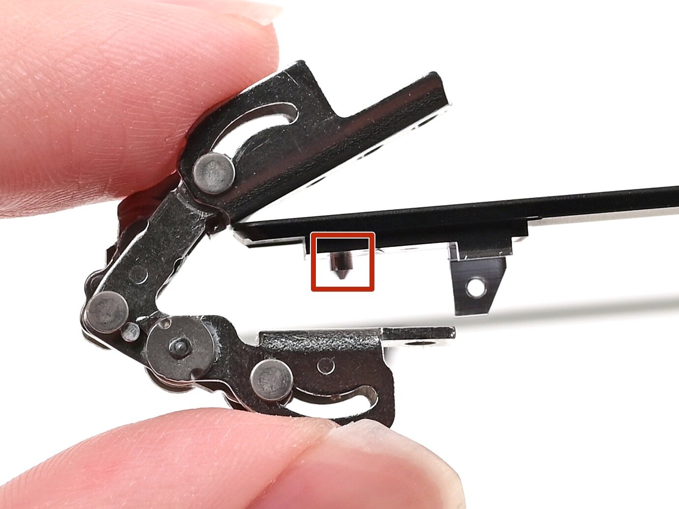

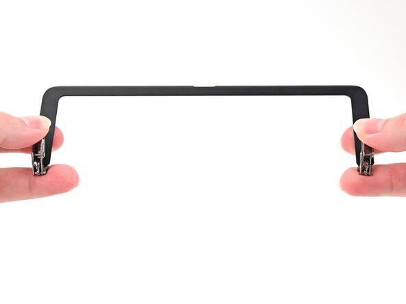

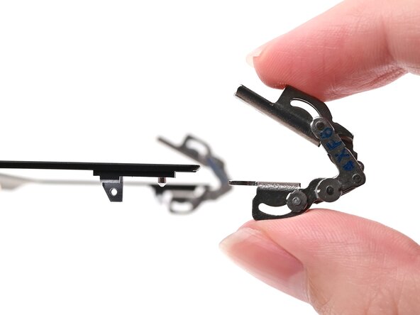

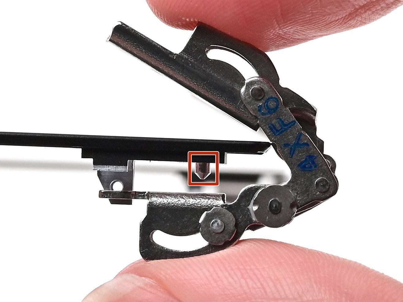

  32. Nintendo Switch 2 Hinges Replacement, Install the hinges: crwdns2935265:032crwdnd2935265:01crwdnd2935265:03crwdne2935265:0 Nintendo Switch 2 Hinges Replacement, Install the hinges: crwdns2935265:032crwdnd2935265:02crwdnd2935265:03crwdne2935265:0 Nintendo Switch 2 Hinges Replacement, Install the hinges: crwdns2935265:032crwdnd2935265:03crwdnd2935265:03crwdne2935265:0
    • Align one of the hinges with its alignment peg on the kickstand and set it into place.
    • Use a JIS 00 driver to install the two 2.3 mm‑long silver screws securing the hinge.

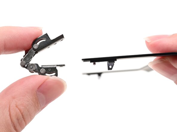

  33. Nintendo Switch 2 Hinges Replacement: crwdns2935265:033crwdnd2935265:01crwdnd2935265:03crwdne2935265:0 Nintendo Switch 2 Hinges Replacement: crwdns2935265:033crwdnd2935265:02crwdnd2935265:03crwdne2935265:0 Nintendo Switch 2 Hinges Replacement: crwdns2935265:033crwdnd2935265:03crwdnd2935265:03crwdne2935265:0
    • Align the other hinge with its alignment peg on the kickstand and set it into place.

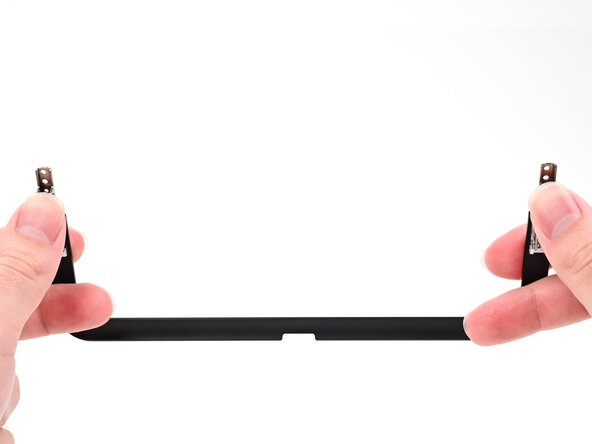

  34. Nintendo Switch 2 Hinges Replacement, Open the hinges: crwdns2935265:034crwdnd2935265:01crwdnd2935265:02crwdne2935265:0 Nintendo Switch 2 Hinges Replacement, Open the hinges: crwdns2935265:034crwdnd2935265:02crwdnd2935265:02crwdne2935265:0
    • Use your fingers to pull the hinges open until they're fully straight.
