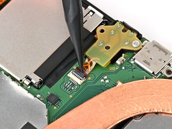

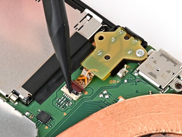

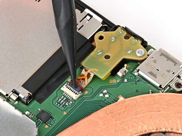

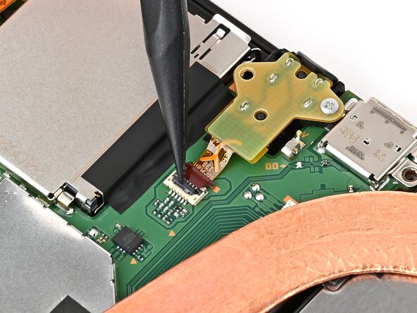

  35. Nintendo Switch 2 Headphone Jack Replacement, Remove the headphone jack: crwdns2935265:035crwdnd2935265:01crwdnd2935265:02crwdne2935265:0 Nintendo Switch 2 Headphone Jack Replacement, Remove the headphone jack: crwdns2935265:035crwdnd2935265:02crwdnd2935265:02crwdne2935265:0
    • Use the point of a spudger to flip up the locking flap on the headphone jack ZIF connector, located on the top edge of the console's board.

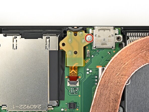

  36. Nintendo Switch 2 Headphone Jack Replacement: crwdns2935265:036crwdnd2935265:01crwdnd2935265:02crwdne2935265:0 Nintendo Switch 2 Headphone Jack Replacement: crwdns2935265:036crwdnd2935265:02crwdnd2935265:02crwdne2935265:0
    • Use a JIS 00 driver to remove the 6.2 mm‑long silver screw securing the headphone jack.

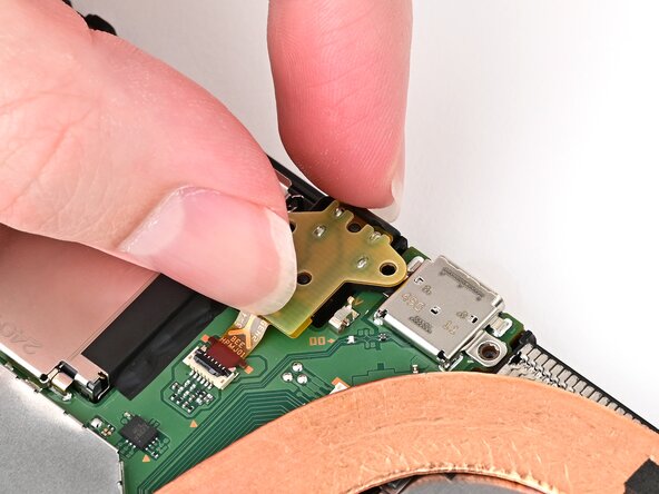

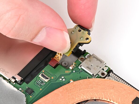

    • Pick up the headphone jack assembly and pull its cable straight out of its connector to remove it.
  38. Nintendo Switch 2 Headphone Jack Replacement, Disassembly complete: crwdns2935265:038crwdnd2935265:01crwdnd2935265:01crwdne2935265:0

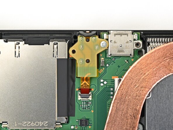

  39. Nintendo Switch 2 Headphone Jack Replacement, Install the headphone jack: crwdns2935265:039crwdnd2935265:01crwdnd2935265:02crwdne2935265:0 Nintendo Switch 2 Headphone Jack Replacement, Install the headphone jack: crwdns2935265:039crwdnd2935265:02crwdnd2935265:02crwdne2935265:0
    • Align the headphone jack assembly with its ZIF connector on the board.
    • Guide the cable into its connector, then set the headphone jack into its recess in the frame.
  40. Nintendo Switch 2 Headphone Jack Replacement: crwdns2935265:040crwdnd2935265:01crwdnd2935265:02crwdne2935265:0 Nintendo Switch 2 Headphone Jack Replacement: crwdns2935265:040crwdnd2935265:02crwdnd2935265:02crwdne2935265:0
    • Use a JIS 00 driver to install the 6.2 mm‑long silver screw securing the headphone jack.
  41. Nintendo Switch 2 Headphone Jack Replacement: crwdns2935265:041crwdnd2935265:01crwdnd2935265:02crwdne2935265:0 Nintendo Switch 2 Headphone Jack Replacement: crwdns2935265:041crwdnd2935265:02crwdnd2935265:02crwdne2935265:0
    • Flip the hinged locking flap down to secure the headphone jack cable.
