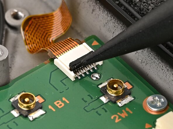

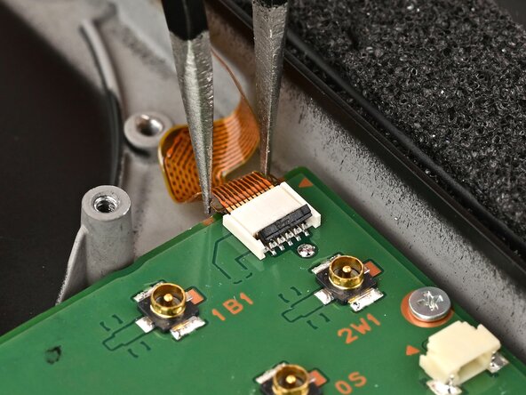

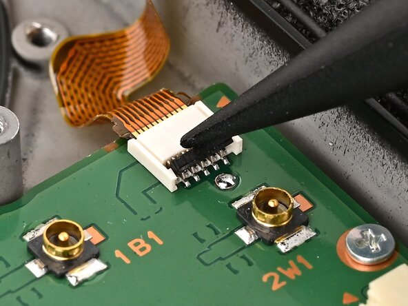

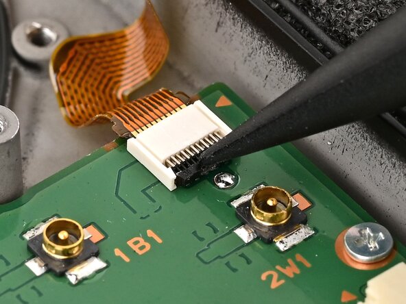

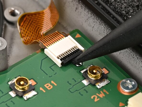

  35. Nintendo Switch 2 Button Board Replacement, Disconnect the button board: crwdns2935265:035crwdnd2935265:01crwdnd2935265:02crwdne2935265:0 Nintendo Switch 2 Button Board Replacement, Disconnect the button board: crwdns2935265:035crwdnd2935265:02crwdnd2935265:02crwdne2935265:0
    • Use the point of a spudger to flip up the locking flap on the button board cable ZIF connector, located next to the battery on the console's board.

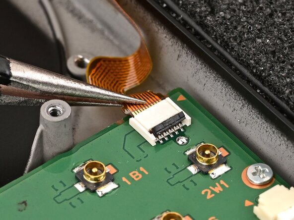

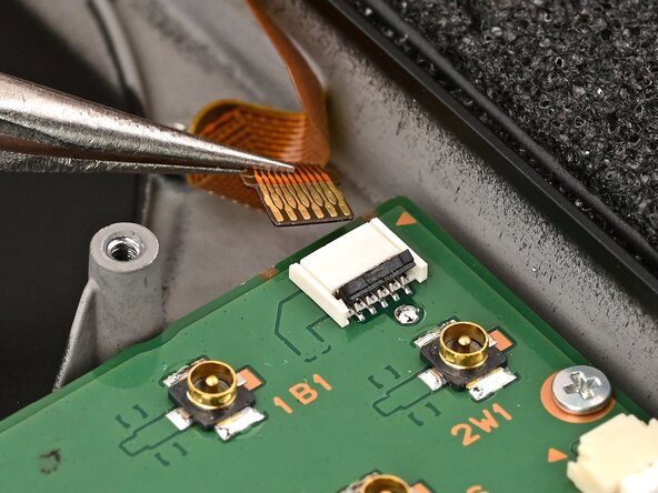

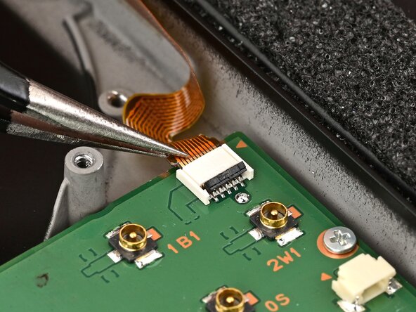

  36. Nintendo Switch 2 Button Board Replacement: crwdns2935265:036crwdnd2935265:01crwdnd2935265:02crwdne2935265:0 Nintendo Switch 2 Button Board Replacement: crwdns2935265:036crwdnd2935265:02crwdnd2935265:02crwdne2935265:0
    • Use tweezers or your fingers to gently pull the cable out of its connector.

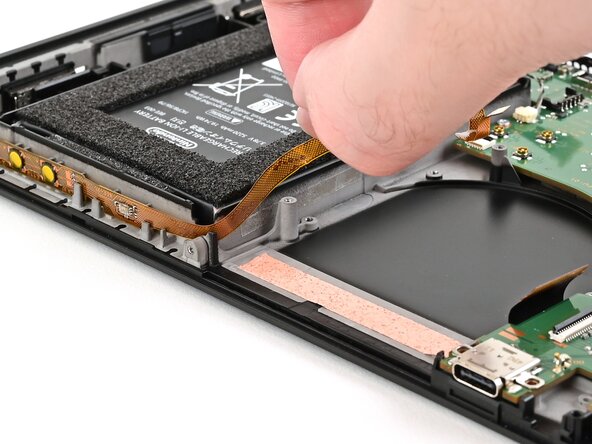

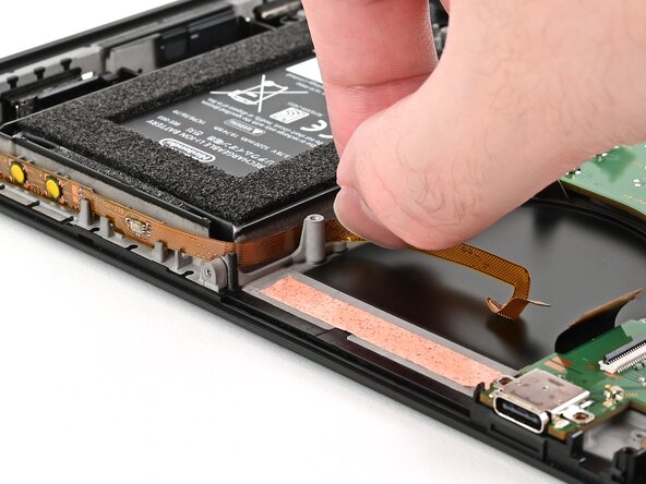

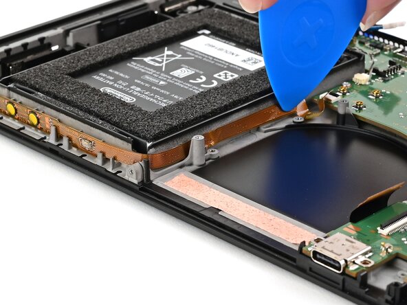

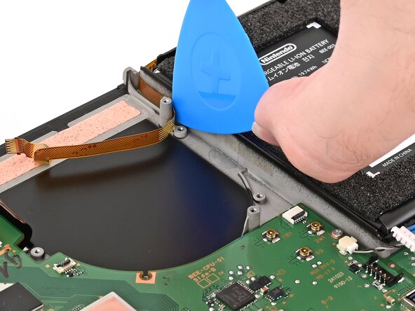

  37. Nintendo Switch 2 Button Board Replacement, Free the button board cable: crwdns2935265:037crwdnd2935265:01crwdnd2935265:02crwdne2935265:0 Nintendo Switch 2 Button Board Replacement, Free the button board cable: crwdns2935265:037crwdnd2935265:02crwdnd2935265:02crwdne2935265:0
    • Slide an opening pick underneath the button board cable to separate the adhesive securing it to the frame.

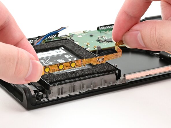

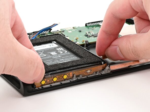

  38. Nintendo Switch 2 Button Board Replacement, Remove the button board: crwdns2935265:038crwdnd2935265:01crwdnd2935265:02crwdne2935265:0 Nintendo Switch 2 Button Board Replacement, Remove the button board: crwdns2935265:038crwdnd2935265:02crwdnd2935265:02crwdne2935265:0
    • Lift the button board to remove it.
  39. Nintendo Switch 2 Button Board Replacement, Disassembly complete: crwdns2935265:039crwdnd2935265:01crwdnd2935265:01crwdne2935265:0
    • Congratulations on completing disassembly! The remaining steps will show how to reassemble your console.

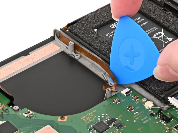

  41. Nintendo Switch 2 Button Board Replacement, Route the button board cable: crwdns2935265:041crwdnd2935265:01crwdnd2935265:03crwdne2935265:0 Nintendo Switch 2 Button Board Replacement, Route the button board cable: crwdns2935265:041crwdnd2935265:02crwdnd2935265:03crwdne2935265:0 Nintendo Switch 2 Button Board Replacement, Route the button board cable: crwdns2935265:041crwdnd2935265:03crwdnd2935265:03crwdne2935265:0
    • Route the button board cable alongside the battery well.
    • Slide an opening pick across the length of the cable to adhere it to the battery well.

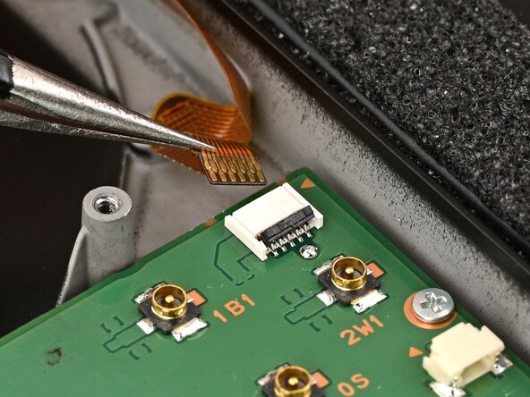

  42. Nintendo Switch 2 Button Board Replacement, Connect the button board: crwdns2935265:042crwdnd2935265:01crwdnd2935265:03crwdne2935265:0 Nintendo Switch 2 Button Board Replacement, Connect the button board: crwdns2935265:042crwdnd2935265:02crwdnd2935265:03crwdne2935265:0 Nintendo Switch 2 Button Board Replacement, Connect the button board: crwdns2935265:042crwdnd2935265:03crwdnd2935265:03crwdne2935265:0
    • Use tweezers or your fingers to insert the button board cable into its ZIF connector until it's fully seated.
    • If you're using tweezers, push on the cable's "wings" to ensure it's fully seated.
