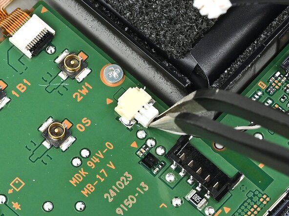

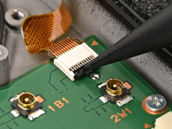

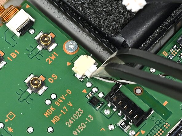

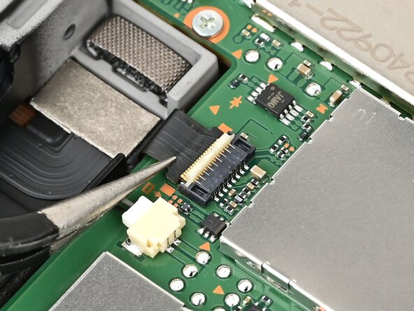

  23. Nintendo Switch 2 Board Replacement, Disconnect the lower antenna cable: crwdns2935265:023crwdnd2935265:01crwdnd2935265:03crwdne2935265:0 Nintendo Switch 2 Board Replacement, Disconnect the lower antenna cable: crwdns2935265:023crwdnd2935265:02crwdnd2935265:03crwdne2935265:0 Nintendo Switch 2 Board Replacement, Disconnect the lower antenna cable: crwdns2935265:023crwdnd2935265:03crwdnd2935265:03crwdne2935265:0
    • Insert an arm of angled tweezers under the metal neck of the white interconnect cable coaxial connector (located beneath the lower antenna) and lift straight up to disconnect it.
  24. Nintendo Switch 2 Board Replacement, Disconnect the remaining antenna cables: crwdns2935265:024crwdnd2935265:01crwdnd2935265:03crwdne2935265:0 Nintendo Switch 2 Board Replacement, Disconnect the remaining antenna cables: crwdns2935265:024crwdnd2935265:02crwdnd2935265:03crwdne2935265:0 Nintendo Switch 2 Board Replacement, Disconnect the remaining antenna cables: crwdns2935265:024crwdnd2935265:03crwdnd2935265:03crwdne2935265:0
    • Repeat this procedure to disconnect the three central coaxial connectors from the board.

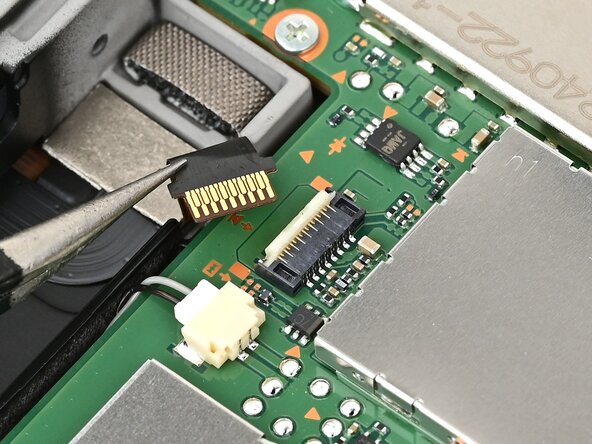

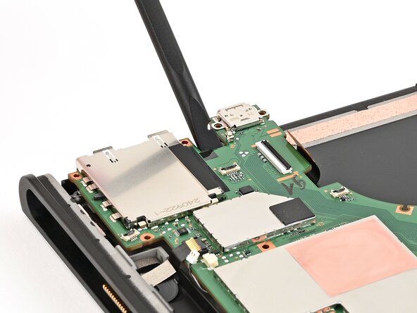

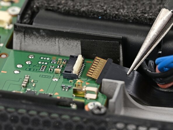

  25. Nintendo Switch 2 Board Replacement, Disconnect the MicroSD connector: crwdns2935265:025crwdnd2935265:01crwdnd2935265:03crwdne2935265:0 Nintendo Switch 2 Board Replacement, Disconnect the MicroSD connector: crwdns2935265:025crwdnd2935265:02crwdnd2935265:03crwdne2935265:0 Nintendo Switch 2 Board Replacement, Disconnect the MicroSD connector: crwdns2935265:025crwdnd2935265:03crwdnd2935265:03crwdne2935265:0
    • Use the flat end of a spudger to pry up and disconnect the MicroSD card reader press connector, located next to the bottom USB‑C port.

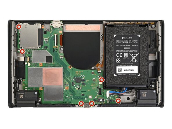

  26. Nintendo Switch 2 Board Replacement, Remove the shield plate screws: crwdns2935265:026crwdnd2935265:01crwdnd2935265:02crwdne2935265:0 Nintendo Switch 2 Board Replacement, Remove the shield plate screws: crwdns2935265:026crwdnd2935265:02crwdnd2935265:02crwdne2935265:0
    • Use a JIS 00 driver to remove the seven screws securing the shield plate:
    • Two 6.2 mm‑long silver screws
    • Five 4.4 mm‑long silver screws

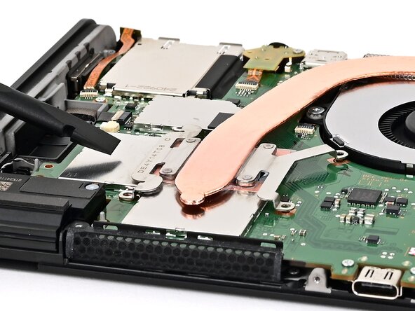

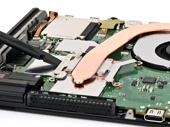

  27. Nintendo Switch 2 Board Replacement, Lift the shield plate: crwdns2935265:027crwdnd2935265:01crwdnd2935265:03crwdne2935265:0 Nintendo Switch 2 Board Replacement, Lift the shield plate: crwdns2935265:027crwdnd2935265:02crwdnd2935265:03crwdne2935265:0 Nintendo Switch 2 Board Replacement, Lift the shield plate: crwdns2935265:027crwdnd2935265:03crwdnd2935265:03crwdne2935265:0
    • Insert the flat end of a spudger between the shield plate and the processor's heat sink, next to the square (⛶) marking on the shield plate.
    • Twist the spudger to lift the shield plate and separate the thermal putty bonded to it. Keep lifting the shield plate until you don't feel resistance.
  28. Nintendo Switch 2 Board Replacement: crwdns2935265:028crwdnd2935265:01crwdnd2935265:03crwdne2935265:0 Nintendo Switch 2 Board Replacement: crwdns2935265:028crwdnd2935265:02crwdnd2935265:03crwdne2935265:0 Nintendo Switch 2 Board Replacement: crwdns2935265:028crwdnd2935265:03crwdnd2935265:03crwdne2935265:0
    • Lift the left edge of the shield plate to ensure it's fully separated from the thermal putty.
    • Gently set the shield plate back down.

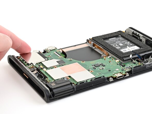

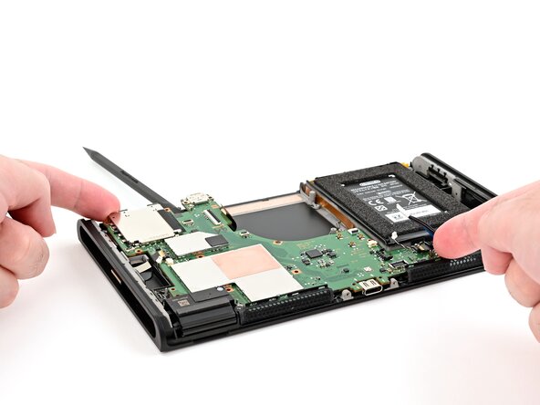

  32. Nintendo Switch 2 Board Replacement, Remove the shield plate: crwdns2935265:032crwdnd2935265:01crwdnd2935265:02crwdne2935265:0 Nintendo Switch 2 Board Replacement, Remove the shield plate: crwdns2935265:032crwdnd2935265:02crwdnd2935265:02crwdne2935265:0
    • Pick up and remove the shield plate.

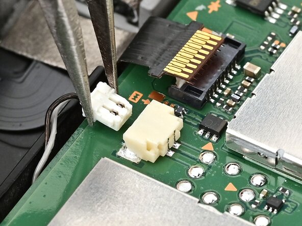

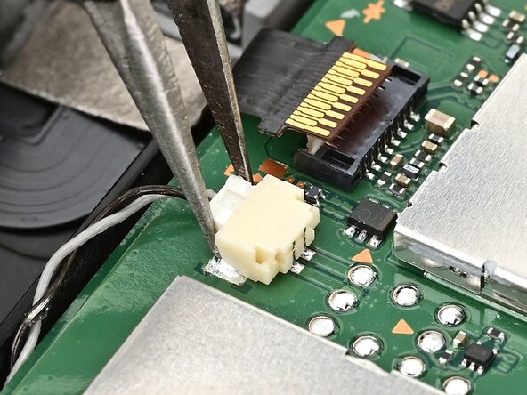

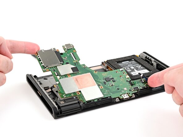

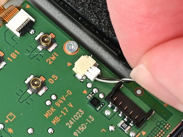

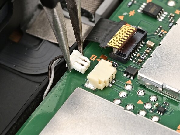

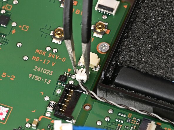

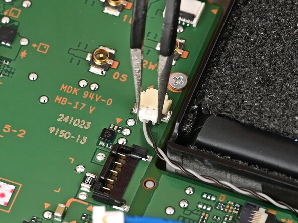

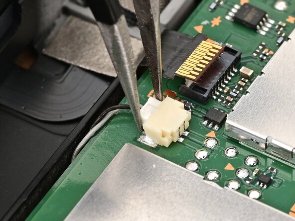

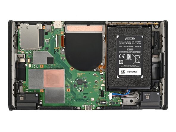

  33. Nintendo Switch 2 Board Replacement, Disconnect the battery: crwdns2935265:033crwdnd2935265:01crwdnd2935265:02crwdne2935265:0 Nintendo Switch 2 Board Replacement, Disconnect the battery: crwdns2935265:033crwdnd2935265:02crwdnd2935265:02crwdne2935265:0
    • Insert the flat end of a spudger underneath the flat-topped battery connector, located next to the battery, and pry up to disconnect it.

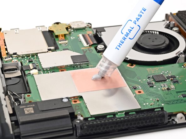

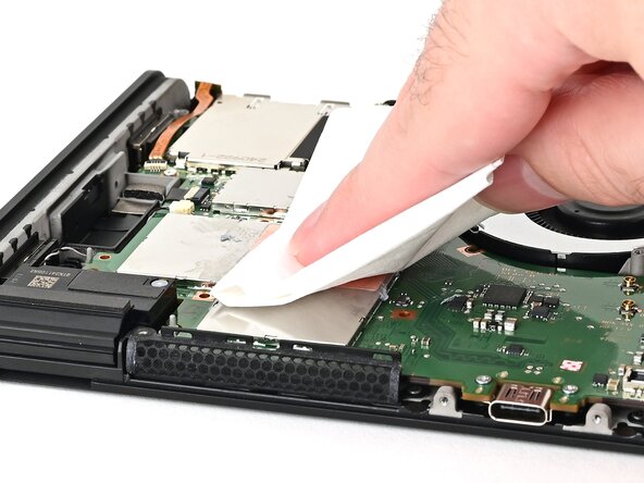

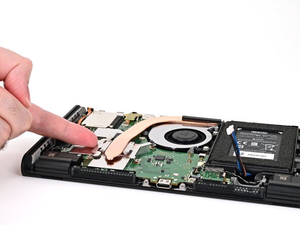

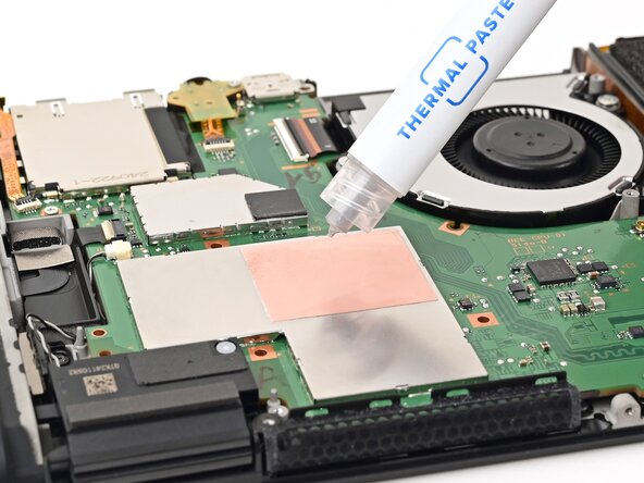

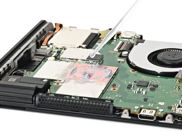

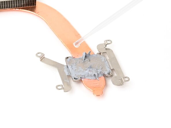

  34. Nintendo Switch 2 Board Replacement, Clean the heat pipe: crwdns2935265:034crwdnd2935265:01crwdnd2935265:03crwdne2935265:0 Nintendo Switch 2 Board Replacement, Clean the heat pipe: crwdns2935265:034crwdnd2935265:02crwdnd2935265:03crwdne2935265:0 Nintendo Switch 2 Board Replacement, Clean the heat pipe: crwdns2935265:034crwdnd2935265:03crwdnd2935265:03crwdne2935265:0
    Arctic Silver ArctiClean
    $9.99
    • If you don't have replacement thermal putty, use the flat end of a spudger to distribute the old putty evenly across the heat pipe, as thick as possible to ensure proper contact. Repeat this process on the shield plate, then skip this step.
    • Use the flat end of a spudger to scrape off the thermal putty on top of the copper heat pipe.
    • Apply high-concentration (90% or higher) isopropyl alcohol or thermal material remover to a cotton swab or lint-free cloth and wipe away any remaining thermal putty on both the heat pipe and shield plate.
    • Don't use a paper towel or rag, as they may scratch the shield plate.

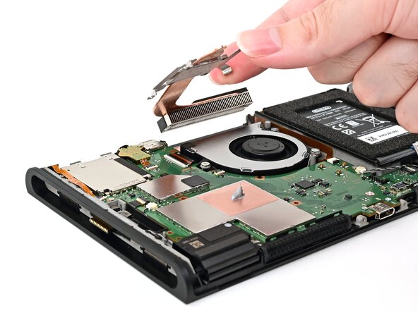

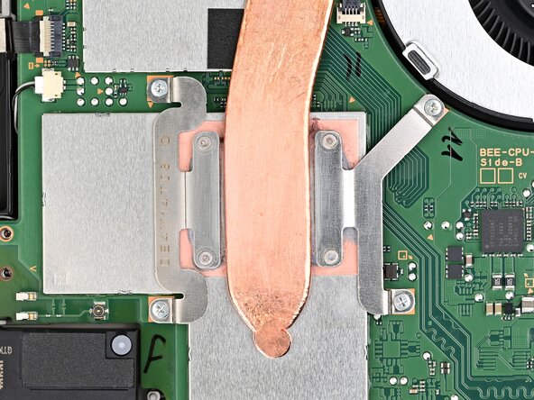

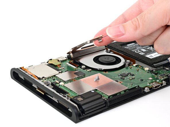

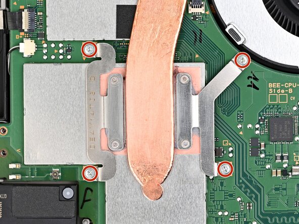

  35. Nintendo Switch 2 Board Replacement, Remove the heat sink screws: crwdns2935265:035crwdnd2935265:01crwdnd2935265:02crwdne2935265:0 Nintendo Switch 2 Board Replacement, Remove the heat sink screws: crwdns2935265:035crwdnd2935265:02crwdnd2935265:02crwdne2935265:0
    • Use a JIS 00 driver to remove the four 3.4 mm‑long silver screws securing the heat sink.

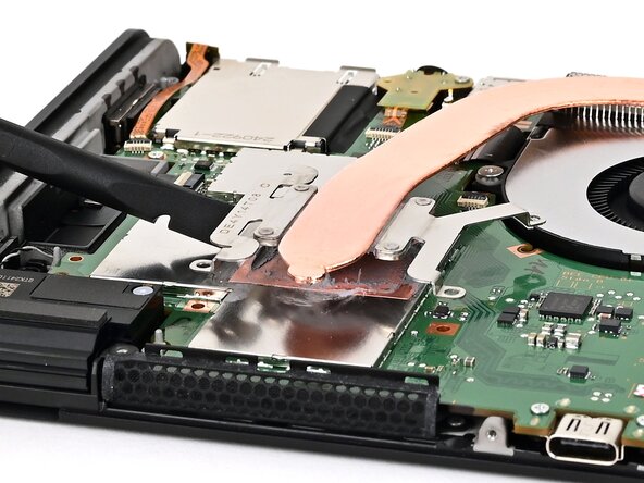

  36. Nintendo Switch 2 Board Replacement, Free the heat sink: crwdns2935265:036crwdnd2935265:01crwdnd2935265:03crwdne2935265:0 Nintendo Switch 2 Board Replacement, Free the heat sink: crwdns2935265:036crwdnd2935265:02crwdnd2935265:03crwdne2935265:0 Nintendo Switch 2 Board Replacement, Free the heat sink: crwdns2935265:036crwdnd2935265:03crwdnd2935265:03crwdne2935265:0
    • Insert the flat end of a spudger between the heat sink and the processor's heat spreader.
    • Twist the spudger to lift the heat sink and separate the thermal paste bonded to it.

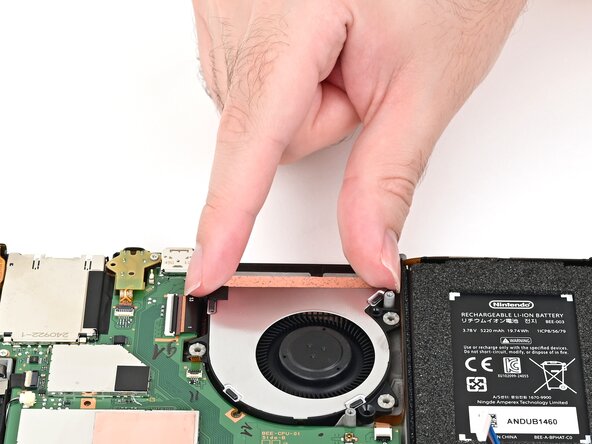

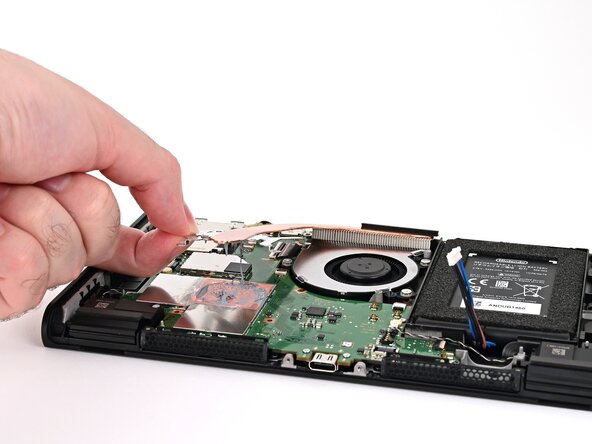

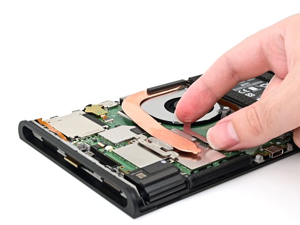

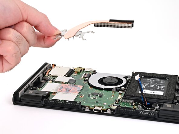

  37. Nintendo Switch 2 Board Replacement, Remove the heat sink: crwdns2935265:037crwdnd2935265:01crwdnd2935265:03crwdne2935265:0 Nintendo Switch 2 Board Replacement, Remove the heat sink: crwdns2935265:037crwdnd2935265:02crwdnd2935265:03crwdne2935265:0 Nintendo Switch 2 Board Replacement, Remove the heat sink: crwdns2935265:037crwdnd2935265:03crwdnd2935265:03crwdne2935265:0
    • Lift the heat sink slowly to avoid bending its thin copper heat pipe.
    • Slowly lift the heat sink from the front, until the aluminum fin stack at the back is detached from the adhesive beneath it.
    • Remove the heat sink.

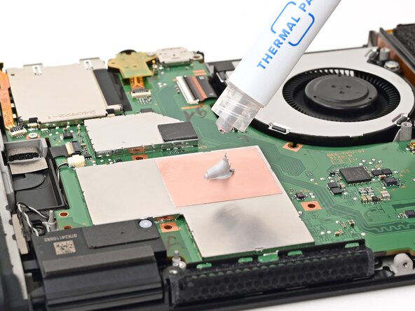

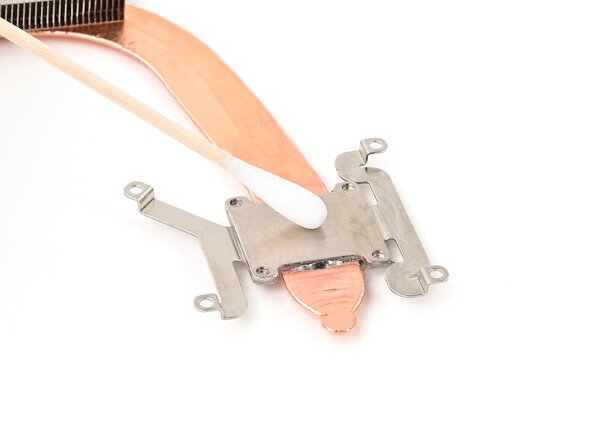

  38. Nintendo Switch 2 Board Replacement, Clean the thermal paste: crwdns2935265:038crwdnd2935265:01crwdnd2935265:03crwdne2935265:0 Nintendo Switch 2 Board Replacement, Clean the thermal paste: crwdns2935265:038crwdnd2935265:02crwdnd2935265:03crwdne2935265:0 Nintendo Switch 2 Board Replacement, Clean the thermal paste: crwdns2935265:038crwdnd2935265:03crwdnd2935265:03crwdne2935265:0
    $9.99
    • Use high-concentration (90% or higher) isopropyl alcohol or thermal material remover to soak the thermal paste on the processor's heat spreader for one minute.
    • Use a lint-free cloth or cotton swabs to wipe away the thermal paste.
    • Repeat this process until the processor's heat spreader is clean.
  39. Nintendo Switch 2 Board Replacement: crwdns2935265:039crwdnd2935265:01crwdnd2935265:02crwdne2935265:0 Nintendo Switch 2 Board Replacement: crwdns2935265:039crwdnd2935265:02crwdnd2935265:02crwdne2935265:0
    • If you're replacing your heat sink, skip this step.
    • Repeat this process to clean the thermal paste off the bottom of the heat sink.

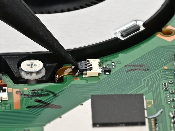

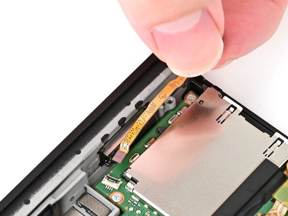

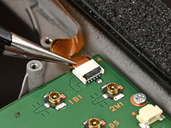

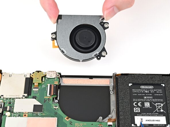

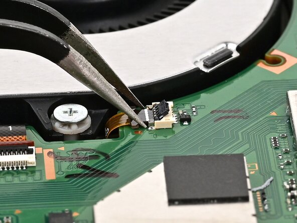

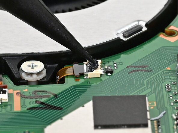

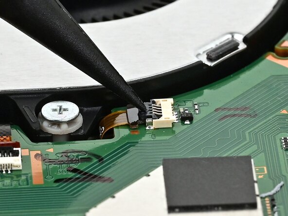

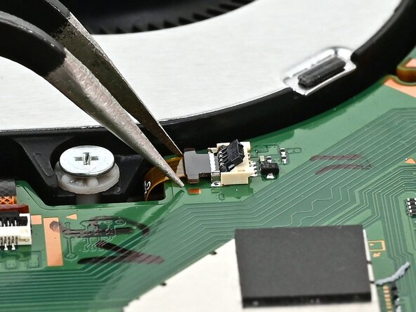

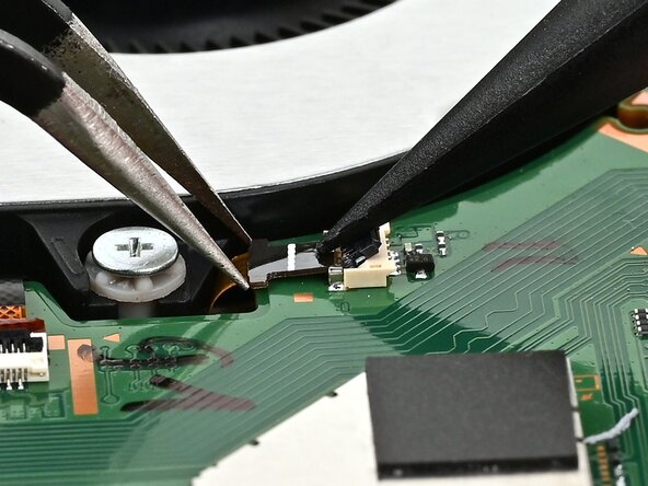

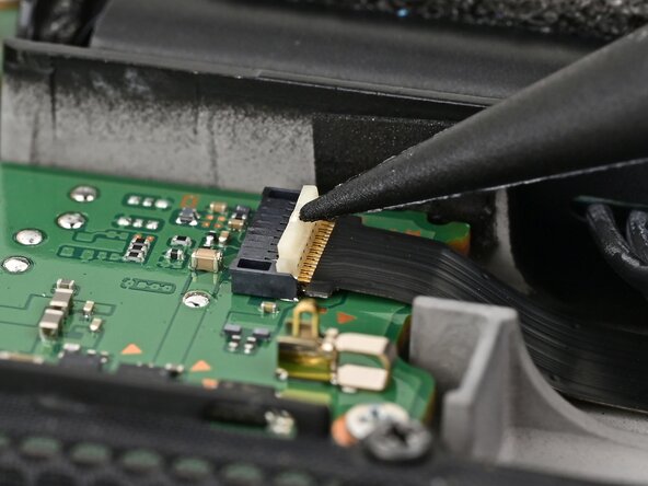

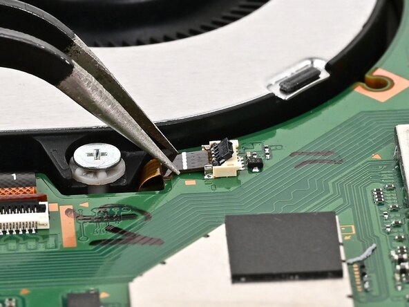

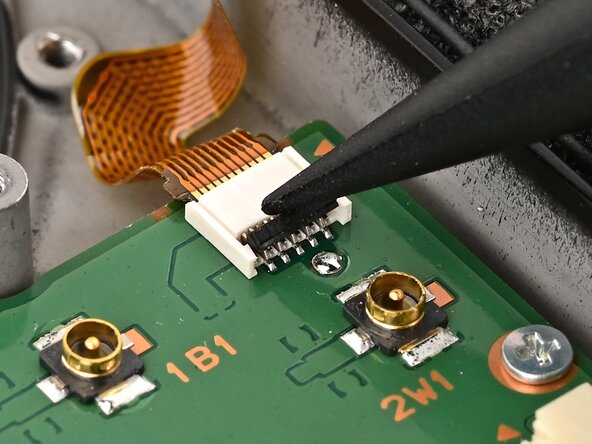

  40. Nintendo Switch 2 Board Replacement, Disconnect the fan: crwdns2935265:040crwdnd2935265:01crwdnd2935265:02crwdne2935265:0 Nintendo Switch 2 Board Replacement, Disconnect the fan: crwdns2935265:040crwdnd2935265:02crwdnd2935265:02crwdne2935265:0
    • Use the point of a spudger to flip up the locking flap on the fan cable ZIF connector, located next to the fan on the console's board.

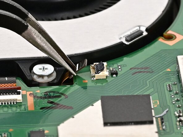

  41. Nintendo Switch 2 Board Replacement: crwdns2935265:041crwdnd2935265:01crwdnd2935265:03crwdne2935265:0 Nintendo Switch 2 Board Replacement: crwdns2935265:041crwdnd2935265:02crwdnd2935265:03crwdne2935265:0 Nintendo Switch 2 Board Replacement: crwdns2935265:041crwdnd2935265:03crwdnd2935265:03crwdne2935265:0
    • Use tweezers or your fingers to gently pull the cable out of its socket.
    • If you're using tweezers, pull the cable out by its "wings" instead of gripping the cable itself.

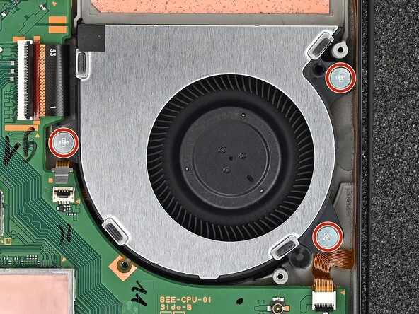

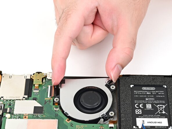

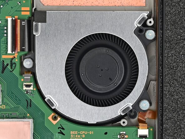

  42. Nintendo Switch 2 Board Replacement, Remove the fan screws: crwdns2935265:042crwdnd2935265:01crwdnd2935265:02crwdne2935265:0 Nintendo Switch 2 Board Replacement, Remove the fan screws: crwdns2935265:042crwdnd2935265:02crwdnd2935265:02crwdne2935265:0
    • Use a JIS 00 driver to remove the three 5.2 mm‑long silver screws securing the fan.
  43. Nintendo Switch 2 Board Replacement, Remove the fan: crwdns2935265:043crwdnd2935265:01crwdnd2935265:03crwdne2935265:0 Nintendo Switch 2 Board Replacement, Remove the fan: crwdns2935265:043crwdnd2935265:02crwdnd2935265:03crwdne2935265:0 Nintendo Switch 2 Board Replacement, Remove the fan: crwdns2935265:043crwdnd2935265:03crwdnd2935265:03crwdne2935265:0
    • Slide the fan out of its recess to free its cable, then pick it up to remove it.

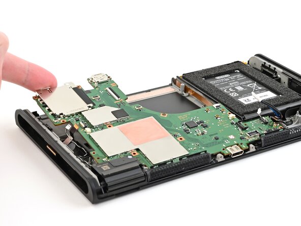

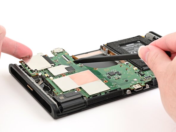

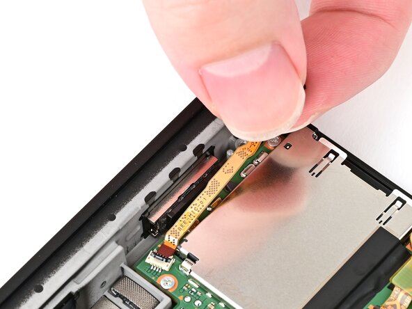

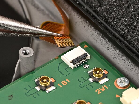

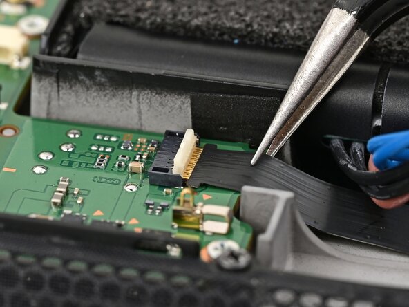

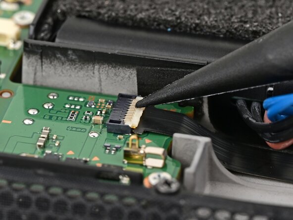

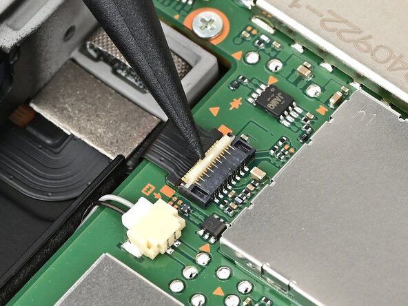

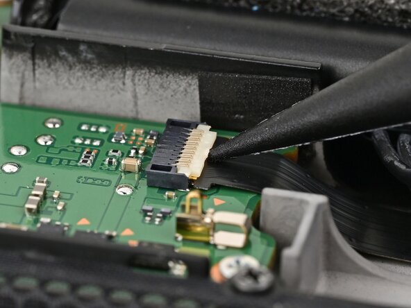

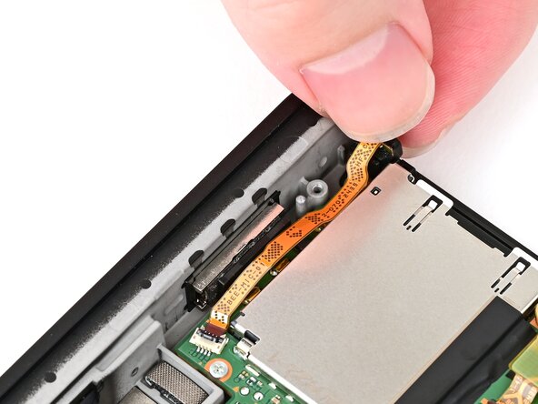

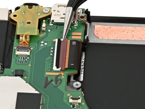

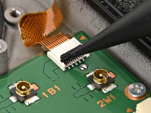

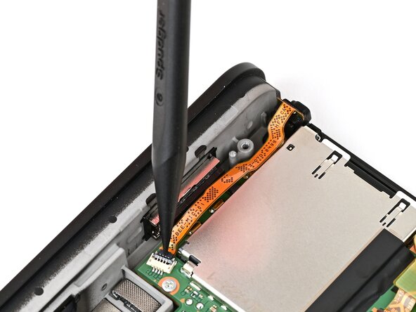

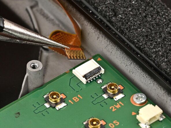

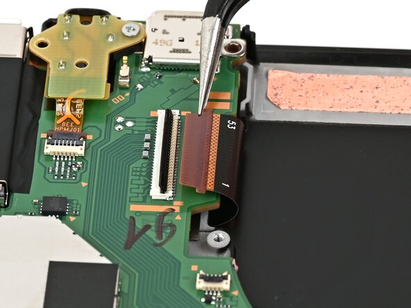

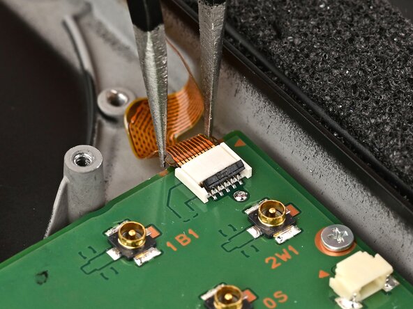

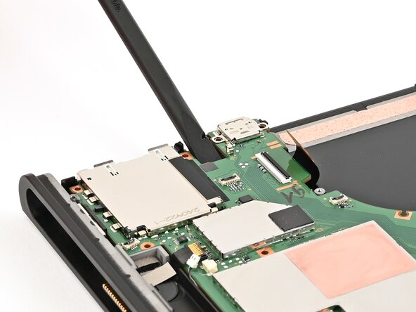

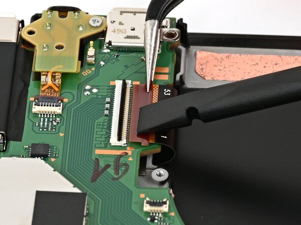

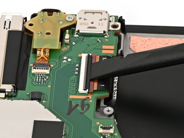

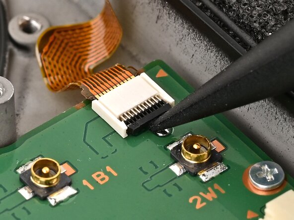

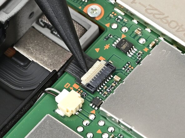

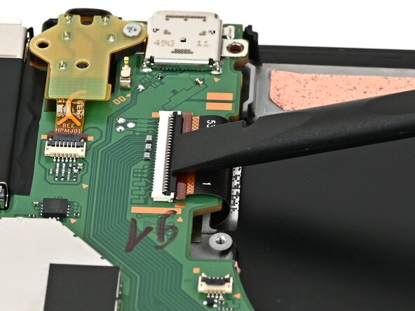

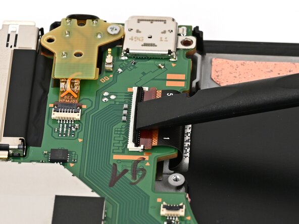

  44. Nintendo Switch 2 Board Replacement, Disconnect the screen: crwdns2935265:044crwdnd2935265:01crwdnd2935265:02crwdne2935265:0 Nintendo Switch 2 Board Replacement, Disconnect the screen: crwdns2935265:044crwdnd2935265:02crwdnd2935265:02crwdne2935265:0
    • Use your finger or the flat end of a spudger to flip up the locking flap on the screen cable ZIF connector.
  45. Nintendo Switch 2 Board Replacement: crwdns2935265:045crwdnd2935265:01crwdnd2935265:02crwdne2935265:0 Nintendo Switch 2 Board Replacement: crwdns2935265:045crwdnd2935265:02crwdnd2935265:02crwdne2935265:0
    • Use tweezers or your fingers to gently pull the screen cable out of its connector.

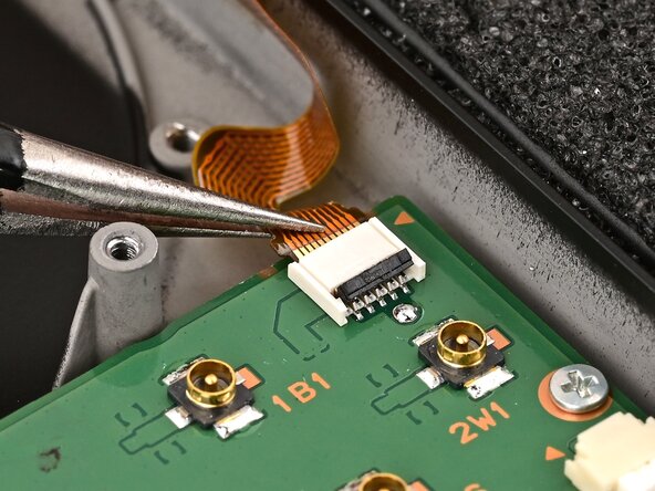

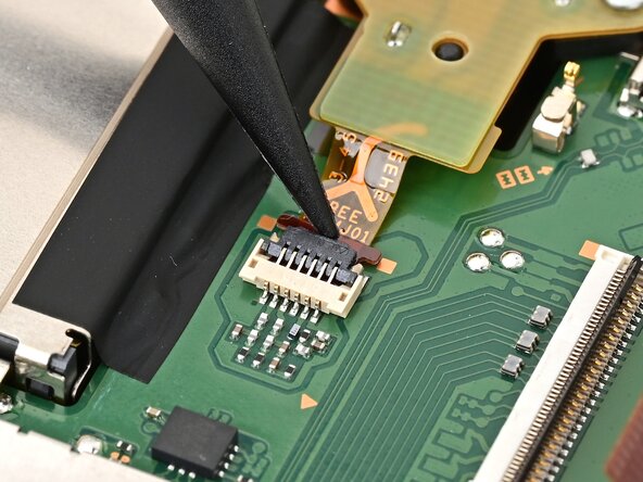

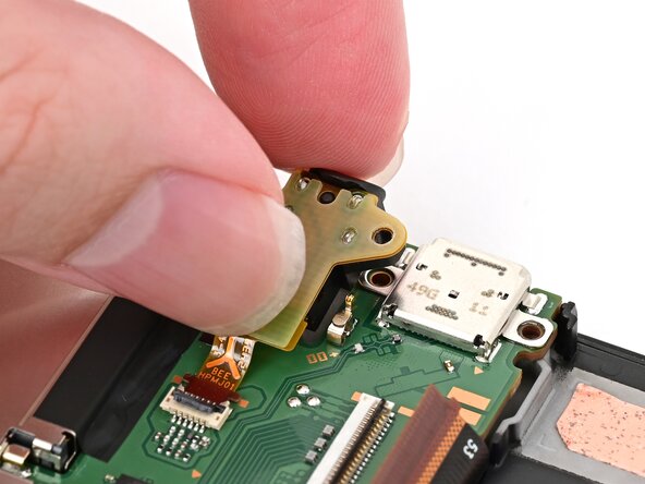

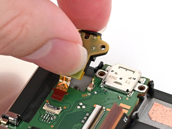

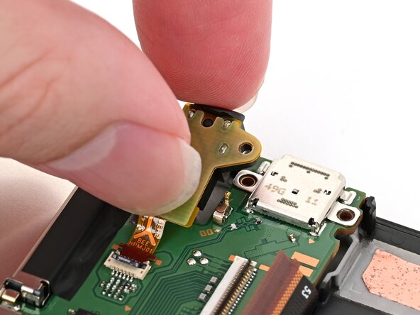

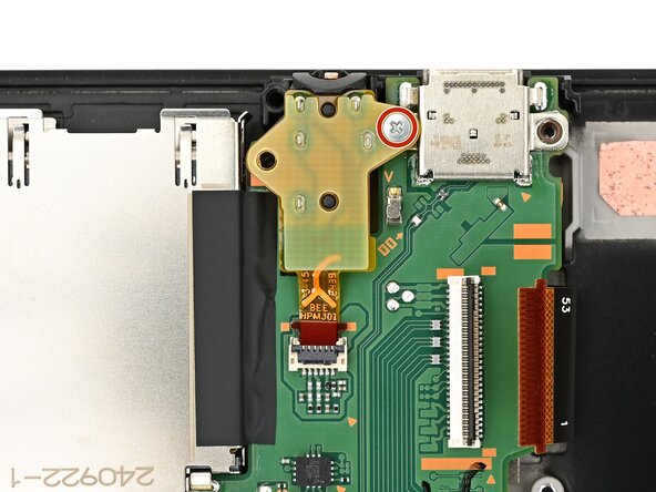

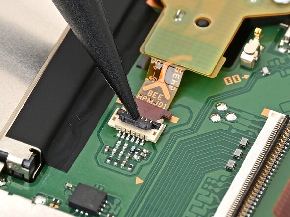

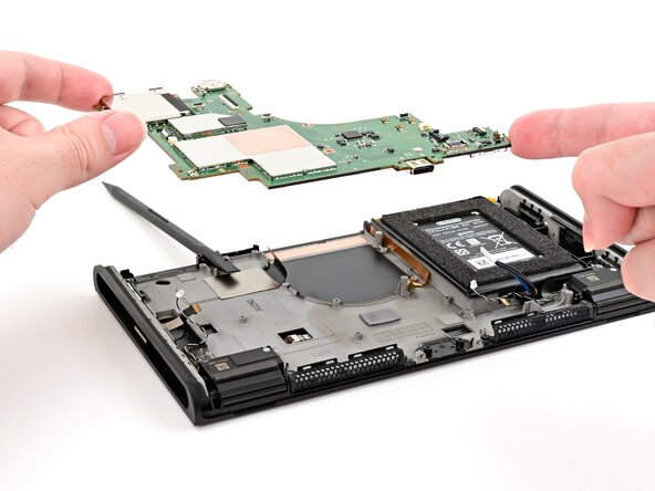

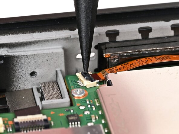

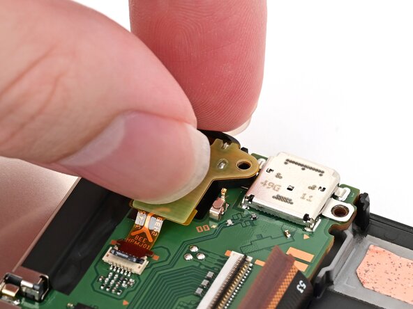

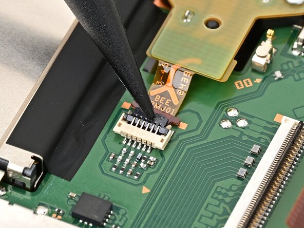

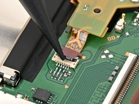

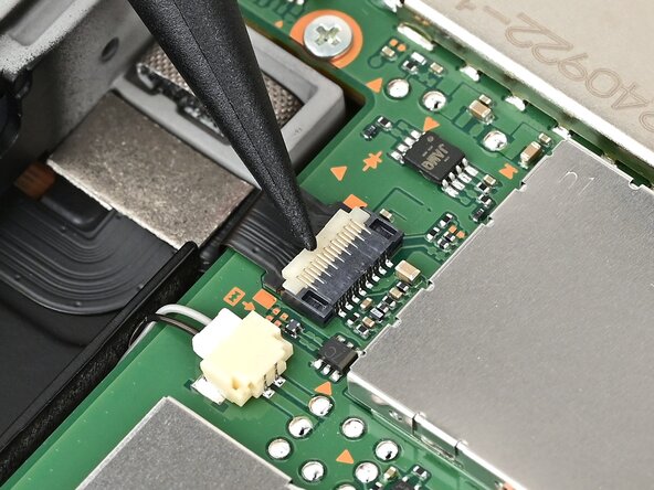

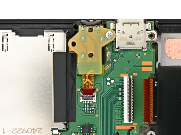

  46. Nintendo Switch 2 Board Replacement, Disconnect the headphone jack: crwdns2935265:046crwdnd2935265:01crwdnd2935265:02crwdne2935265:0 Nintendo Switch 2 Board Replacement, Disconnect the headphone jack: crwdns2935265:046crwdnd2935265:02crwdnd2935265:02crwdne2935265:0
    • Use the point of a spudger to flip up the locking flap on the headphone jack ZIF connector, located on the top edge of the console's board.

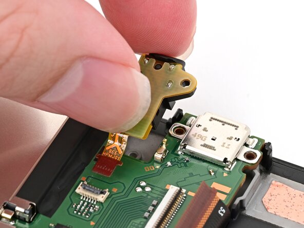

  47. Nintendo Switch 2 Board Replacement, Remove the headphone jack: crwdns2935265:047crwdnd2935265:01crwdnd2935265:02crwdne2935265:0 Nintendo Switch 2 Board Replacement, Remove the headphone jack: crwdns2935265:047crwdnd2935265:02crwdnd2935265:02crwdne2935265:0
    • Use a JIS 00 driver to remove the 6.2 mm‑long silver screw securing the headphone jack.

    • Pick up the headphone jack assembly and pull its cable straight out of its connector to remove it.
  49. Nintendo Switch 2 Board Replacement, Remove the microphone: crwdns2935265:049crwdnd2935265:01crwdnd2935265:03crwdne2935265:0 Nintendo Switch 2 Board Replacement, Remove the microphone: crwdns2935265:049crwdnd2935265:02crwdnd2935265:03crwdne2935265:0 Nintendo Switch 2 Board Replacement, Remove the microphone: crwdns2935265:049crwdnd2935265:03crwdnd2935265:03crwdne2935265:0
    • Follow the same procedure to disconnect and remove the microphone.
  50. Nintendo Switch 2 Board Replacement, Disconnect the right Joy-Con 2 connector: crwdns2935265:050crwdnd2935265:01crwdnd2935265:02crwdne2935265:0 Nintendo Switch 2 Board Replacement, Disconnect the right Joy-Con 2 connector: crwdns2935265:050crwdnd2935265:02crwdnd2935265:02crwdne2935265:0
    • Use the point of a spudger to flip up the locking flap on the right Joy‑Con 2 connector cable ZIF connector, located on the edge of the console's board.
  51. Nintendo Switch 2 Board Replacement: crwdns2935265:051crwdnd2935265:01crwdnd2935265:02crwdne2935265:0 Nintendo Switch 2 Board Replacement: crwdns2935265:051crwdnd2935265:02crwdnd2935265:02crwdne2935265:0
    • Use tweezers or your fingers to gently pull the cable out of its connector.
  52. Nintendo Switch 2 Board Replacement, Disconnect the right speaker: crwdns2935265:052crwdnd2935265:01crwdnd2935265:02crwdne2935265:0 Nintendo Switch 2 Board Replacement, Disconnect the right speaker: crwdns2935265:052crwdnd2935265:02crwdnd2935265:02crwdne2935265:0
    • Use tweezers or your fingers to firmly grip the right speaker cable's white JST connector and pull straight away from its socket to disconnect it.
  53. Nintendo Switch 2 Board Replacement, Disconnect the button board: crwdns2935265:053crwdnd2935265:01crwdnd2935265:02crwdne2935265:0 Nintendo Switch 2 Board Replacement, Disconnect the button board: crwdns2935265:053crwdnd2935265:02crwdnd2935265:02crwdne2935265:0
    • Use the point of a spudger to flip up the locking flap on the button cable ZIF connector, located next to the battery.
  54. Nintendo Switch 2 Board Replacement: crwdns2935265:054crwdnd2935265:01crwdnd2935265:02crwdne2935265:0 Nintendo Switch 2 Board Replacement: crwdns2935265:054crwdnd2935265:02crwdnd2935265:02crwdne2935265:0
    • Use tweezers or your fingers to gently pull the button board cable out of its connector.
  55. Nintendo Switch 2 Board Replacement, Disconnect the left speaker: crwdns2935265:055crwdnd2935265:01crwdnd2935265:02crwdne2935265:0 Nintendo Switch 2 Board Replacement, Disconnect the left speaker: crwdns2935265:055crwdnd2935265:02crwdnd2935265:02crwdne2935265:0
    • Use tweezers or your fingers to firmly grip the left speaker cable's white JST connector and pull straight away from its socket to disconnect it.
  56. Nintendo Switch 2 Board Replacement, Disconnect the left Joy‑Con 2 connector: crwdns2935265:056crwdnd2935265:01crwdnd2935265:02crwdne2935265:0 Nintendo Switch 2 Board Replacement, Disconnect the left Joy‑Con 2 connector: crwdns2935265:056crwdnd2935265:02crwdnd2935265:02crwdne2935265:0
    • Use the point of a spudger to flip up the locking flap on the left Joy‑Con 2 connector cable ZIF connector, located next to the battery on the console's board.
  57. Nintendo Switch 2 Board Replacement: crwdns2935265:057crwdnd2935265:01crwdnd2935265:02crwdne2935265:0 Nintendo Switch 2 Board Replacement: crwdns2935265:057crwdnd2935265:02crwdnd2935265:02crwdne2935265:0
  58. Nintendo Switch 2 Board Replacement, Remove the board screws: crwdns2935265:058crwdnd2935265:01crwdnd2935265:02crwdne2935265:0 Nintendo Switch 2 Board Replacement, Remove the board screws: crwdns2935265:058crwdnd2935265:02crwdnd2935265:02crwdne2935265:0
    • Use a JIS 00 driver to remove the six 3.4 mm‑long silver screws securing the board.
  59. Nintendo Switch 2 Board Replacement, Lift the board: crwdns2935265:059crwdnd2935265:01crwdnd2935265:02crwdne2935265:0 Nintendo Switch 2 Board Replacement, Lift the board: crwdns2935265:059crwdnd2935265:02crwdnd2935265:02crwdne2935265:0
    • Use the flat end of a spudger to lift the board off the frame from the headphone jack cutout.
  60. Nintendo Switch 2 Board Replacement, Remove the board: crwdns2935265:060crwdnd2935265:01crwdnd2935265:03crwdne2935265:0 Nintendo Switch 2 Board Replacement, Remove the board: crwdns2935265:060crwdnd2935265:02crwdnd2935265:03crwdne2935265:0 Nintendo Switch 2 Board Replacement, Remove the board: crwdns2935265:060crwdnd2935265:03crwdnd2935265:03crwdne2935265:0
    • Lift the top edge of the board, then the bottom, to remove it.
  61. Nintendo Switch 2 Board Replacement, Disassembly complete: crwdns2935265:061crwdnd2935265:01crwdnd2935265:01crwdne2935265:0
    • Congratulations on completing disassembly! The remaining steps will show how to reassemble your console.

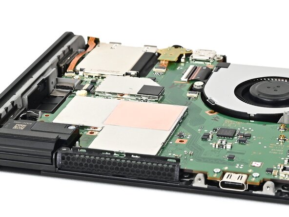

  62. Nintendo Switch 2 Board Replacement, Install the board: crwdns2935265:062crwdnd2935265:01crwdnd2935265:03crwdne2935265:0 Nintendo Switch 2 Board Replacement, Install the board: crwdns2935265:062crwdnd2935265:02crwdnd2935265:03crwdne2935265:0 Nintendo Switch 2 Board Replacement, Install the board: crwdns2935265:062crwdnd2935265:03crwdnd2935265:03crwdne2935265:0
    • Place the board into the console at an angle so it sits underneath the metal grilles on the bottom edge of the console.
    • Use your fingers or a spudger to bend all the ribbon cables away from the board so they aren't stuck beneath it.
    • Lower the board into the console.
  63. Nintendo Switch 2 Board Replacement, Install the board screws: crwdns2935265:063crwdnd2935265:01crwdnd2935265:02crwdne2935265:0 Nintendo Switch 2 Board Replacement, Install the board screws: crwdns2935265:063crwdnd2935265:02crwdnd2935265:02crwdne2935265:0
    • Use a JIS 00 driver to install the six 3.4 mm‑long silver screws securing the board.
  64. Nintendo Switch 2 Board Replacement, Connect the left Joy‑Con 2 cable: crwdns2935265:064crwdnd2935265:01crwdnd2935265:03crwdne2935265:0 Nintendo Switch 2 Board Replacement, Connect the left Joy‑Con 2 cable: crwdns2935265:064crwdnd2935265:02crwdnd2935265:03crwdne2935265:0 Nintendo Switch 2 Board Replacement, Connect the left Joy‑Con 2 cable: crwdns2935265:064crwdnd2935265:03crwdnd2935265:03crwdne2935265:0
    • Use tweezers to insert the left Joy‑Con 2 connector cable into its ZIF connector on the board until it's fully seated.
    • Use your finger or a spudger to flip the hinged locking flap down to secure the cable.
  65. Nintendo Switch 2 Board Replacement, Connect the left speaker: crwdns2935265:065crwdnd2935265:01crwdnd2935265:03crwdne2935265:0 Nintendo Switch 2 Board Replacement, Connect the left speaker: crwdns2935265:065crwdnd2935265:02crwdnd2935265:03crwdne2935265:0 Nintendo Switch 2 Board Replacement, Connect the left speaker: crwdns2935265:065crwdnd2935265:03crwdnd2935265:03crwdne2935265:0
    • Align the left speaker cable's white JST connector with its socket on the board.
    • Use tweezers or your fingers to fully seat the connector into its socket.
  66. Nintendo Switch 2 Board Replacement, Connect the button board: crwdns2935265:066crwdnd2935265:01crwdnd2935265:03crwdne2935265:0 Nintendo Switch 2 Board Replacement, Connect the button board: crwdns2935265:066crwdnd2935265:02crwdnd2935265:03crwdne2935265:0 Nintendo Switch 2 Board Replacement, Connect the button board: crwdns2935265:066crwdnd2935265:03crwdnd2935265:03crwdne2935265:0
    • Use tweezers or your fingers to insert the button board cable into its ZIF connector.
    • If you're using tweezers, push on the cable's "wings" to ensure it's fully seated.
  67. Nintendo Switch 2 Board Replacement: crwdns2935265:067crwdnd2935265:01crwdnd2935265:02crwdne2935265:0 Nintendo Switch 2 Board Replacement: crwdns2935265:067crwdnd2935265:02crwdnd2935265:02crwdne2935265:0
    • Flip the hinged locking flap down to secure the button board cable.
  68. Nintendo Switch 2 Board Replacement, Connect the right speaker: crwdns2935265:068crwdnd2935265:01crwdnd2935265:02crwdne2935265:0 Nintendo Switch 2 Board Replacement, Connect the right speaker: crwdns2935265:068crwdnd2935265:02crwdnd2935265:02crwdne2935265:0
    • Align the right speaker cable's JST connector with its socket on the board and push it in until it's fully seated.

  71. Nintendo Switch 2 Board Replacement, Install the headphone jack: crwdns2935265:071crwdnd2935265:01crwdnd2935265:03crwdne2935265:0 Nintendo Switch 2 Board Replacement, Install the headphone jack: crwdns2935265:071crwdnd2935265:02crwdnd2935265:03crwdne2935265:0 Nintendo Switch 2 Board Replacement, Install the headphone jack: crwdns2935265:071crwdnd2935265:03crwdnd2935265:03crwdne2935265:0
    • Guide the headphone jack cable into its connector, then set the assembly into its recess in the frame.
  72. Nintendo Switch 2 Board Replacement: crwdns2935265:072crwdnd2935265:01crwdnd2935265:02crwdne2935265:0 Nintendo Switch 2 Board Replacement: crwdns2935265:072crwdnd2935265:02crwdnd2935265:02crwdne2935265:0
    • Use a JIS 00 driver to install the 6.2 mm‑long silver screw securing the headphone jack.
  73. Nintendo Switch 2 Board Replacement: crwdns2935265:073crwdnd2935265:01crwdnd2935265:02crwdne2935265:0 Nintendo Switch 2 Board Replacement: crwdns2935265:073crwdnd2935265:02crwdnd2935265:02crwdne2935265:0
    • Flip the hinged locking flap down to secure the headphone jack cable.
  74. Nintendo Switch 2 Board Replacement, Connect the screen cable: crwdns2935265:074crwdnd2935265:01crwdnd2935265:03crwdne2935265:0 Nintendo Switch 2 Board Replacement, Connect the screen cable: crwdns2935265:074crwdnd2935265:02crwdnd2935265:03crwdne2935265:0 Nintendo Switch 2 Board Replacement, Connect the screen cable: crwdns2935265:074crwdnd2935265:03crwdnd2935265:03crwdne2935265:0
    • Use tweezers or your fingers to slide the screen cable into its ZIF connector until it's fully seated.
    • If you're using tweezers, you can use the flat end of a spudger to help guide the cable into its connector.
    • Flip the hinged locking flap down to secure the cable.
  75. Nintendo Switch 2 Board Replacement, Install the fan: crwdns2935265:075crwdnd2935265:01crwdnd2935265:03crwdne2935265:0 Nintendo Switch 2 Board Replacement, Install the fan: crwdns2935265:075crwdnd2935265:02crwdnd2935265:03crwdne2935265:0 Nintendo Switch 2 Board Replacement, Install the fan: crwdns2935265:075crwdnd2935265:03crwdnd2935265:03crwdne2935265:0
    • Slide the fan into its recess. Ensure its cable slides underneath the edge of the board.
    • Align the fan with its screw posts on the frame.
  76. Nintendo Switch 2 Board Replacement: crwdns2935265:076crwdnd2935265:01crwdnd2935265:02crwdne2935265:0 Nintendo Switch 2 Board Replacement: crwdns2935265:076crwdnd2935265:02crwdnd2935265:02crwdne2935265:0
    • Use a JIS 00 driver to install the three 5.2 mm‑long silver screws securing the fan.
  77. Nintendo Switch 2 Board Replacement, Connect the fan: crwdns2935265:077crwdnd2935265:01crwdnd2935265:03crwdne2935265:0 Nintendo Switch 2 Board Replacement, Connect the fan: crwdns2935265:077crwdnd2935265:02crwdnd2935265:03crwdne2935265:0 Nintendo Switch 2 Board Replacement, Connect the fan: crwdns2935265:077crwdnd2935265:03crwdnd2935265:03crwdne2935265:0
    • Use tweezers or your fingers to slide the fan cable into its ZIF connector until it's fully seated.
    • If you're using tweezers, you can use a spudger to help guide the cable into its connector.
  78. Nintendo Switch 2 Board Replacement, Install thermal paste: crwdns2935265:078crwdnd2935265:01crwdnd2935265:03crwdne2935265:0 Nintendo Switch 2 Board Replacement, Install thermal paste: crwdns2935265:078crwdnd2935265:02crwdnd2935265:03crwdne2935265:0 Nintendo Switch 2 Board Replacement, Install thermal paste: crwdns2935265:078crwdnd2935265:03crwdnd2935265:03crwdne2935265:0
    iFixit Thermal Paste
    $9.95
    • Apply a bead of new thermal paste to the center of the processor's copper heat spreader, roughly the size of a pea.
  79. Nintendo Switch 2 Board Replacement, Install the heat sink: crwdns2935265:079crwdnd2935265:01crwdnd2935265:03crwdne2935265:0 Nintendo Switch 2 Board Replacement, Install the heat sink: crwdns2935265:079crwdnd2935265:02crwdnd2935265:03crwdne2935265:0 Nintendo Switch 2 Board Replacement, Install the heat sink: crwdns2935265:079crwdnd2935265:03crwdnd2935265:03crwdne2935265:0
    • Set the heat sink's aluminum fins into its recess behind the fan, then lower the heat sink onto the board.
  80. Nintendo Switch 2 Board Replacement: crwdns2935265:080crwdnd2935265:01crwdnd2935265:02crwdne2935265:0 Nintendo Switch 2 Board Replacement: crwdns2935265:080crwdnd2935265:02crwdnd2935265:02crwdne2935265:0
    • Use a JIS 00 driver to partially install the four 3.4 mm‑long silver screws securing the heat sink.
    • Tighten the screws in an X pattern. For example: bottom left, top right, bottom right, then top left.

  82. Nintendo Switch 2 Board Replacement, Apply thermal putty: crwdns2935265:082crwdnd2935265:01crwdnd2935265:03crwdne2935265:0 Nintendo Switch 2 Board Replacement, Apply thermal putty: crwdns2935265:082crwdnd2935265:02crwdnd2935265:03crwdne2935265:0 Nintendo Switch 2 Board Replacement, Apply thermal putty: crwdns2935265:082crwdnd2935265:03crwdnd2935265:03crwdne2935265:0
    iFixit Thermal Putty
    $9.95
    • Apply a line of new thermal putty down the center of the heat pipe, roughly the thickness of a pea.
