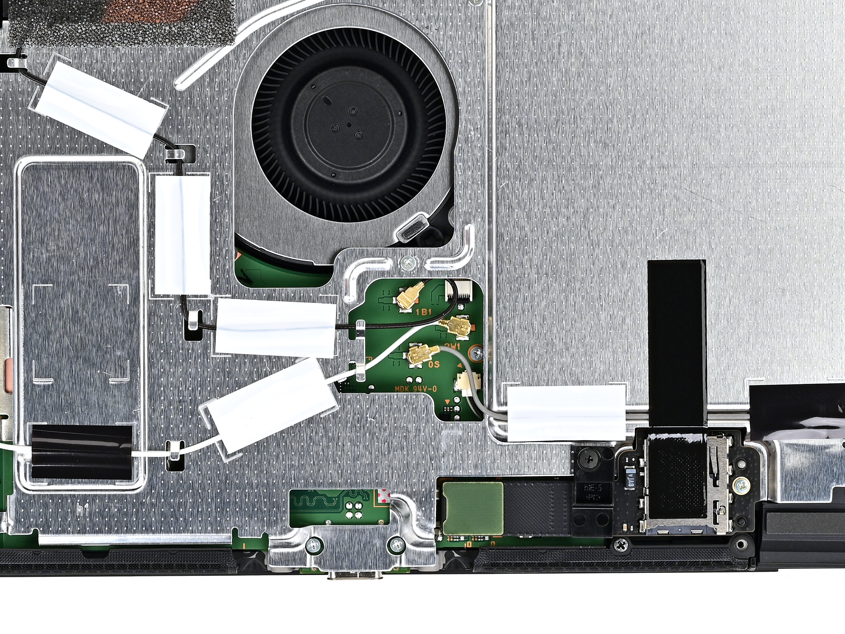

  23. Nintendo Switch 2 Battery Replacement, Disconnect the lower antenna cable: crwdns2935265:023crwdnd2935265:01crwdnd2935265:03crwdne2935265:0 Nintendo Switch 2 Battery Replacement, Disconnect the lower antenna cable: crwdns2935265:023crwdnd2935265:02crwdnd2935265:03crwdne2935265:0 Nintendo Switch 2 Battery Replacement, Disconnect the lower antenna cable: crwdns2935265:023crwdnd2935265:03crwdnd2935265:03crwdne2935265:0
    • Insert an arm of angled tweezers under the metal neck of the white interconnect cable coaxial connector (located beneath the lower antenna) and lift straight up to disconnect it.
  24. Nintendo Switch 2 Battery Replacement, Disconnect the remaining antenna cables: crwdns2935265:024crwdnd2935265:01crwdnd2935265:03crwdne2935265:0 Nintendo Switch 2 Battery Replacement, Disconnect the remaining antenna cables: crwdns2935265:024crwdnd2935265:02crwdnd2935265:03crwdne2935265:0 Nintendo Switch 2 Battery Replacement, Disconnect the remaining antenna cables: crwdns2935265:024crwdnd2935265:03crwdnd2935265:03crwdne2935265:0
    • Repeat this procedure to disconnect the three central coaxial connectors from the board.
  25. Nintendo Switch 2 Battery Replacement, Disconnect the MicroSD connector: crwdns2935265:025crwdnd2935265:01crwdnd2935265:03crwdne2935265:0 Nintendo Switch 2 Battery Replacement, Disconnect the MicroSD connector: crwdns2935265:025crwdnd2935265:02crwdnd2935265:03crwdne2935265:0 Nintendo Switch 2 Battery Replacement, Disconnect the MicroSD connector: crwdns2935265:025crwdnd2935265:03crwdnd2935265:03crwdne2935265:0
    • Use the flat end of a spudger to pry up and disconnect the MicroSD card reader press connector, located next to the bottom USB‑C port.

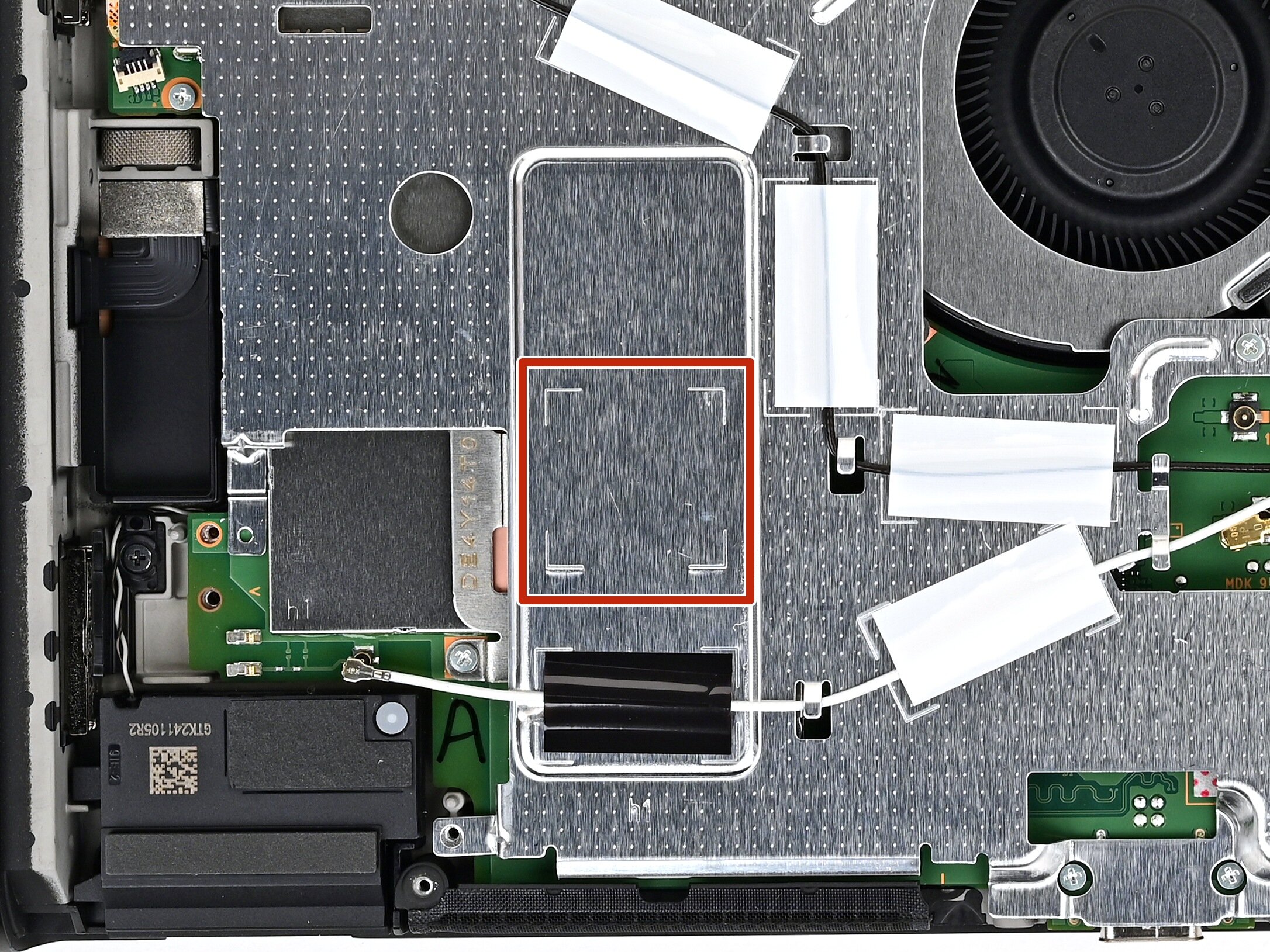

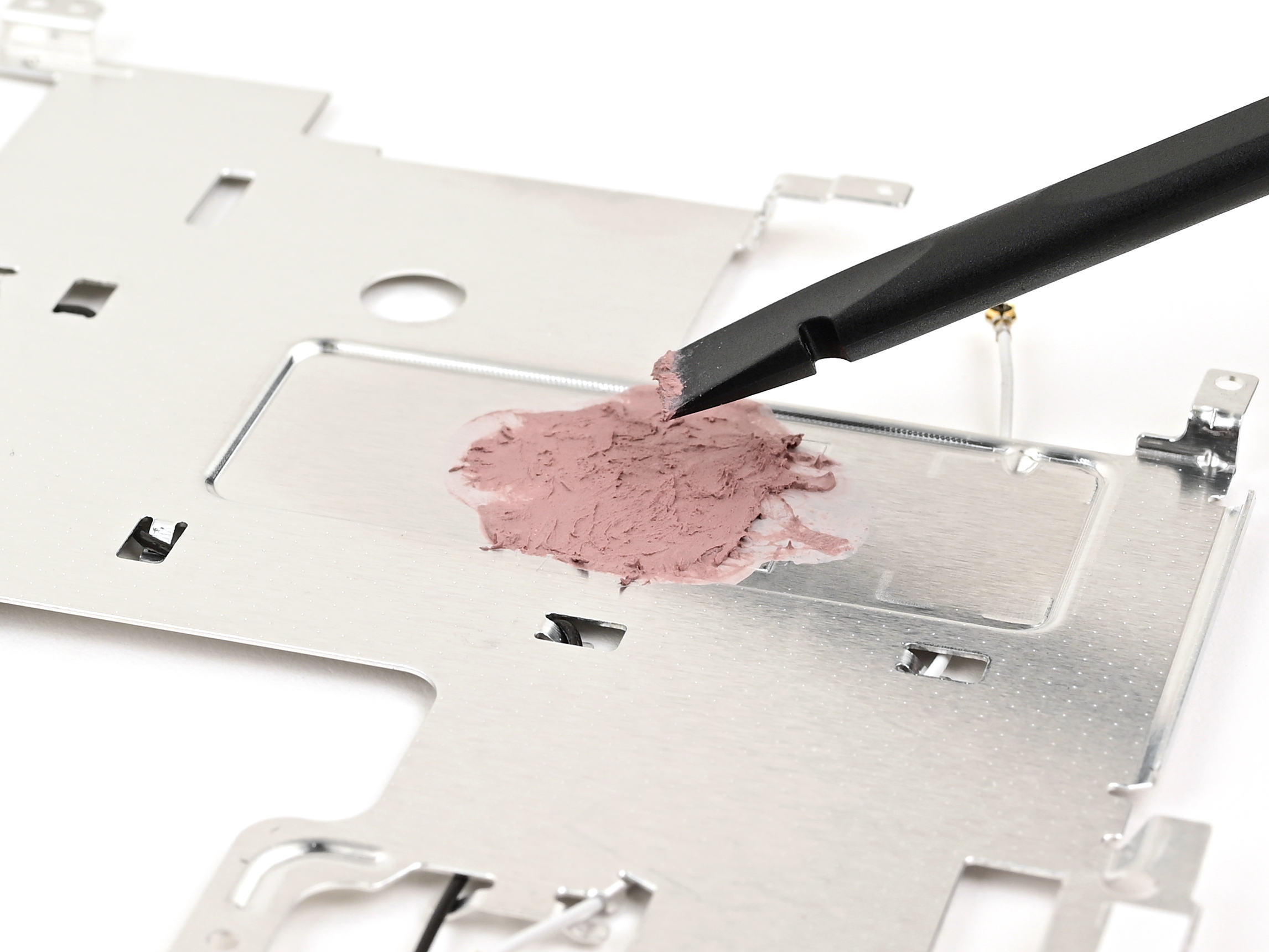

  27. Nintendo Switch 2 Battery Replacement, Lift the shield plate: crwdns2935265:027crwdnd2935265:01crwdnd2935265:03crwdne2935265:0 Nintendo Switch 2 Battery Replacement, Lift the shield plate: crwdns2935265:027crwdnd2935265:02crwdnd2935265:03crwdne2935265:0 Nintendo Switch 2 Battery Replacement, Lift the shield plate: crwdns2935265:027crwdnd2935265:03crwdnd2935265:03crwdne2935265:0
    • Insert the flat end of a spudger between the shield plate and the processor's heat sink, next to the square (⛶) marking on the shield plate.
    • Twist the spudger to lift the shield plate and separate the thermal putty bonded to it. Keep lifting the shield plate until you don't feel resistance.
  28. Nintendo Switch 2 Battery Replacement: crwdns2935265:028crwdnd2935265:01crwdnd2935265:03crwdne2935265:0 Nintendo Switch 2 Battery Replacement: crwdns2935265:028crwdnd2935265:02crwdnd2935265:03crwdne2935265:0 Nintendo Switch 2 Battery Replacement: crwdns2935265:028crwdnd2935265:03crwdnd2935265:03crwdne2935265:0
    • Lift the left edge of the shield plate to ensure it's fully separated from the thermal putty.
    • Gently set the shield plate back down.

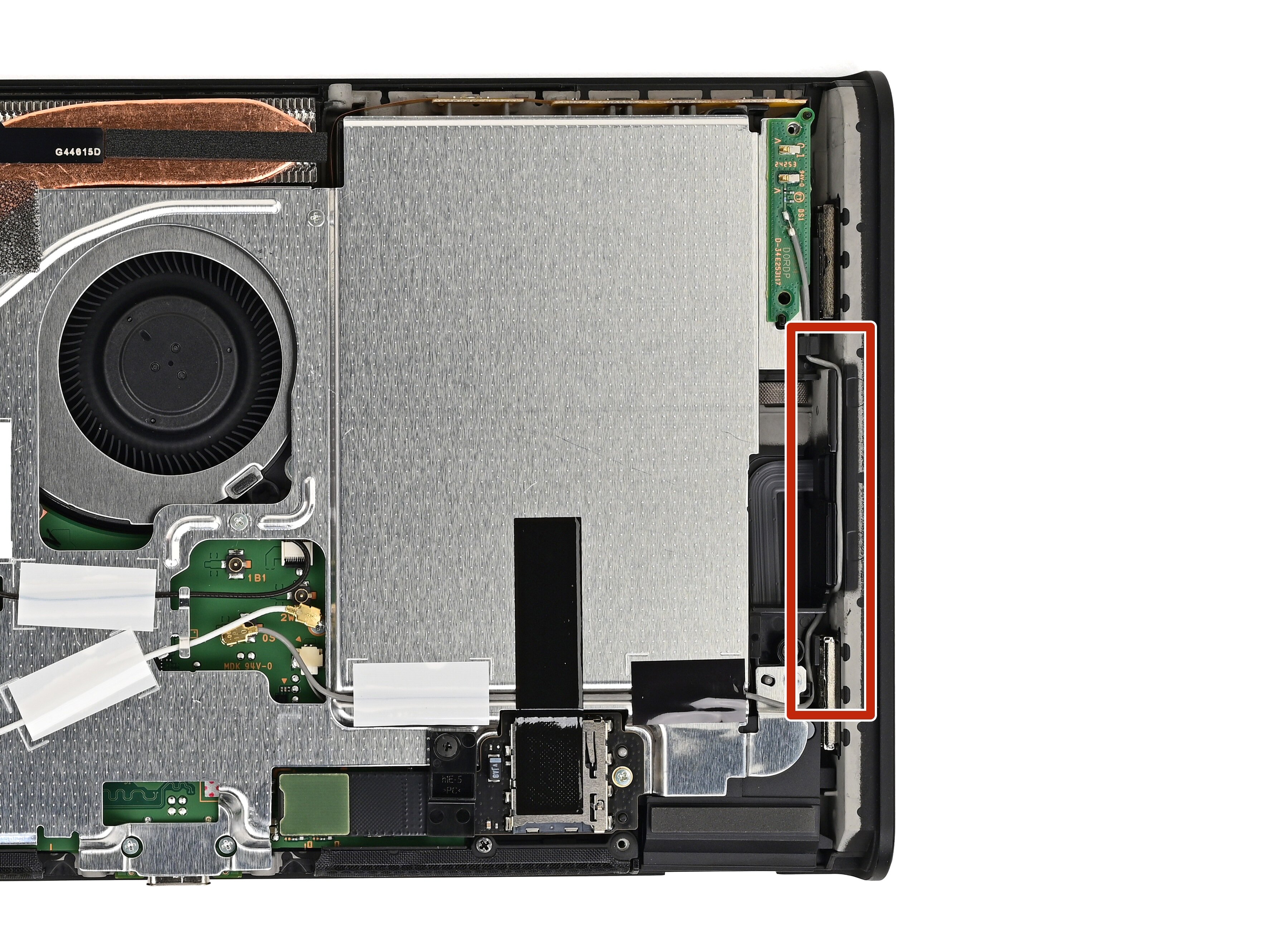

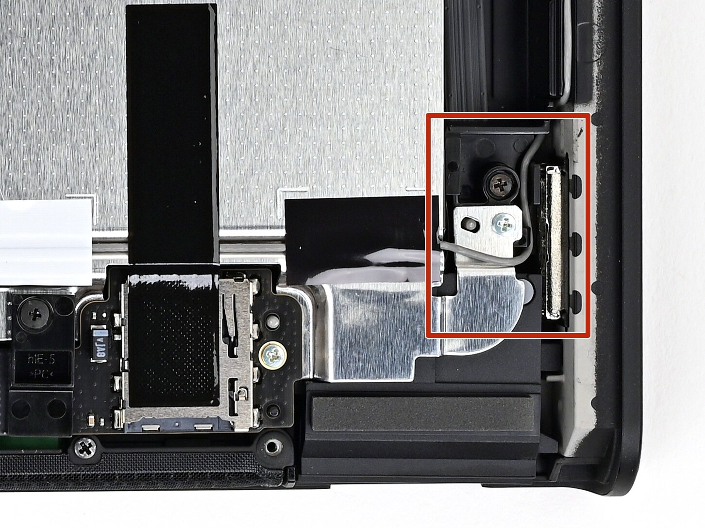

  29. Nintendo Switch 2 Battery Replacement, Unroute the gray antenna cable: crwdns2935265:029crwdnd2935265:01crwdnd2935265:03crwdne2935265:0 Nintendo Switch 2 Battery Replacement, Unroute the gray antenna cable: crwdns2935265:029crwdnd2935265:02crwdnd2935265:03crwdne2935265:0 Nintendo Switch 2 Battery Replacement, Unroute the gray antenna cable: crwdns2935265:029crwdnd2935265:03crwdnd2935265:03crwdne2935265:0
    • Insert one arm of angled tweezers underneath the gray antenna cable at the bottom-right corner of the console.
    • Lift the cable out of the black clip securing it to the frame.
  30. Nintendo Switch 2 Battery Replacement: crwdns2935265:030crwdnd2935265:01crwdnd2935265:03crwdne2935265:0 Nintendo Switch 2 Battery Replacement: crwdns2935265:030crwdnd2935265:02crwdnd2935265:03crwdne2935265:0 Nintendo Switch 2 Battery Replacement: crwdns2935265:030crwdnd2935265:03crwdnd2935265:03crwdne2935265:0
    • Unroute the gray antenna cable from its channel along the right edge of the console.

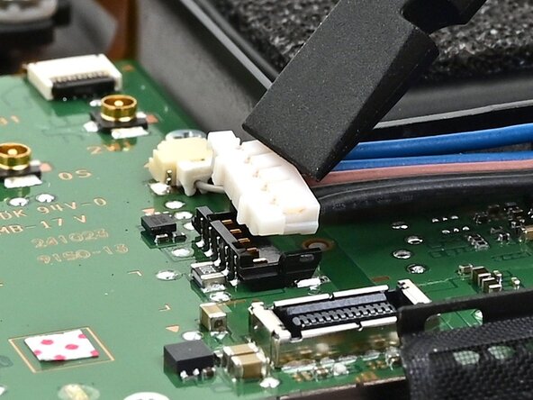

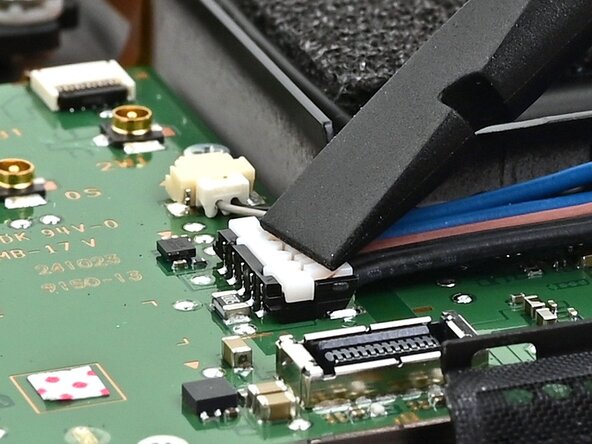

  33. Nintendo Switch 2 Battery Replacement, Disconnect the battery: crwdns2935265:033crwdnd2935265:01crwdnd2935265:02crwdne2935265:0 Nintendo Switch 2 Battery Replacement, Disconnect the battery: crwdns2935265:033crwdnd2935265:02crwdnd2935265:02crwdne2935265:0
    • Insert the flat end of a spudger underneath the flat-topped battery connector, located next to the battery, and pry up to disconnect it.

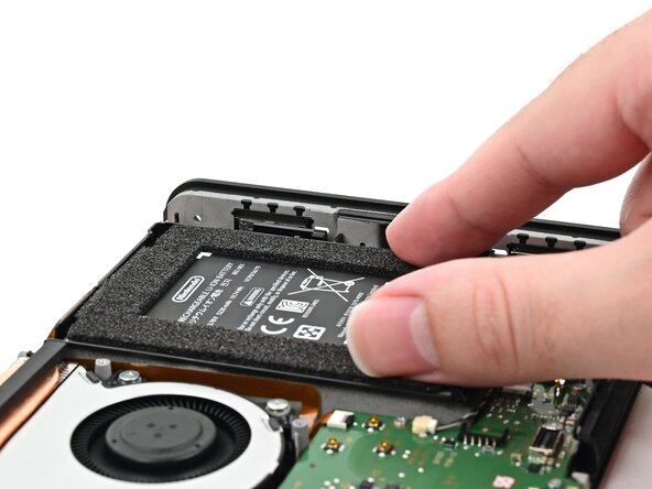

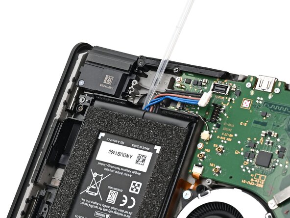

  34. Nintendo Switch 2 Battery Replacement, Weaken the adhesive: crwdns2935265:034crwdnd2935265:01crwdnd2935265:01crwdne2935265:0
    iFixit Adhesive Remover
    $19.99
    • Tilt the bottom edge of the console upward.
    • Apply a few drops of adhesive remover or high-concentration (90% or higher) isopropyl alcohol inside the battery well from its bottom cutout to weaken the adhesive.
    • Make sure not to puncture or scrape the bottom of the battery.
    • If you're using adhesive remover, follow these preparation steps first.
    • Hold the console upright for 1–2 minutes for the solvent to flow under the battery and weaken the adhesive.

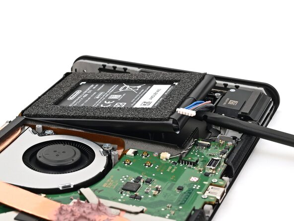

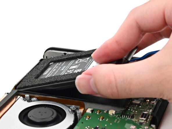

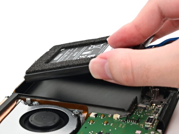

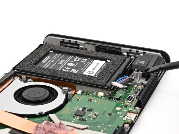

  35. Nintendo Switch 2 Battery Replacement, Lift the battery: crwdns2935265:035crwdnd2935265:01crwdnd2935265:03crwdne2935265:0 Nintendo Switch 2 Battery Replacement, Lift the battery: crwdns2935265:035crwdnd2935265:02crwdnd2935265:03crwdne2935265:0 Nintendo Switch 2 Battery Replacement, Lift the battery: crwdns2935265:035crwdnd2935265:03crwdnd2935265:03crwdne2935265:0
    • Don't bend the battery. If you see the battery bending, or if you're having difficulty prying, apply more solvent.
    • Insert the flat end of a spudger underneath the battery from the battery well cutout.
    • Slowly pry the battery up until its adhesive is fully separated from the frame. You can pry against the metal grille along the bottom edge of the console.

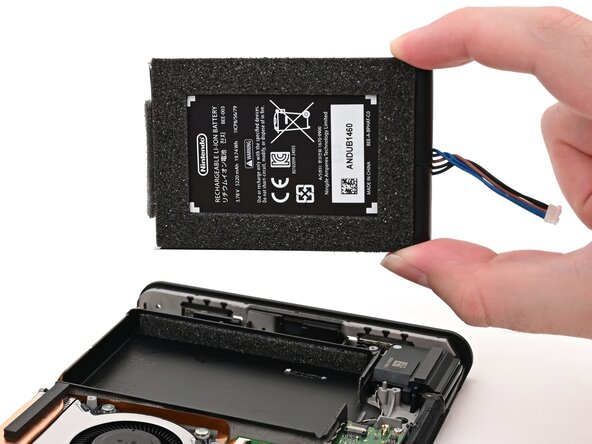

  36. Nintendo Switch 2 Battery Replacement, Remove the battery: crwdns2935265:036crwdnd2935265:01crwdnd2935265:01crwdne2935265:0
    • Remove the battery.

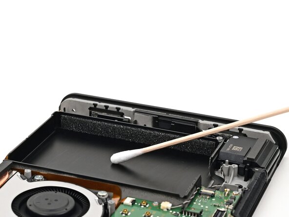

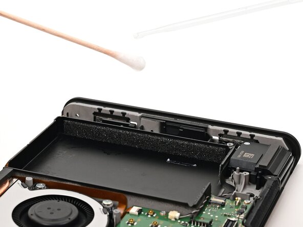

  38. Nintendo Switch 2 Battery Replacement, Clean the battery well: crwdns2935265:038crwdnd2935265:01crwdnd2935265:02crwdne2935265:0 Nintendo Switch 2 Battery Replacement, Clean the battery well: crwdns2935265:038crwdnd2935265:02crwdnd2935265:02crwdne2935265:0
    Cotton Swabs
    • Apply high-concentration (90% or higher) isopropyl alcohol to a cotton swab and wipe any adhesive residue from the battery well.
    • The foam on the inside walls of the well dissolves in isopropyl alcohol. Avoid touching the foam with your cotton swab so you don't damage it.

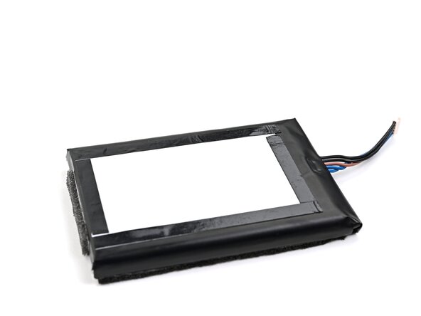

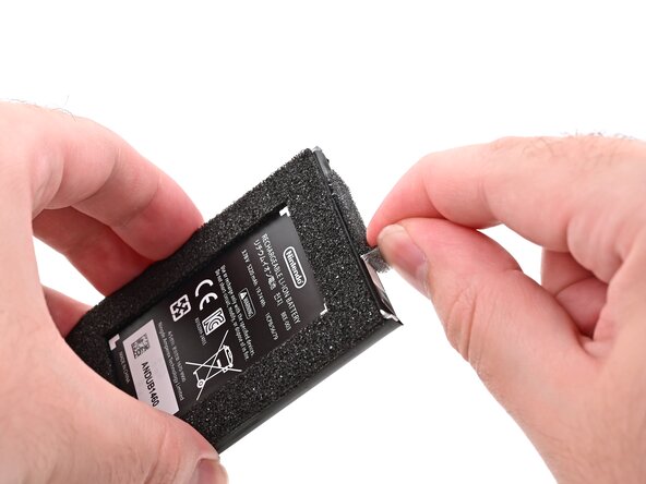

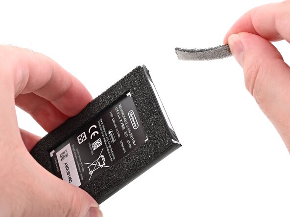

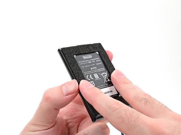

  39. Nintendo Switch 2 Battery Replacement, Transfer the foam: crwdns2935265:039crwdnd2935265:01crwdnd2935265:02crwdne2935265:0 Nintendo Switch 2 Battery Replacement, Transfer the foam: crwdns2935265:039crwdnd2935265:02crwdnd2935265:02crwdne2935265:0
    • If your new battery comes with foam pre-installed, skip the next two steps.
    • Use an opening pick or your fingernail to lift the foam strip off the top edge of the battery by its adhesive, not the foam itself.

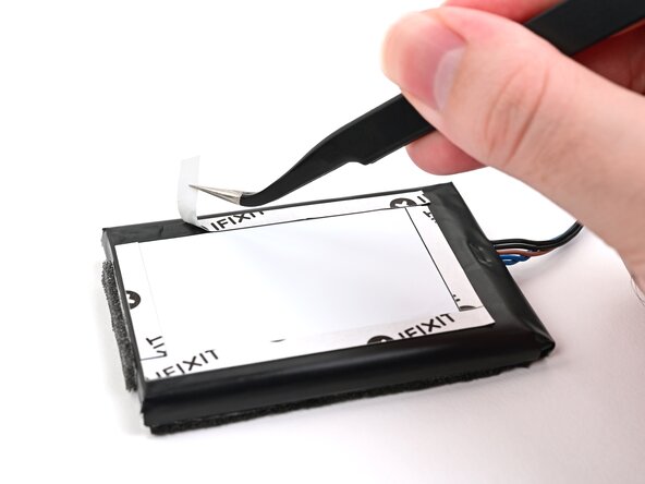

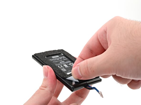

  40. Nintendo Switch 2 Battery Replacement: crwdns2935265:040crwdnd2935265:01crwdnd2935265:02crwdne2935265:0 Nintendo Switch 2 Battery Replacement: crwdns2935265:040crwdnd2935265:02crwdnd2935265:02crwdne2935265:0

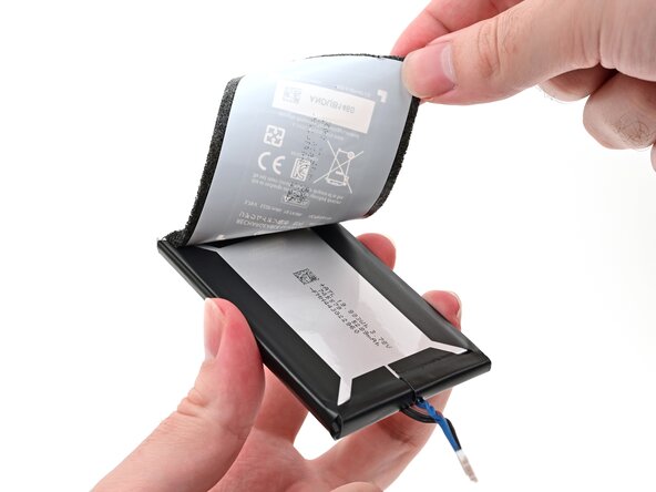

    • Peel the entire sticker, including the foam, from the front of the battery.
  41. Nintendo Switch 2 Battery Replacement: crwdns2935265:041crwdnd2935265:01crwdnd2935265:02crwdne2935265:0 Nintendo Switch 2 Battery Replacement: crwdns2935265:041crwdnd2935265:02crwdnd2935265:02crwdne2935265:0
    • Install the foam stickers in their original positions onto the new battery.

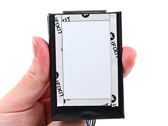

  42. Nintendo Switch 2 Battery Replacement, Prepare the adhesive: crwdns2935265:042crwdnd2935265:01crwdnd2935265:03crwdne2935265:0 Nintendo Switch 2 Battery Replacement, Prepare the adhesive: crwdns2935265:042crwdnd2935265:02crwdnd2935265:03crwdne2935265:0 Nintendo Switch 2 Battery Replacement, Prepare the adhesive: crwdns2935265:042crwdnd2935265:03crwdnd2935265:03crwdne2935265:0
    Tesa 61395 Tape
    $2.99
    • If your battery doesn't come with pre-installed adhesive, apply 5 mm‑wide strips of thin, double-sided tape to the flat area on the bottom of the battery. Don't install adhesive along the angled parts of the edges.
    • Remove all adhesive backings.

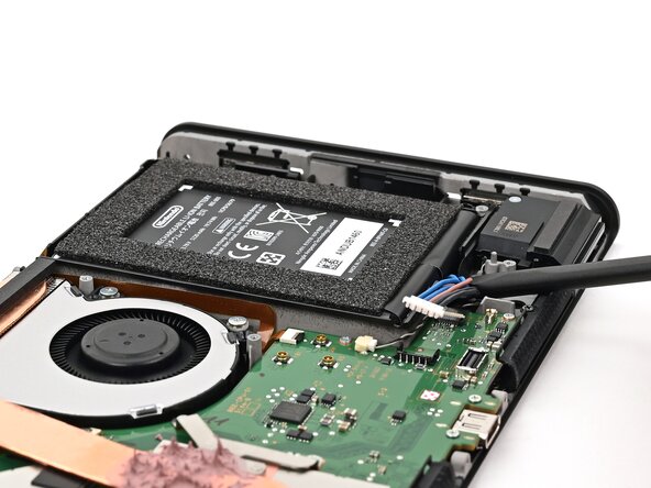

  44. Nintendo Switch 2 Battery Replacement, Connect the battery: crwdns2935265:044crwdnd2935265:01crwdnd2935265:02crwdne2935265:0 Nintendo Switch 2 Battery Replacement, Connect the battery: crwdns2935265:044crwdnd2935265:02crwdnd2935265:02crwdne2935265:0
    • Use your finger or the flat end of a spudger to press the flat-topped battery connector onto its socket until it's fully seated.

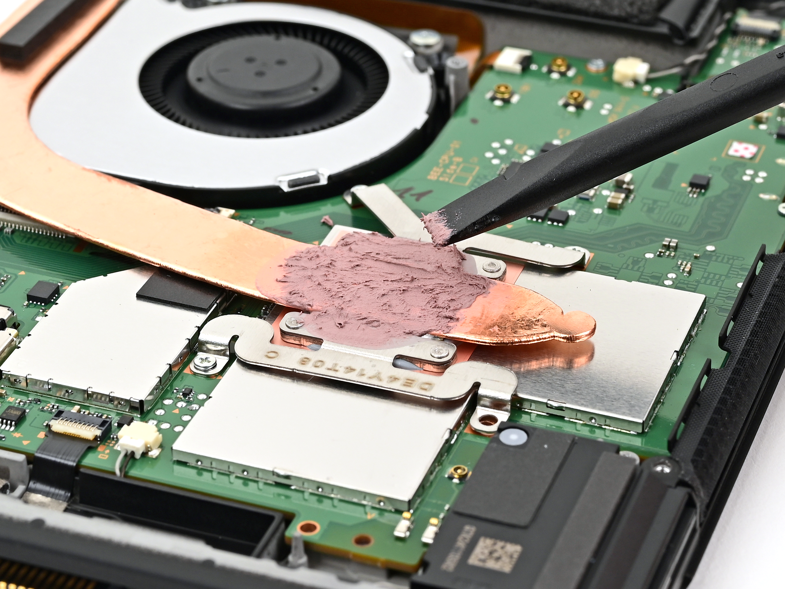

  45. Nintendo Switch 2 Battery Replacement, Clean the heat pipe: crwdns2935265:045crwdnd2935265:01crwdnd2935265:03crwdne2935265:0 Nintendo Switch 2 Battery Replacement, Clean the heat pipe: crwdns2935265:045crwdnd2935265:02crwdnd2935265:03crwdne2935265:0 Nintendo Switch 2 Battery Replacement, Clean the heat pipe: crwdns2935265:045crwdnd2935265:03crwdnd2935265:03crwdne2935265:0
    Arctic Silver ArctiClean
    $9.99
    • If you don't have replacement thermal putty, use the flat end of a spudger to distribute the old putty evenly across the heat pipe, as thick as possible to ensure proper contact. Repeat this process on the shield plate, then skip this step.
    • Use the flat end of a spudger to scrape off the thermal putty on top of the copper heat pipe.
    • Apply high-concentration (90% or higher) isopropyl alcohol or thermal material remover to a cotton swab or lint-free cloth and wipe away any remaining thermal putty on both the heat pipe and shield plate.

  46. Nintendo Switch 2 Battery Replacement, Apply thermal putty: crwdns2935265:046crwdnd2935265:01crwdnd2935265:03crwdne2935265:0 Nintendo Switch 2 Battery Replacement, Apply thermal putty: crwdns2935265:046crwdnd2935265:02crwdnd2935265:03crwdne2935265:0 Nintendo Switch 2 Battery Replacement, Apply thermal putty: crwdns2935265:046crwdnd2935265:03crwdnd2935265:03crwdne2935265:0
    iFixit Thermal Putty
    $9.95
    • Apply a line of new thermal putty down the center of the heat pipe, roughly the thickness of a pea.
  47. Nintendo Switch 2 Battery Replacement, Route the gray antenna cable: crwdns2935265:047crwdnd2935265:01crwdnd2935265:03crwdne2935265:0 Nintendo Switch 2 Battery Replacement, Route the gray antenna cable: crwdns2935265:047crwdnd2935265:02crwdnd2935265:03crwdne2935265:0 Nintendo Switch 2 Battery Replacement, Route the gray antenna cable: crwdns2935265:047crwdnd2935265:03crwdnd2935265:03crwdne2935265:0
    • Hold the top‑right corner of the shield plate above the top‑right corner of the console.
    • Route the gray antenna cable underneath the black hook near the top corner of the frame.
  48. Nintendo Switch 2 Battery Replacement, Lower the shield plate: crwdns2935265:048crwdnd2935265:01crwdnd2935265:02crwdne2935265:0 Nintendo Switch 2 Battery Replacement, Lower the shield plate: crwdns2935265:048crwdnd2935265:02crwdnd2935265:02crwdne2935265:0
    • Lower the shield plate into place and align it with its screw holes.
  49. Nintendo Switch 2 Battery Replacement, Finish routing the gray antenna cable: crwdns2935265:049crwdnd2935265:01crwdnd2935265:03crwdne2935265:0 Nintendo Switch 2 Battery Replacement, Finish routing the gray antenna cable: crwdns2935265:049crwdnd2935265:02crwdnd2935265:03crwdne2935265:0 Nintendo Switch 2 Battery Replacement, Finish routing the gray antenna cable: crwdns2935265:049crwdnd2935265:03crwdnd2935265:03crwdne2935265:0
    • Route the gray antenna cable down its channel on the right edge of the frame.
  50. Nintendo Switch 2 Battery Replacement: crwdns2935265:050crwdnd2935265:01crwdnd2935265:03crwdne2935265:0 Nintendo Switch 2 Battery Replacement: crwdns2935265:050crwdnd2935265:02crwdnd2935265:03crwdne2935265:0 Nintendo Switch 2 Battery Replacement: crwdns2935265:050crwdnd2935265:03crwdnd2935265:03crwdne2935265:0
    • Press the gray antenna cable into its groove at the bottom of its channel, and continue routing until it's secured to the clip at the bottom of the frame.
  51. Nintendo Switch 2 Battery Replacement, Install the shield plate screws: crwdns2935265:051crwdnd2935265:01crwdnd2935265:02crwdne2935265:0 Nintendo Switch 2 Battery Replacement, Install the shield plate screws: crwdns2935265:051crwdnd2935265:02crwdnd2935265:02crwdne2935265:0
    • Use a JIS 00 driver to install the seven screws securing the shield plate:
    • Two 6.2 mm‑long silver screws
    • Five 4.4 mm‑long silver screws
  52. Nintendo Switch 2 Battery Replacement, Connect the MicroSD connector: crwdns2935265:052crwdnd2935265:01crwdnd2935265:02crwdne2935265:0 Nintendo Switch 2 Battery Replacement, Connect the MicroSD connector: crwdns2935265:052crwdnd2935265:02crwdnd2935265:02crwdne2935265:0
    • Use your finger or the flat end of a spudger to press the MicroSD card reader press connector onto its socket on the board.
    • Don't try to force the connector into place. If you're having trouble, reposition it and try again.
  53. Nintendo Switch 2 Battery Replacement, Connect the antenna cables: crwdns2935265:053crwdnd2935265:01crwdnd2935265:03crwdne2935265:0 Nintendo Switch 2 Battery Replacement, Connect the antenna cables: crwdns2935265:053crwdnd2935265:02crwdnd2935265:03crwdne2935265:0 Nintendo Switch 2 Battery Replacement, Connect the antenna cables: crwdns2935265:053crwdnd2935265:03crwdnd2935265:03crwdne2935265:0
    • Use tweezers to hold the lower antenna coaxial connector in place over its socket and gently press down with your finger or a spudger—the connector should "snap" into place. If you're having trouble, reposition the head instead of using more force.
    • Repeat this process to connect the three central coaxial connectors to their respective sockets.
    • The black cable connects to the socket closest to the fan, the white to the middle, and the gray the furthest away.
