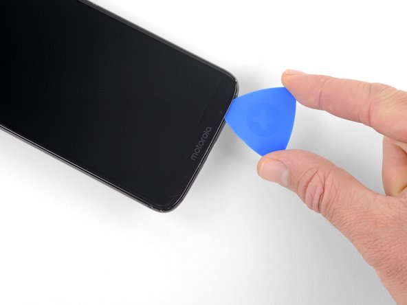

    2. Motorola Moto Z3 Screen Replacement, Display adhesive and cutting reference: crwdns2935265:02crwdnd2935265:01crwdnd2935265:02crwdne2935265:0 Motorola Moto Z3 Screen Replacement, Display adhesive and cutting reference: crwdns2935265:02crwdnd2935265:02crwdnd2935265:02crwdne2935265:0
      • In the following steps, you will separate the display assembly from the Moto Z3's chassis.
      • The first image shows the back of the display assembly after it has been removed from the phone. The second image shows the front of the phone to reference where the display cable lies.
      • If you plan to re-use the display assembly, pay particular attention to the side edges. When slicing through the glue in this area, you must be careful to insert your tool less than 2 mm, or your tool will come in contact with the LCD and damage it.
      • Take special care when cutting near the display cable. If you pry too deep or too forcefully, it is very easy to damage the cable. If you encounter extra resistance around this area, do not try to force the pick forward. Pull it out and reinsert it on the other side of the display cable before you continue cutting.
      • Playing cards are a safer, but much slower, prying tool. The soft paper cards are less likely to damage the LCD, which is good news if you plan to reuse it.

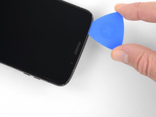

    3. Motorola Moto Z3 Screen Replacement, Cut the display adhesive: crwdns2935265:03crwdnd2935265:01crwdnd2935265:03crwdne2935265:0 Motorola Moto Z3 Screen Replacement, Cut the display adhesive: crwdns2935265:03crwdnd2935265:02crwdnd2935265:03crwdne2935265:0 Motorola Moto Z3 Screen Replacement, Cut the display adhesive: crwdns2935265:03crwdnd2935265:03crwdnd2935265:03crwdne2935265:0

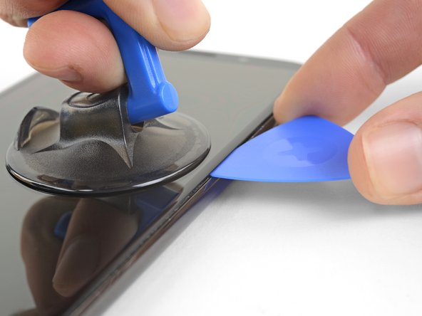

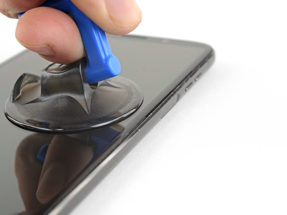

      • Apply a suction cup to the display, near the middle of the right edge.
      • Pull up on the suction cup with firm, constant pressure to create a slight gap between the display and rear case.
      • If the screen is cracked, the suction cup may not stick. Try lifting it with strong tape, or superglue the suction cup in place and allow it to cure so you can proceed.
      • This may require a significant amount of force, but you only need to open a very slight gap with the suction cup to insert your tool.
      • If you have trouble, apply more heat to further soften the adhesive, and try again. The adhesive cools quickly, so you may need to heat it repeatedly.

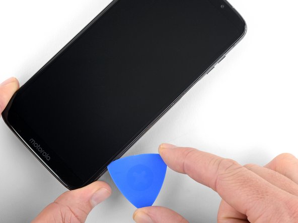

      • Insert an opening pick (or playing card) into the gap you opened behind the display.
      • Do not insert the tool more than 1.5 mm past the edge of the display.
    4. Motorola Moto Z3 Screen Replacement: crwdns2935265:04crwdnd2935265:01crwdnd2935265:03crwdne2935265:0 Motorola Moto Z3 Screen Replacement: crwdns2935265:04crwdnd2935265:02crwdnd2935265:03crwdne2935265:0 Motorola Moto Z3 Screen Replacement: crwdns2935265:04crwdnd2935265:03crwdnd2935265:03crwdne2935265:0

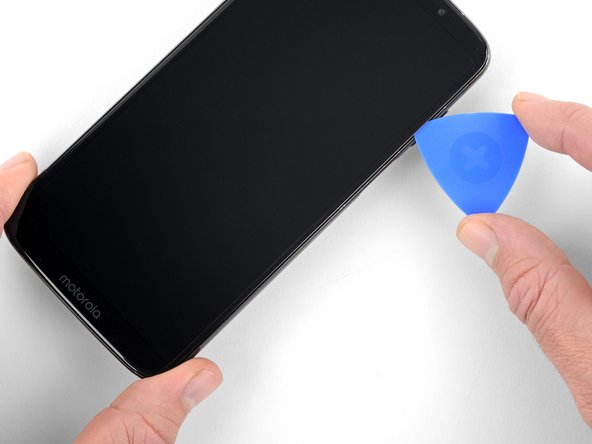

      • Slide the tool all along the right edge of the phone to slice through the adhesive securing the display.
      • If you plan to reuse the display, continue moving the tool in a straight line as you approach the corners of the phone—do not round the corners with the tool. The corners of the LCD come very close to the edge of the digitizer and are easy to damage.

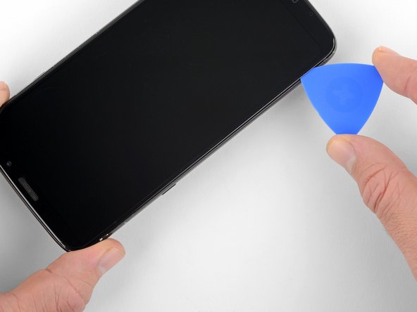

    5. Motorola Moto Z3 Screen Replacement: crwdns2935265:05crwdnd2935265:01crwdnd2935265:01crwdne2935265:0
      • Heat the upper edge of the display to soften the adhesive underneath.

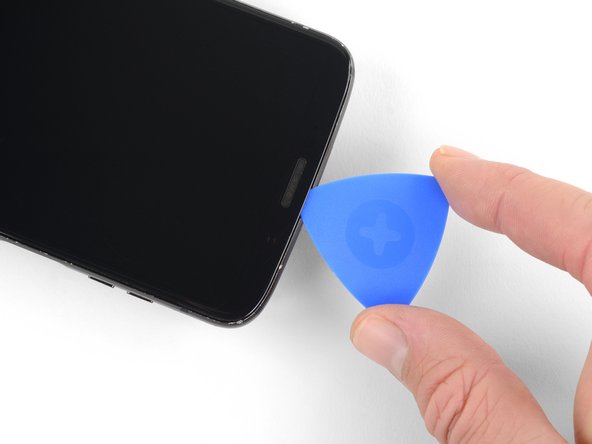

    6. Motorola Moto Z3 Screen Replacement: crwdns2935265:06crwdnd2935265:01crwdnd2935265:03crwdne2935265:0 Motorola Moto Z3 Screen Replacement: crwdns2935265:06crwdnd2935265:02crwdnd2935265:03crwdne2935265:0 Motorola Moto Z3 Screen Replacement: crwdns2935265:06crwdnd2935265:03crwdnd2935265:03crwdne2935265:0

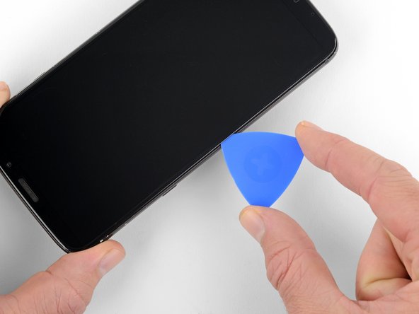

      • Slide your tool underneath the top bezel to separate the glue.
      • You can insert the pick slightly deeper here, but if you want to re-use the display, don't insert the tool more than 5.5 mm past the edge of the display.

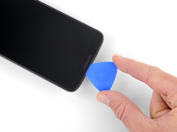

      • Slice through the glue under the lower bezel.
      • You can insert the pick slightly deeper here, but if you want to re-use the display, don't insert the tool more than 4 mm past the edge of the display.

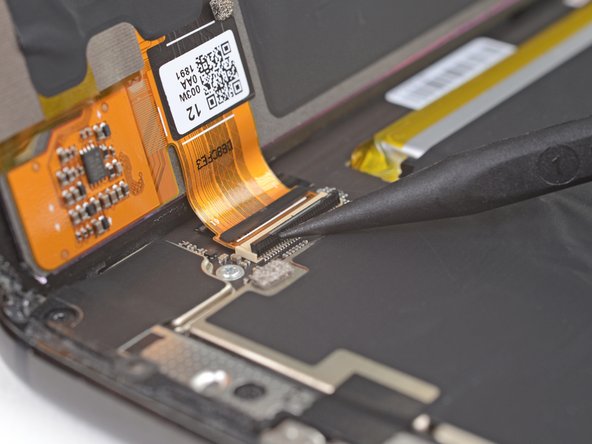

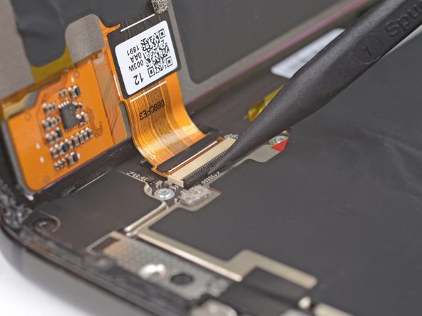

      • While holding the display open, use tweezers to remove the tape over the display cable connector.
      • Use the point of a spudger to pry up the locking tab on the display cable's ZIF connector.
