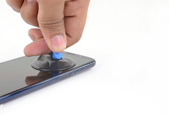

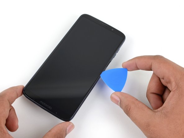

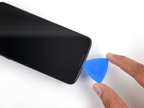

  3. Motorola Moto Z3 Play Battery Replacement, Cut the Display Adhesive: crwdns2935265:03crwdnd2935265:01crwdnd2935265:03crwdne2935265:0 Motorola Moto Z3 Play Battery Replacement, Cut the Display Adhesive: crwdns2935265:03crwdnd2935265:02crwdnd2935265:03crwdne2935265:0 Motorola Moto Z3 Play Battery Replacement, Cut the Display Adhesive: crwdns2935265:03crwdnd2935265:03crwdnd2935265:03crwdne2935265:0
    • Apply a suction cup to the display, near the middle of the right edge.
    • Pull up on the suction cup with firm, constant pressure to create a slight gap between the display and rear case.
    • If the screen is cracked, the suction cup may not stick. Try lifting it with strong tape, or superglue the suction cup in place and allow it to cure so you can proceed.
    • This may require a significant amount of force, but you only need to open a very slight gap with the suction cup to insert your tool.
    • If you have trouble, apply more heat to further soften the adhesive, and try again. The adhesive cools quickly, so you may need to heat it repeatedly.

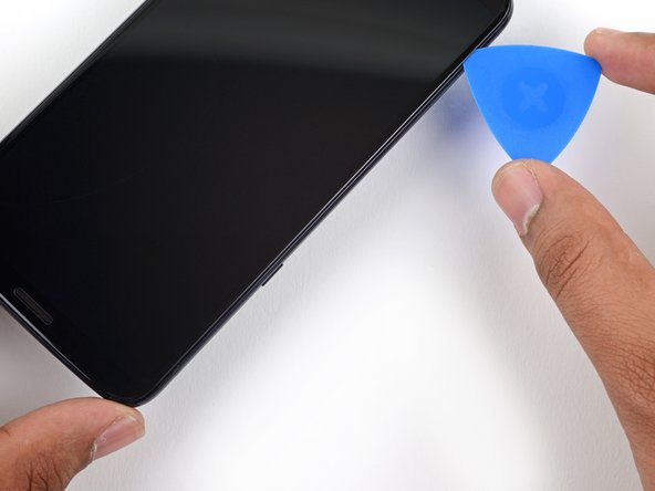

    • Insert an opening pick (or playing card) into the gap you opened behind the display.
    • Do not insert the tool more than ~1.5 mm past the edge of the display.

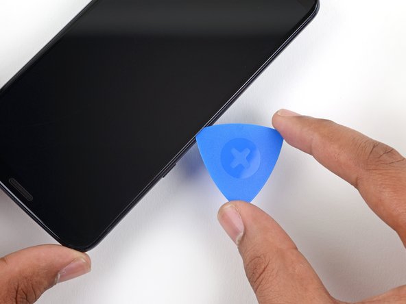

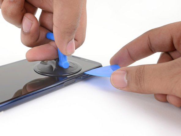

  4. Motorola Moto Z3 Play Battery Replacement: crwdns2935265:04crwdnd2935265:01crwdnd2935265:03crwdne2935265:0 Motorola Moto Z3 Play Battery Replacement: crwdns2935265:04crwdnd2935265:02crwdnd2935265:03crwdne2935265:0 Motorola Moto Z3 Play Battery Replacement: crwdns2935265:04crwdnd2935265:03crwdnd2935265:03crwdne2935265:0
    • Slide the tool all along the right edge of the phone to slice through the adhesive securing the display.
    • If you plan to reuse the display, continue moving the tool in a straight line as you approach the corners of the phone—do not round the corners with the tool. The corners of the LCD come very close to the edge of the digitizer and are easy to damage.

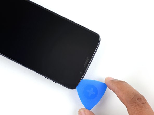

    • Heat the upper edge of the display to soften the adhesive underneath.

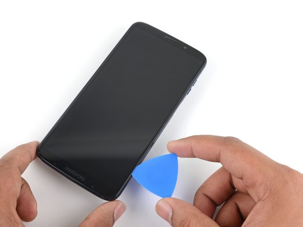

  6. Motorola Moto Z3 Play Battery Replacement: crwdns2935265:06crwdnd2935265:01crwdnd2935265:03crwdne2935265:0 Motorola Moto Z3 Play Battery Replacement: crwdns2935265:06crwdnd2935265:02crwdnd2935265:03crwdne2935265:0 Motorola Moto Z3 Play Battery Replacement: crwdns2935265:06crwdnd2935265:03crwdnd2935265:03crwdne2935265:0
    • Slide your tool underneath the top bezel to separate the glue.
    • You can insert the pick slightly deeper here, but if you want to re-use the display, don't insert the tool more than ~5.5 mm past the edge of the display.

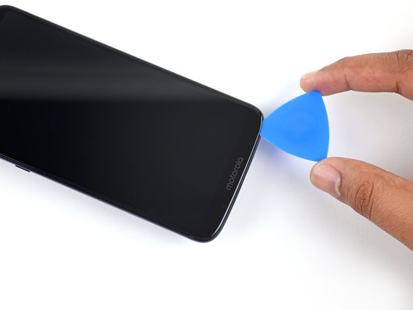

    • Heat the bottom edge of the phone to soften the adhesive securing the bottom of the display.
  10. Motorola Moto Z3 Play Battery Replacement: crwdns2935265:010crwdnd2935265:01crwdnd2935265:03crwdne2935265:0 Motorola Moto Z3 Play Battery Replacement: crwdns2935265:010crwdnd2935265:02crwdnd2935265:03crwdne2935265:0 Motorola Moto Z3 Play Battery Replacement: crwdns2935265:010crwdnd2935265:03crwdnd2935265:03crwdne2935265:0
    • Slice through the glue under the lower bezel.
    • You can insert the pick slightly deeper here, but if you want to re-use the display, don't insert the tool more than ~4 mm past the edge of the display.

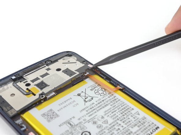

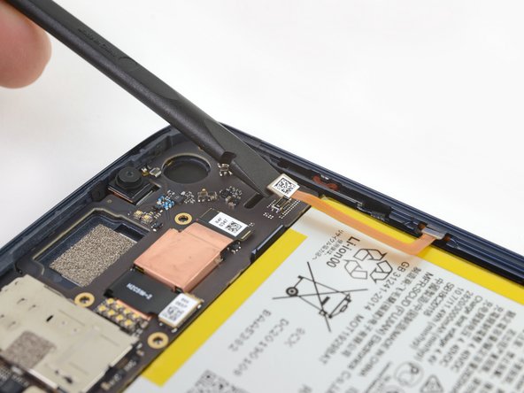

    • Use the point of a spudger to pry up the locking tab on the display cable's ZIF connector.
    If anyone knows, how hard is it to re-seat the locking tab if it’s come loose?

  13. Motorola Moto Z3 Play Battery Replacement: crwdns2935265:013crwdnd2935265:01crwdnd2935265:01crwdne2935265:0
    The flat cable may not slide smoothly out as there are tiny notches on either side: Lift, jiggle and pull carefully until it unhooks!

    • Use tweezers to peel up the black tape covering the battery connector and battery.
    • If possible, avoid damaging the tape so that it can be reused.

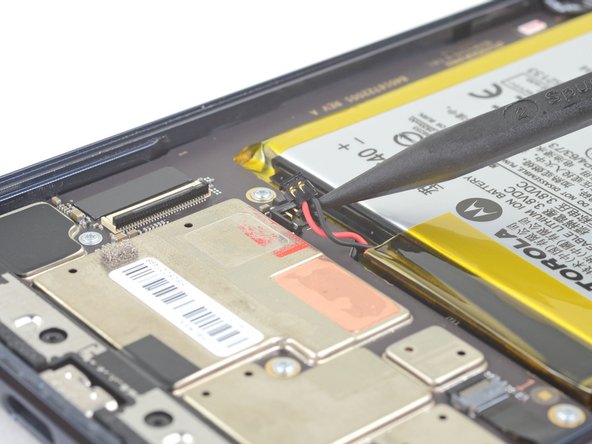

  16. Motorola Moto Z3 Play Battery Replacement, Disconnect the Battery: crwdns2935265:016crwdnd2935265:01crwdnd2935265:02crwdne2935265:0 Motorola Moto Z3 Play Battery Replacement, Disconnect the Battery: crwdns2935265:016crwdnd2935265:02crwdnd2935265:02crwdne2935265:0
    • Use the point of a spudger to pry the battery connector straight up and disconnect it.

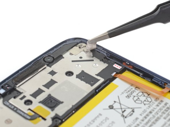

  18. Motorola Moto Z3 Play Battery Replacement, Remove Earpiece and Sensor Assembly: crwdns2935265:018crwdnd2935265:01crwdnd2935265:02crwdne2935265:0 Motorola Moto Z3 Play Battery Replacement, Remove Earpiece and Sensor Assembly: crwdns2935265:018crwdnd2935265:02crwdnd2935265:02crwdne2935265:0
    • There may two pieces of silver tape covering screws in the top corners of the device. If this is the case, carefully peel the tape back to access the screws, and replace it during reassembly.
  19. Motorola Moto Z3 Play Battery Replacement: crwdns2935265:019crwdnd2935265:01crwdnd2935265:01crwdne2935265:0
