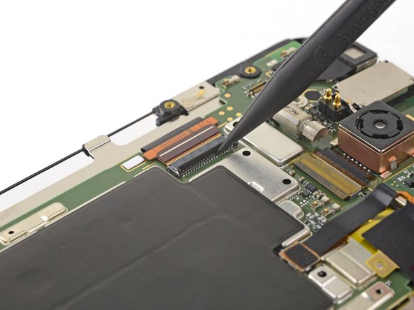

    • Remove the tape covering the display cable connector.

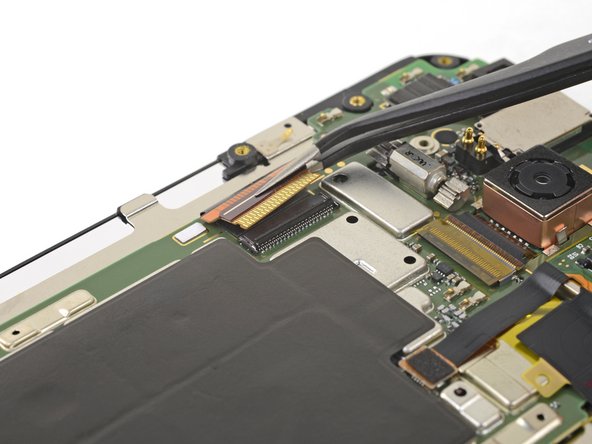

  21. Motorola Moto X Pure Edition LCD and Digitizer Assembly Replacement: crwdns2935265:021crwdnd2935265:01crwdnd2935265:03crwdne2935265:0 Motorola Moto X Pure Edition LCD and Digitizer Assembly Replacement: crwdns2935265:021crwdnd2935265:02crwdnd2935265:03crwdne2935265:0 Motorola Moto X Pure Edition LCD and Digitizer Assembly Replacement: crwdns2935265:021crwdnd2935265:03crwdnd2935265:03crwdne2935265:0
    • Use the tip of a spudger to flip open the locking flap on the display cable's ZIF connector.
    • Pull the display ribbon cable out of its socket. The cable should slide parallel to the board surface.
  22. Motorola Moto X Pure Edition LCD and Digitizer Assembly Replacement: crwdns2935265:022crwdnd2935265:01crwdnd2935265:02crwdne2935265:0 Motorola Moto X Pure Edition LCD and Digitizer Assembly Replacement: crwdns2935265:022crwdnd2935265:02crwdnd2935265:02crwdne2935265:0
    • Use the point of a spudger to lift the second display connector straight up and out of its socket.

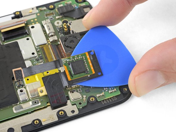

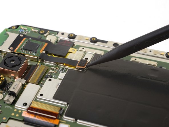

  23. Motorola Moto X Pure Edition LCD and Digitizer Assembly Replacement: crwdns2935265:023crwdnd2935265:01crwdnd2935265:01crwdne2935265:0
    • Prepare an iOpener and apply it to the small PCB adhered to the top of the SIM card slot.
  24. Motorola Moto X Pure Edition LCD and Digitizer Assembly Replacement: crwdns2935265:024crwdnd2935265:01crwdnd2935265:02crwdne2935265:0 Motorola Moto X Pure Edition LCD and Digitizer Assembly Replacement: crwdns2935265:024crwdnd2935265:02crwdnd2935265:02crwdne2935265:0
    • Slide an opening pick under the PCB to slice through its adhesive and separate it from the SIM card slot.
  25. Motorola Moto X Pure Edition LCD and Digitizer Assembly Replacement: crwdns2935265:025crwdnd2935265:01crwdnd2935265:01crwdne2935265:0

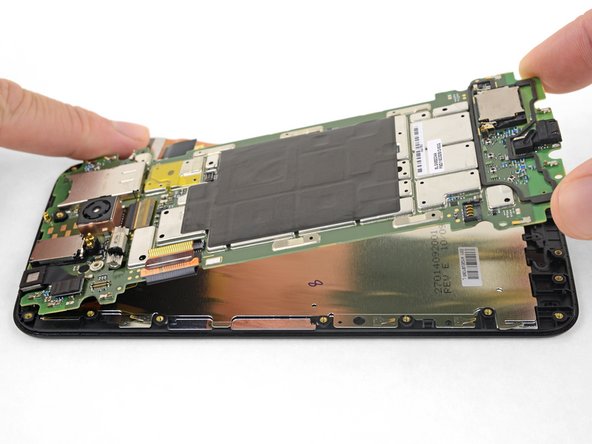

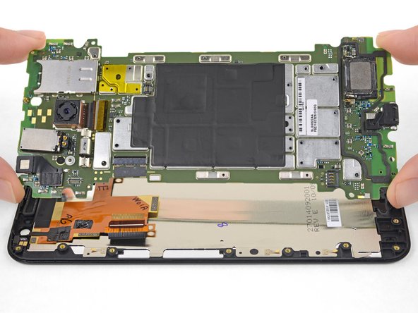

    • Use a T3 Torx driver to remove one 2.4 mm screw from the bottom of the motherboard.
  26. Motorola Moto X Pure Edition LCD and Digitizer Assembly Replacement: crwdns2935265:026crwdnd2935265:01crwdnd2935265:03crwdne2935265:0 Motorola Moto X Pure Edition LCD and Digitizer Assembly Replacement: crwdns2935265:026crwdnd2935265:02crwdnd2935265:03crwdne2935265:0 Motorola Moto X Pure Edition LCD and Digitizer Assembly Replacement: crwdns2935265:026crwdnd2935265:03crwdnd2935265:03crwdne2935265:0
    • Starting at the bottom, lift the motherboard away from the display assembly.
    • Remove the motherboard.

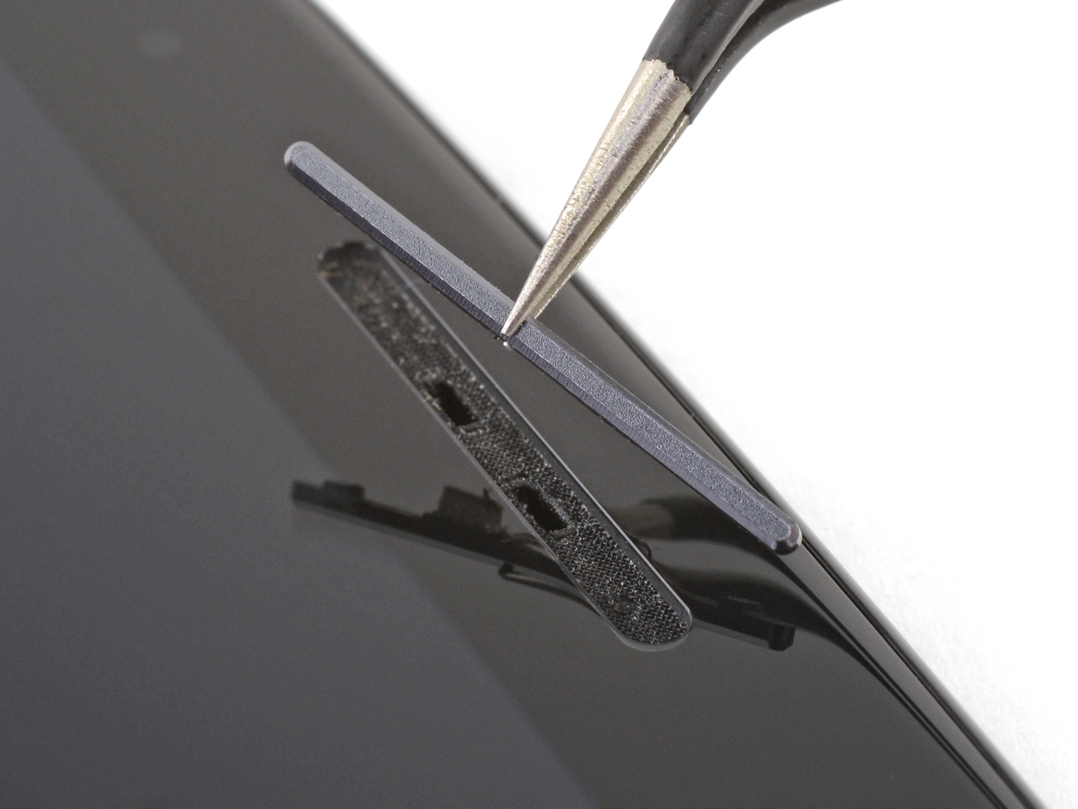

    • Only the LCD screen and digitizer assembly (with frame) remains.
    • Check carefully to make sure your replacement part matches, and that you've removed all the necessary parts from the old frame for installation in the new one.
    • When reassembling your phone replace old adhesive with double-sided tape or pre-cut adhesive strips.
    • Your new display may not come with the small metal speaker guards installed over the front-facing speaker grills. If this is the case, continue to the next step. If your display comes with these installed, you may stop here.

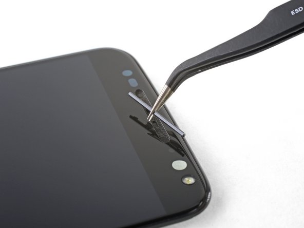

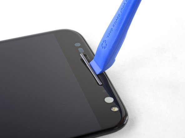

  28. Motorola Moto X Pure Edition LCD and Digitizer Assembly Replacement: crwdns2935265:028crwdnd2935265:01crwdnd2935265:03crwdne2935265:0 Motorola Moto X Pure Edition LCD and Digitizer Assembly Replacement: crwdns2935265:028crwdnd2935265:02crwdnd2935265:03crwdne2935265:0 Motorola Moto X Pure Edition LCD and Digitizer Assembly Replacement: crwdns2935265:028crwdnd2935265:03crwdnd2935265:03crwdne2935265:0
    • Use an opening tool to carefully pry the upper speaker guard straight up and out of the speaker grill.
    • Remove the speaker guard.
  29. Motorola Moto X Pure Edition LCD and Digitizer Assembly Replacement: crwdns2935265:029crwdnd2935265:01crwdnd2935265:01crwdne2935265:0
    • Repeat the previous step to remove the lower speaker guard.
    • To reinstall the guard, line up the small tabs on the guard with the holes in the grill, and press the guard straight down into the grill.
