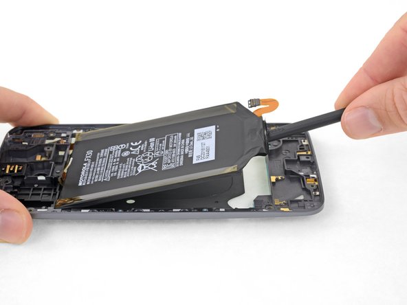

  24. Motorola Moto X Pure Edition Battery Replacement: crwdns2935265:024crwdnd2935265:01crwdnd2935265:03crwdne2935265:0 Motorola Moto X Pure Edition Battery Replacement: crwdns2935265:024crwdnd2935265:02crwdnd2935265:03crwdne2935265:0 Motorola Moto X Pure Edition Battery Replacement: crwdns2935265:024crwdnd2935265:03crwdnd2935265:03crwdne2935265:0
    Tesa 61395 Tape
    $5.99
    • Use the flat end of a spudger to lift the battery out of the midframe.
    • Check to make sure no ribbon cables remain stuck to the battery, and separate them carefully if needed.
    • If there is still adhesive holding the battery down, slowly pry the battery away from the midframe, taking care not to bend the battery.
    • The battery will separate more easily if you add a few drops of isopropyl alcohol along each side, to soften the adhesive beneath. High concentration (90% or greater) alcohol will not harm your phone's components.
    • Alternatively, you may apply heat to the midframe to soften the battery adhesive, but be very careful not to overheat the battery.
    • Don't deform or puncture the battery—it can catch fire and/or explode if damaged.
    • Never reinstall a damaged or deformed battery. Replace the battery.
