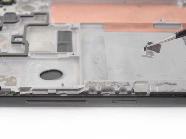

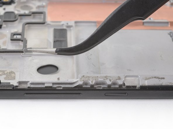

  32. Motorola Moto G6 Screen Replacement: crwdns2935265:032crwdnd2935265:01crwdnd2935265:03crwdne2935265:0 Motorola Moto G6 Screen Replacement: crwdns2935265:032crwdnd2935265:02crwdnd2935265:03crwdne2935265:0 Motorola Moto G6 Screen Replacement: crwdns2935265:032crwdnd2935265:03crwdnd2935265:03crwdne2935265:0
    • Use tweezers to lift the two silver retention brackets flanking either end of the volume and power buttons straight up and remove them from the phone.
