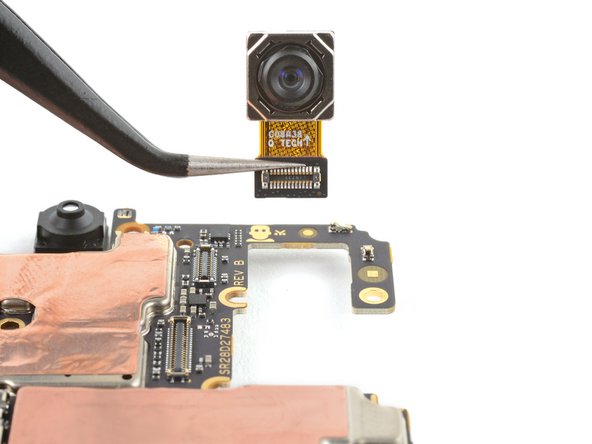

  25. Motorola Moto G Stylus 5G (2022) Motherboard Replacement, Main Camera: crwdns2935265:025crwdnd2935265:01crwdnd2935265:03crwdne2935265:0 Motorola Moto G Stylus 5G (2022) Motherboard Replacement, Main Camera: crwdns2935265:025crwdnd2935265:02crwdnd2935265:03crwdne2935265:0 Motorola Moto G Stylus 5G (2022) Motherboard Replacement, Main Camera: crwdns2935265:025crwdnd2935265:03crwdnd2935265:03crwdne2935265:0
    • Flip the motherboard over so the rear cameras are faced down.
    • Use the point of a spudger to pry and disconnect the main camera's press connector.
    • The camera may eject from the motherboard. Work slowly to avoid losing it.
    • Use a pair of tweezers or your fingers to grab and remove the camera.

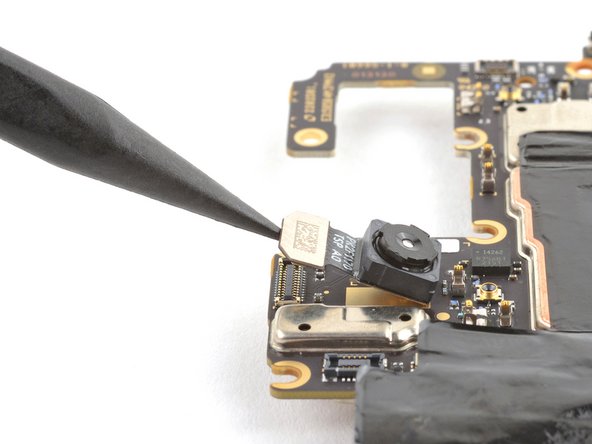

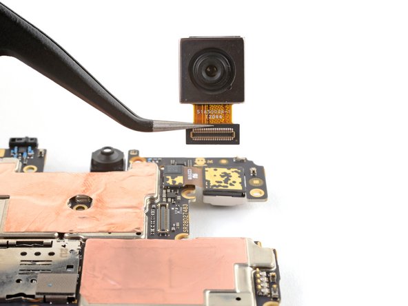

  26. Motorola Moto G Stylus 5G (2022) Motherboard Replacement, Remove the macro camera: crwdns2935265:026crwdnd2935265:01crwdnd2935265:03crwdne2935265:0 Motorola Moto G Stylus 5G (2022) Motherboard Replacement, Remove the macro camera: crwdns2935265:026crwdnd2935265:02crwdnd2935265:03crwdne2935265:0 Motorola Moto G Stylus 5G (2022) Motherboard Replacement, Remove the macro camera: crwdns2935265:026crwdnd2935265:03crwdnd2935265:03crwdne2935265:0
    • Use the point of a spudger to pry and disconnect the macro camera's press connector.
    • Grab and remove the camera.

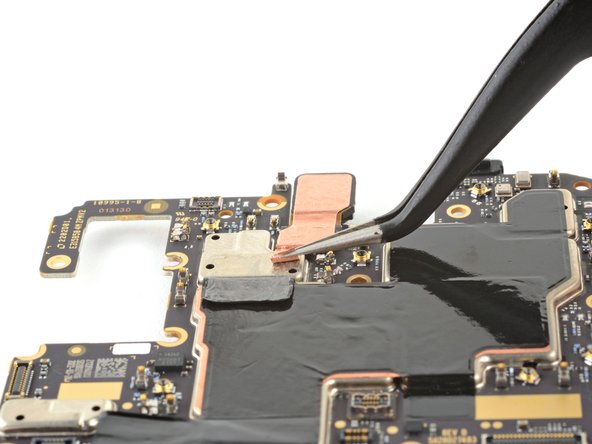

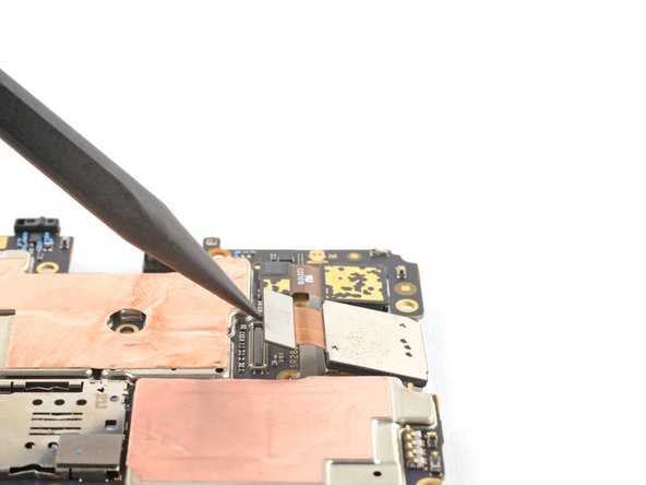

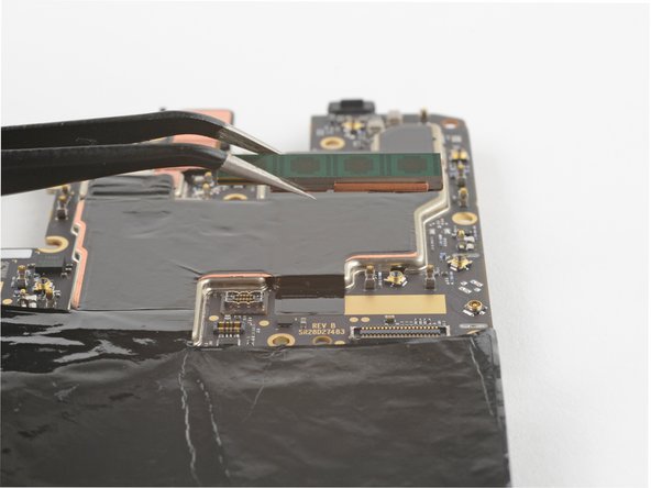

  28. Motorola Moto G Stylus 5G (2022) Motherboard Replacement, Remove the 5G mmWave Antenna: crwdns2935265:028crwdnd2935265:01crwdnd2935265:03crwdne2935265:0 Motorola Moto G Stylus 5G (2022) Motherboard Replacement, Remove the 5G mmWave Antenna: crwdns2935265:028crwdnd2935265:02crwdnd2935265:03crwdne2935265:0 Motorola Moto G Stylus 5G (2022) Motherboard Replacement, Remove the 5G mmWave Antenna: crwdns2935265:028crwdnd2935265:03crwdnd2935265:03crwdne2935265:0
    • Flip the motherboard over again so that the graphite film is facing upwards.
    • Insert a spudger between the left side of the 5G mmWave antenna and the motherboard.
    • Pry up to disconnect the press connector.
    • Use a pair of tweezers or your fingers to grab and remove the 5G mmWave antenna.
    • There is light adhesive holding the antenna in place.

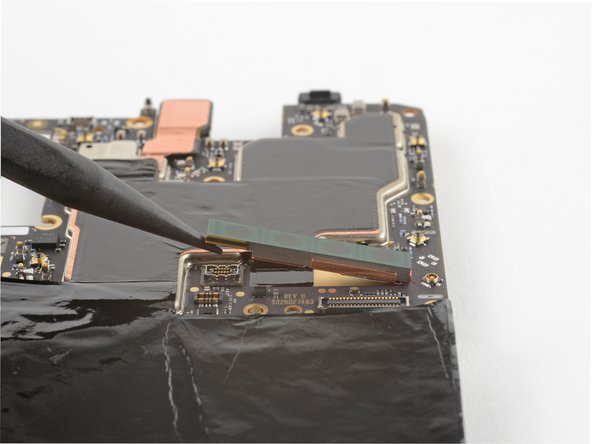

  29. Motorola Moto G Stylus 5G (2022) Motherboard Replacement, Heat the tape: crwdns2935265:029crwdnd2935265:01crwdnd2935265:01crwdne2935265:0
    • Heat an iOpener and apply it to the front-facing camera for two minutes.
    • A hair dryer or heat gun may also be used, but be careful not to overheat the phone—the display and internal battery are both susceptible to heat damage.

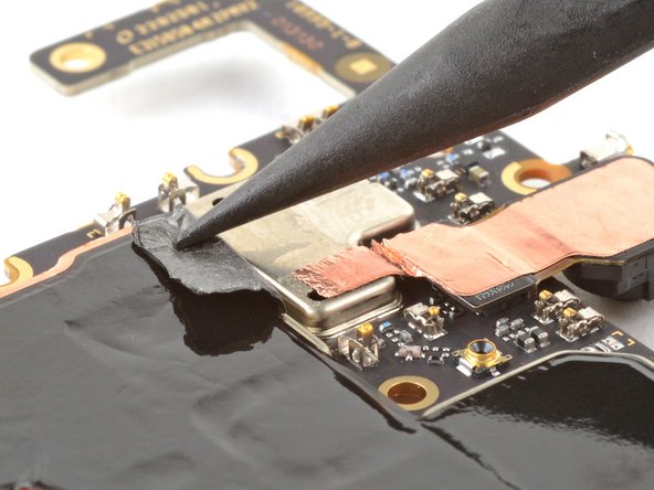

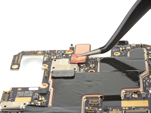

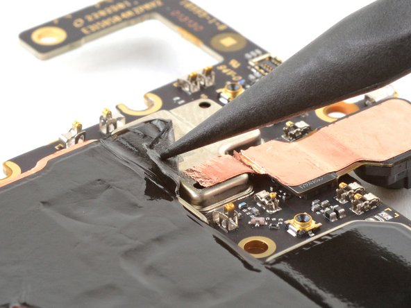

  30. Motorola Moto G Stylus 5G (2022) Motherboard Replacement, Peel the graphite film: crwdns2935265:030crwdnd2935265:01crwdnd2935265:03crwdne2935265:0 Motorola Moto G Stylus 5G (2022) Motherboard Replacement, Peel the graphite film: crwdns2935265:030crwdnd2935265:02crwdnd2935265:03crwdne2935265:0 Motorola Moto G Stylus 5G (2022) Motherboard Replacement, Peel the graphite film: crwdns2935265:030crwdnd2935265:03crwdnd2935265:03crwdne2935265:0
    • Use the point of a spudger to lift the graphite film near the front-facing camera.
    • Peel the graphite film and fully expose the front-facing camera's copper tape.

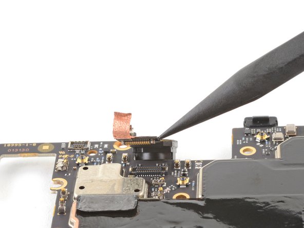

  31. Motorola Moto G Stylus 5G (2022) Motherboard Replacement, Peel the copper tape: crwdns2935265:031crwdnd2935265:01crwdnd2935265:03crwdne2935265:0 Motorola Moto G Stylus 5G (2022) Motherboard Replacement, Peel the copper tape: crwdns2935265:031crwdnd2935265:02crwdnd2935265:03crwdne2935265:0 Motorola Moto G Stylus 5G (2022) Motherboard Replacement, Peel the copper tape: crwdns2935265:031crwdnd2935265:03crwdnd2935265:03crwdne2935265:0
    • Use the tips of your tweezers to lift a corner of the front-facing camera's copper tape.
    • Grab and peel the copper tape from the motherboard.
    • This tape tears very easily. Work slowly and apply more heat if the tape feels stuck.

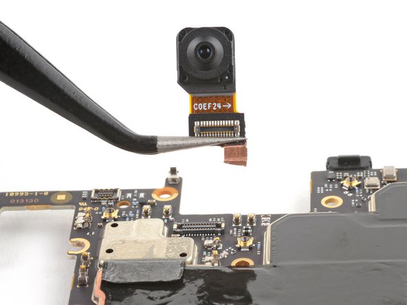

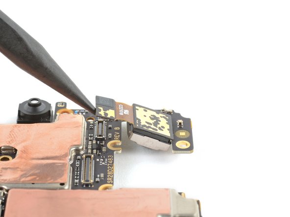

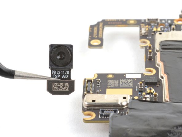

  32. Motorola Moto G Stylus 5G (2022) Motherboard Replacement, Remove the front-facing camera: crwdns2935265:032crwdnd2935265:01crwdnd2935265:03crwdne2935265:0 Motorola Moto G Stylus 5G (2022) Motherboard Replacement, Remove the front-facing camera: crwdns2935265:032crwdnd2935265:02crwdnd2935265:03crwdne2935265:0 Motorola Moto G Stylus 5G (2022) Motherboard Replacement, Remove the front-facing camera: crwdns2935265:032crwdnd2935265:03crwdnd2935265:03crwdne2935265:0
    • Use the point of a spudger to pry and disconnect the front-facing camera's press connector.
    • Remove the camera with your fingers or a pair of tweezers.
