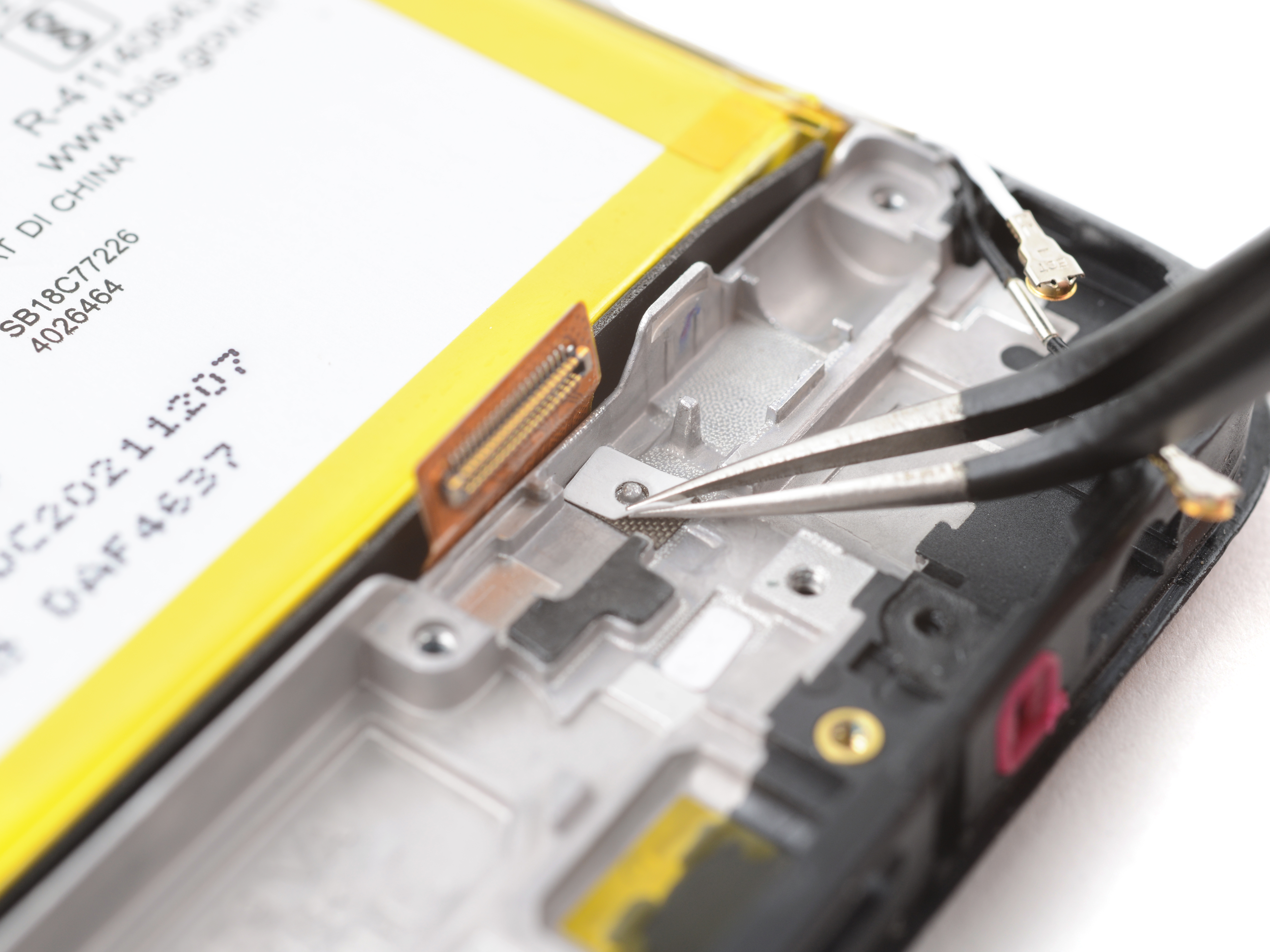

  13. Motorola Moto G 5G (2022) Screen Replacement, Unfasten the power button cable bracket: crwdns2935265:013crwdnd2935265:01crwdnd2935265:02crwdne2935265:0 Motorola Moto G 5G (2022) Screen Replacement, Unfasten the power button cable bracket: crwdns2935265:013crwdnd2935265:02crwdnd2935265:02crwdne2935265:0
    • Use a PH00 screwdriver to remove the two 3.9 mm-long screws securing the power button cable bracket.
  14. Motorola Moto G 5G (2022) Screen Replacement, Remove the power button cable bracket: crwdns2935265:014crwdnd2935265:01crwdnd2935265:02crwdne2935265:0 Motorola Moto G 5G (2022) Screen Replacement, Remove the power button cable bracket: crwdns2935265:014crwdnd2935265:02crwdnd2935265:02crwdne2935265:0
    • Use your fingers or a pair of blunt nose tweezers to grab and remove the bracket from the power button cable.
  15. Motorola Moto G 5G (2022) Screen Replacement, Disconnect the power button: crwdns2935265:015crwdnd2935265:01crwdnd2935265:02crwdne2935265:0 Motorola Moto G 5G (2022) Screen Replacement, Disconnect the power button: crwdns2935265:015crwdnd2935265:02crwdnd2935265:02crwdne2935265:0
    • Use the pointed end of a spudger to pry up and disconnect the power button's press connector.
  16. Motorola Moto G 5G (2022) Screen Replacement, Remove the power button: crwdns2935265:016crwdnd2935265:01crwdnd2935265:02crwdne2935265:0 Motorola Moto G 5G (2022) Screen Replacement, Remove the power button: crwdns2935265:016crwdnd2935265:02crwdnd2935265:02crwdne2935265:0
    • Grab and remove the power button.
    • If you're using tweezers, take care not to puncture the battery—a punctured battery may leak dangerous chemicals or cause a fire.

    • Apply the isopropyl alcohol into the gaps between the sides of the battery and the frame.
  43. Motorola Moto G 5G (2022) Screen Replacement, Pry the battery: crwdns2935265:043crwdnd2935265:01crwdnd2935265:03crwdne2935265:0 Motorola Moto G 5G (2022) Screen Replacement, Pry the battery: crwdns2935265:043crwdnd2935265:02crwdnd2935265:03crwdne2935265:0 Motorola Moto G 5G (2022) Screen Replacement, Pry the battery: crwdns2935265:043crwdnd2935265:03crwdnd2935265:03crwdne2935265:0
    • Apply a suction cup to the battery, as close to the center of the right edge as possible.
    • Insert an opening pick between the right edge of the battery and the frame.
    • Pull on the suction cup and pry the battery upward.
    • Don't use excessive force on the battery. Slow, consistent pressure is all that is required to free it from the frame.
    • Use two opening picks, side-by-side, if the first pick does not provide enough leverage, like this.
    • Remove the battery from the frame.
    • Don't reinstall a damaged or deformed battery, as doing so is a potential safety hazard.
    • Use this guide to install a battery with custom-cut adhesives, or use this guide to install a battery with an adhesive sheet.
