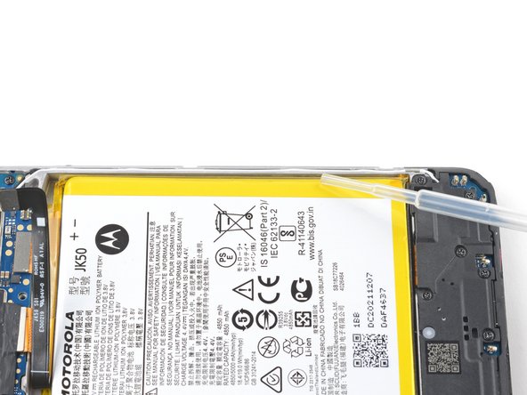

  22. Motorola Moto G 5G (2022) Battery Replacement, Soften the adhesive with isopropyl alcohol: crwdns2935265:022crwdnd2935265:01crwdnd2935265:02crwdne2935265:0 Motorola Moto G 5G (2022) Battery Replacement, Soften the adhesive with isopropyl alcohol: crwdns2935265:022crwdnd2935265:02crwdnd2935265:02crwdne2935265:0
    • Additionally, you may use highly-concentrated isopropyl alcohol (over 90%) to further loosen the adhesive securing the battery.
    • Apply the isopropyl alcohol into the gaps between the sides of the battery and the frame.

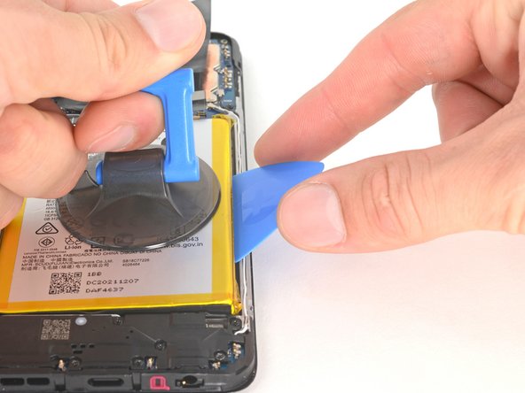

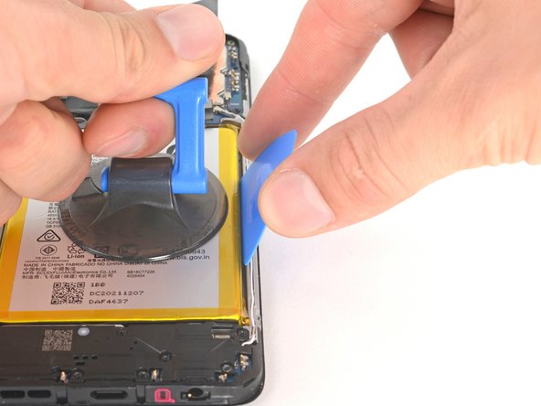

  23. Motorola Moto G 5G (2022) Battery Replacement, Pry the battery: crwdns2935265:023crwdnd2935265:01crwdnd2935265:03crwdne2935265:0 Motorola Moto G 5G (2022) Battery Replacement, Pry the battery: crwdns2935265:023crwdnd2935265:02crwdnd2935265:03crwdne2935265:0 Motorola Moto G 5G (2022) Battery Replacement, Pry the battery: crwdns2935265:023crwdnd2935265:03crwdnd2935265:03crwdne2935265:0
    • Apply a suction cup to the battery, as close to the center of the right edge as possible.
    • Insert an opening pick between the right edge of the battery and the frame.
    • Pull on the suction cup and pry the battery upward.
    • Don't use excessive force on the battery. Slow, consistent pressure is all that is required to free it from the frame.
    • Use two opening picks, side-by-side, if the first pick does not provide enough leverage, like this.
    • Apply more isopropyl alcohol if the battery becomes stuck.

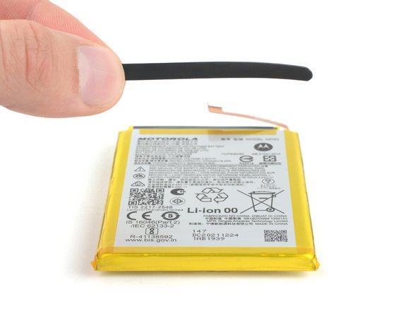

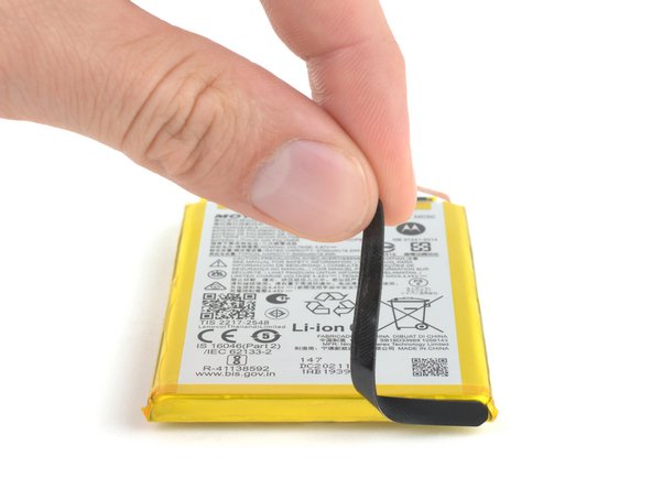

  25. Motorola Moto G 5G (2022) Battery Replacement, Remove the foam strip: crwdns2935265:025crwdnd2935265:01crwdnd2935265:03crwdne2935265:0 Motorola Moto G 5G (2022) Battery Replacement, Remove the foam strip: crwdns2935265:025crwdnd2935265:02crwdnd2935265:03crwdne2935265:0 Motorola Moto G 5G (2022) Battery Replacement, Remove the foam strip: crwdns2935265:025crwdnd2935265:03crwdnd2935265:03crwdne2935265:0
    • Peel and remove the foam strip from the bottom of the battery.
    • Apply the foam strip onto your new battery.
For optimal performance, calibrate your newly installed battery after completing this guide.
