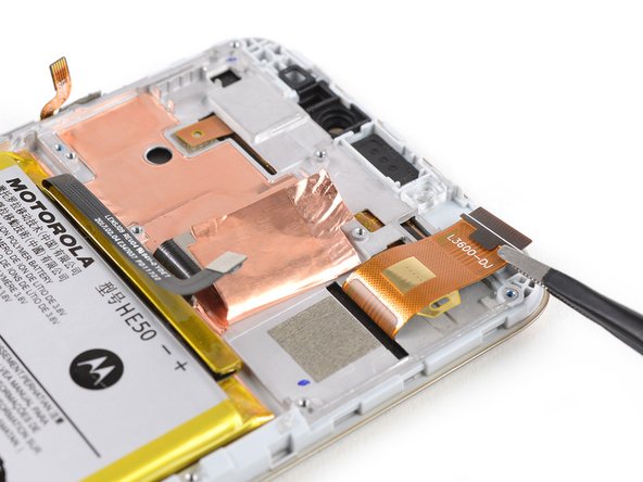

  21. Motorola Moto E4 Plus (XT1771) Fingerprint Sensor Replacement, Display: crwdns2935265:021crwdnd2935265:01crwdnd2935265:02crwdne2935265:0 Motorola Moto E4 Plus (XT1771) Fingerprint Sensor Replacement, Display: crwdns2935265:021crwdnd2935265:02crwdnd2935265:02crwdne2935265:0
    • Use a pair of tweezers to peel the copper tape from the right edge until the display flex cable underneath is fully exposed.

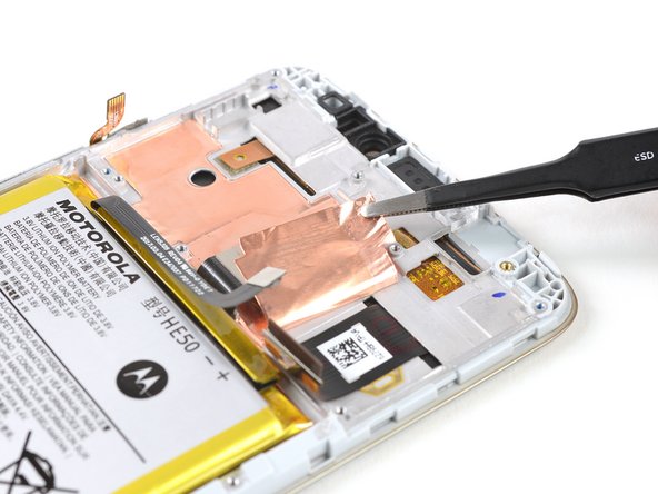

  22. Motorola Moto E4 Plus (XT1771) Fingerprint Sensor Replacement: crwdns2935265:022crwdnd2935265:01crwdnd2935265:02crwdne2935265:0 Motorola Moto E4 Plus (XT1771) Fingerprint Sensor Replacement: crwdns2935265:022crwdnd2935265:02crwdnd2935265:02crwdne2935265:0
    • Use a pair of tweezers to carefully peel the display flex cable off of the midframe.

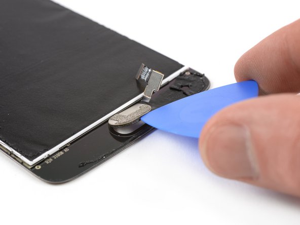

  30. Motorola Moto E4 Plus (XT1771) Fingerprint Sensor Replacement, Fingerprint Sensor: crwdns2935265:030crwdnd2935265:01crwdnd2935265:01crwdne2935265:0
    • Apply an iOpener to the bottom edge of the screen for about a minute to loosen the adhesive beneath the fingerprint sensor.
  31. Motorola Moto E4 Plus (XT1771) Fingerprint Sensor Replacement: crwdns2935265:031crwdnd2935265:01crwdnd2935265:03crwdne2935265:0 Motorola Moto E4 Plus (XT1771) Fingerprint Sensor Replacement: crwdns2935265:031crwdnd2935265:02crwdnd2935265:03crwdne2935265:0 Motorola Moto E4 Plus (XT1771) Fingerprint Sensor Replacement: crwdns2935265:031crwdnd2935265:03crwdnd2935265:03crwdne2935265:0
    • Carefully pry off the fingerprint sensor by lifting it with the edge of an opening pick.
    • Remove the fingerprint sensor with a pair of tweezers.
    • There's a small rubber gasket around the fingerprint sensor which you might need to transfer to your replacement sensor.
