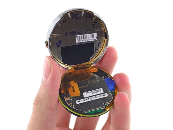

  7. Motorola Moto 360 Teardown: crwdns2935265:07crwdnd2935265:01crwdnd2935265:03crwdne2935265:0 Motorola Moto 360 Teardown: crwdns2935265:07crwdnd2935265:02crwdnd2935265:03crwdne2935265:0 Motorola Moto 360 Teardown: crwdns2935265:07crwdnd2935265:03crwdnd2935265:03crwdne2935265:0
    Jimmy
    $7.95
    • The Moto 360's innards are sealed in tight. No easy point of entry and a rubber o-ring waterproof this oyster, but make it extra difficult to open.
    • We suspect Motorola has a special tool for this job. For the rest of us, there's the Jimmy.
    • Instead of a pearl, we find a round motherboard squeezed into the inner enclosure. A couple of data cables run to the front panel connecting the two halves.
    • Disconnecting the LCD and digitizer cables frees the halves for more exploration.

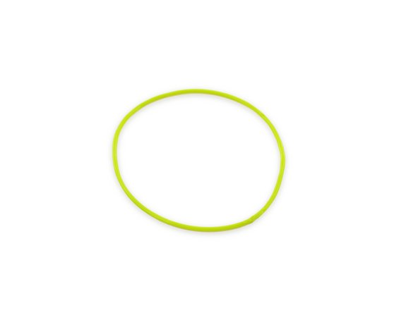

  8. Motorola Moto 360 Teardown: crwdns2935265:08crwdnd2935265:01crwdnd2935265:02crwdne2935265:0 Motorola Moto 360 Teardown: crwdns2935265:08crwdnd2935265:02crwdnd2935265:02crwdne2935265:0
    • Any good water resistant watch will have some fancy seals. Our Moto 360 is no different, and it keeps water away from its innards with a colorful rubber o-ring.
    • The o-ring is essentially a fancy rubber band. But for technical purposes, we will refer to it as a fancy rubber o-ring. After all, we are professionals.

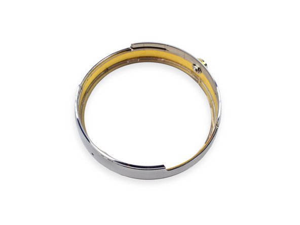

  17. Motorola Moto 360 Teardown: crwdns2935265:018crwdnd2935265:01crwdnd2935265:02crwdne2935265:0 Motorola Moto 360 Teardown: crwdns2935265:018crwdnd2935265:02crwdnd2935265:02crwdne2935265:0
    • After being freed from the rest of the watch, the display assembly is laid out in all its glory.
    • We can't help but notice that it looks just like the USS Enterprise, if it were missing a nacelle that is.
    • The Moto 360 is the first Android Wear smartwatch to feature an ambient light sensor (for an auto-dimming screen). To save space, Motorola built the sensor into the display assembly, which explains the black bar found on the bottom of the display.
